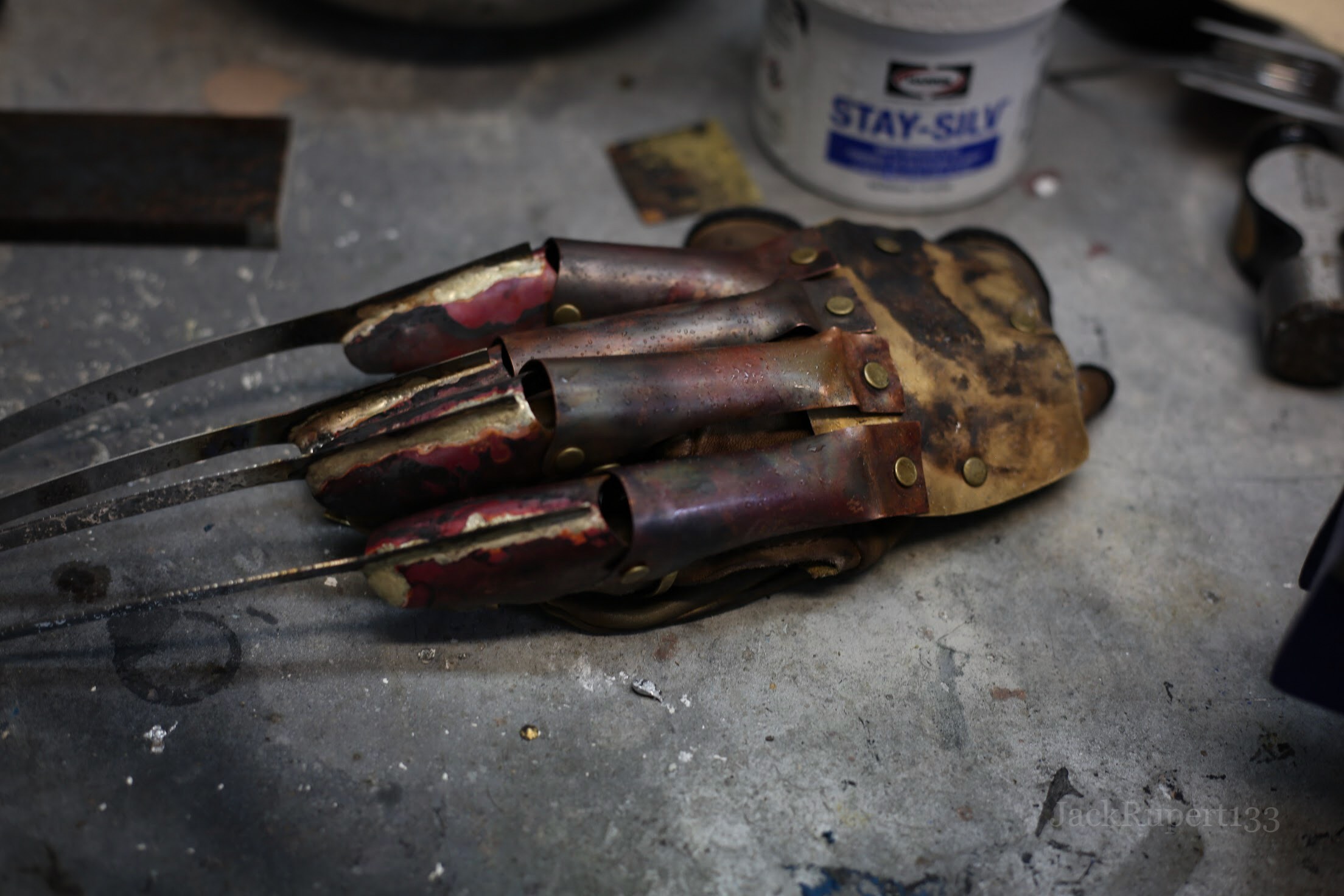

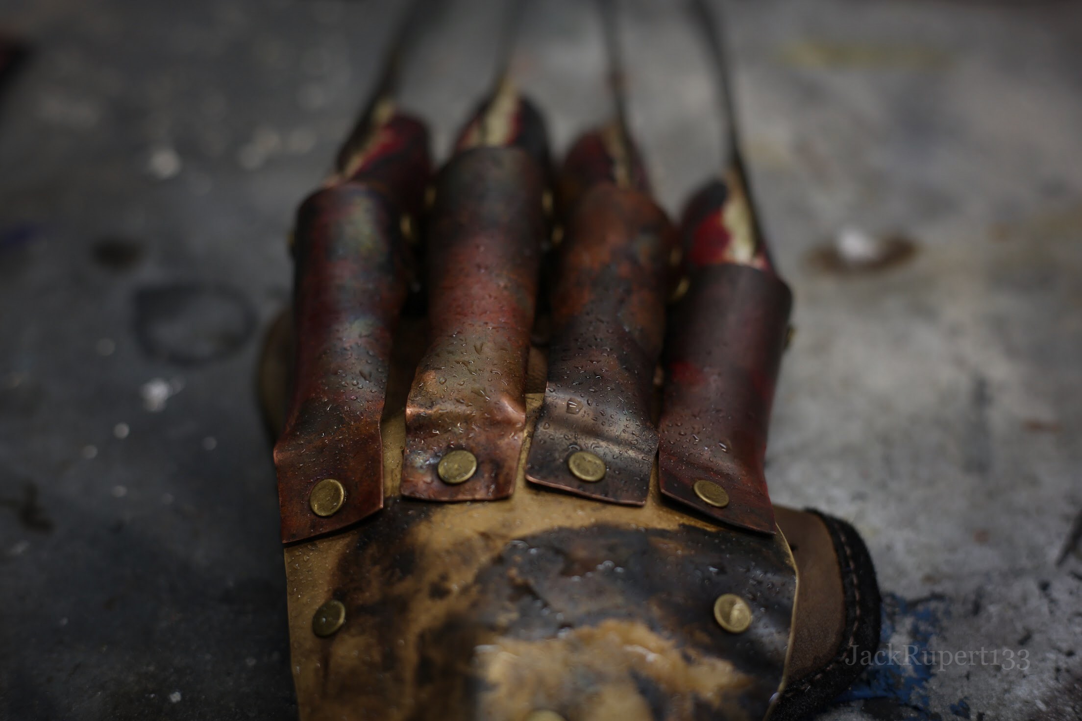

My attempt not a replace just a Krueger glove and man I got that thing sharp

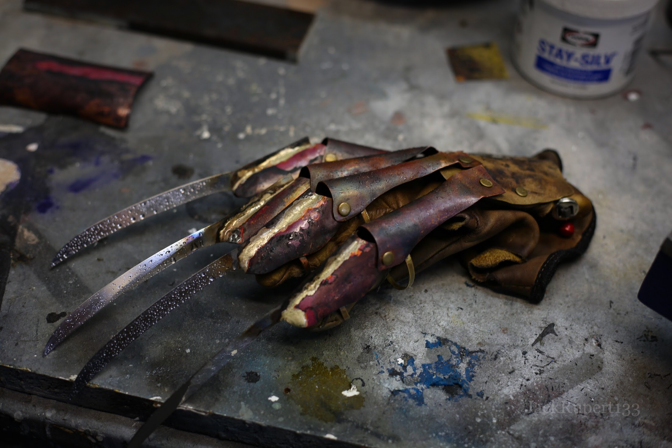

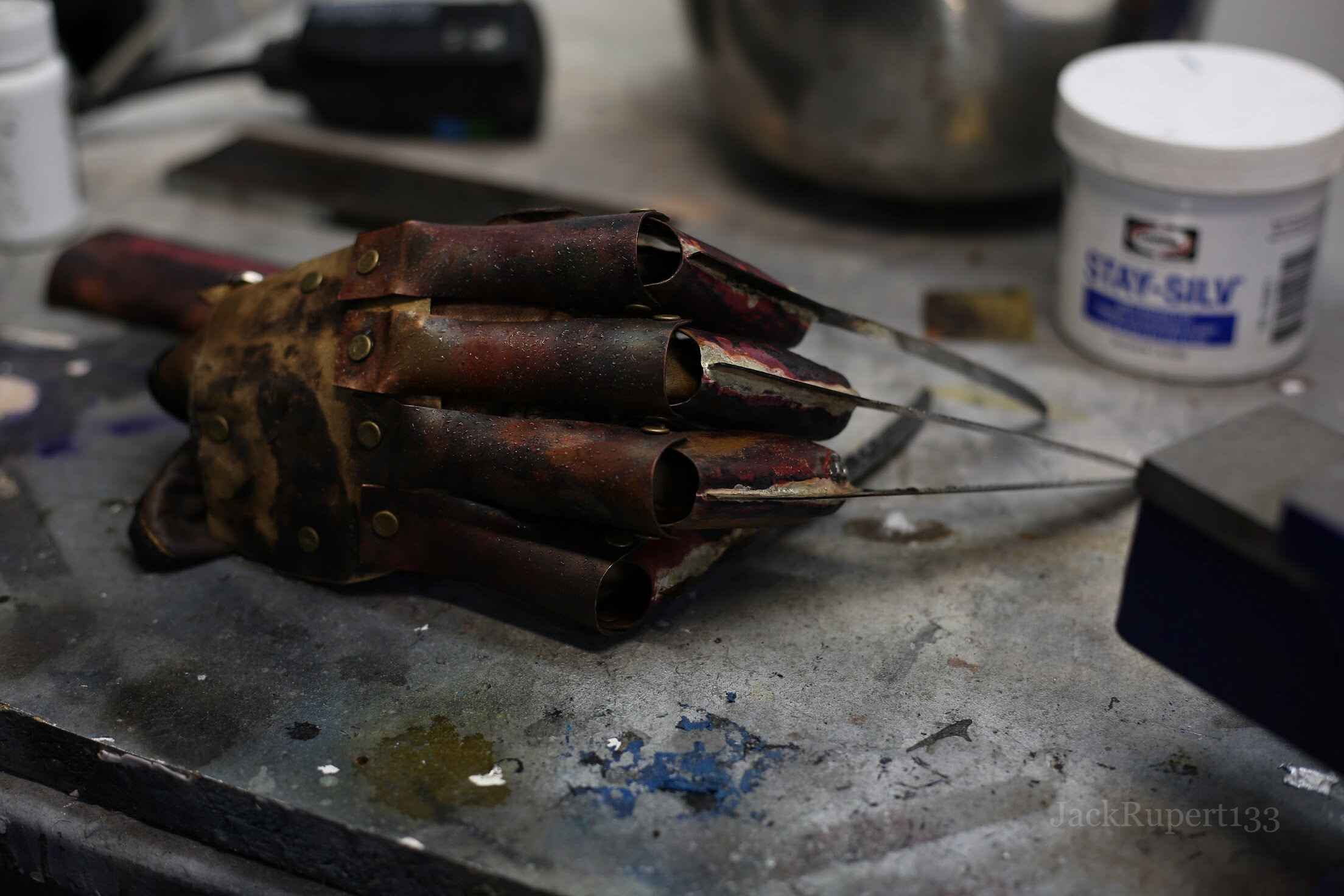

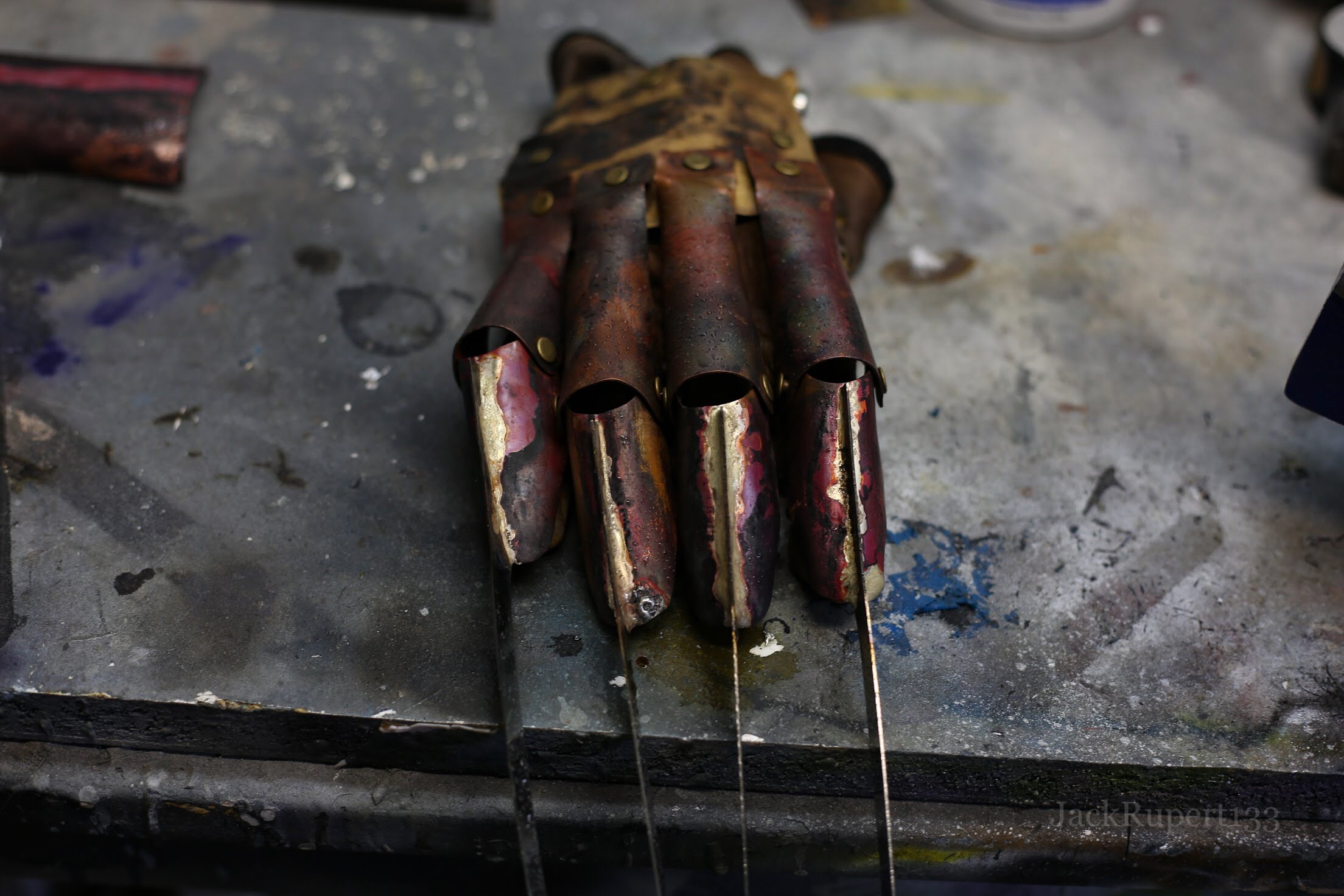

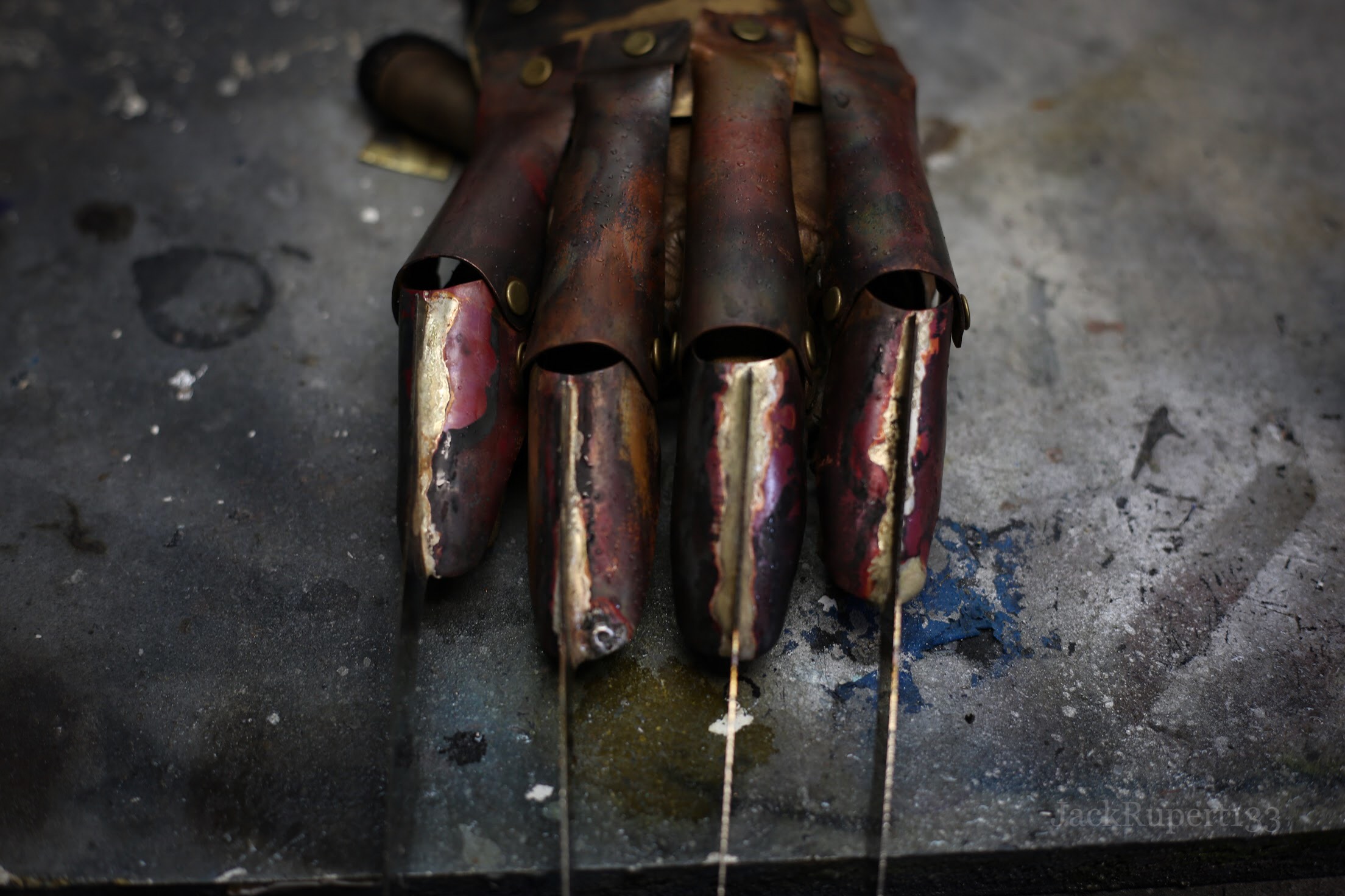

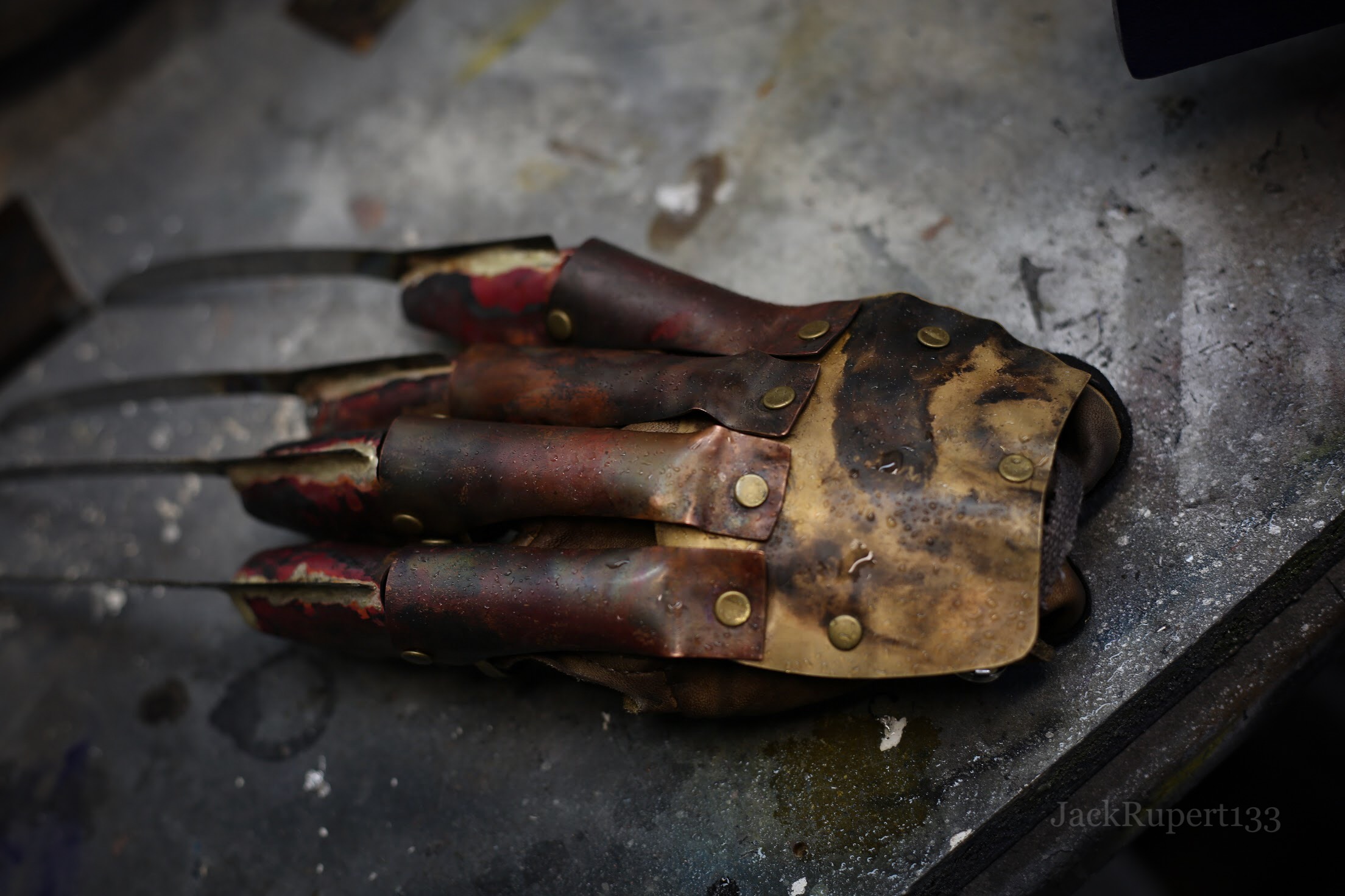

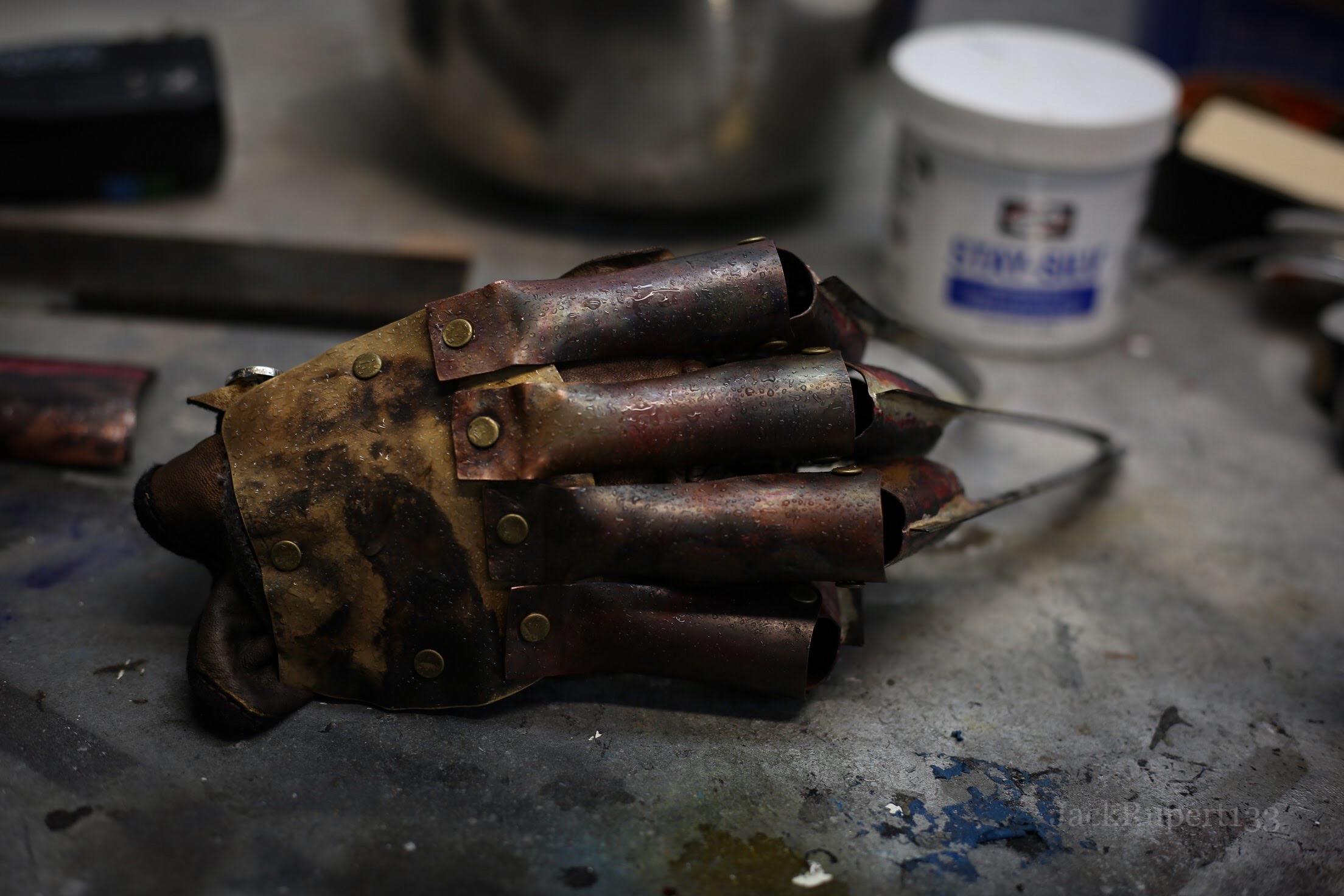

Hey folks! Been a while since I’ve had anything to share. I had some free time, and I’ve always really wanted to make myself a Freddy Glove. I had made attempts years ago that never quite reached my standards. Happy to say that I’ve just made my first Part One Glove, and I am thrilled with the results.
While it is certainly not down to the dent screen accurate, it is very screen “authentic”. What I mean by that is to the best of my ability, I used the exact same templates, the exact same materials, and exact same techniques, used to construct the original glove.
The stalls and tips are made out of 3/4” Type M Copper Pipe. The backplate and rings are made of .02 brass. The blades are .02 spring steel brazed on to the tips with a high silver content brazing wire. I tried to replicate everything down to individual brazing and solder spills. Other small details I replicated include the small hole next to the rivet on the ring stall, the slanted ring on the ring tip, and the slightly curved pinky blade.
View attachment 1013966 View attachment 1013967 View attachment 1013968 View attachment 1013969 View attachment 1013970 View attachment 1013971 View attachment 1013972 View attachment 1013973
Hope you like it. I also shot a short video where I show close ups and also movement of the glove.
I do paint commissions very frequently and plan on uploading short videos showing techniques and finished commissions, as well as builds like this. If that sounds like something that interests you, feel free to subscribe as well!

The easiest way to do the blades for a one off glove, in my opinion, is just buy really cheap dollar store knives and cut them out of those. If you plan to do a few you can draft up a template and have them waterjet cut through an online service, they should have different materials to choose from.
That is correct. It is seen in the film both broken and unbroken so for P1 it is down to preference. P2 always has the break. The glove in my initial post was done clean, but I did make a sister glove to it which has the break. Never ended up mounting it on leather though. My original glove above was gifted to a good friend who has since passed.
I don’t know if your still following this thread but my question is how do you solder the ringlets on without heating it to the point where the blades fall off and vice versa I do the ringlets my blades fall off I do the blades my ringlets fall off
When I was doing them I brazed the blades with map gas and brazing wire, the ringlets and blade break I did with propane gas and normal solder. I think at that time I was using acid core solder. Much lower melting point than the brazing wire so I could sit there and heat those ringlets all day without any issue.
