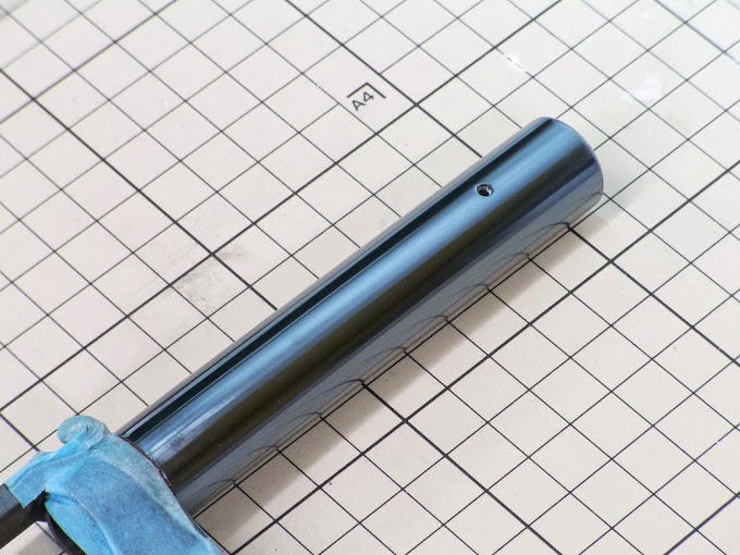

You cant blue aluminum. Unless they make it out of steel they cant blue it. I am not sure what finish you could put on aluminum that would give the same finish..
How do they achieve this tho? and what are there barrel's made of?
I don't know, where is that pic from? I think they were saying because of legalities the barrel could not be made of metal so I'm guessing it will be plastic. You could probably get that finish using paint.
The receiver is zinc and can be blued. At least it was on the last kit. The barrel is plastic that has been impregnated with a touch of zinc so that with some care you can achieve a reasonable blued finish.
