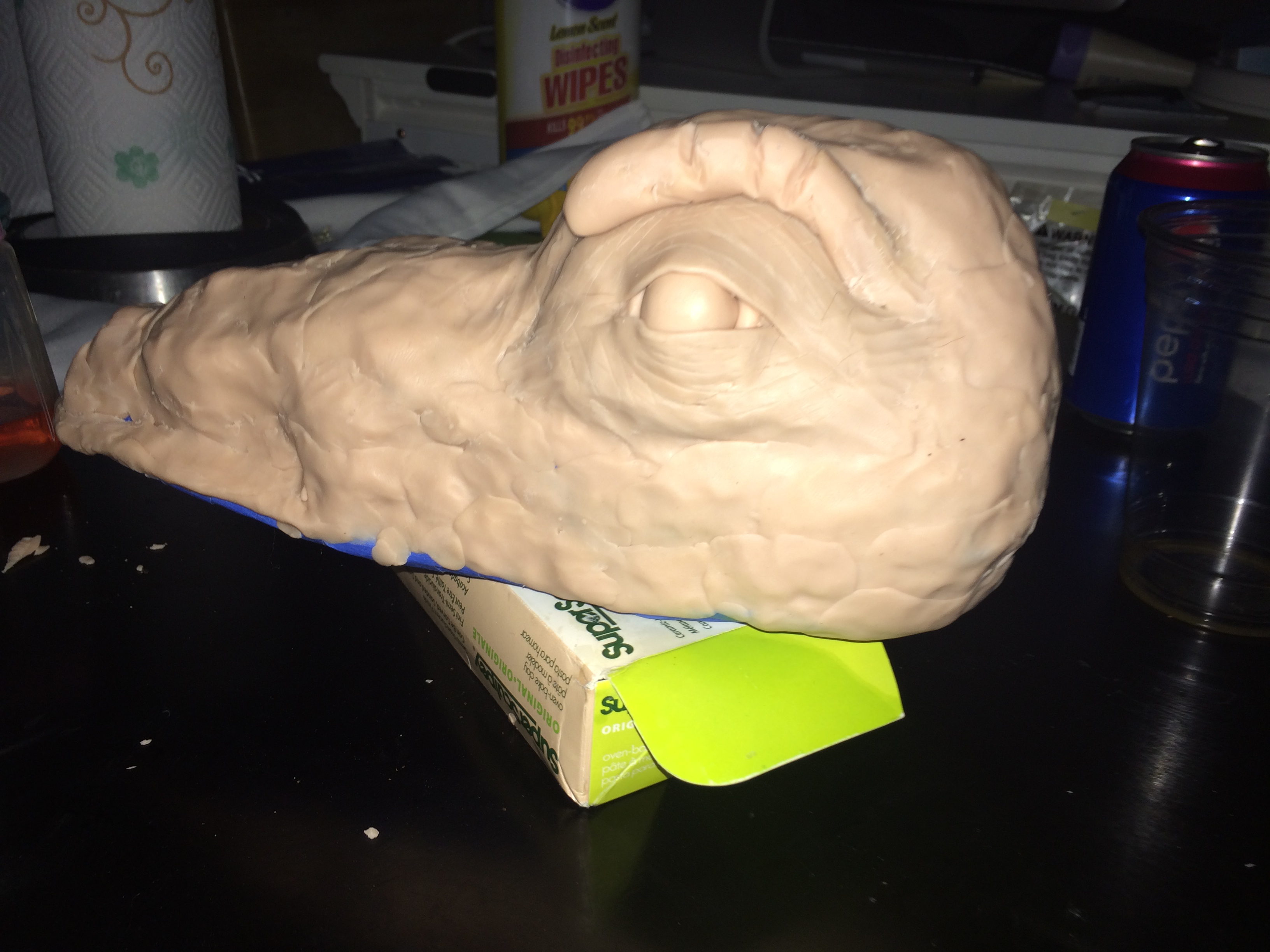

I have been Sculpting a long time and have 0 work to show for it because I truly had no Knowledge on sculpting. I am one of the those people that could get to a certain point then I wouldn't know how to get from A to B as it were. I recently took to YouTube and watched a few how to sculpt Videos and they might as well have been speaking Klingon, I just couldn't comprehend, so I changed up my curriculum. I started looking up how the tools worked and that started making since to me. my current project I'm working on is a Skeksis head bust. literally put clay to armature last night. I'm using Super Sculpey and an OK pack of wood tools. ( wood Spoons, a couple ribbon tools, a wood stylist tool, a small plastic rake) there is a series of videos from a sculptor on YouTube that worked for me. his channel is Polymer Clay Artist. his method worked for me so I'm try to piggy back off of his techniques. Best advise I i can give as someone also just starting out is keep in mind basic geometry (spheres, Cylinders, Etc) Best of luck!
