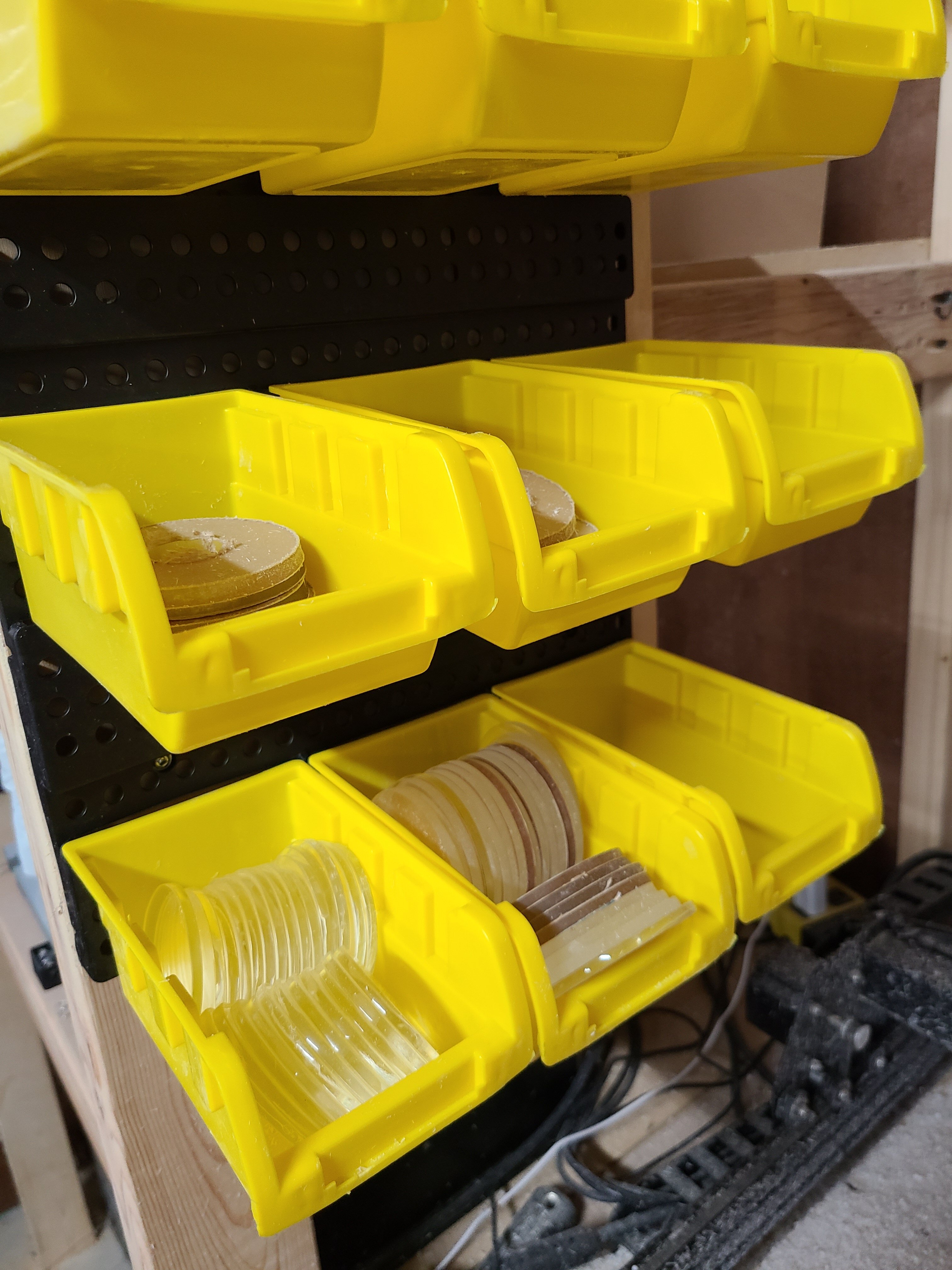

In general, each piece is milled on a CNC. There are three different heights I'm using.
So I cut everything out and just assign them in bins.

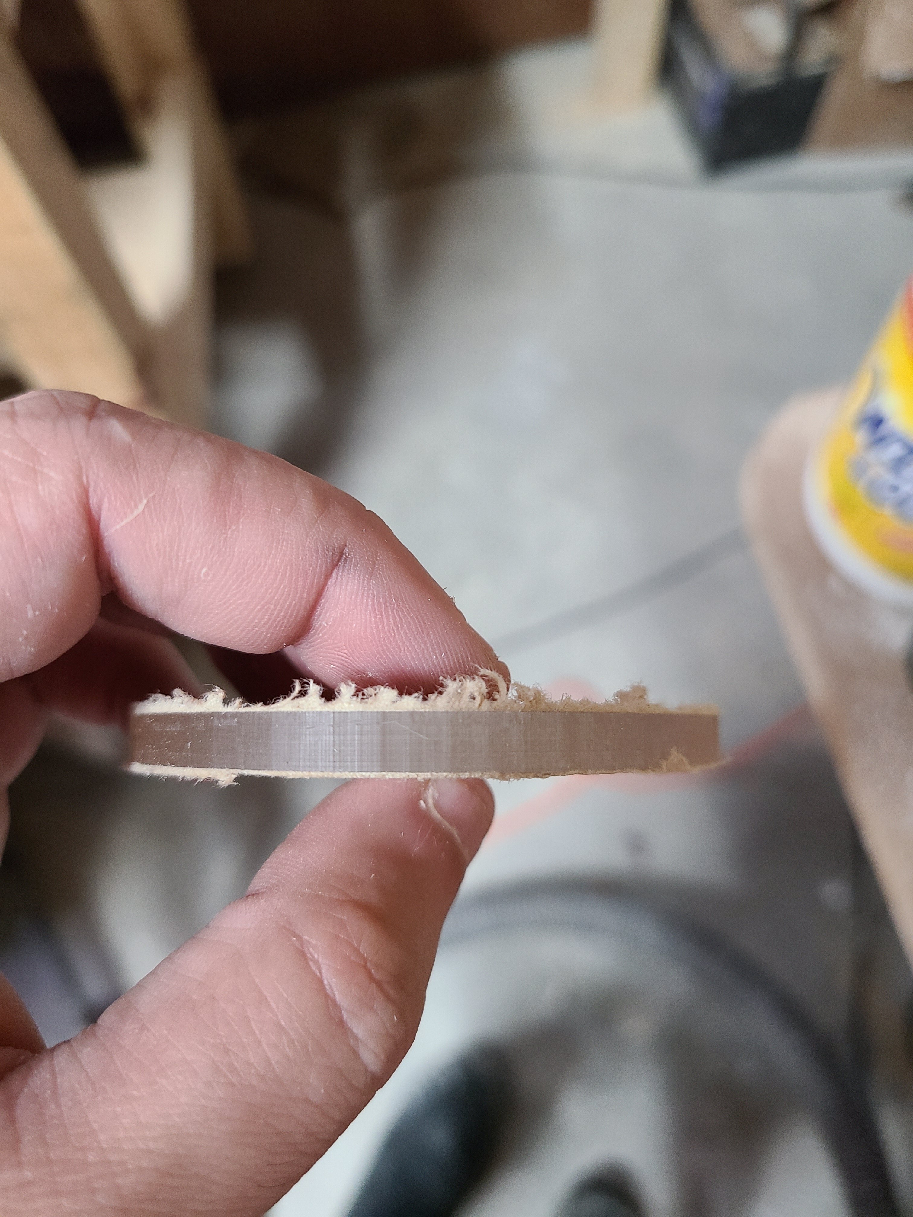

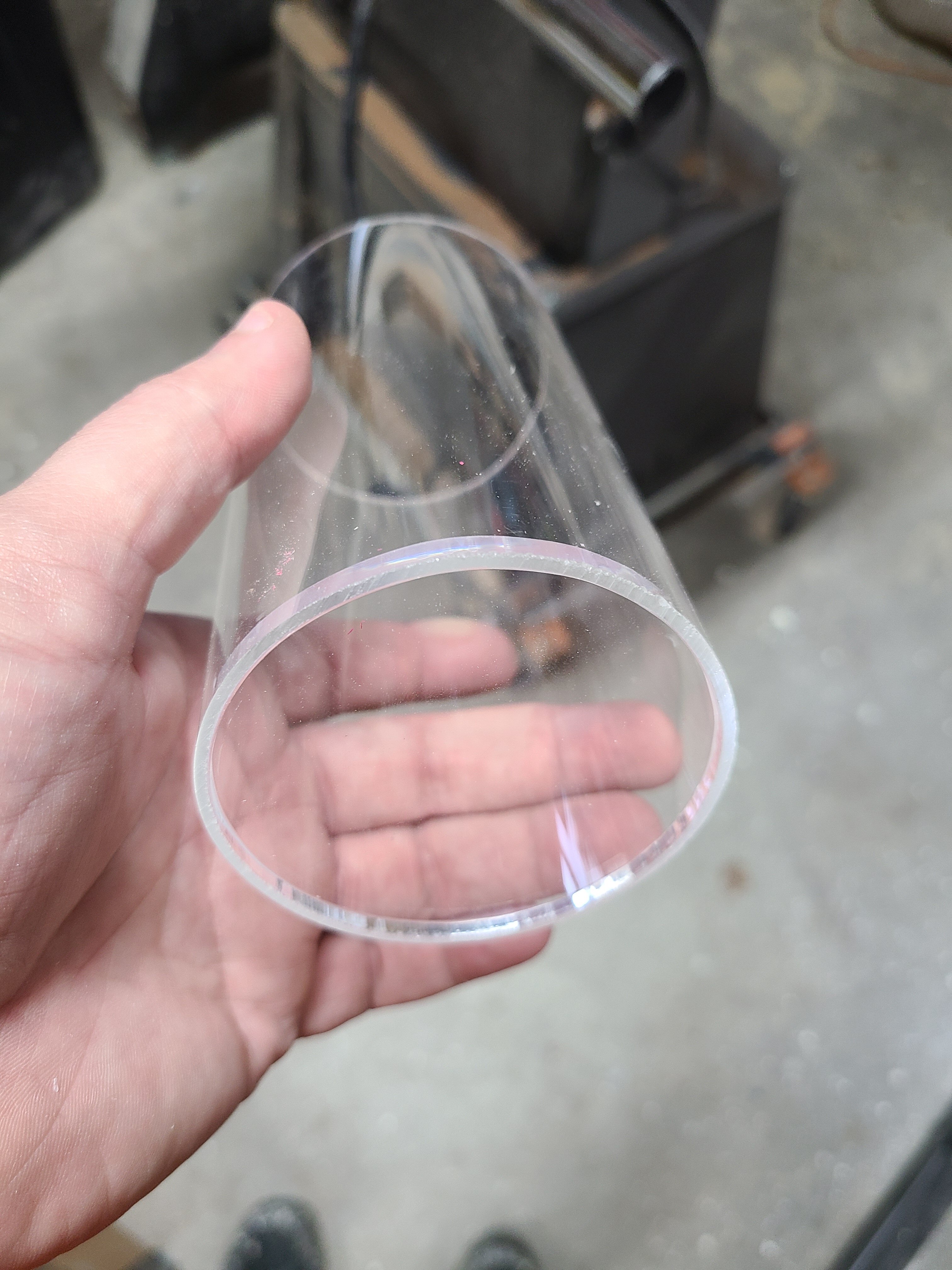

There are 11 bins that contain various sized circles. 7 for the top pieces, 2 for the pieces that are inserted into the top and bottom of the container and 2 different sizes for the bottom. They come off the CNC all looking like this:

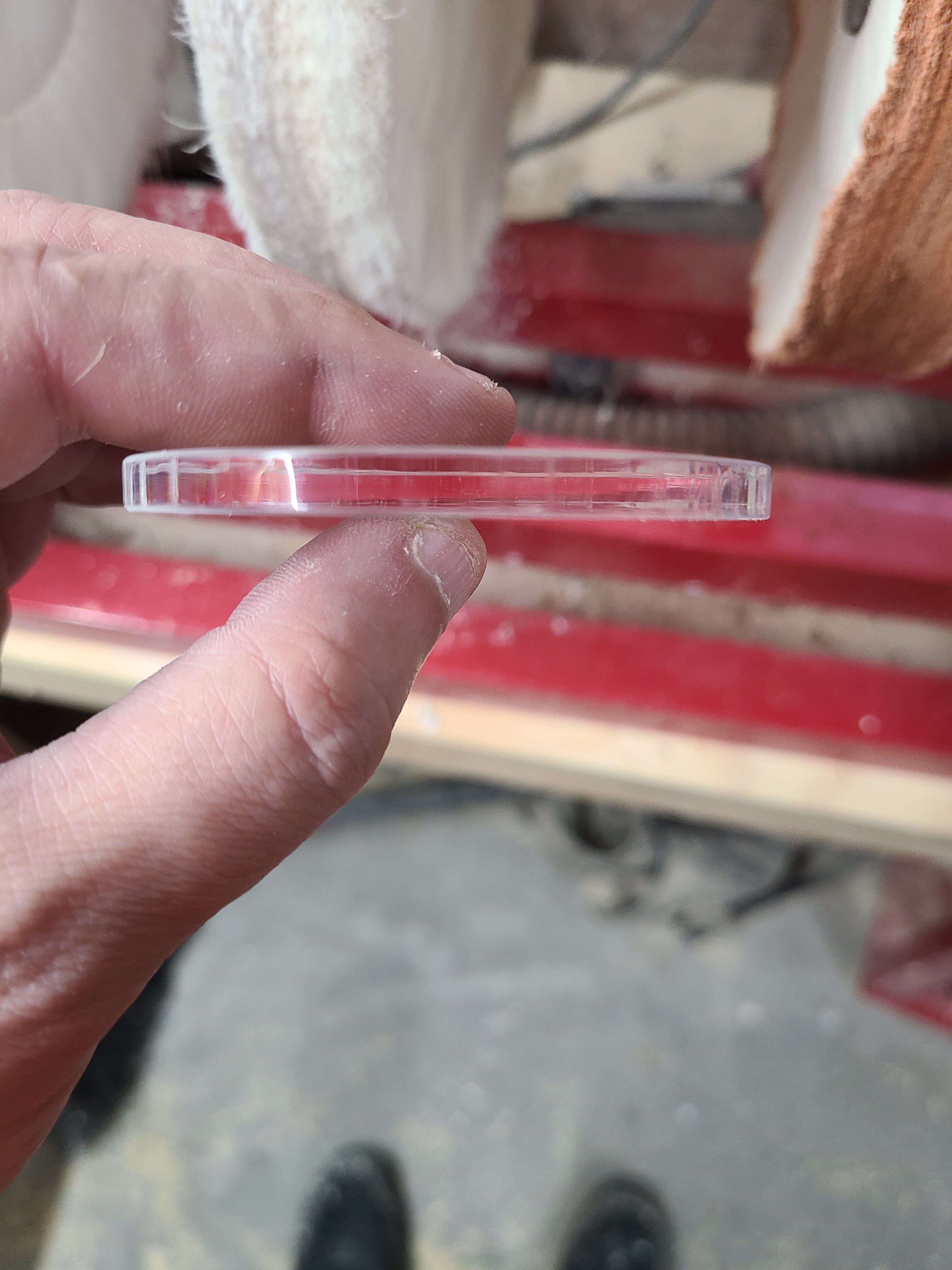

Next step is take them over to my polishing wheels. I use an old lathe for this. Side note, if you ever want to add a polishing wheel to your shop go to Amazon and buy just a crappy lathe. You can find them for under $100. And if you work with resins or acrylic you'll want one. Anyway, after a polish they look like this:
I fine turn it from there.

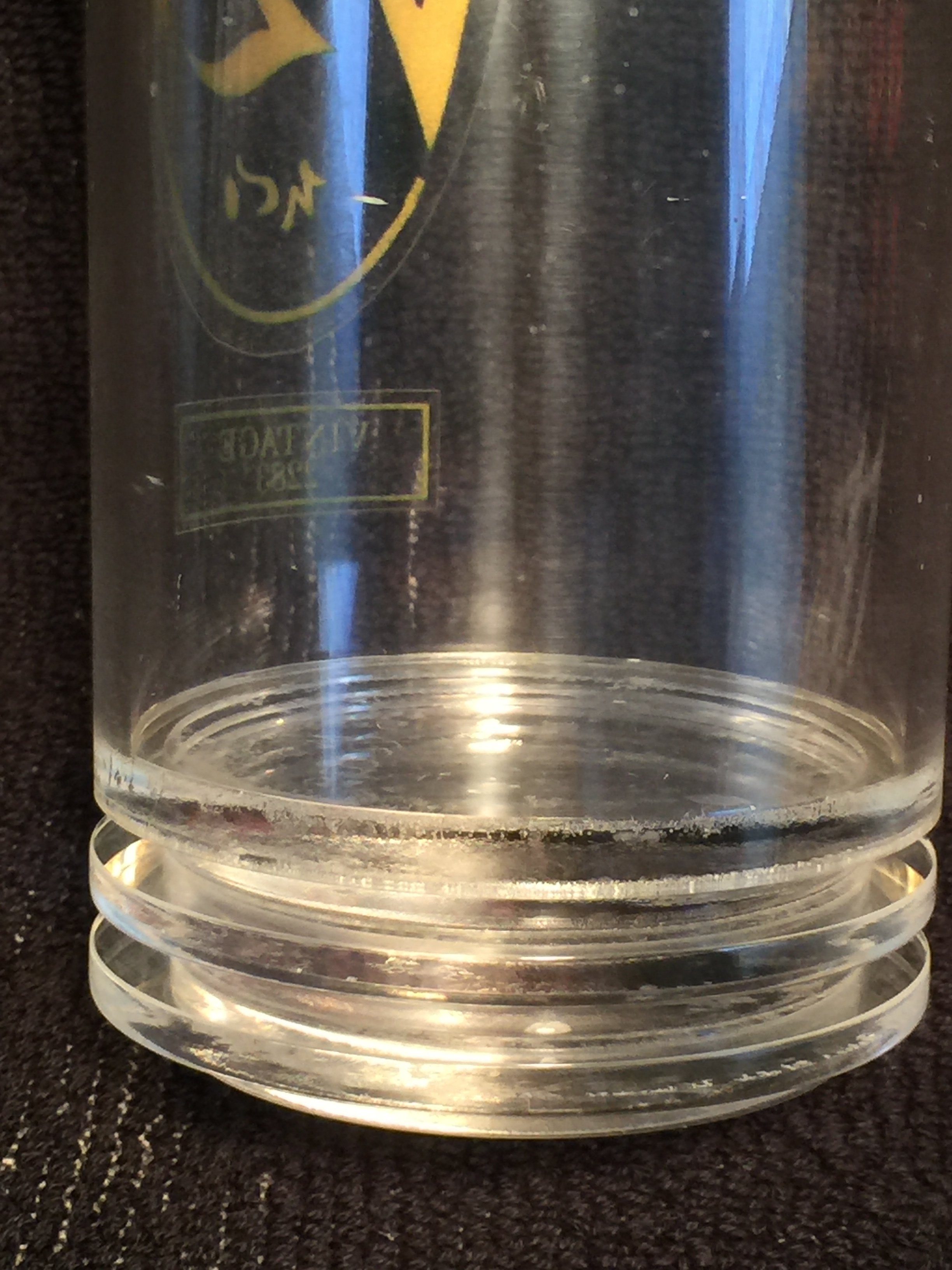

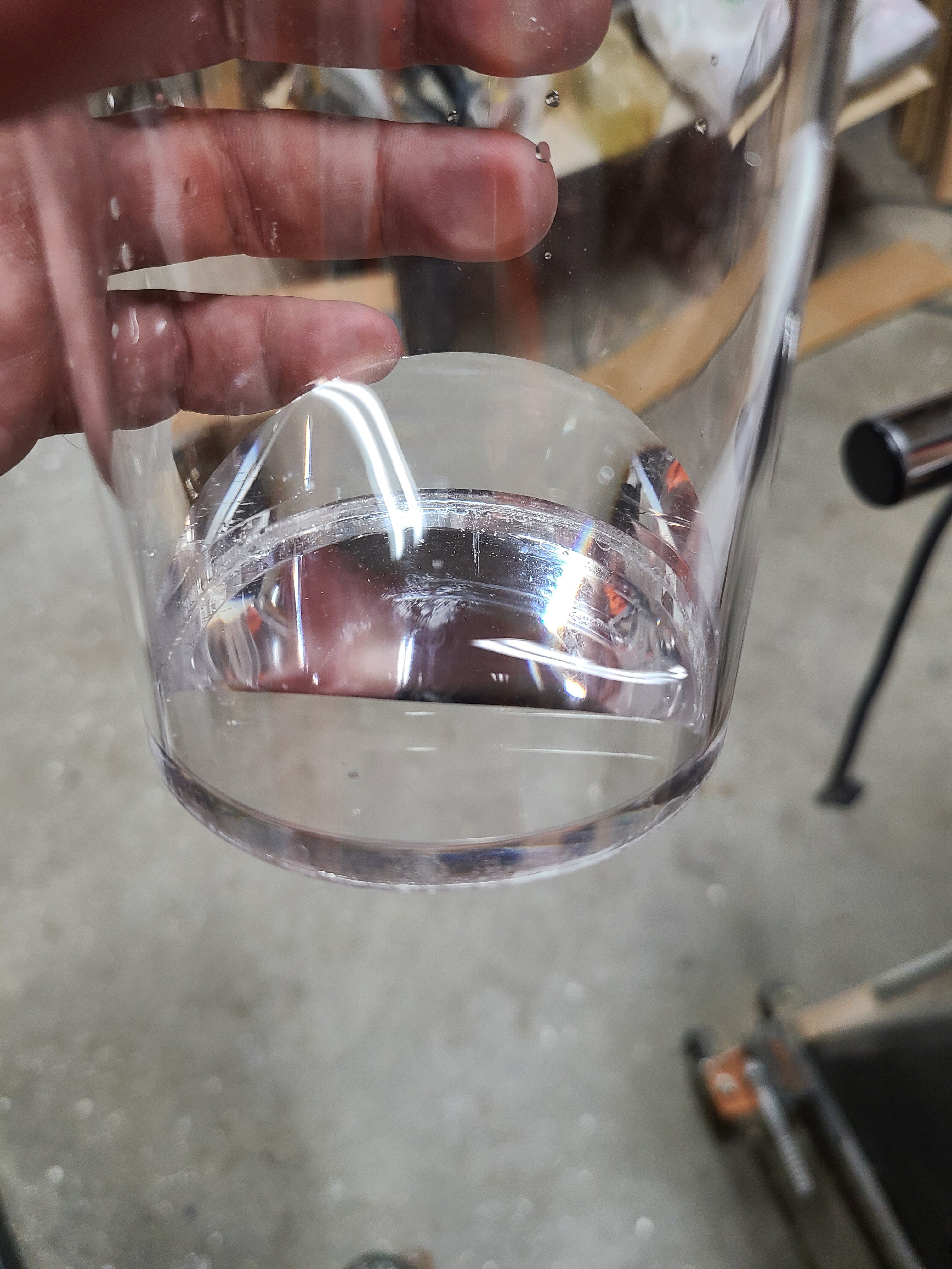

Next it's just assembly. The bottom of the containers I just snap in. It's a tight fit already and that's the way I want it. Then I seal it and wait.
Then I pour water in each one and let them sit to make sure the liquid is staying inside.

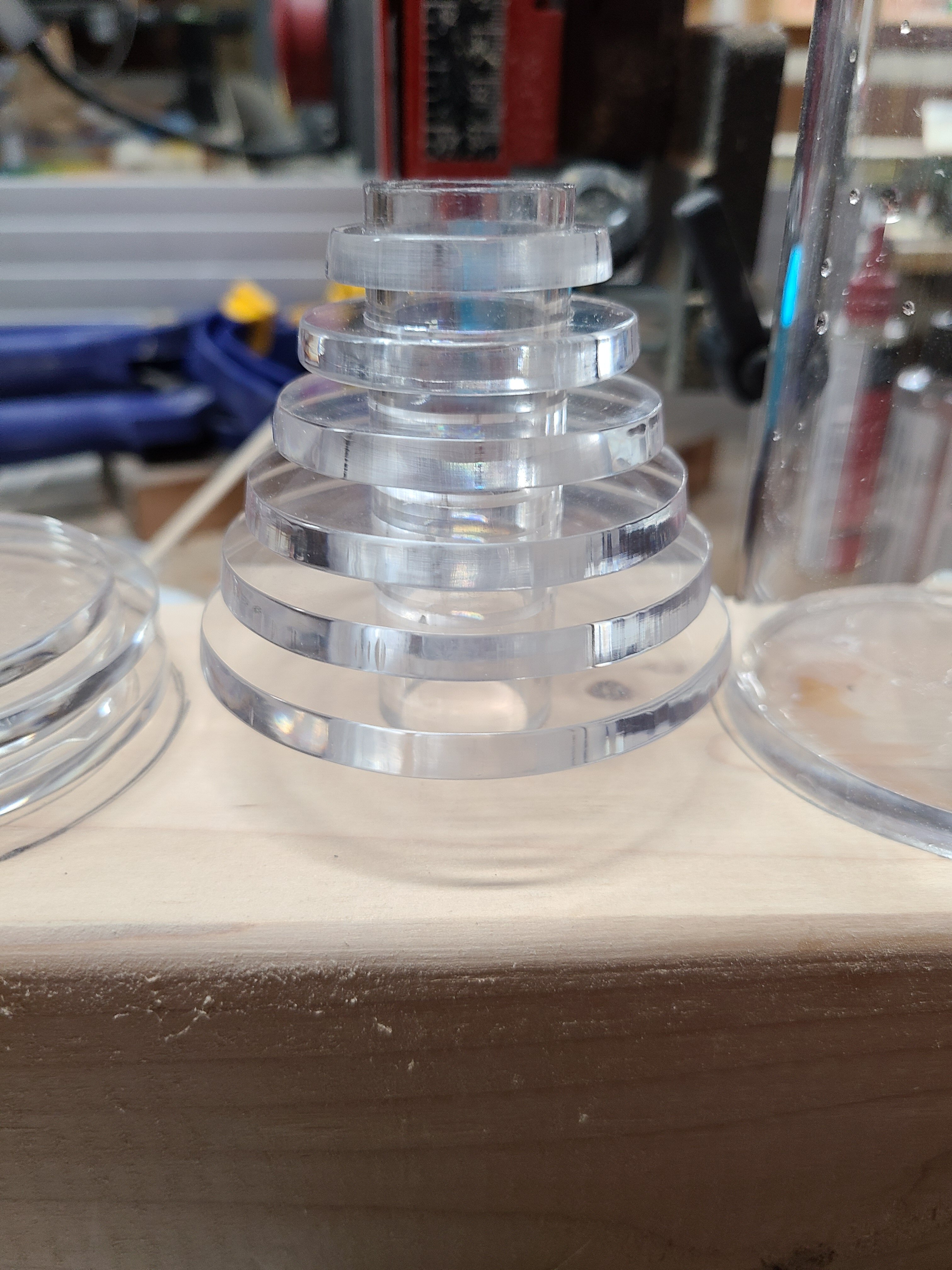

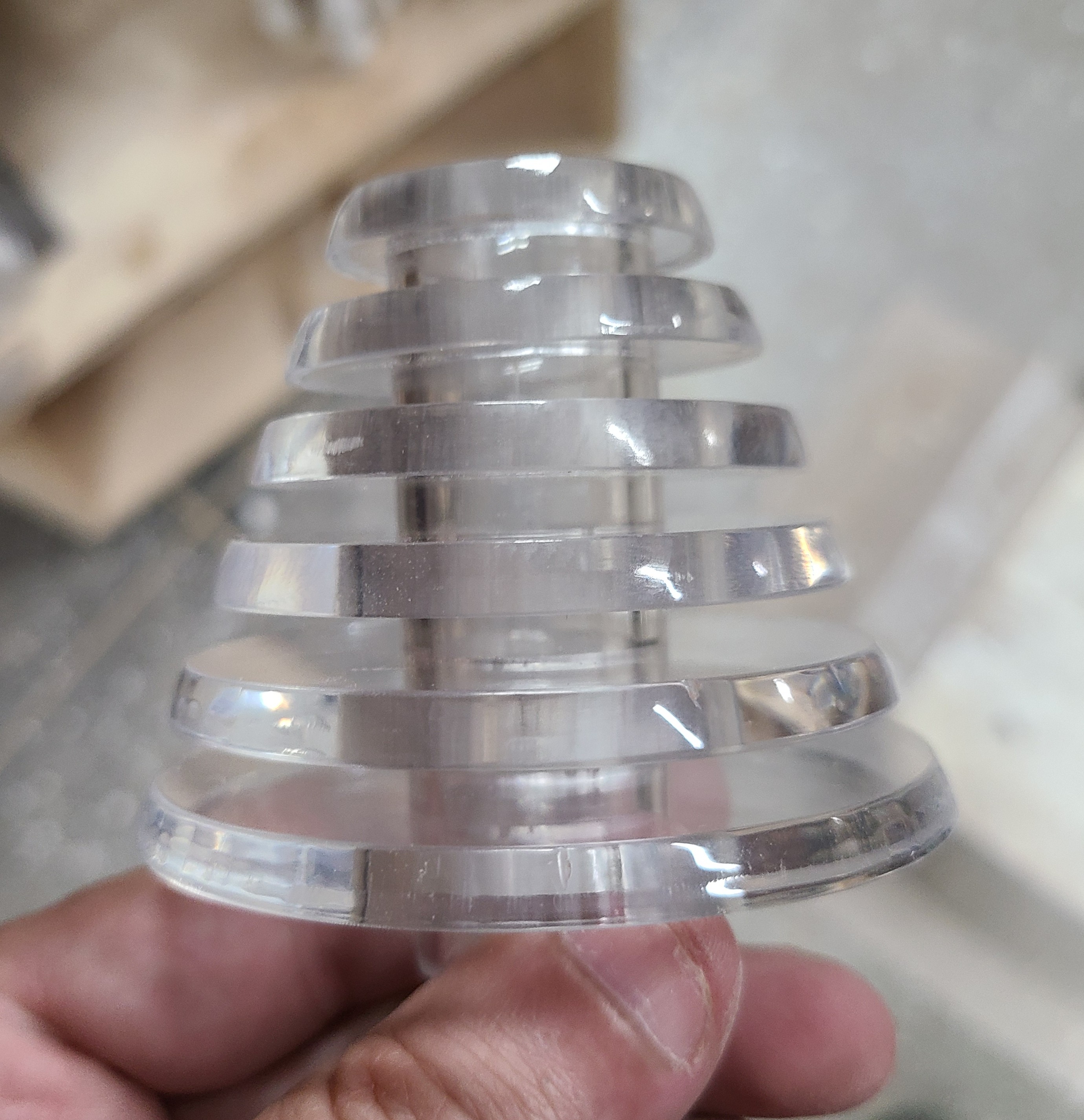

After that I glue the stand together and let that cure. Next I add the rings to the top. I have a piece of acrylic that I've made as a spacer to make sure the distance between them is right.
AND that's what I have done so far. These three sections are milled and the pieces are ready to assemble like this:

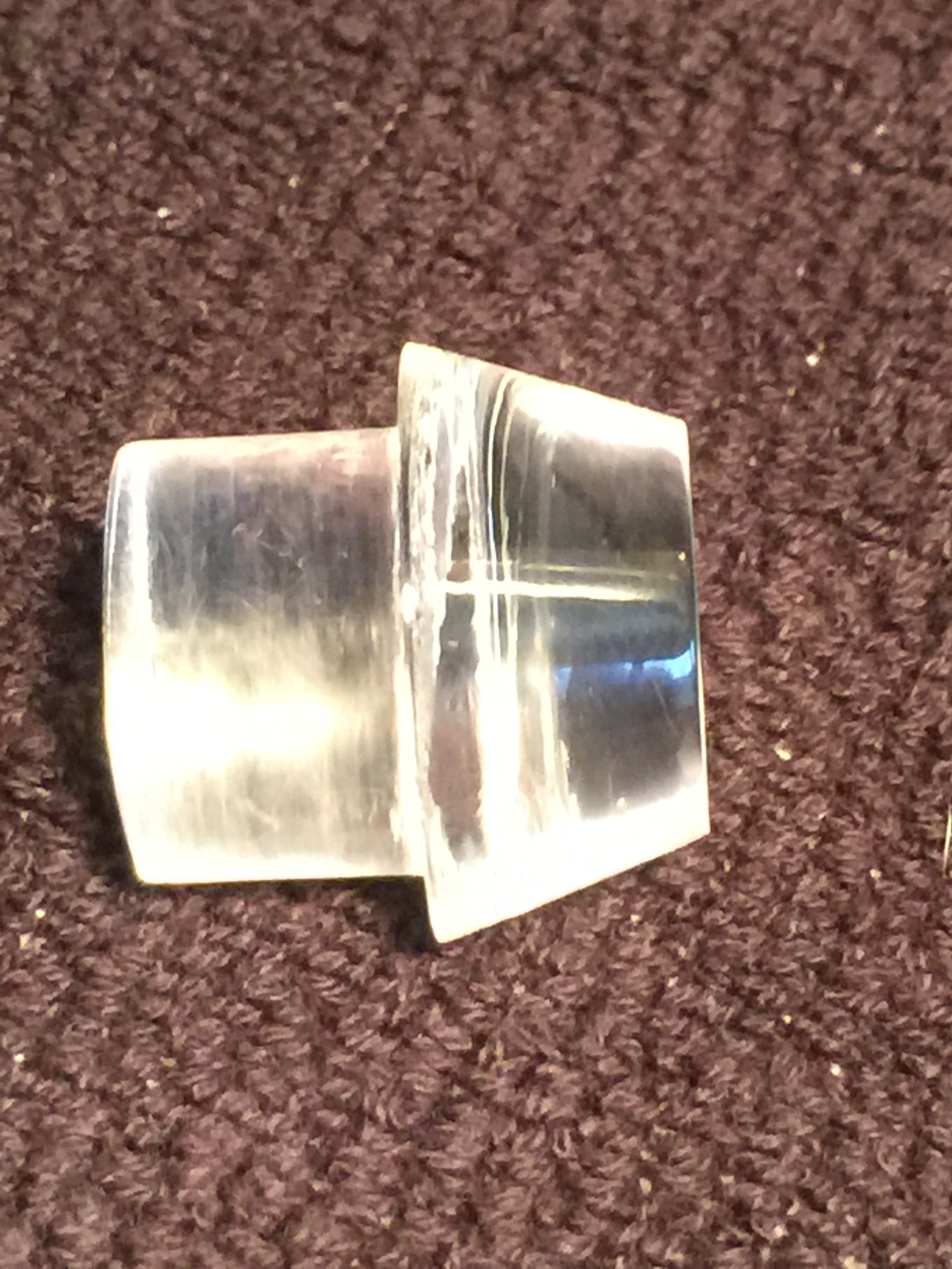

The caps and the small top ring (the one that skinnier than the others.)

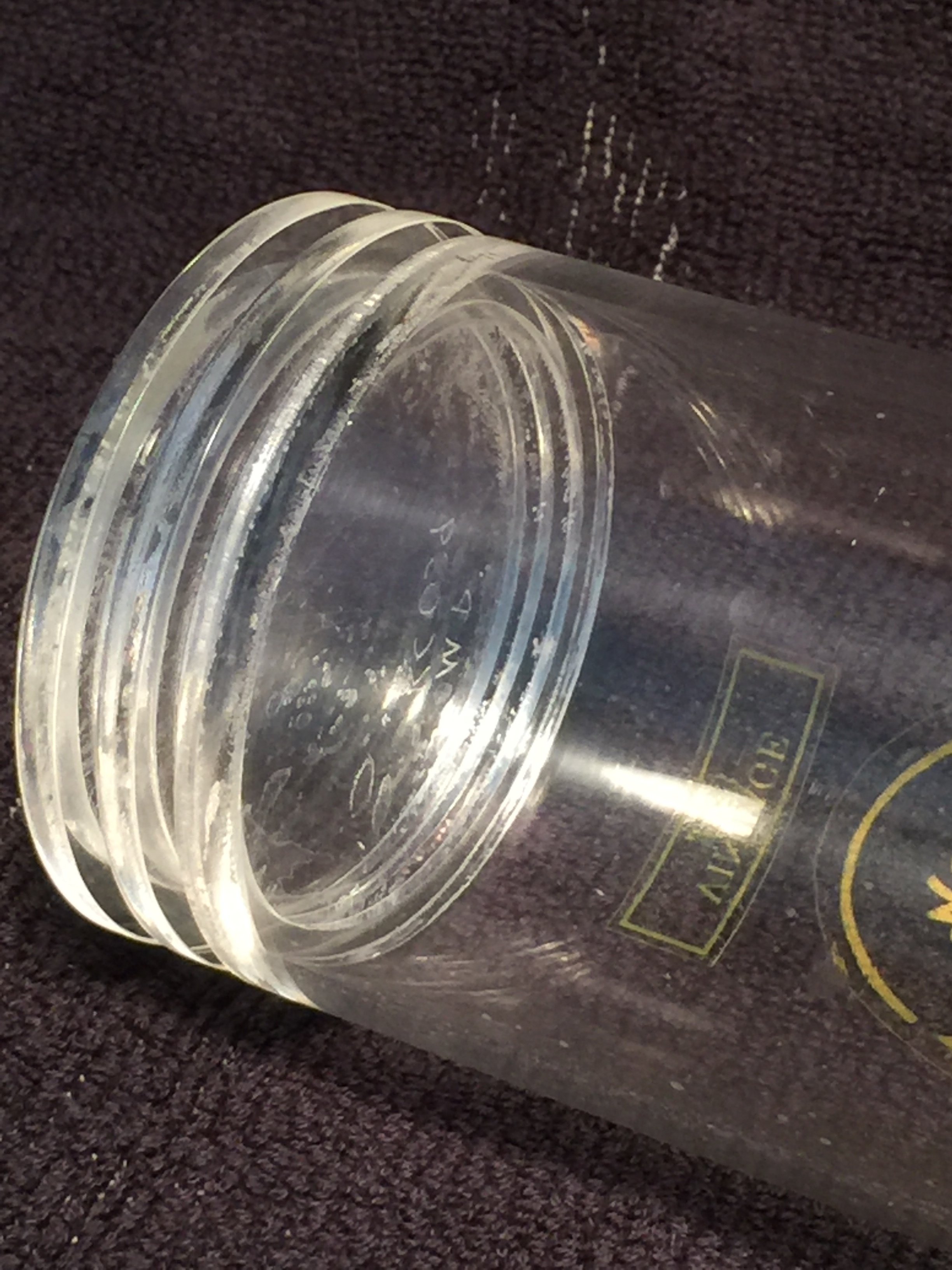

The sticker. I've tried two different ones and they look fine UNTIL you put liquid in the container. They then look cloudy. So I've ordered some more to try but if anyone has a suggestion let me know.

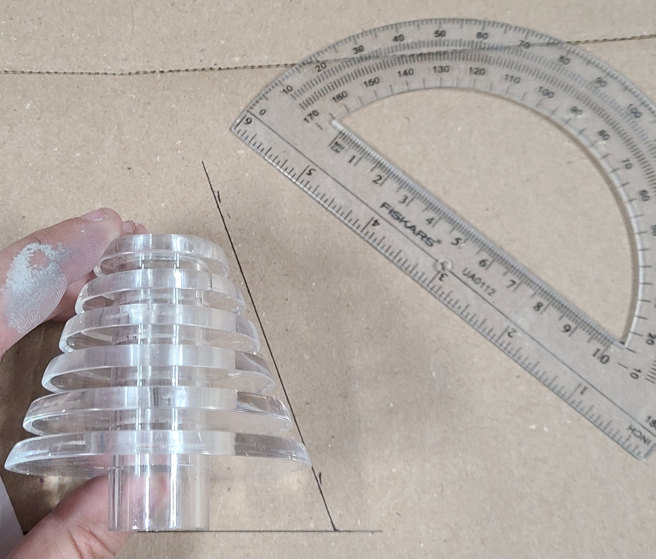

Are those rings not angled in this shot, or is it an optical illusion? I noticed on some of your prototype photos that sometimes the sides of the rings looked off in relation to each other. On this shot of the prop, it all looks very straight up the sides of the rings... I'm not sure what's going on there.

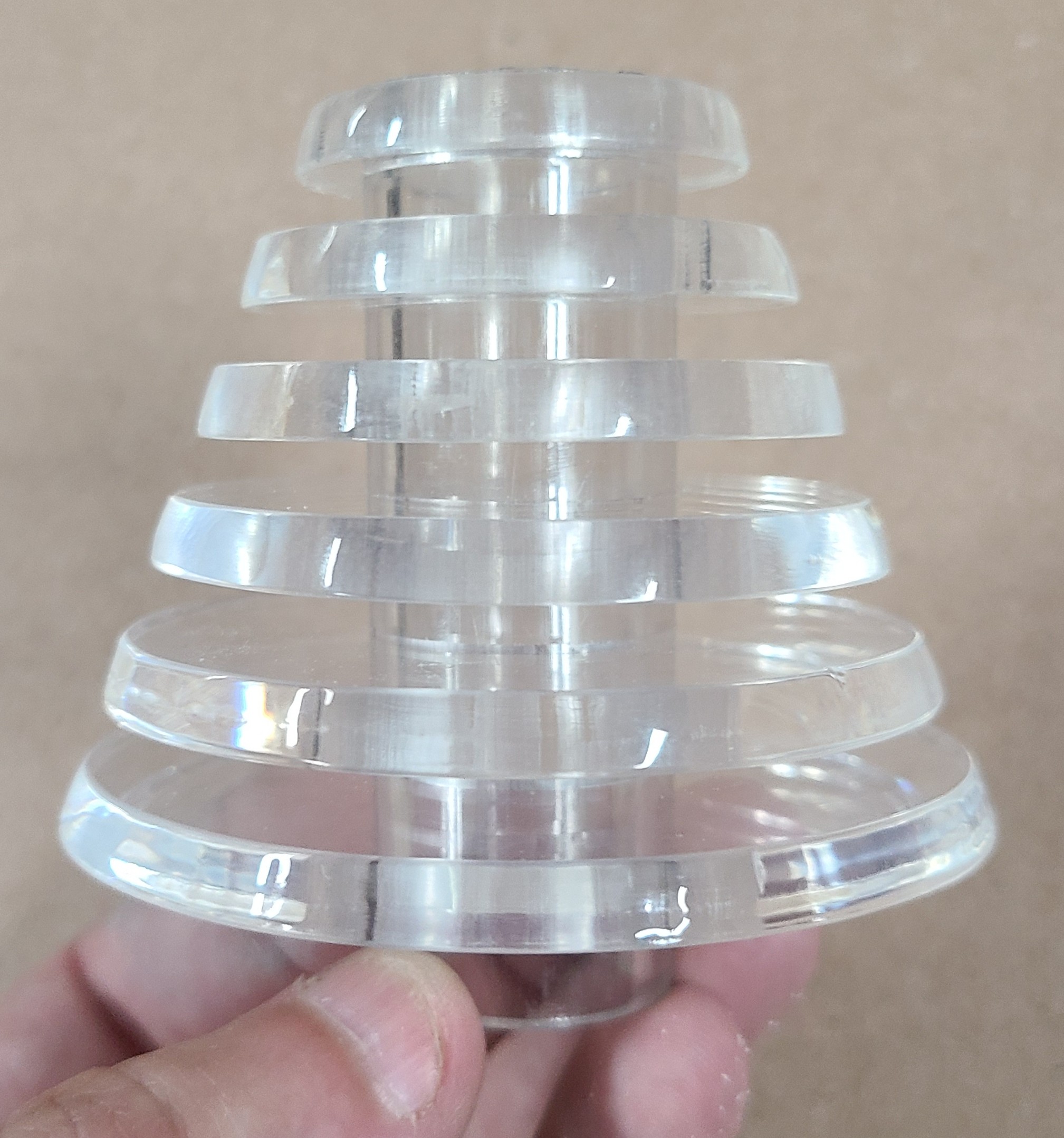

The rings are angles at 20° (its actually 70° but router bits go off 90° center). Ill post some better shots when I get back to my shop and update those pics. But it use a 20° bit on that cut.
Tried a show the angle here lol. Anyway, the line on the box is at 70°
Here is a better shot. These pieces aren't secured on there yet so it might be a little off kilter but it's pretty close.

I'm really sorry for the delay. My biggest delay here is the label. I've been trying a few different options but honestly haven't found one I like. So I order something new, try it, don't like it and repeat. Most of the transparent labels aren't transparent enough imho. But I have a nice gold vinyl now that matches the prop color that I think is going to do the trick. I also might try printing through my sublimation printer on transparent stock because that will create a better solid image.
