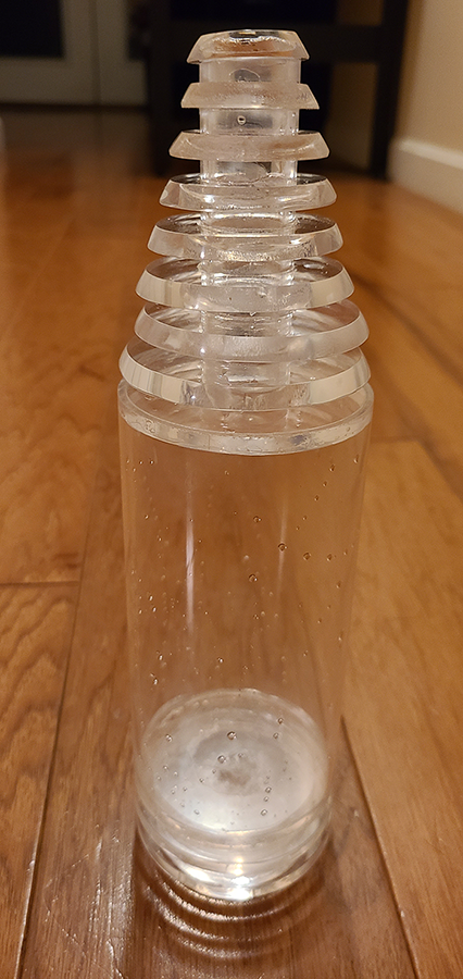

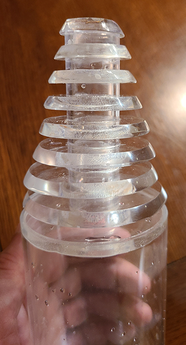

My first prototype Wrath of Khan Romulan Ale Bottle. This is my first stab at it so it's a rough take and not perfect. Next one I'll polish more to make it a keeper but I was basically learning as I went with this one and trying out new things. It's all cnc'ed clear acrylic and surprisingly it's water tight (i surprised myself with that one lol). I plan on making more to sell in the near future and will be adding the Romulan logo to this one next week sometime. Two things I want to change in the next one: I'm going to make the "cork" taller and I'm going to add a recessed o-ring so it stays put when attached. Otherwise it will be pretty close to this one just more precise and shiny. Learned a lot with with one to make others quicker and better for sure. I've seen other Romulan ale bottles but most haven't mimics the Wrath of Khan version where the top has spaces in-between the rings.
Dimensions: 10.5 Inches tall and 3 Inches wide

You probably have this figured out, but I'm going to type it out anyway. In addition to the original having a thinner ring on the bottom layer (3/16?), the gaps are clearly narrower than the thickness of the rest of the rings, you have them equal which makes everything look too tall. But if you make the cap taller and adjust the spacing to compensate it should be closer. What thickness of plex are you using for the rings?

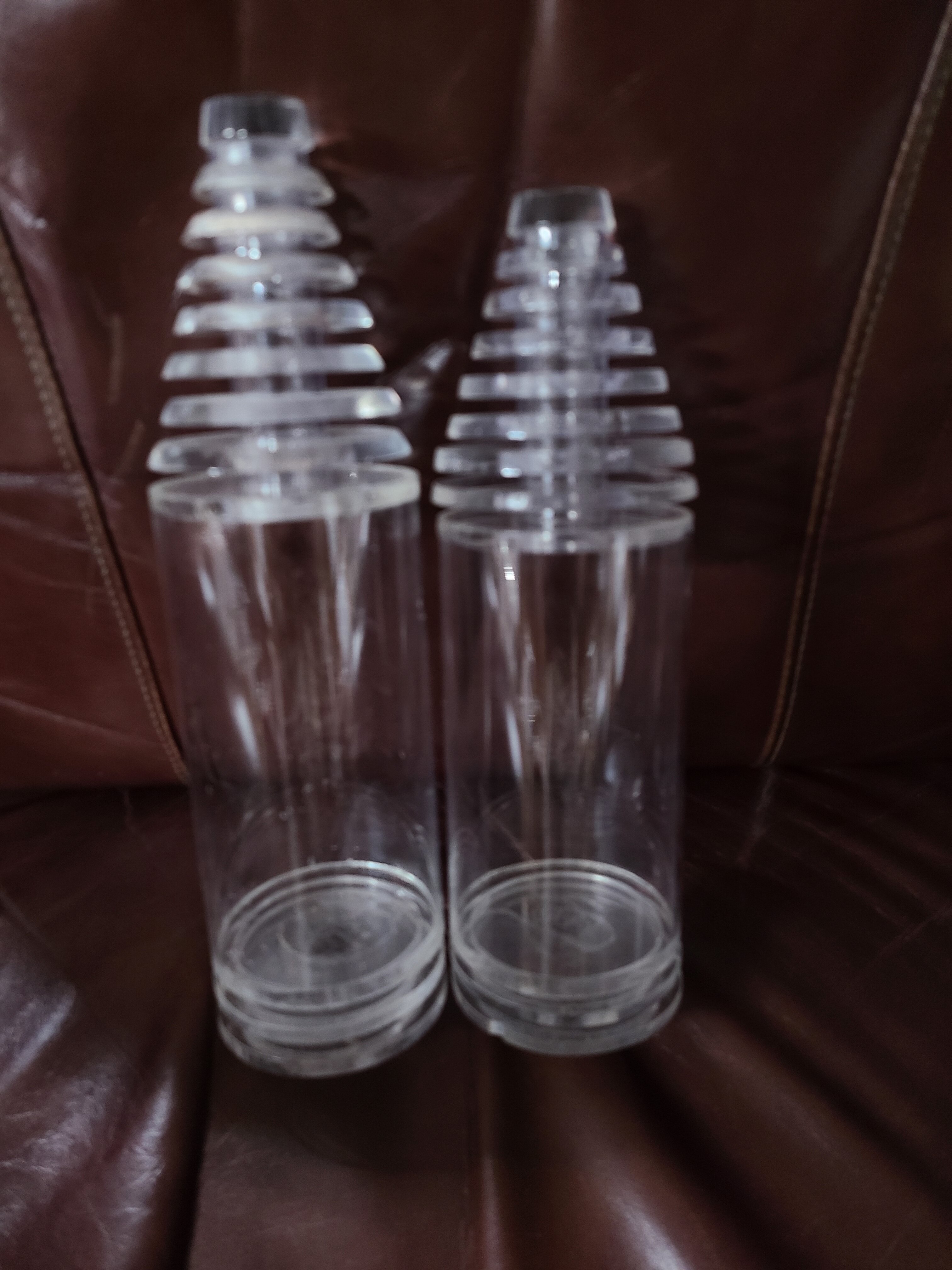

I don't disagree with you because it does look that way but when you you actually measure it it seems to be really close. BUT they aren't uniform:
I think like most props they probably just used what they had at the time. Or they might get gradually thicker as you go up the pyramid. So, I chose to go with .25 inches or roughly 6.4mm for them all to make it easier. To be honest I was more curious to see if I could do it because I hadn't worked with acrylic much and wasn't sure how it would turn out.
Now one thing that might be throwing you off is the angle incline. The original appears to be 70 degrees whereas mine is 80 degrees. I'll probably try and mill some out at 70 degrees and see how much of a difference it makes.
I'm going to work on some precision numbers tonight and see what I can come up with for the top (angle and each ring size/spacing).

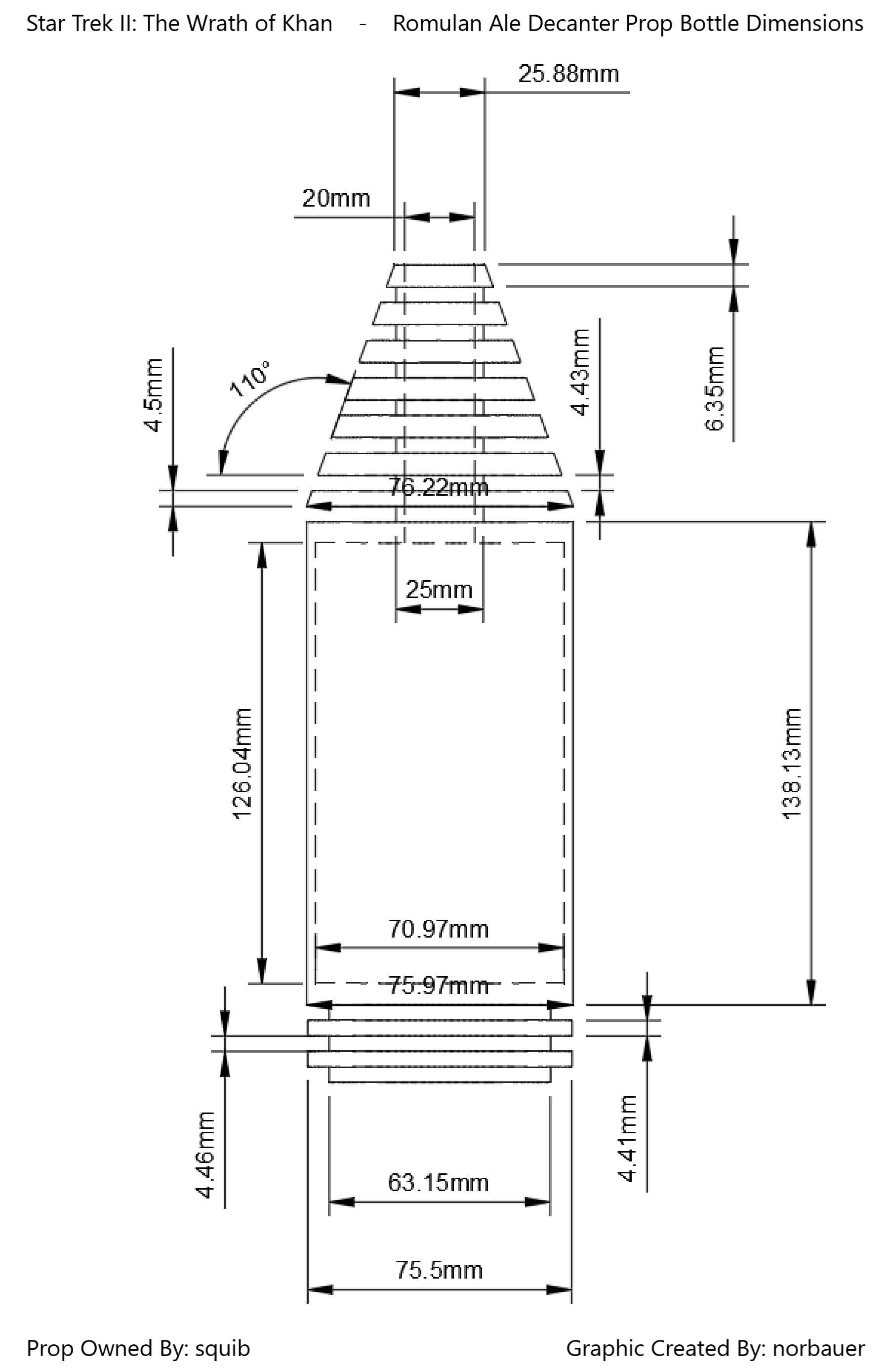

Hey guys, here's some documentation that I've got permission to share so you or anyone else can make accurate STII: TWOK Romulan Ale decanters. These dimensions were taken by norbauer (RPF member) directly off the screen-used prop that was owned by squib (I don't think they're a member here). The label graphic was also traced off the original prop graphic. There was going to be a replica released by Roddenberry.com but it didn't get past the prototype stage by the point they left the replica business. I'm just passing this along, credit goes to those mentioned above.

That's awesome. Thanks for the share. Those numbers are pretty close to what I came up with too. I'll share my drawing mockup when I get to my shop later.
