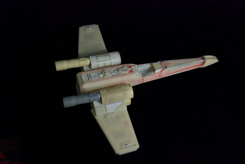

Always loved the X-Wing from Star Wars. But always hard to find kits in large scale to build to finish my dream. That's why I decide to build it.
Here is a new project I am starting few weeks ago. After collect enough information, I did prework in 3D ProE to finish the main body.
Then links up with my cnc to finish it. Just check following WIP pics to see my works.
After finish it(now the progress is around 80%), I would like to cast it into a kit.
So, please just drop me a pm if you are interested it.

Nice size and nicely detailed....love the movable wing idea.
Interesting approach. Your canopy is too tall and squared-off - that could benefit from a rework but other than that there isn't very much I'd suggest. It might be very well received if you can produce it cheaper than the existing high-end 1/24 X-wing kits. Either way, well done.

The engineering of the hull really looks to my like it is a mass-produced, factory-produced item, built and structured like a toy would be.
Were all the parts you are showing built wholly by you?
And if so what techniques are you using?
Well, it's clear a good deal of that is fabricated in styrene so I assume the remainder is CNC'd as Poseidon described. It does seem to match her 3D models. If she's using CNC then she can design whatever features she wants into her mesh I guess. The engineering looks pretty nice. Would certainly make for a new level of ease of construction in the X-wing GK world; I'm sure there's room for an easier to build, simpler kit. I'd love to know more too.
Hello PHArchivist:
Yes, all parts are built by me. You can zoom in these pics to see the most of details of surface are built by hands.:cool
Actually, using 3D modeling tools (CAD or ProE) and CNC machine to assist built works is very common to see now, not so special. Many guys announce their projects here are using same approach.
I use the 3D models and CNC to finish the hull and add details by hands. If I had more money, I will buy a higher-level CNC machine to complete all works.:lol

This looks really awesome. If everything fits, this could become the best thought-out garage kit. I´ll keep an eye on this... But please, as mentioned, make the canopy more flat. That´s the only "negative" thing I can find. Looking forward to more progress. Keep it up! :thumbsup
Hi Poseidon - okay, girlfriend was my second theory, hehe! There is a lot of good reference around these days for the X-wings. Stare at it until your eyes bleed is my recommendation! You may find other things you want to change and it's much much less depressing doing so before you pour silicone. :lol
Oh I had another question; if you are going to mould in silicone and cast in resin then your "pillars" in the fuselage will present challenges for bubble traps. Have you planned that out?

So would this eventually have everything molded on or included as parts? Or would this be just a basis for a kit, and we'd have to provide our own scratchbuilding? What would it be made of?
I'm cautiously optimistic, but it's just that it doesn't seem to fit the normal resin kit option, nor the normal injection molded plastic kit option, so I'm trying to figure out where this fits in.
