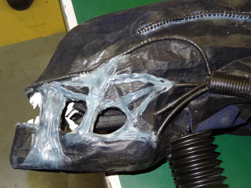

Whit the "shine" and the wet look:
The "transparent silicones turn "opalescent" and a little whiter.
I experimented a lot and taken a few ideas from car polishers. whit the had the best resoult.

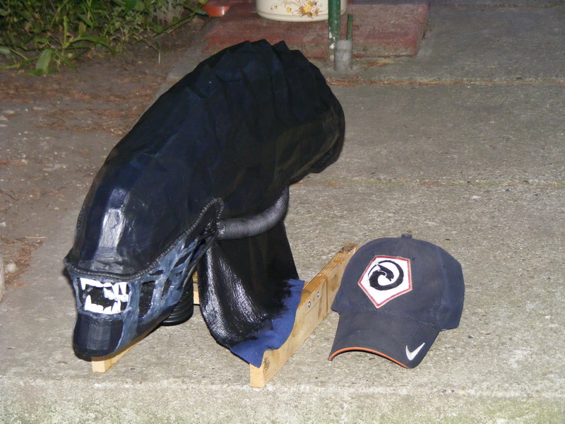

Whit very diluted and thin (transparent) silicone + coloring pigment (black + 1 blue + 1 gray + black agan) -> a LOT thin layers
I had experimented On the NECK -> 16-20 layers -> The pigments are "floated" and semi transparent -> whit this mutch layers the scin has a little "depht" and even so it only 1-2 mm thick.
will use the same technik on the rest of the head on summer.
