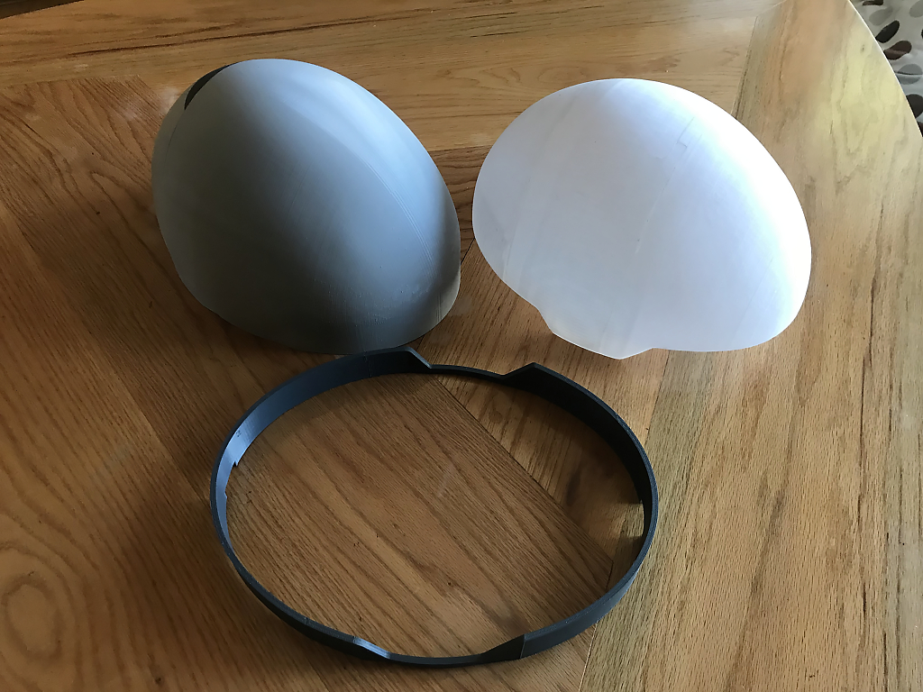

5401B1FC-9FAF-4C70-9B9A-A9A3EEECD7F9.jpeg C0B3FBDD-0447-40AA-91B5-07575FBCE1BB.jpeg Here’s were I am with mine thanks to my son, he decided that I hadn’t made enough progress and while I was out food shopping he glued the two sides on locked up my shed and I found these the following day...... the question I have now is two fold firstly the two back sections don’t meet do I try to fill this or secondly why don’t they meetdo I try to separate and work out a fix any help would be greatfull.

View attachment 1283571 View attachment 1283572 Here’s were I am with mine thanks to my son, he decided that I hadn’t made enough progress and while I was out food shopping he glued the two sides on locked up my shed and I found these the following day...... the question I have now is two fold firstly the two back sections don’t meet do I try to fill this or secondly why don’t they meetdo I try to separate and work out a fix any help would be greatfull.
Ouch...
So, Here's my input. You need to break them apart again. On my model, only the upper part is split and the idea is to use the metallic insert to help keep the sections fixed. If I were in your position, I would reprint the metallic insert again as a complete, break apart what's glued and fix the outer shell-pieces separately before attaching the lower metallic carrier piece. That, btw, does not really need to be glued but sits pretty good when just pushed in place.
Just filling the gap won't do you any good since then the upper dome-part won't fit.
