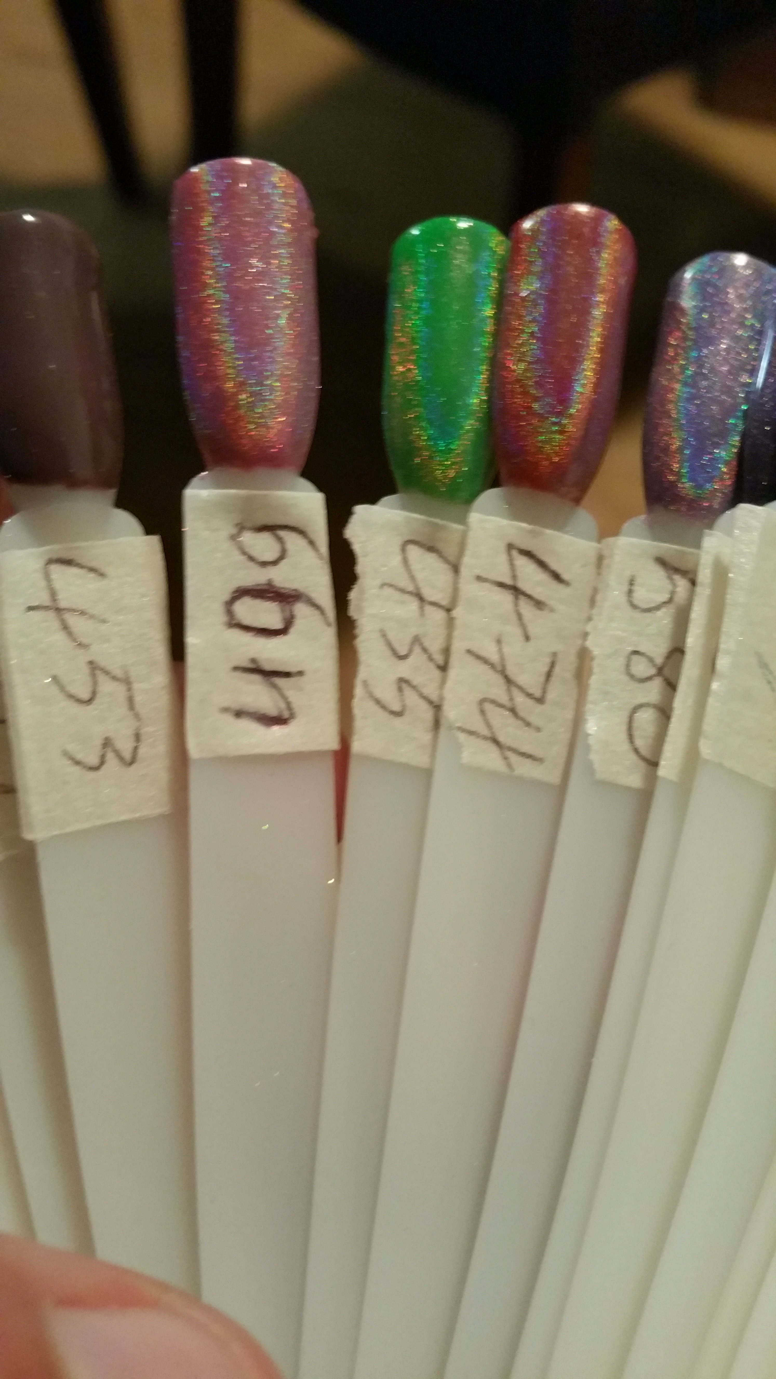

Guys and gals, I have a great new idea for chroming our pieces. My wife works in acrylic nails. She just got some metallic paint that is ridiculous. I am going to post some of the results soon. I am blown away. She is getting a metallic affect from one application. 14908989442702063517245.jpg1490899097526-368884771.jpg
I find this method she uses incredibly effective for creating a metallic finish in controlled settings. Under uv light, it has less effect. I will help you guys more on the process if you would like to try it. It is extremely cheap, and a great way to build certain items, like Aliens.

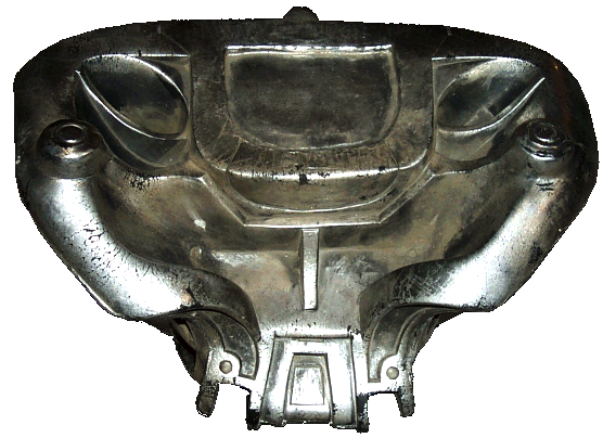

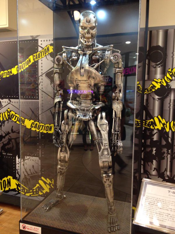

Hmmm maybe your right. I've always heard T2 was the same and the surviving endos sure point to it. The following is a T2 endo (even though it has T1 shins.) first pic during filming and second pic nowadays. It exhibits vacuum metalizing aged characteristics. I have many close up shots of the plating rubbing off or chipping and fading. The third pic is a T2 hip that shows similar signs. Also they were actively vacuum metalizing all the T1000 bullet hits and other props.

I can only go off of what I have been told and what the people who made the film have said. As far as I know about the process, the pieces were painted with a copper heavy paint and then electroplated. There are a few steps in between there, but essentially they were plated. Shane Mahan's quote also points to this. Adam Savage actually claims in his T-800 video that his replica was plated at the same shop that plated originals... the evidence towards plating, at the very least in T2's case, is quite solid to me just given the fact that everyone who worked on it refers to it as plated and being a "different" process than what was used on T1.
The T-1000 pieces and bullet hits that were vac metalized were rubber. You can't plate rubber, as it would crack and fall right off.. and back then they didn't have Imperiflex. ;) It's no surprise that they would plate the T-800s and vac metalized other pieces.
