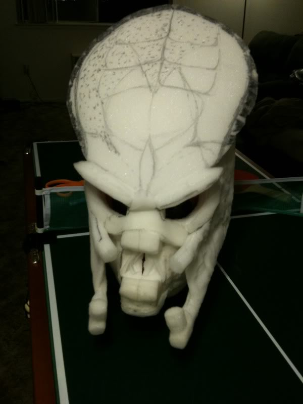

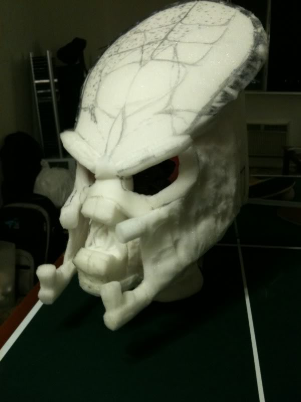

So I decided to try and make a wolf mask for now until I can convince myself to buy a mask on the board haha.
Anyway, I went with the foam method I saw on youtube by a member here called predattack.
here is what I have so far. If you guys want step by step progress pics let me know and ill post pics on how I got to this pic :p
Right now im working on mouth details then mandibles :mad:
I'm HOPEFULLY going to be able to finish this before Halloween, I'm trying by the 15th but I doubt that will happen. anyway ill continue to post progress when I can :D Thanks for watching!

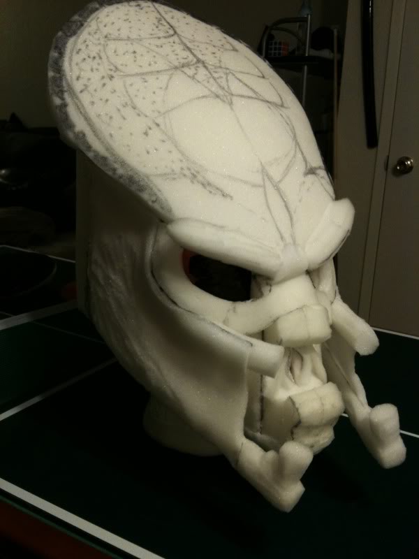

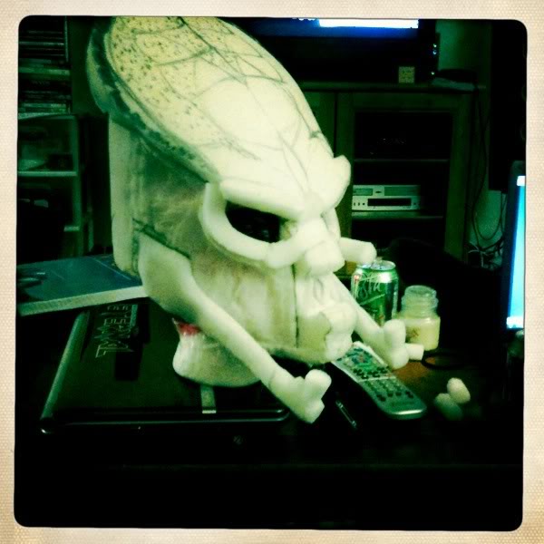

ok so i have progress.

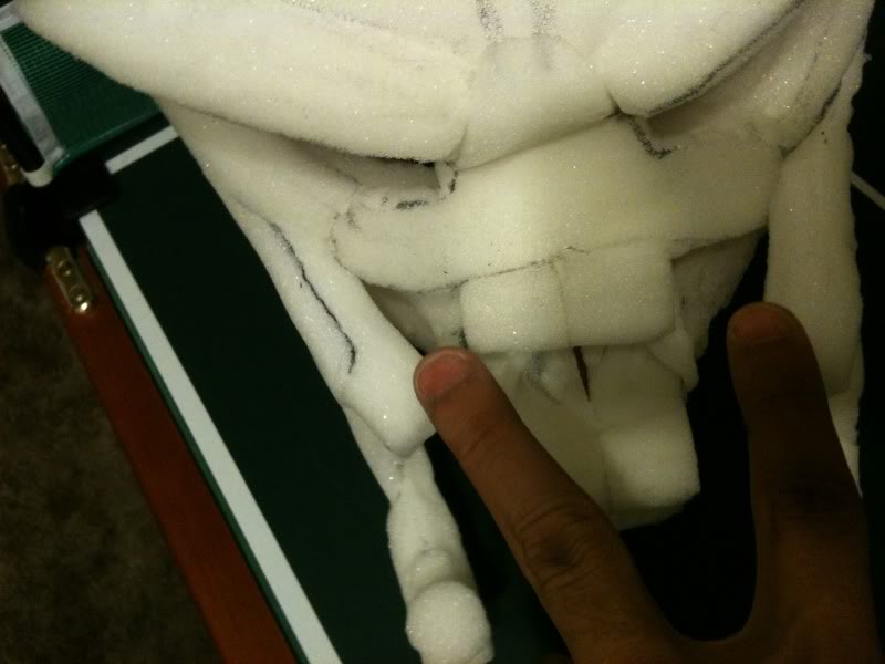

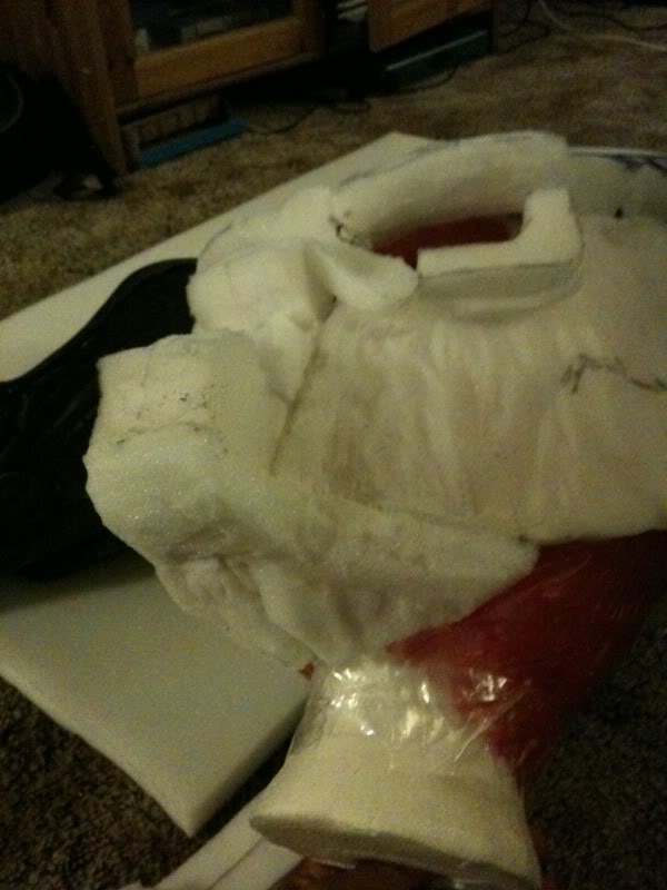

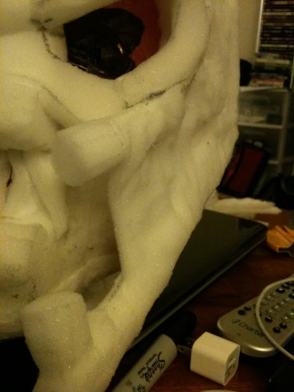

i added the chin piece (which ill add onto later to the neck)
here i have added a mandible
and here is the other side
heres how it sits on the chin

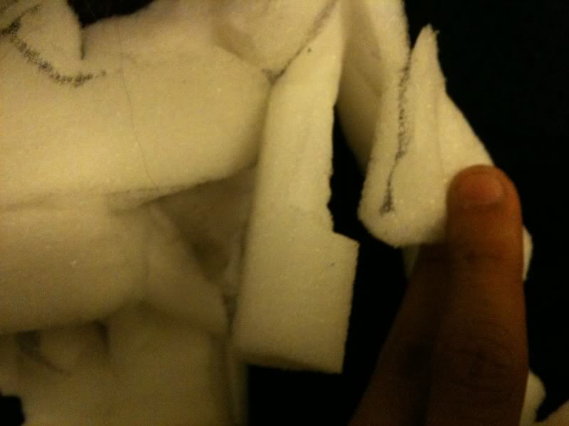

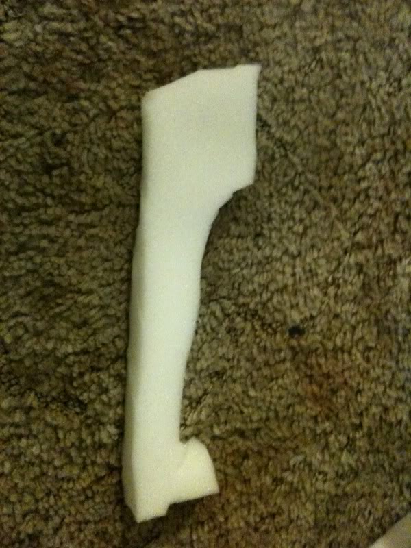

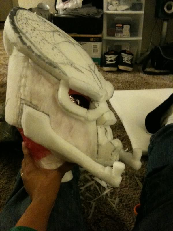

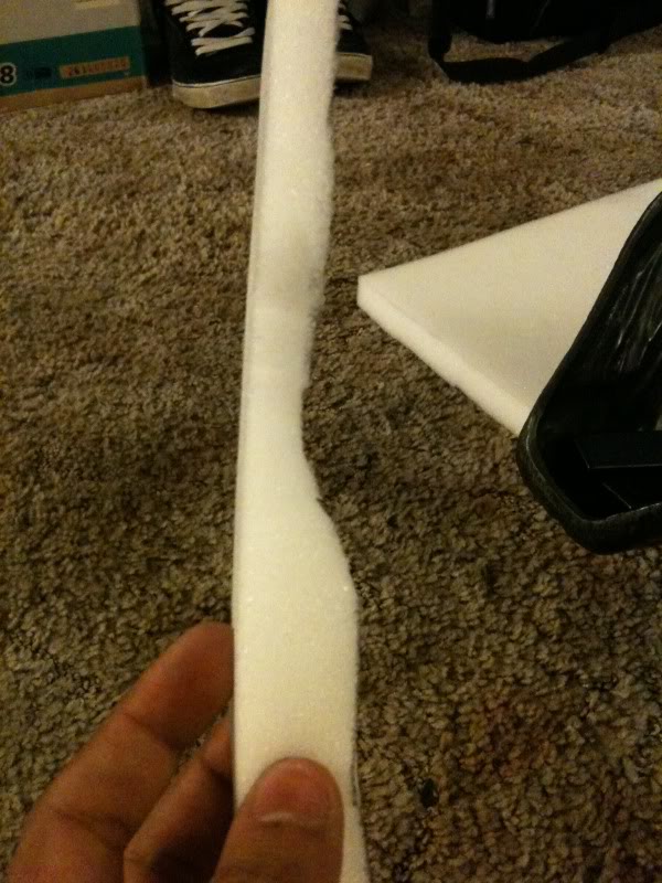

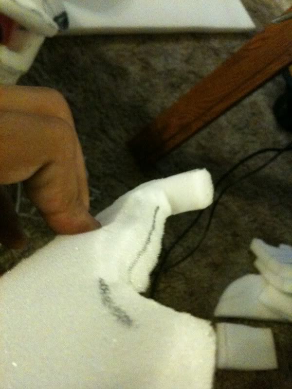

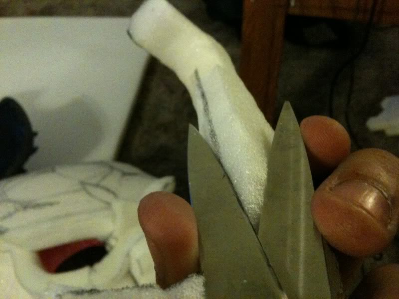

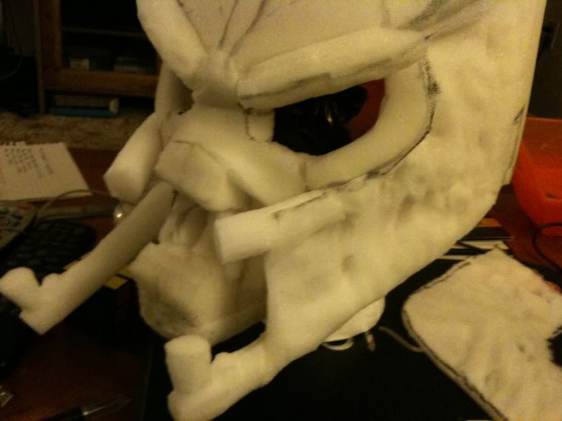

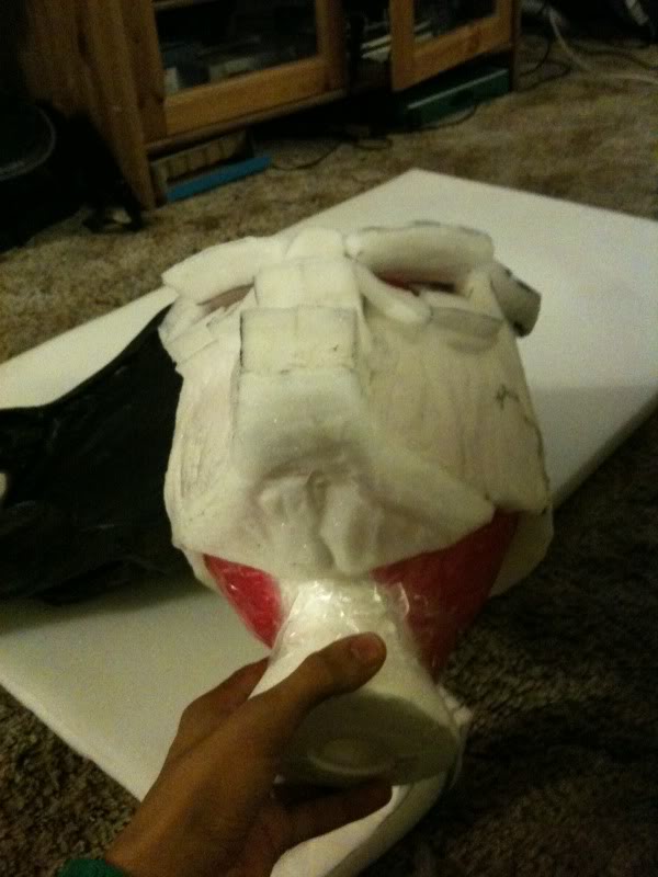

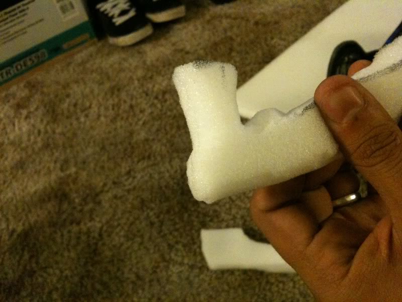

btw I shape and cut everything on this mask with scissors. here's how I shaped the mandibles round
It starts out like this
and heres the shaping with scissors
heres an ok pic on the progress of rounding

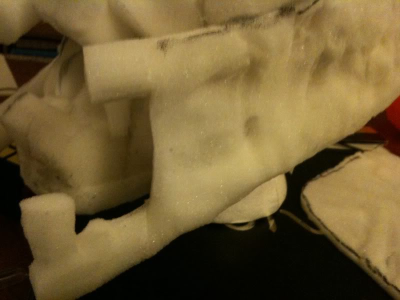

so after you round it, i cut it on the inside so that it sits on the face more flush and doesnt "bulge" the foam

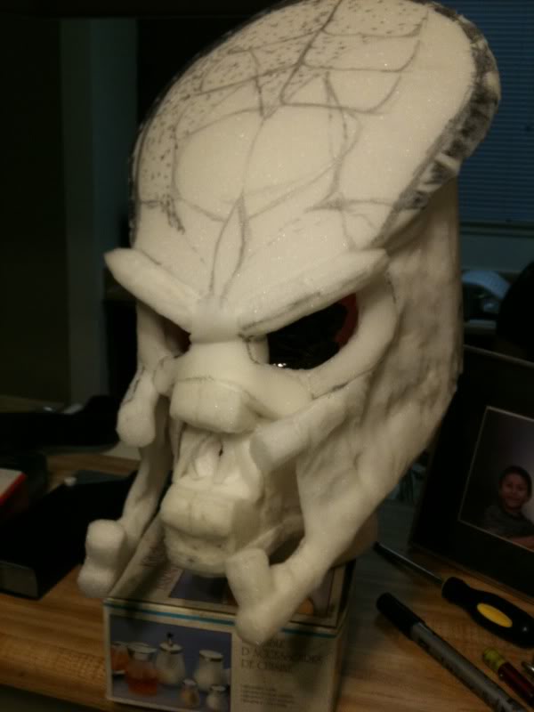

heres how its looking from the crown down to the mandibles, the angle looks pretty flat and i believe correct. It sits in Caseys wolf bio perfectly
and heres my favorite. my gf took a picture of it with an app on her iphone. it looks awesome! (you can see me starting the upper mandibles also)
forgot to mention this is what im using to glue everything. its the only thing that had foam on the can haha

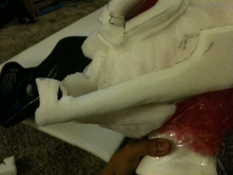

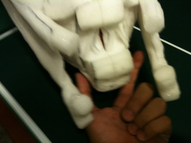

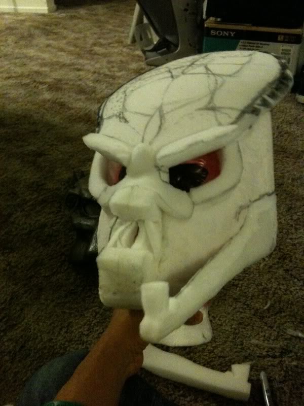

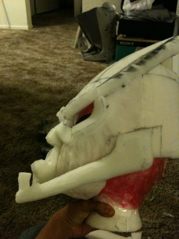

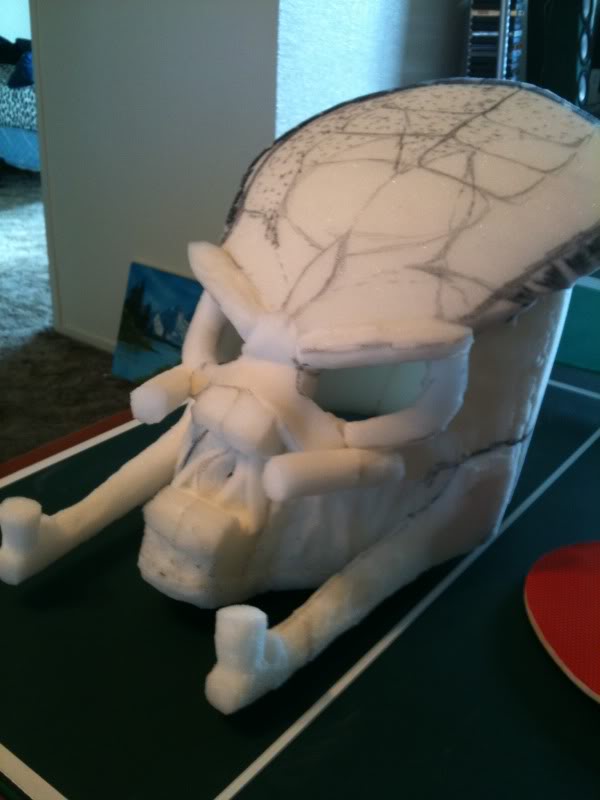

Here is the upper mandibles added (i decided to keep both mandibles on my wolf, but still have the messed up face)
i cut a really thin layer of foam and added the skin to the mandibles. i cut the thin layer with a hobby knife (xacto blade)
here is how i cut the mandible to compensate for the thickness of the skin so it sits flush
the finished look

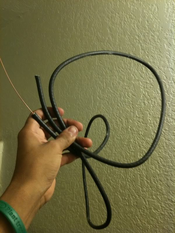

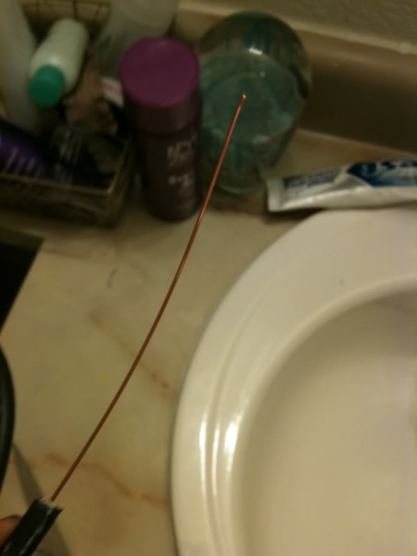

next i added copper wire

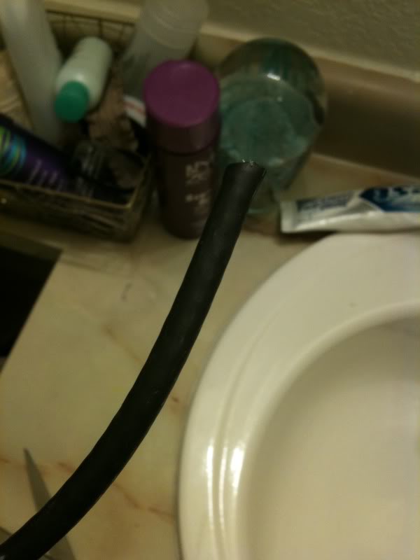

found in coaxial cable. (i got mine free from some charter guys that worked on my house and had some scrap they were throwing away)
This allowed me to maneuver the mandibles to closed position
Which allowed the mask to fit even more perfectly
Here is some videos on how to strip the coaxial and cut the copper wire

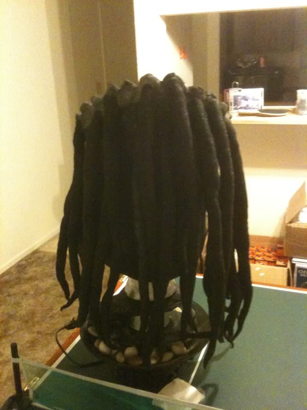

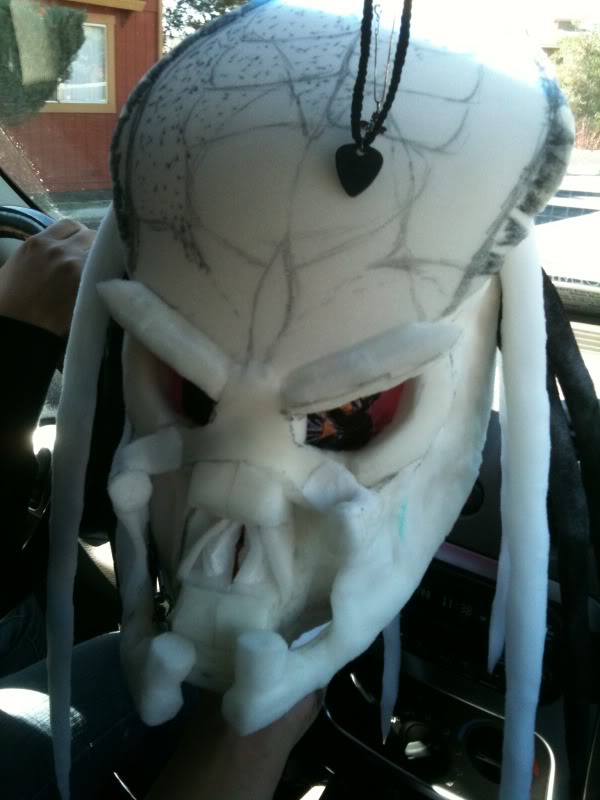

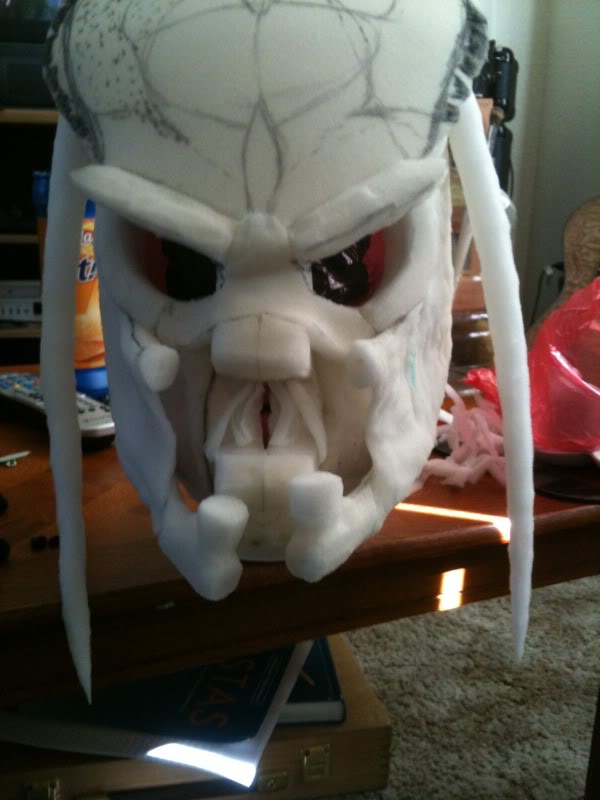

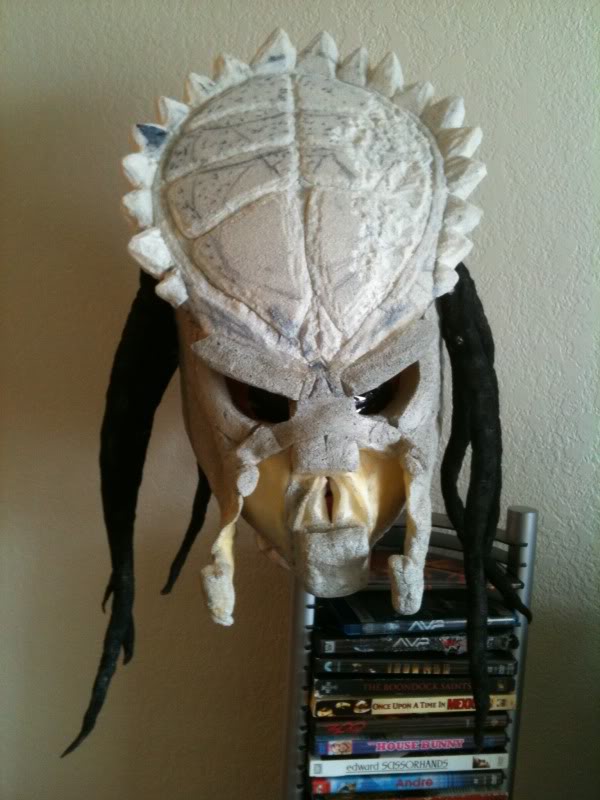

alrighty guys so here is the progress. from the last time i posted i started making dreads out of foam (and yes this WHOLE mask dreads and all was made with one foam roll i bought at walmart for like 18 bucks) haha

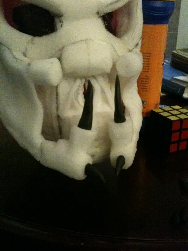

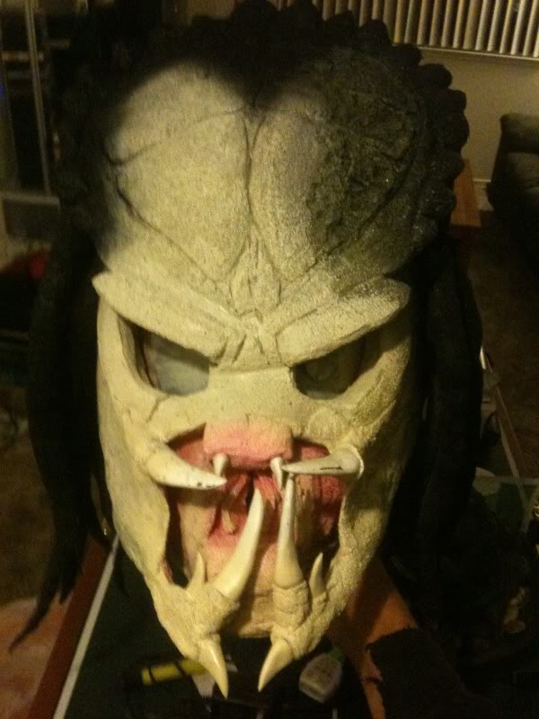

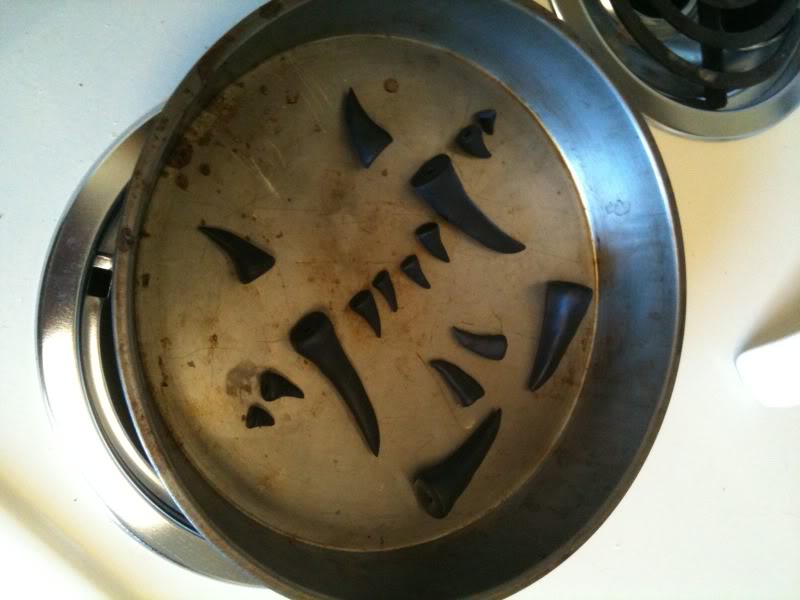

i started sculpting the teeth i used sculpty and baked them
then test fitted on the mask using toothpicks (which later attaches to the copper wire)
i then painted the dreads black as a test. looked pretty rad

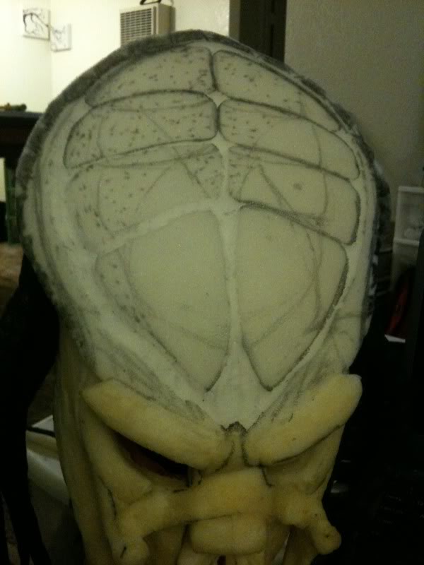

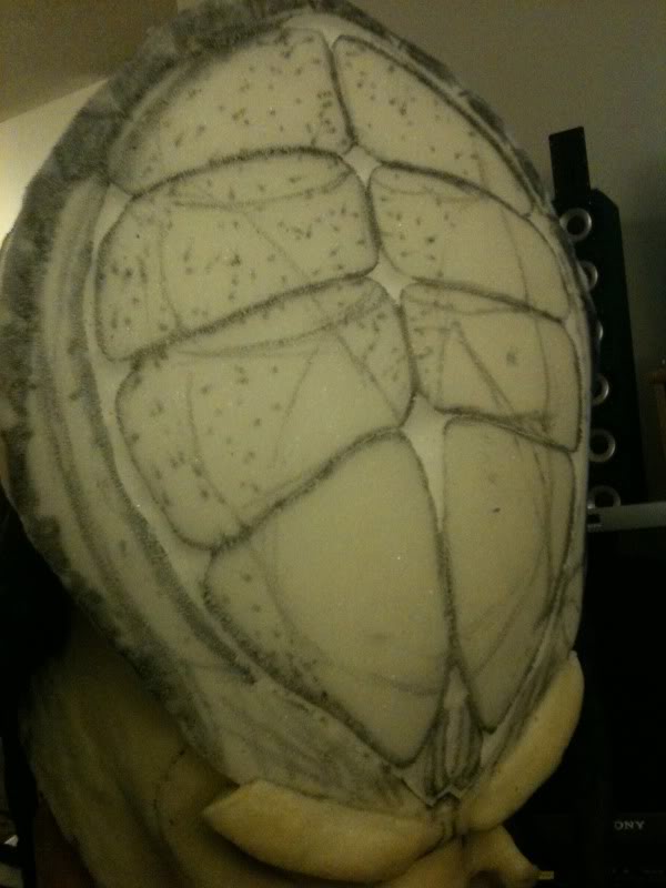

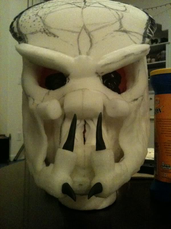

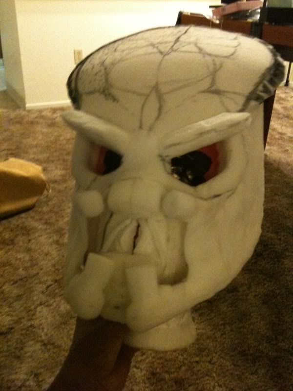

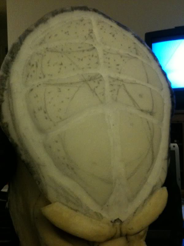

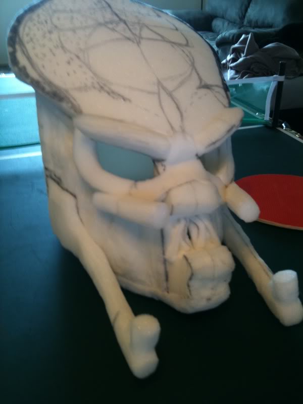

so while i finished latexing the mouth, waiting for it to dry i moved on to redrawing the "muscles" on the head (or whatever they are called on the wolf haha) and started cutting out the lines to create ridges and bumps of the mucles.
i then started cutting the damage on the left side of the wolfs face

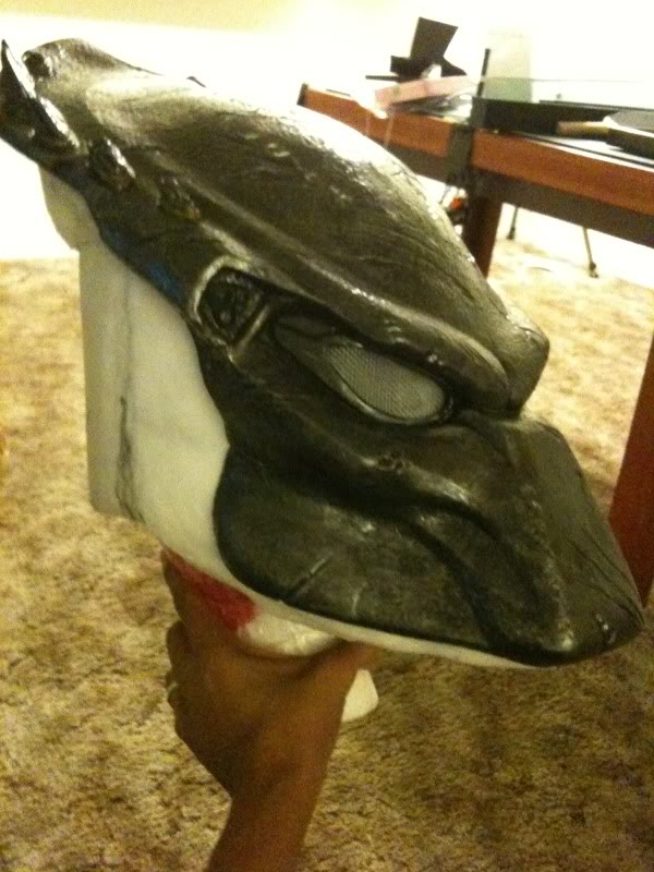

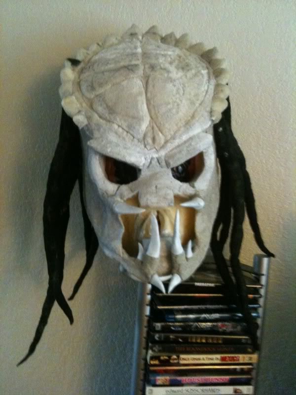

at this point i thought it looked pretty rad haha. but i knew it needed horns. so i started making them one by one. i kinda went for my own P2/Wolf look here so i just started adding what looked good to me and came up with this

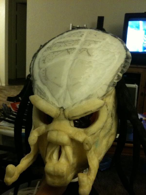

Then of course started latexing it when i liked it
(oh yeah right, i added the teeth after painting them pale yellow white with acrylic paint)
my Girlfriends little brother had a blast with it.

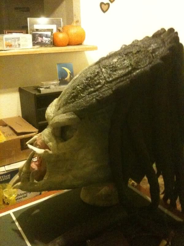

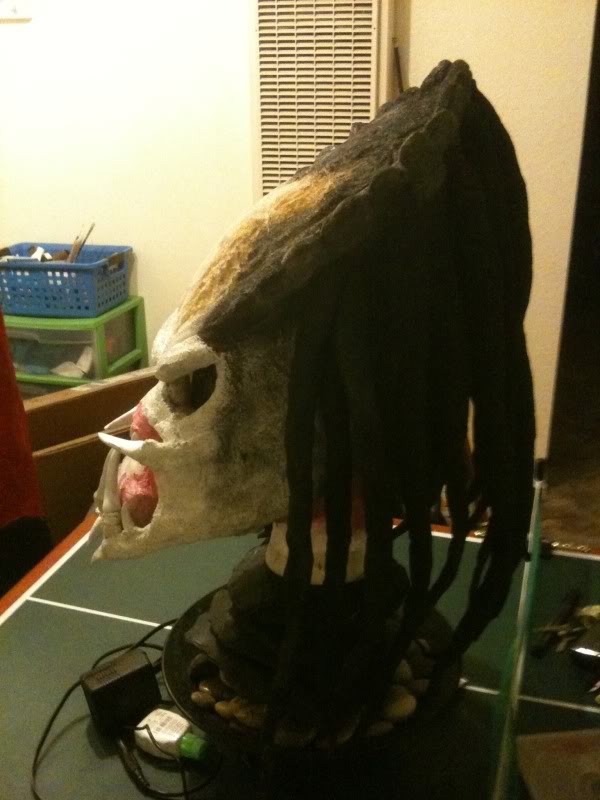

heres how it looks fromt he side. i love that lifted horn look. adds a nice curve to the head that points up at the end
at this point i got sidetracked decorating the house with decorations. so i decided to mess with the fog machine and catch these photos :eek:
(it was outside so the fog didnt stay to well like it does inside)

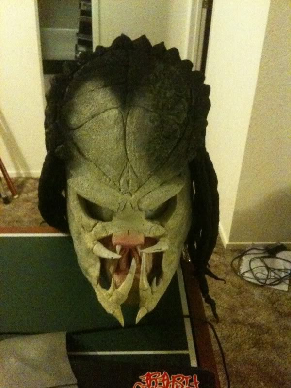

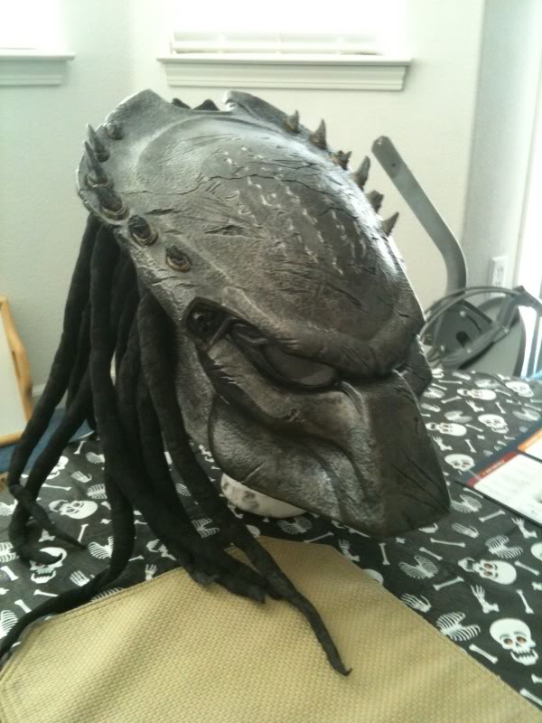

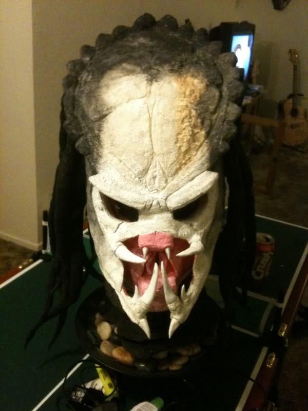

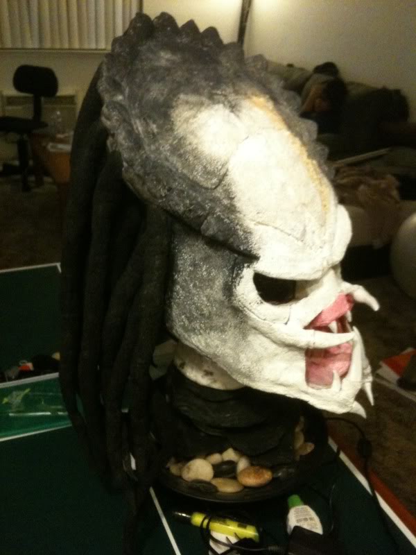

anyway this is what i came up with so far

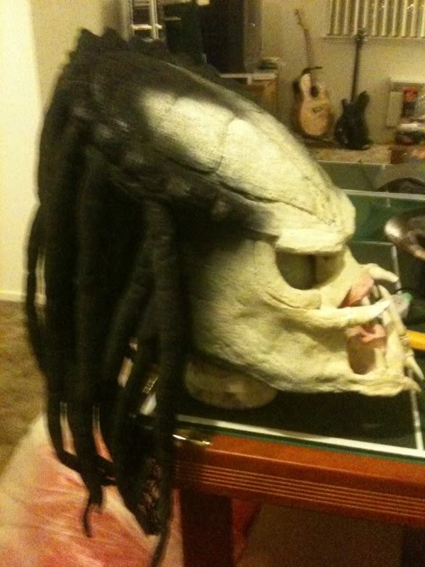

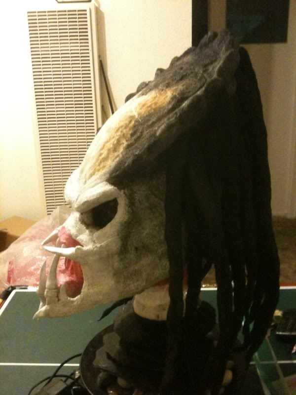

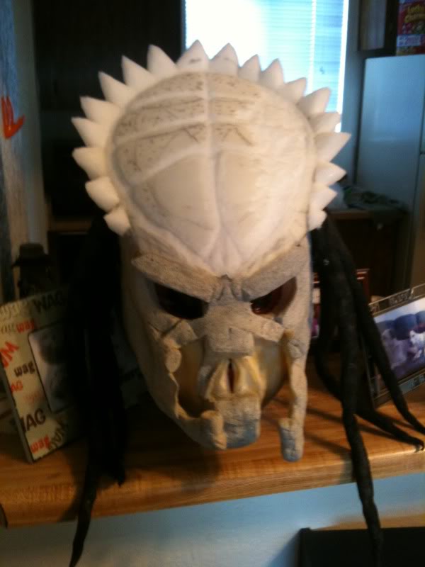

i added more dreads then test painted and came up with this... it was ok i guess. i really need an air brush
side view again. i Love the head angles
more temporary dreads (i will be purchasing some "seconds" dreads from casey soon)

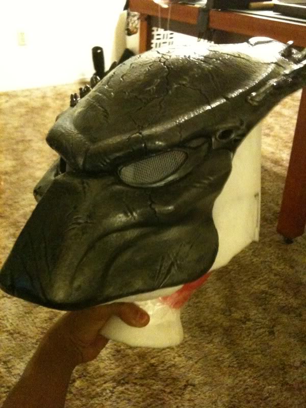

at this point i added the bio with magnets
http://www.thehunterslair.com/index.php?showtopic=21206

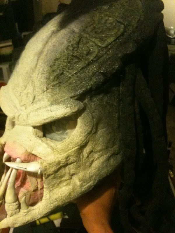

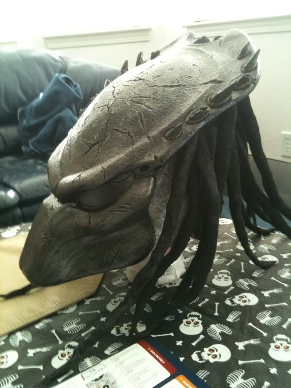

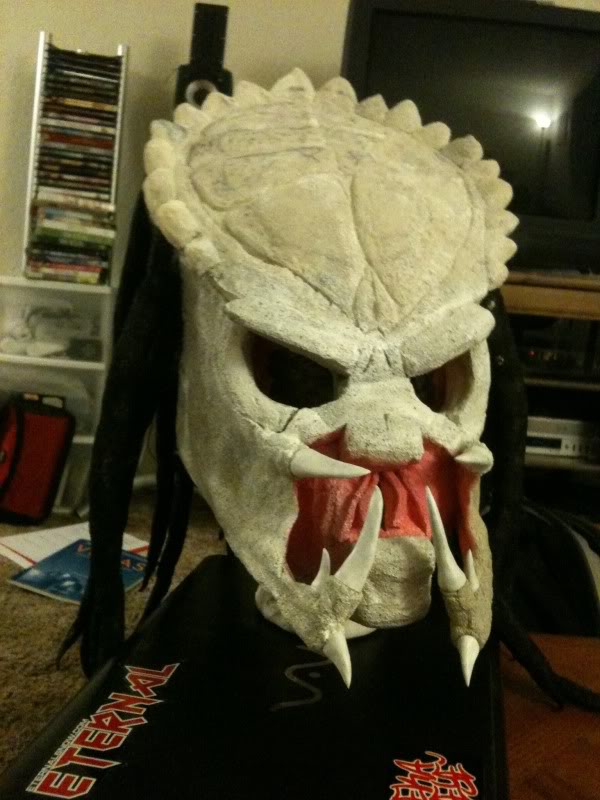

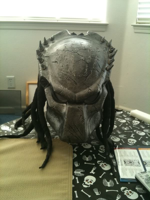

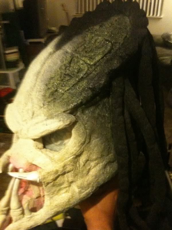

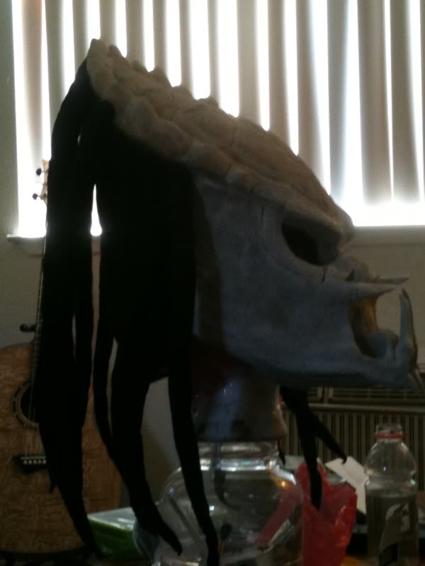

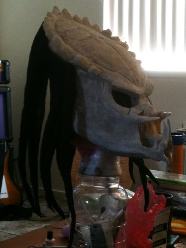

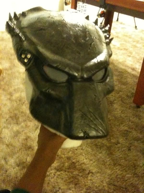

anyway. i decided to get some spray cans and use acrylic paints and sprayed this up. I'm actually pretty happy with it enough to want to permawet the paintjob. but i dont have any. does anyone know permawet alternative? (i didnt find an answer on the search)
Damage
teeth
side views

anyway all in all it came out awesome I think. At least good enough to satisfy me for halloween (im pretty picky on things looking at LEAST pretty decent or good haha)
Thanks everyone for watching and dont forget to look at the Bio to mask Magnet tutorial!!
