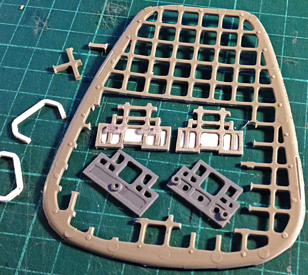

I've scanned the sheet (removed the stickers) printed it and laminated the sheet. I'll use that for two things, to create the missing parts and for painting!
These things are taking forever. much longer than I thought they would.
Some bits are missing because they stick to the overhangs above and below the sidewalls and can't be attached yet.

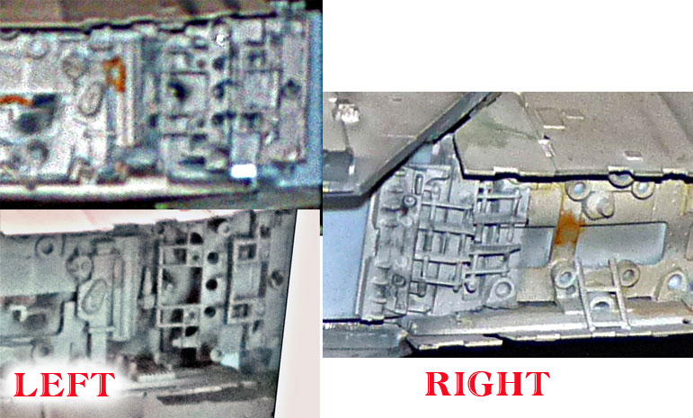

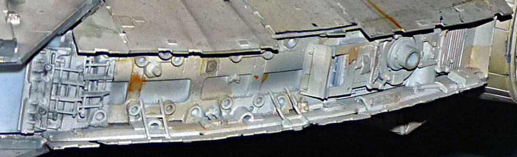

Just out of interest does anyone know why these details left and right of the light up engine ports are different... and were they always like it, i.e during filming?

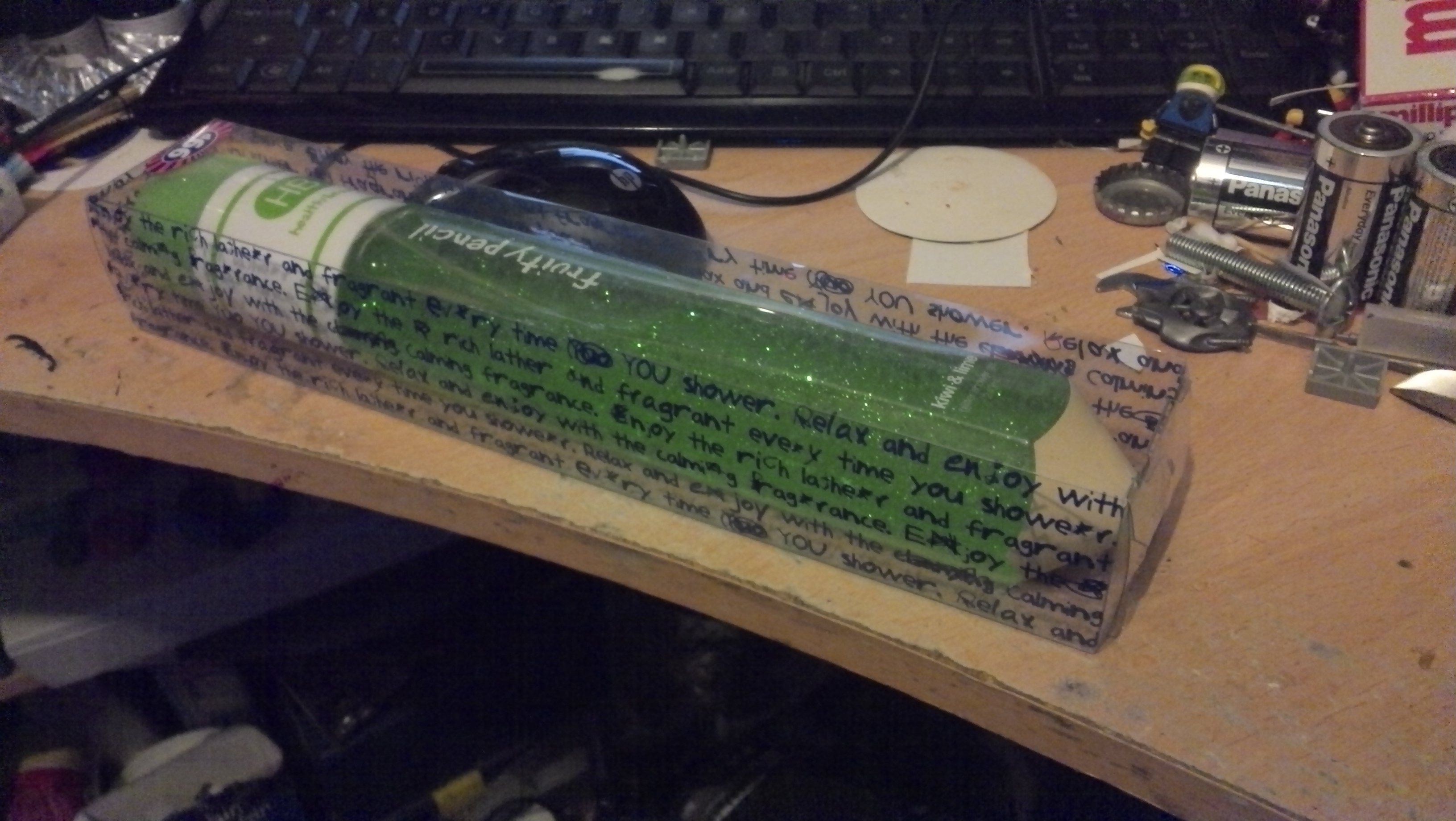

Another bargain here, a 99p bath gel, in the shape of a large pencil, and while it might be hexagonal in shape, and I was after something octagonal, (can you guess what for?) it should be easy enough to cut the size I want twice and make an octagon from two of the hexagons split down one side.
As an added bonus the box it comes in is a good source of clear plastic in itself.

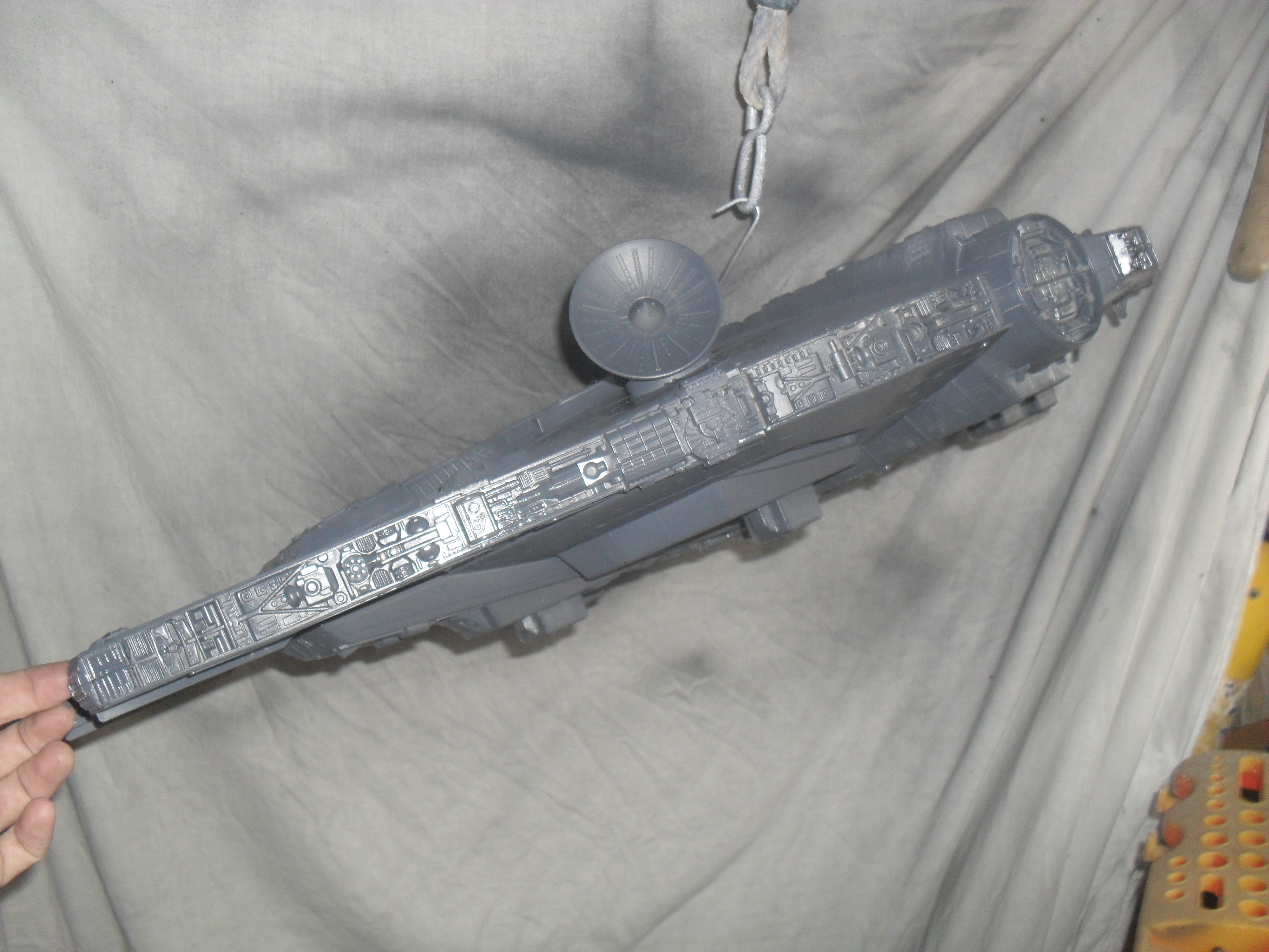

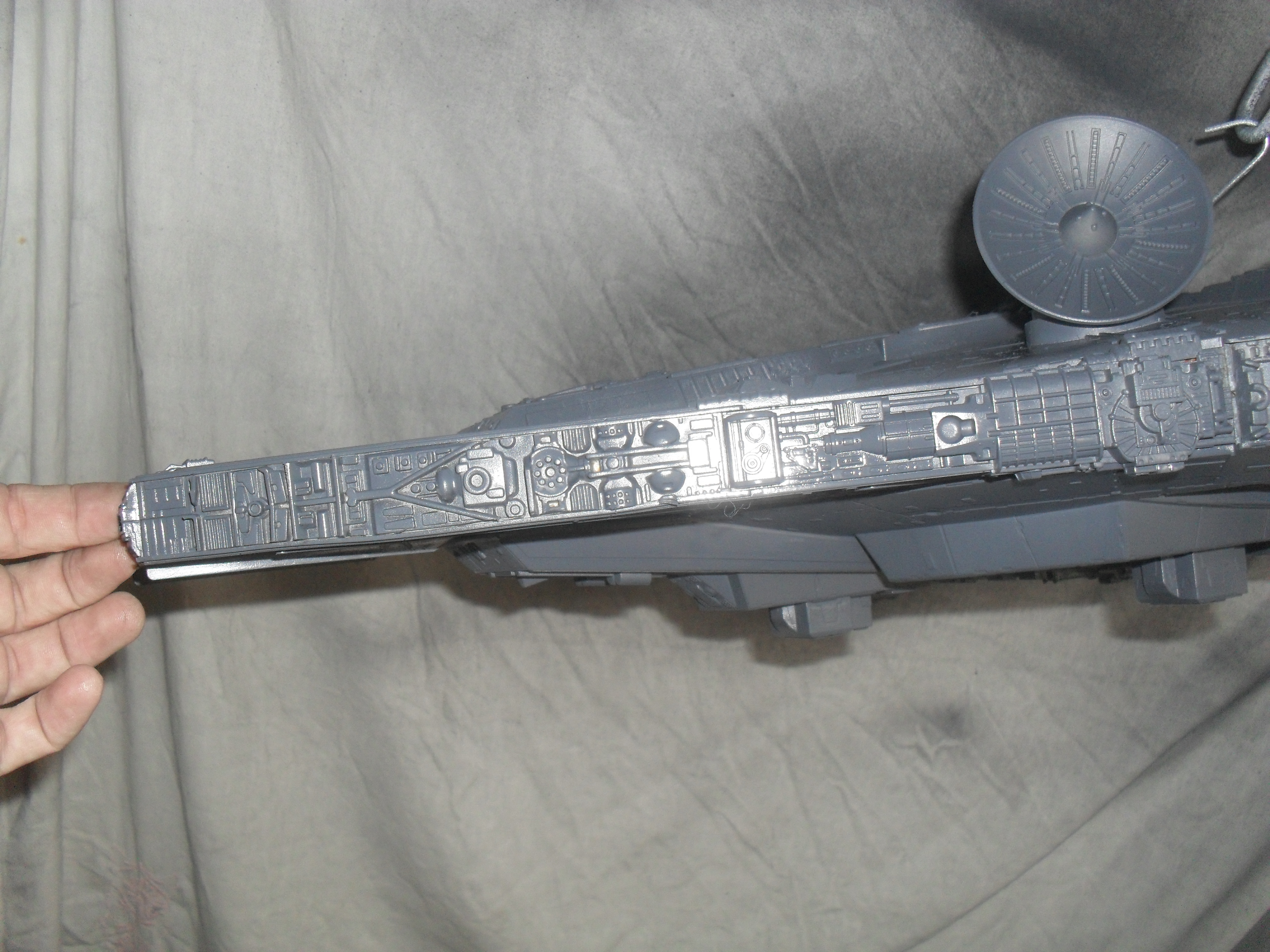

For those looking for side panels, seriously do what i done a grab some from a vintage Falcon. You can find loads of spare parts and empty shells on the bay, and ive seen a set of the panels sell for £10 shipped this week. You need to trim them down a little, but its well worth it plus they are actual panels. Mine are in the pics.
Just got another coat of primer on mine. Im working on a tight budget as many are, and im using spray primer that costs £1 a can :) Ive got 2 coats on now and done a tape test and its sticking :)

Details made from part of a respirator :)
Not 100% but quite close to the two different side bits I posted earlier.

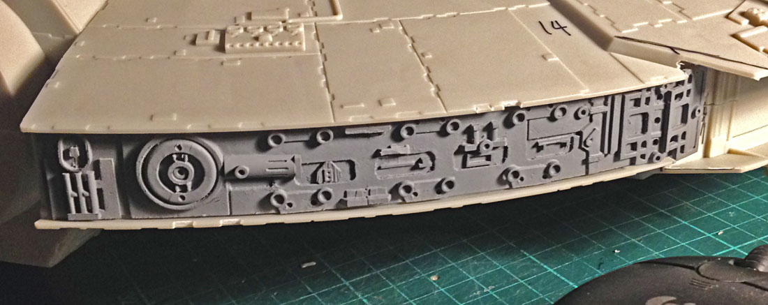

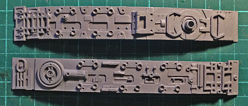

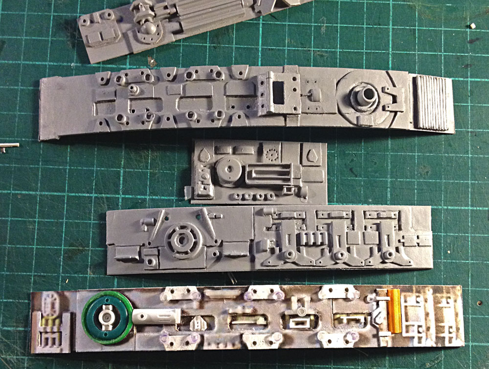

Well they aren't perfect but they will do..
The bad news is the sidewalls will almost certainly need moving back a bit.
I made these as thin as I could but its not enough,
I'm sure there will be the same problem with the shape ways parts or casts from them.
here's a real one, much much further back.
