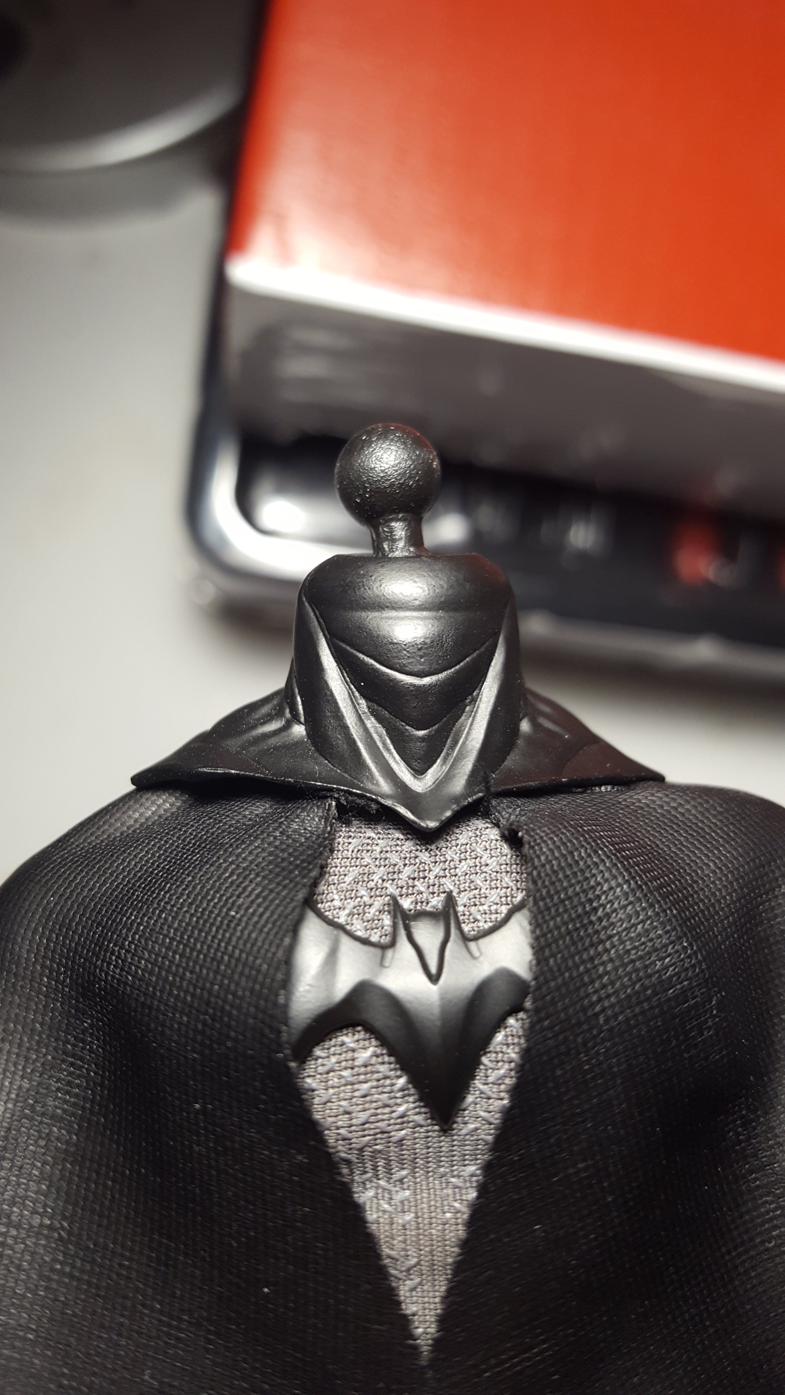

Hi guys! I need some help modelling a Batcowl, I dont have the technical knowhow or a printer to model and make my own so I figure theres nowhere better to go than here. I want to make the cowl in the below pictures, I have the figure so I was able to get pics all the way around to help you get an idea. Basically the idea is, this cowl, modelled as one piece to then be molded and cast in latex, to account for shrinkage Id like to model it big, about 25 inch brow circumference to allow for bigger heads. Thanks guys!

This is my first and I know the process, this is my first step in the process Im doing, its a bit different from the usual style of sculpt over a lifecast, mold and cast copies, the plan is that the 3d file will be printed, cleaned, then a mold will be made from the print and casts then pulled from the mold. I know I COULD sculpt it, but I really want everything symmetrical and I cant trust myself to do that by hand. Plus I plan on selling the copies so Im not worried about it fitting me PERFECTLY, so much as a 1 size fits most. Thanks for helping though, thats helpful info.
