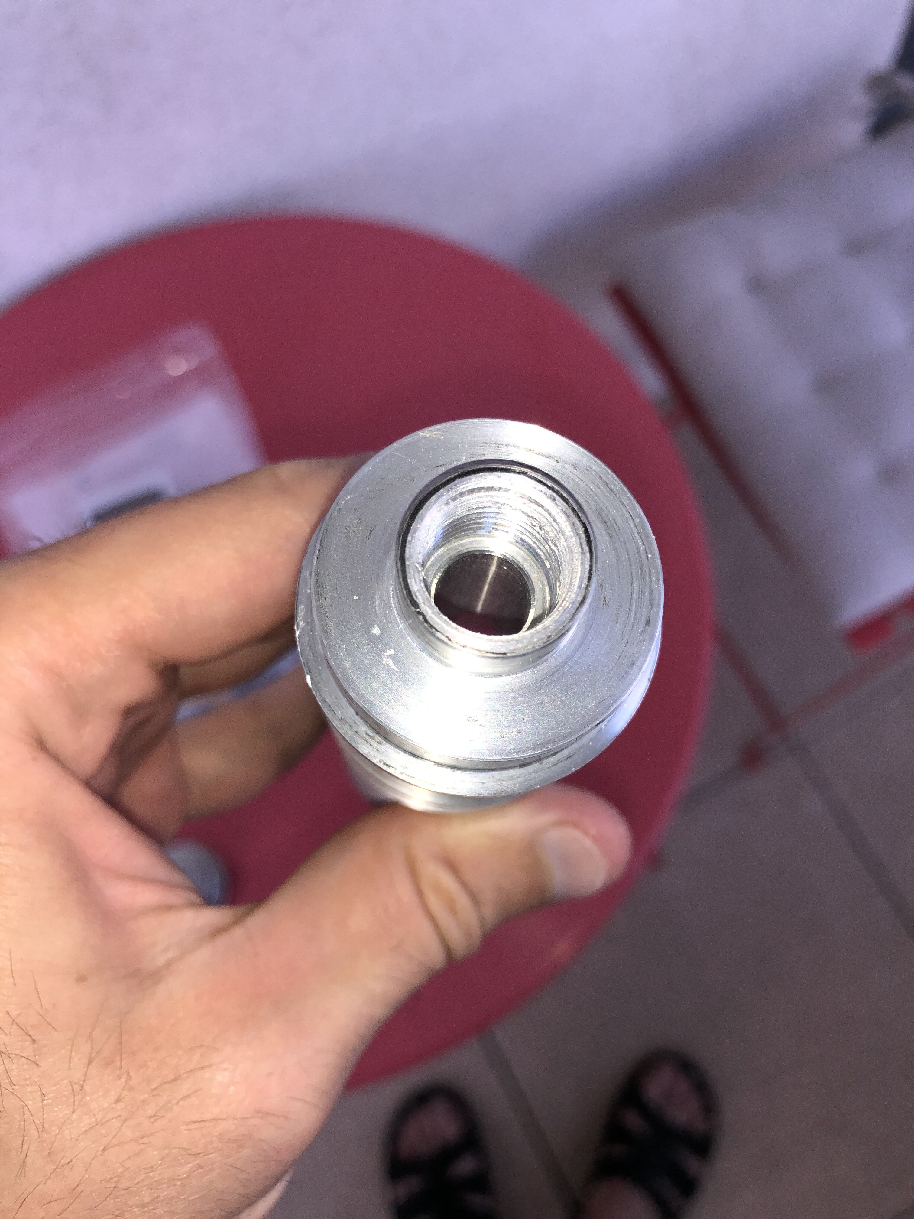

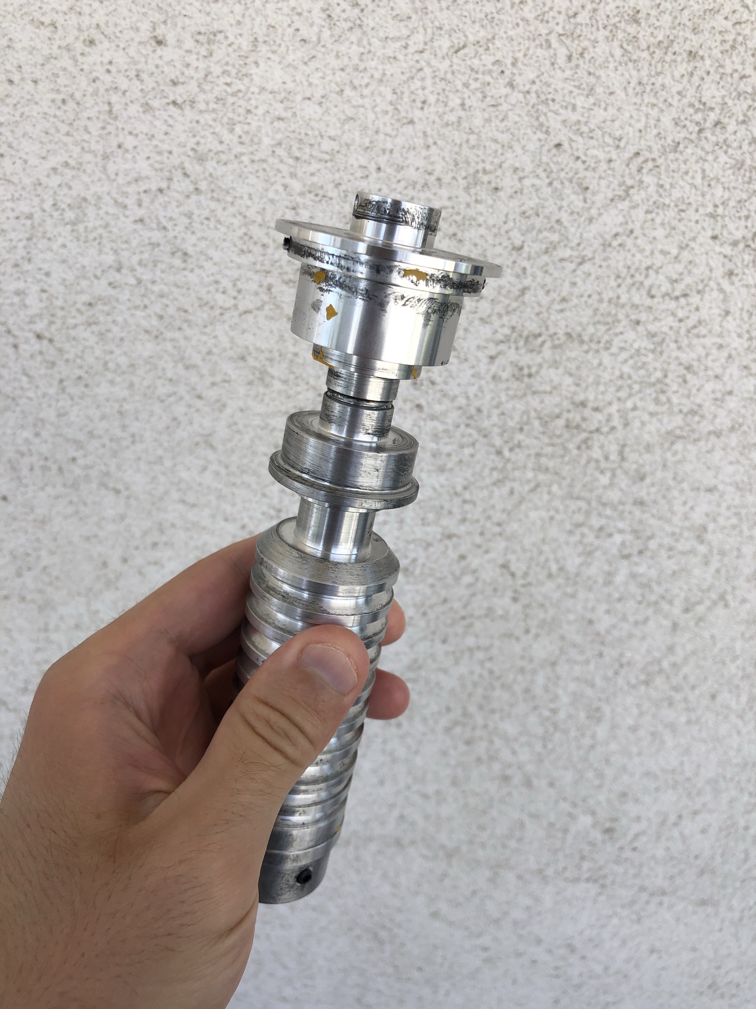

After year, i decided to finish my solo hold v2 and i totally messed up…
- Wrong way for trooper trent stencils (i waiting for another batch)
- The emitter is blocked. I don’t know how to put it off safely. I screwed it and now it seems to be irreversible :( with my father, we took the emitter top off so we can see the heatsink and the steel piece that allow emitter to spin without succes…
Do you have some ideas ?

Use a penetrating oil like WD-40 and allow it to sit… perhaps even soak the part in a container for some time (at least 2 hours up to a day) as there could be a burr or debris that seized the threading.
Then use rubber gloves for additional grip or a set of rubber pliers (for round objects) To prevent marring the surface.

BRRogers, you are the man ! I finally put off the emitter thanks to the rubber plier !
As you can see, the screw is damaged, i think he got damaged when i initialy screwed it…

If they are a standard size thread you might be able to at least partially repair them with new tap and die if he doesn’t have more of those parts to spare?
I can try it or perhaps i can short the thread ? The damage are located in the bottom but will i be able to spin the emitter ?
