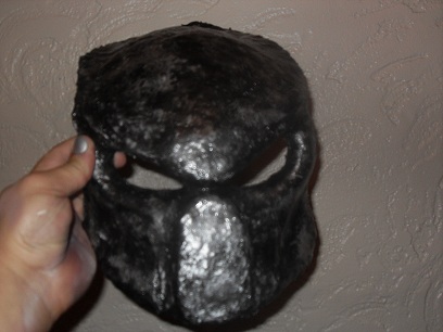

I made mine out of paper mache, here let me see if I got some pics
heres a few pics, one shows the wire mesh I used for the shape. I got it at a craft store, I used celluclay wich is paper mache and coverd the mesh. I probaly spent 10-15$ after paint
