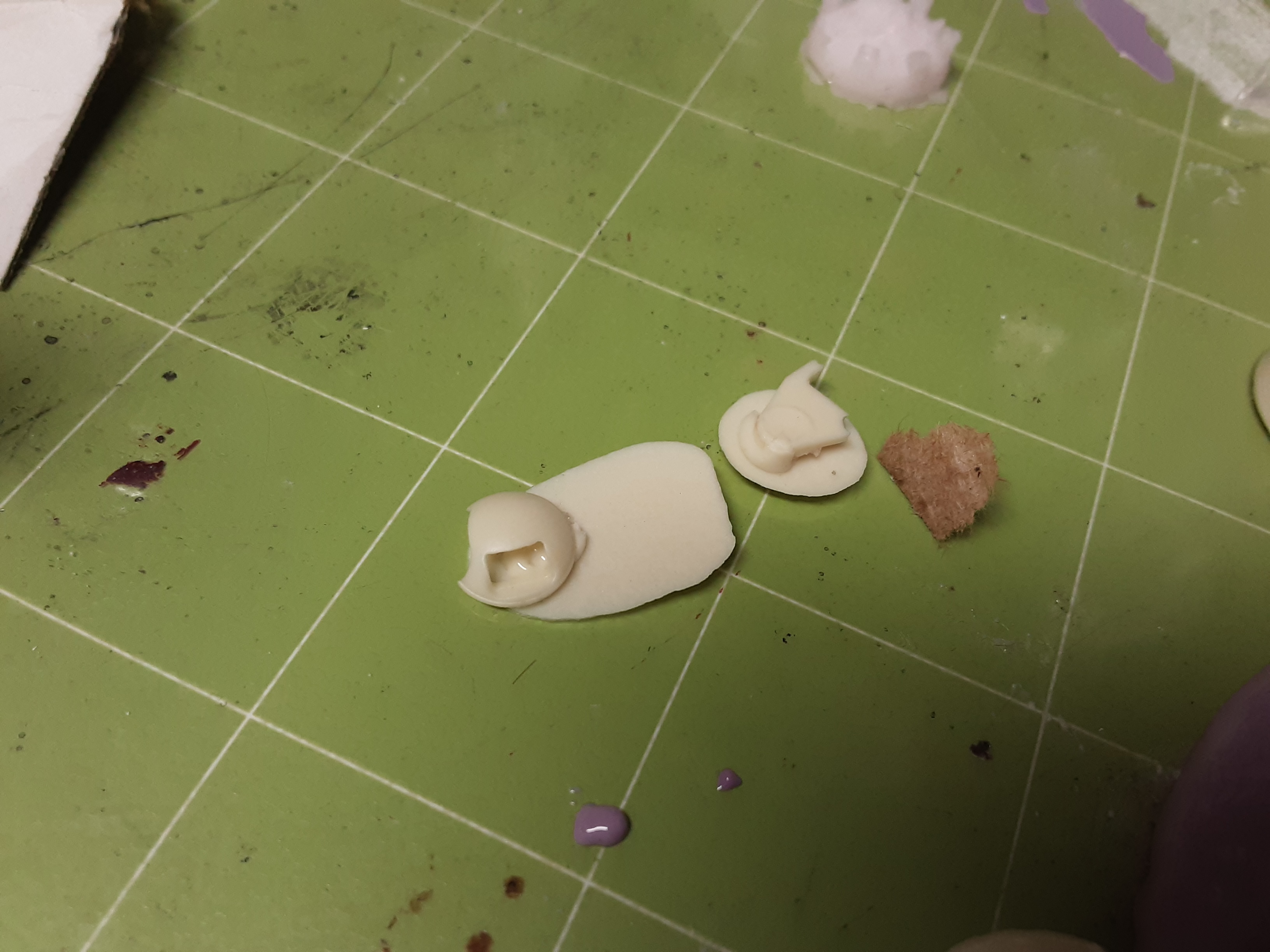

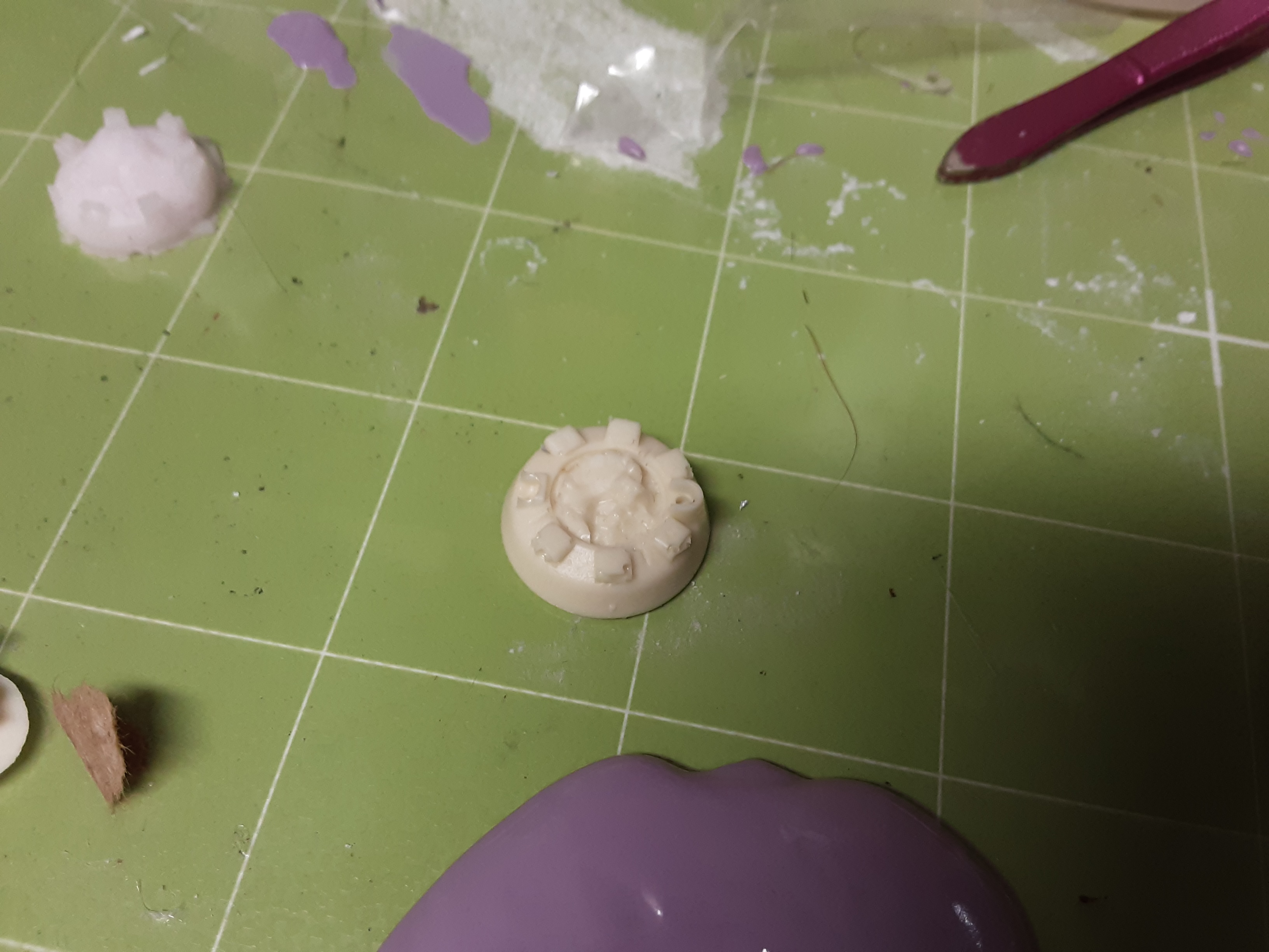

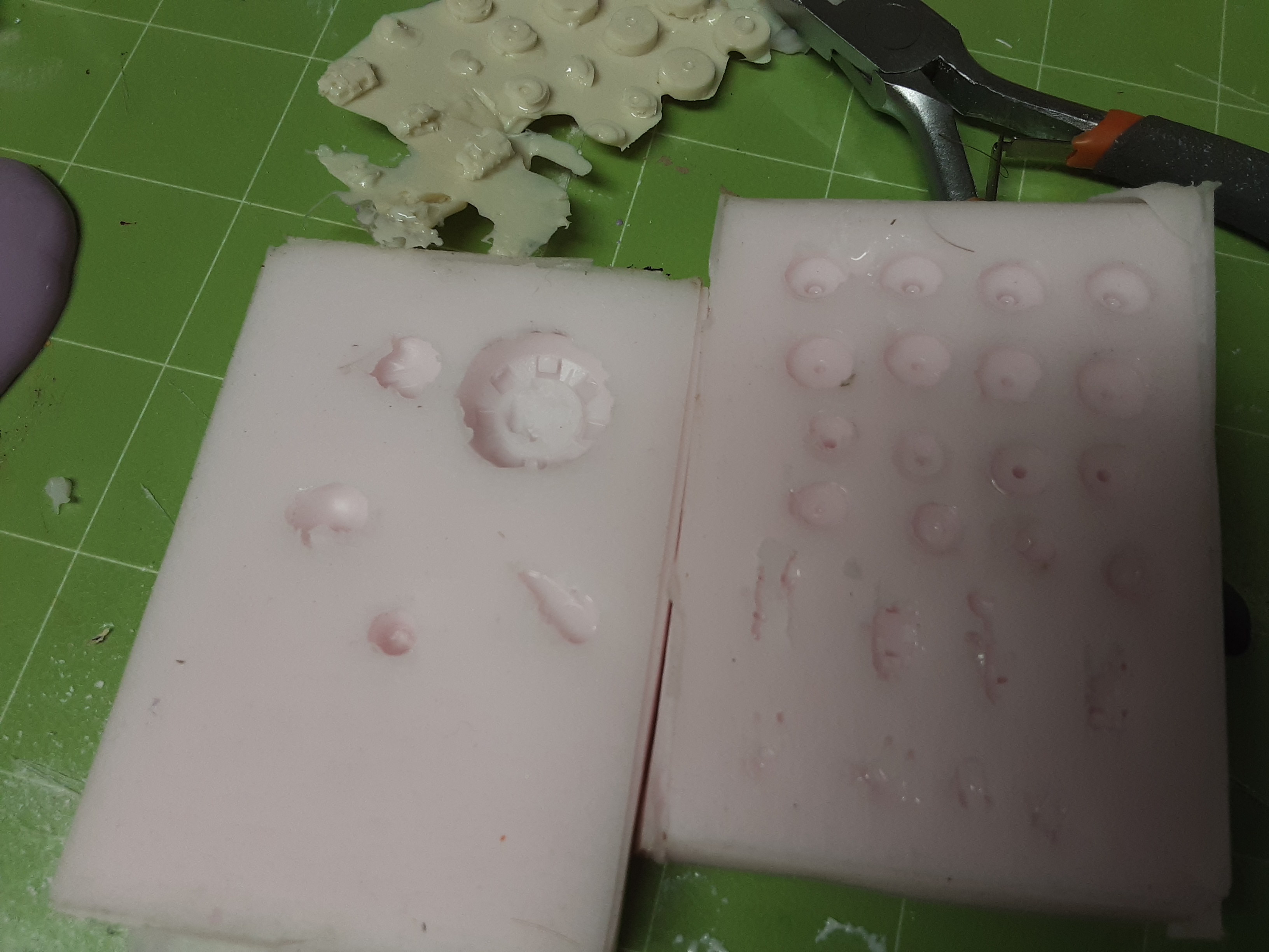

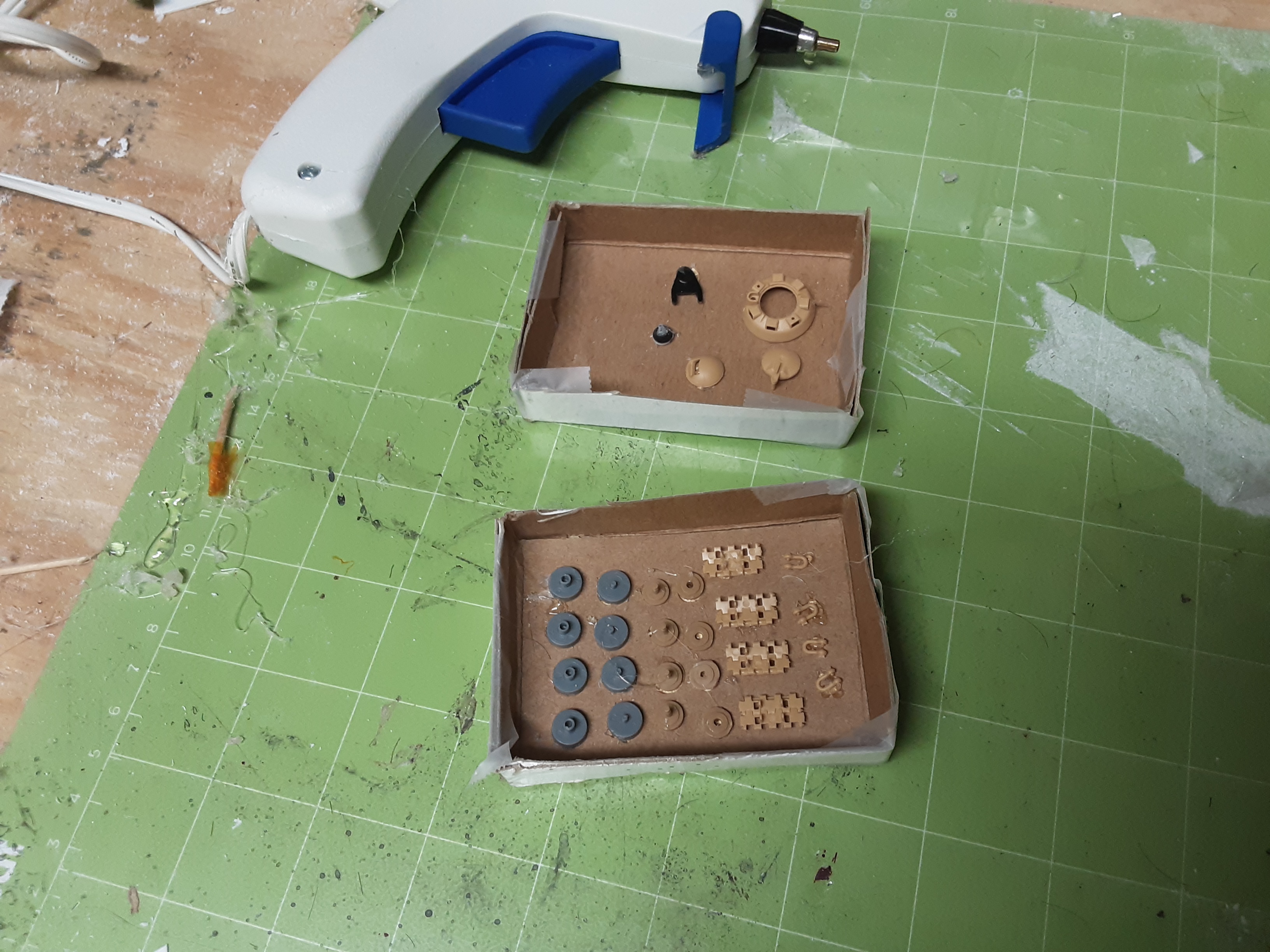

These are for a training remote. I used hot glue to hold in place, poured the mold and let cure for 24 hours.
Poured my resin and this was my end result. Not very good looking molds or castings

Use styrene to make a mold box, or make one from LEGOs. I use CA glue to tack my original parts to a piece of styrene, then build a mold box around them.

No chamber. . I am going to remake my mold. I also bought some two sided tape .I can't help but think some of the hot glue took away definition
Tack glue it using a tiny drop of super glue. get rid of the cardboard mold box, use styrene.

1. Throw out that rubber and resin that you got at the craft shop. It is beneath what you are trying to do here.
2. Smooth-On.com has rubber and resin for what you want to do. they also have videos.
3. Lose the cardboard. start with a solid surface, styrene, acrylic, glass... I like styrene because it cuts with a score and a snap.
4. Hot glue is fine for attaching parts to the surface, but be sure the pieces are mounted firmly.
5. I also see in the top box that there are pieces with hollow centers. This must be filled with clay to avoid locking the piece in.
I use foam core for my mold boxes. It's easy to cut, It glues well and if you glue original parts down to it with ca, you only have to sand off a little bit of paper.

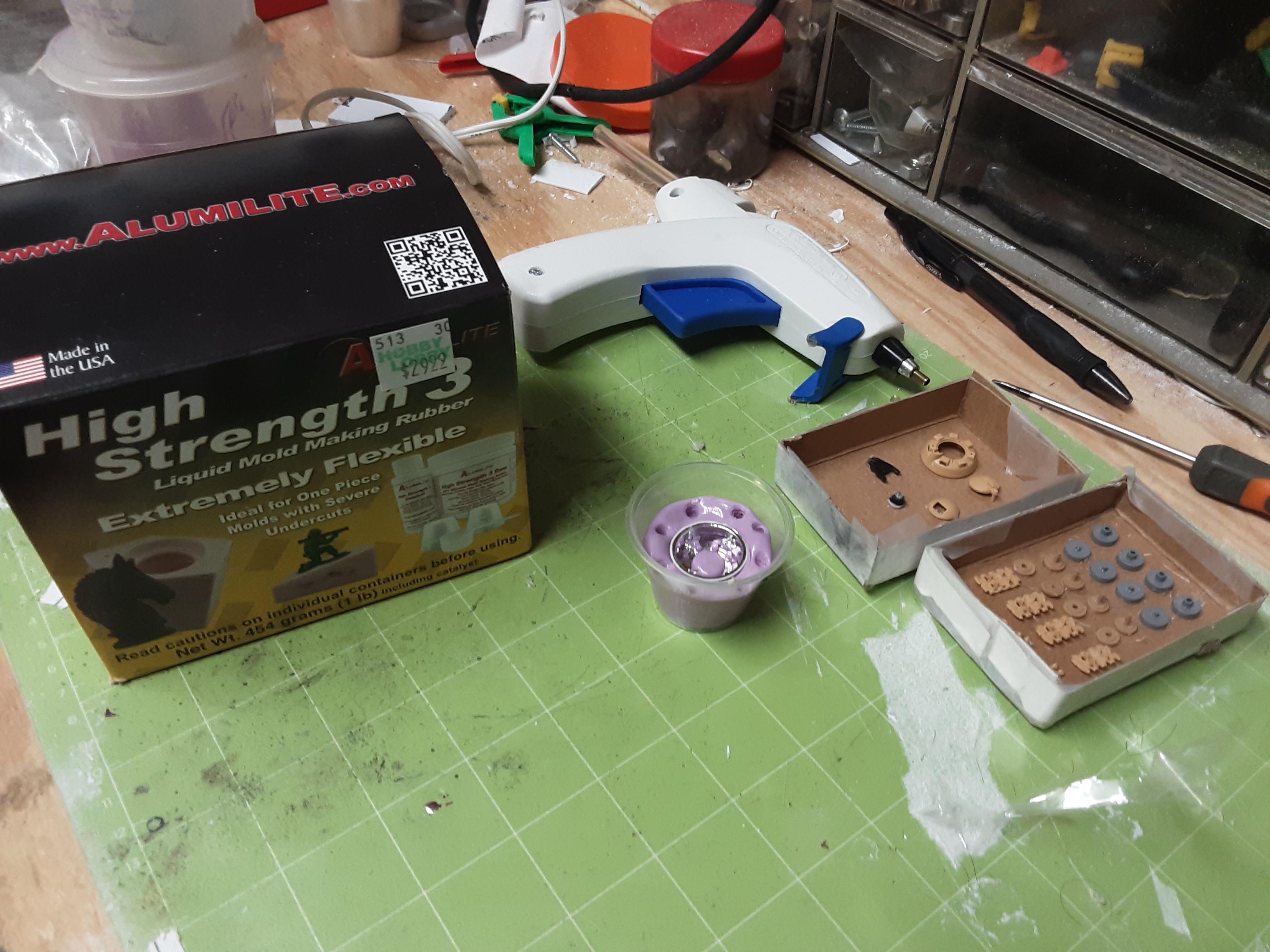

Thanks everyone. I ordered my mold and resin . I did buy the plastic form board I saw from the first video posted above. I have lots of styrene in my shop. I'm making a full size styrene R2. Never thought about using it. .
I will begin making a mold stock and wait for my order to arrive.
