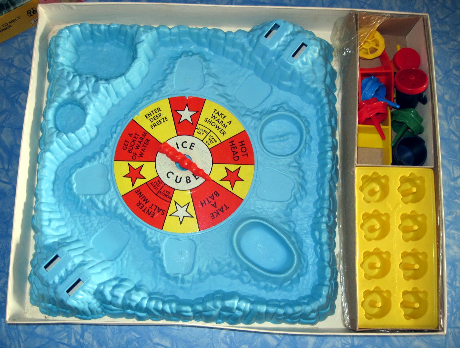

Well, I went ahead and got Vytaflex 30 (just because it was available near me at the time) and on one hand, it worked really well in terms of viscosity for pouring, on the other hand removing the ice cubes from the tray cause damage to the center portion, meaning I'm not sure how long the tray will last before it doesn't work anymore. Would Vytaflex 40 be strong enough to resist tearing, or should I go directly to 50, or is there another material, like they use for the novelty ice cube trays they sell on amazon, that would work better?

Edit: Here's a picture of the ice cube tray game with the ice cube tray in yellow for reference to the center thing I'm referring to, to hopefully clarify what I mean when I say the center portion tears when pulling the ice cube out.
