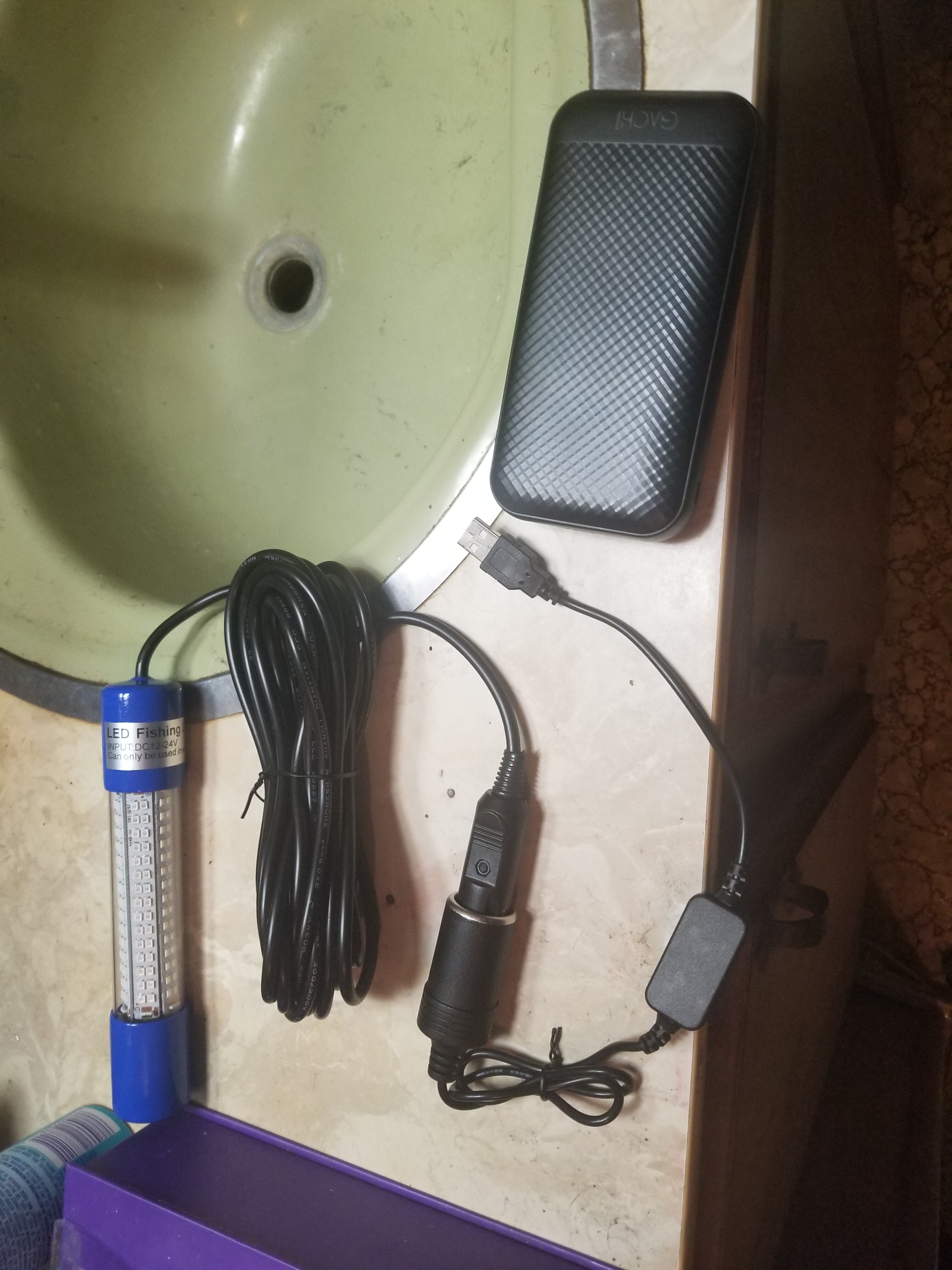

Okay, I'm doing the 12v green light mod, myself. First, the cord for the green light is super LONG. When I splice the cables, I'm going to remove a bunch of the cord. Here it is, as is, without any mods, running off of a 2.4a usb power bank. (the normal 1amp usb port does nothing) I gotta search through my power bank collection and find a smaller one that supports the 2.4a output.
The light and usb to 12v I used are from Amazon, and are a little different than the link previously posted, as the one I used already had a cigarette lighter adapter on the light.
<CLICK THIS LINK> Amazon usb to 12v 10w
<CLICK THIS LINK> 12v 8w green light with cig adapter

And are you using the power bank to green light ? I think it worked good.
The last green light link I posted is actually for a 8w instead of 10w light. So, it can run on a 2a usb power bank. [more common]

I want a smaller power bank with a 2amp output, I may actually just make one. The light itself is a bit larger than I thought, so there's not as much room in the trap as I had originally anticipated. A smaller power bank will save space.
So, as previously stated, the light is bigger than anticipated. I still thought I could wedge it in the trap diagonally. That's what I get for "thinking".
I can't make it fit. It might almost fit on the inside, but I can't get it through the hole in the top. This is most unfortunate. I may have to MAKE room, and a bigger entry and glue any modifications back together, or go with some other form of light. I liked this one. Super bright. A nice green. But now I'll have to rethink this.
Maybe different traps are slightly different sizes? I can give dimensions of the light if asked.
I still have time before Halloween, so I bought some 12v replacement lights. It's actually 3 x 12v bulbs, green LED, they're meant to be replacements for Halogen, so they're super bright. They're 2 inches high, so I'll just put all three in the trap facing up and wire it with the usb to 12v cable I already purchased and still run it off of a USB power bank.

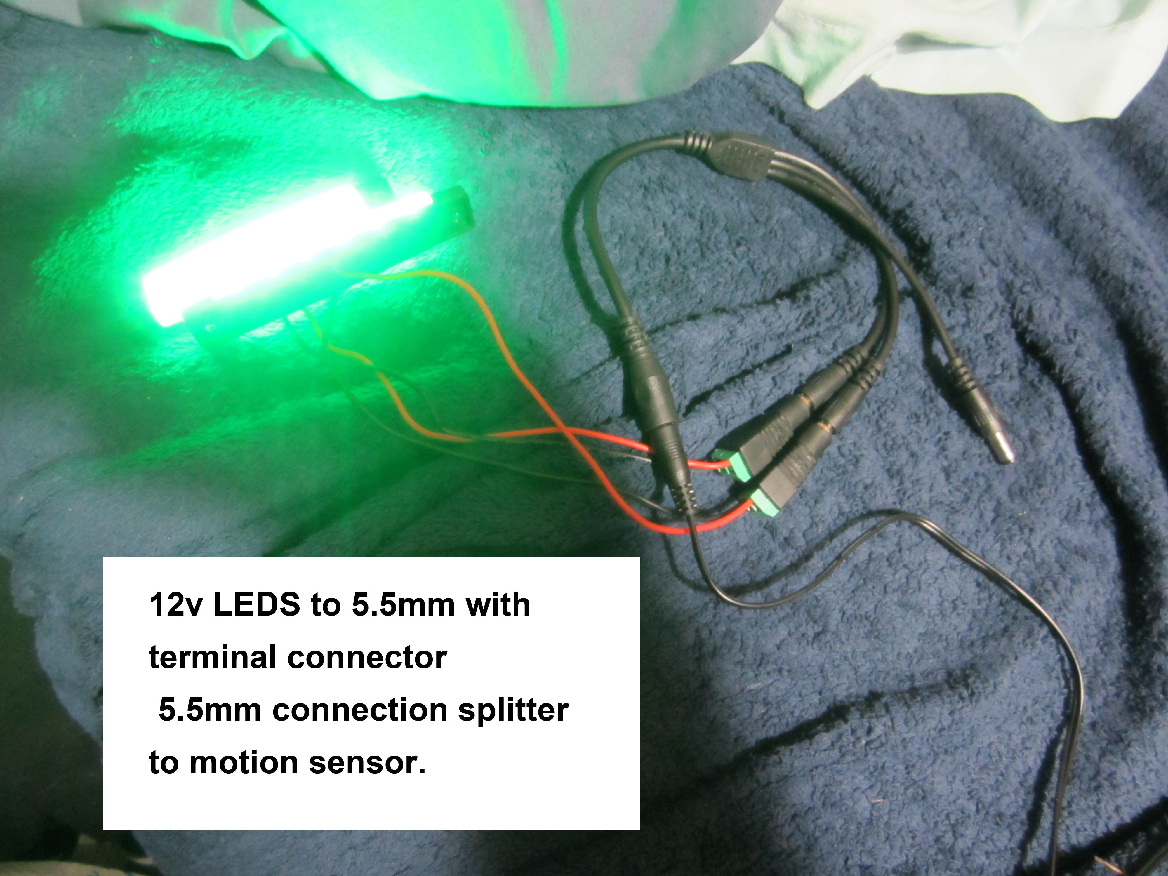

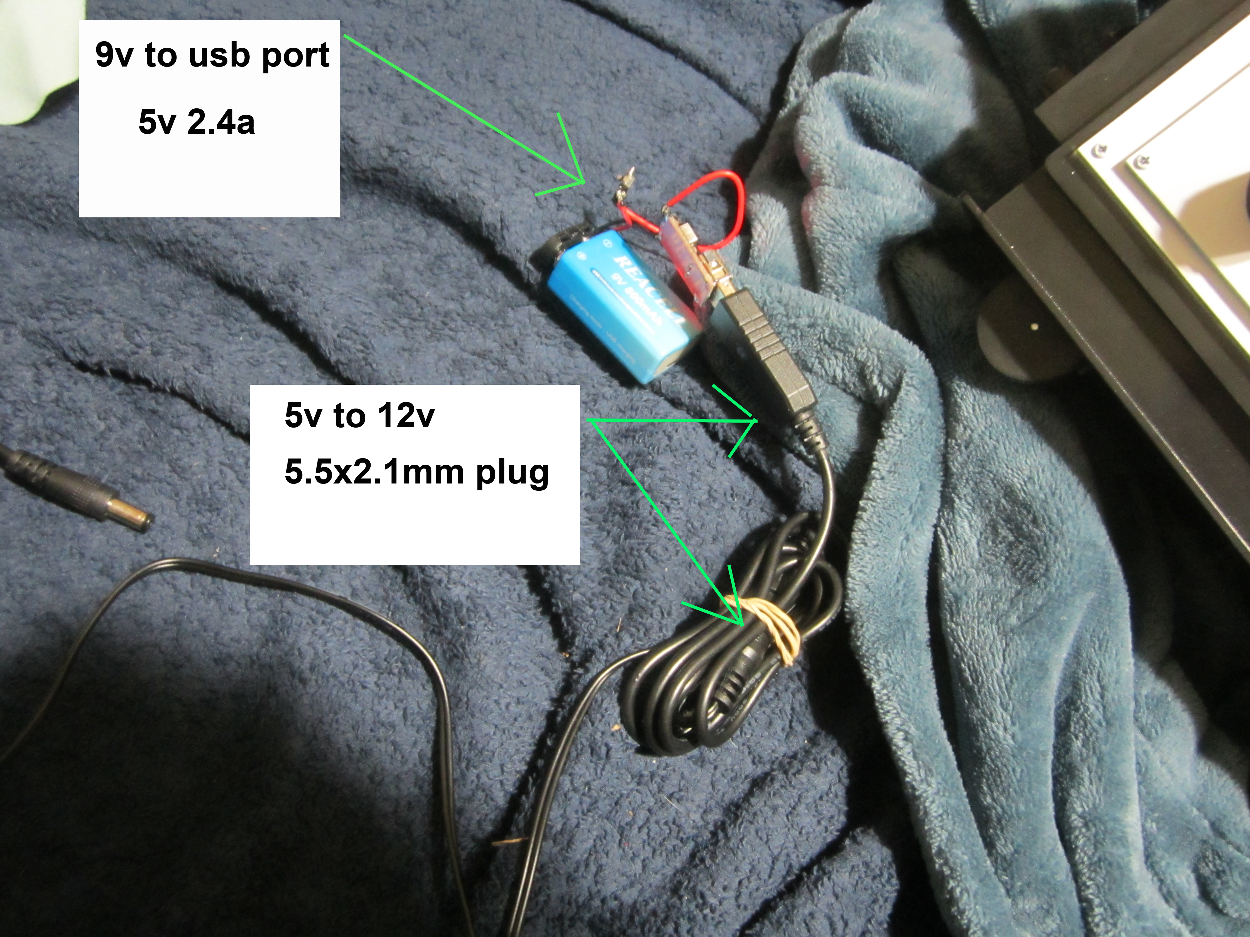

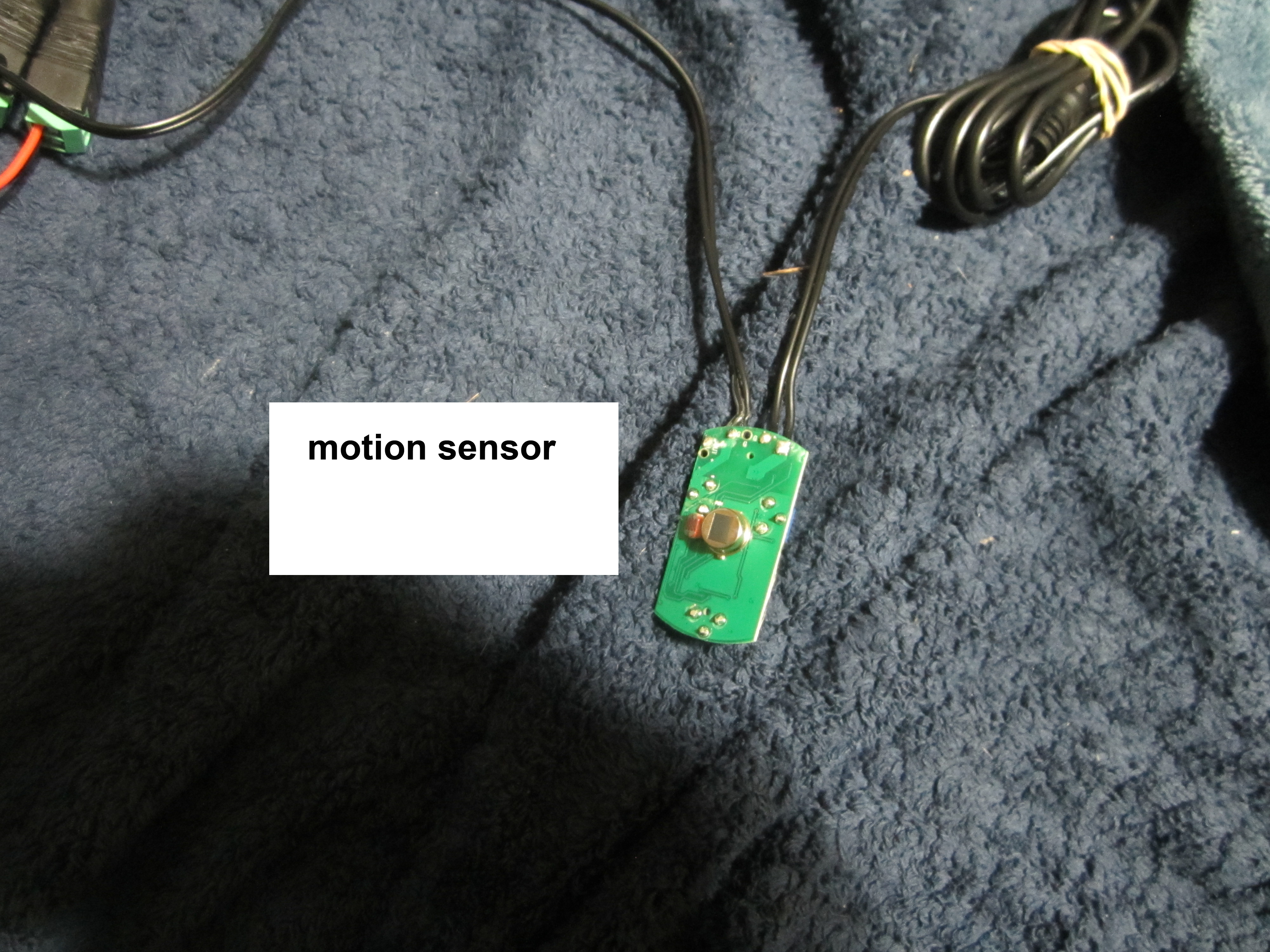

I put a homemade power bank, a usb to 12v converter, a splitter, and two green led strips in the trap.
When the trap opens, it sets off the motion sensor and the green light comes on for 10 seconds. The delay time is settable on the board.
