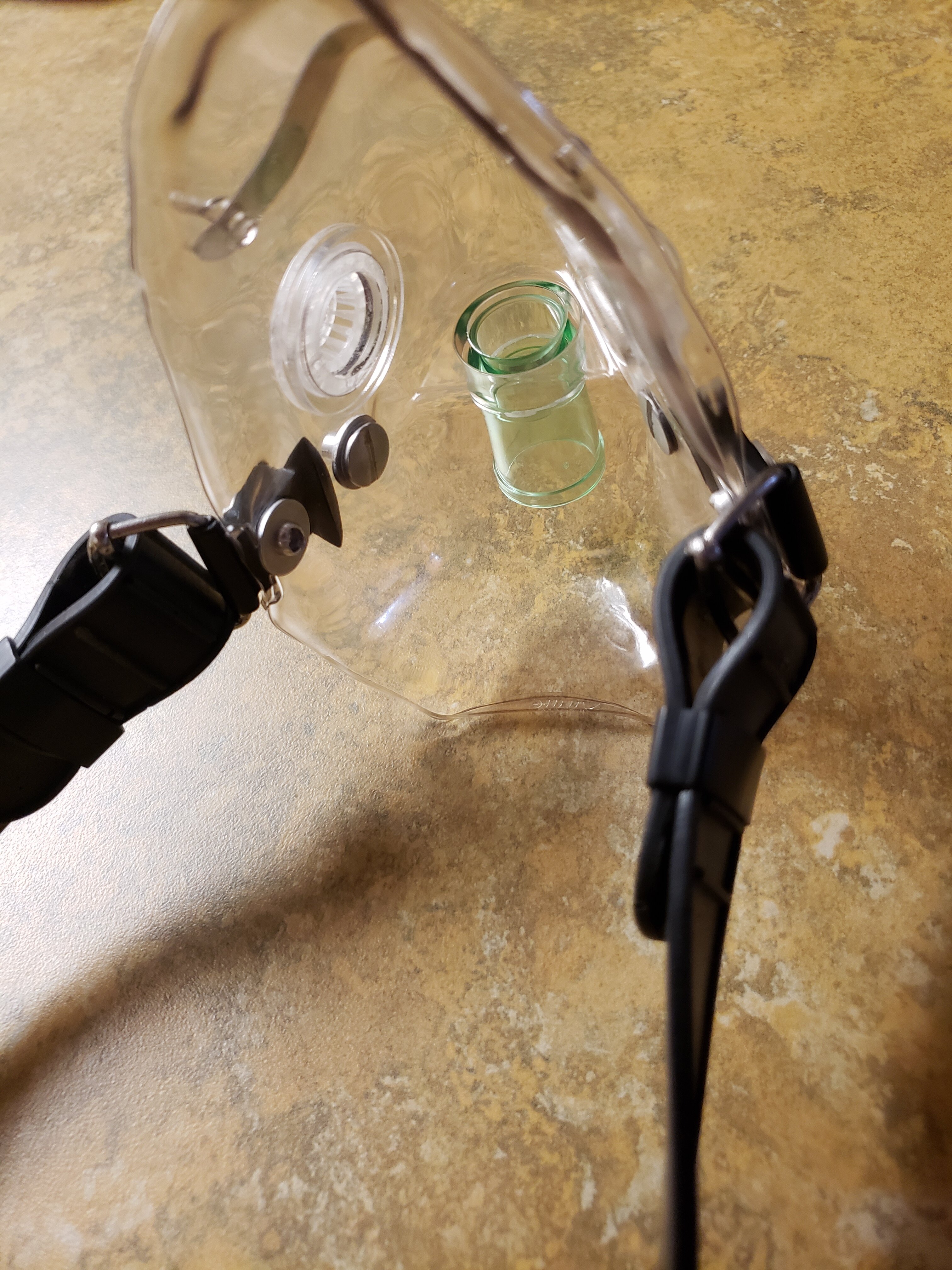

Ryan Clinton

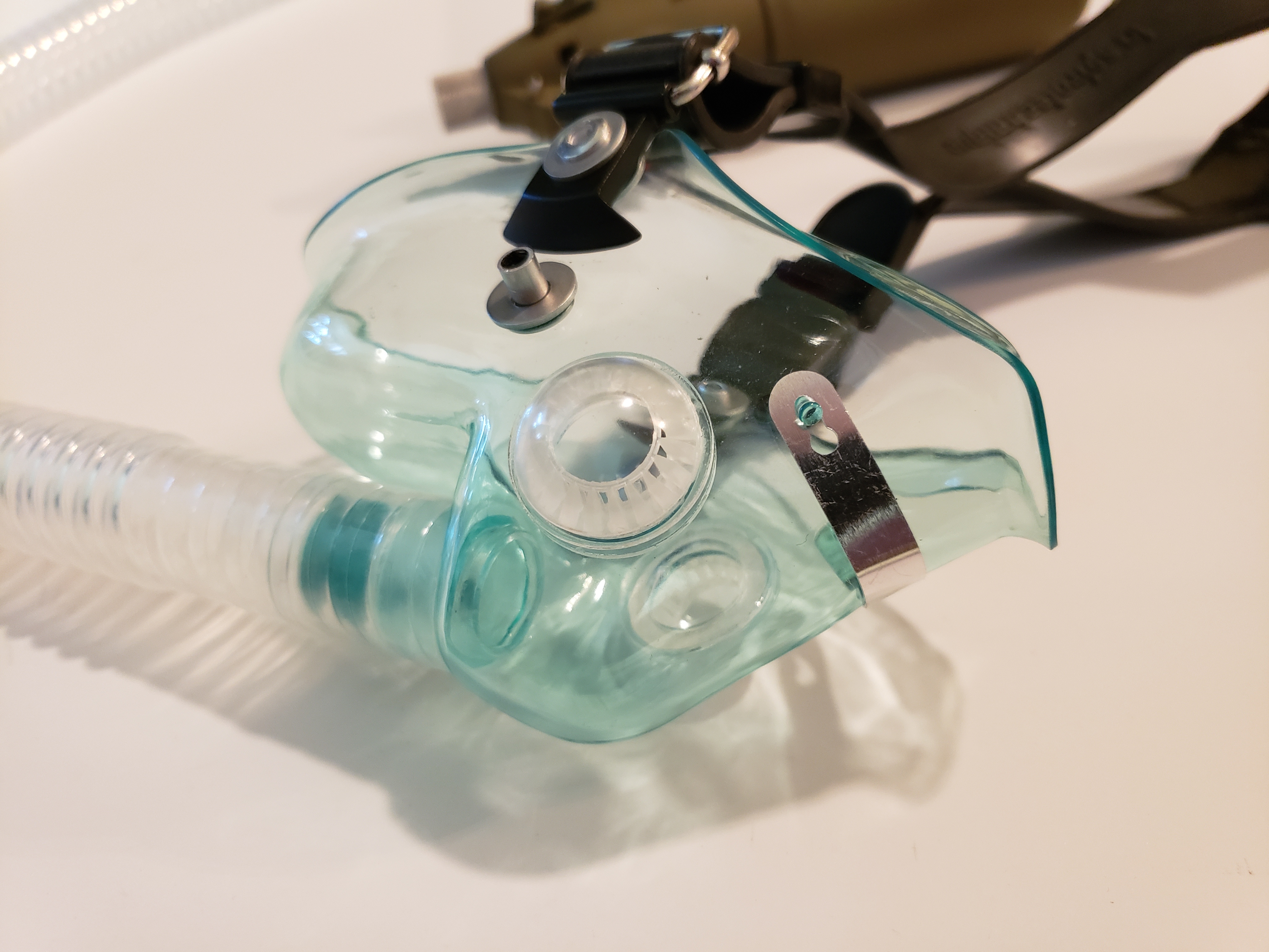

I modeled and printed a few parts for a mask sent to my Secret Santa recipient. Check out ESB Mynock Cave Oxygen Mask parts by wesaj for strap attachments, strap keepers, a spacer for the vent to center and support it in the holes in the mask, and a spacer to fill the top of the sparklets bottle. Apparently I forgot to take any pictures of it before I sent it out, so here's one from my recipient.
If your mask strap splits, gorilla glue is awesome. Mine split also. Gorilla glue repaired it. Its strong too

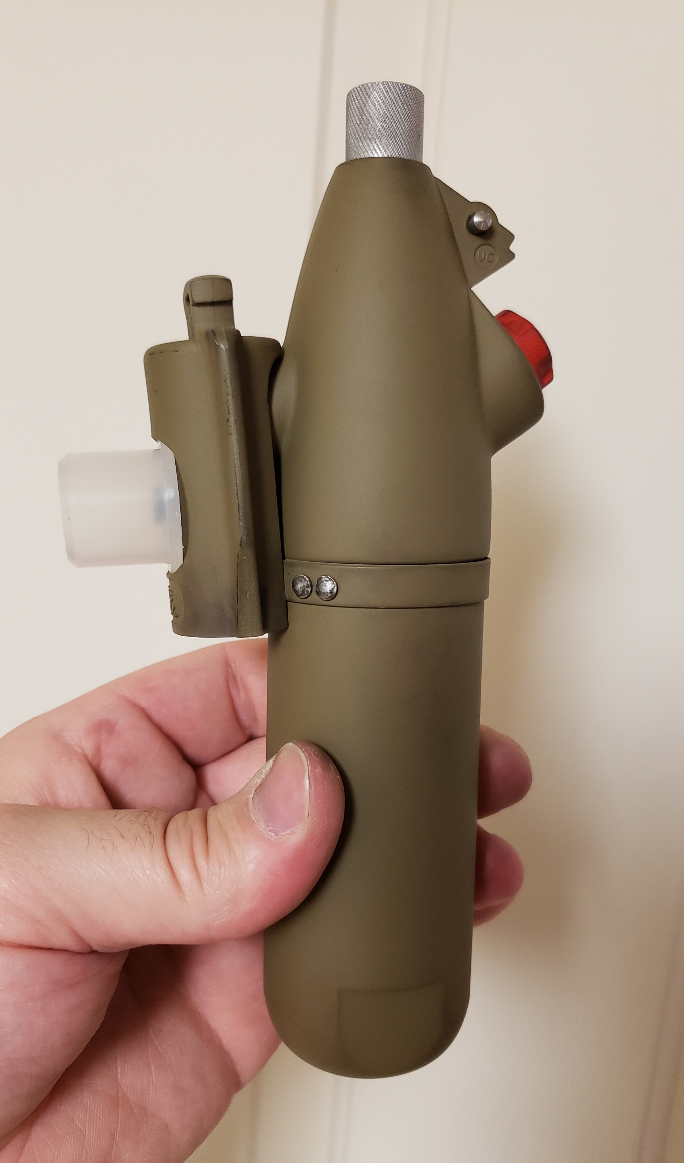

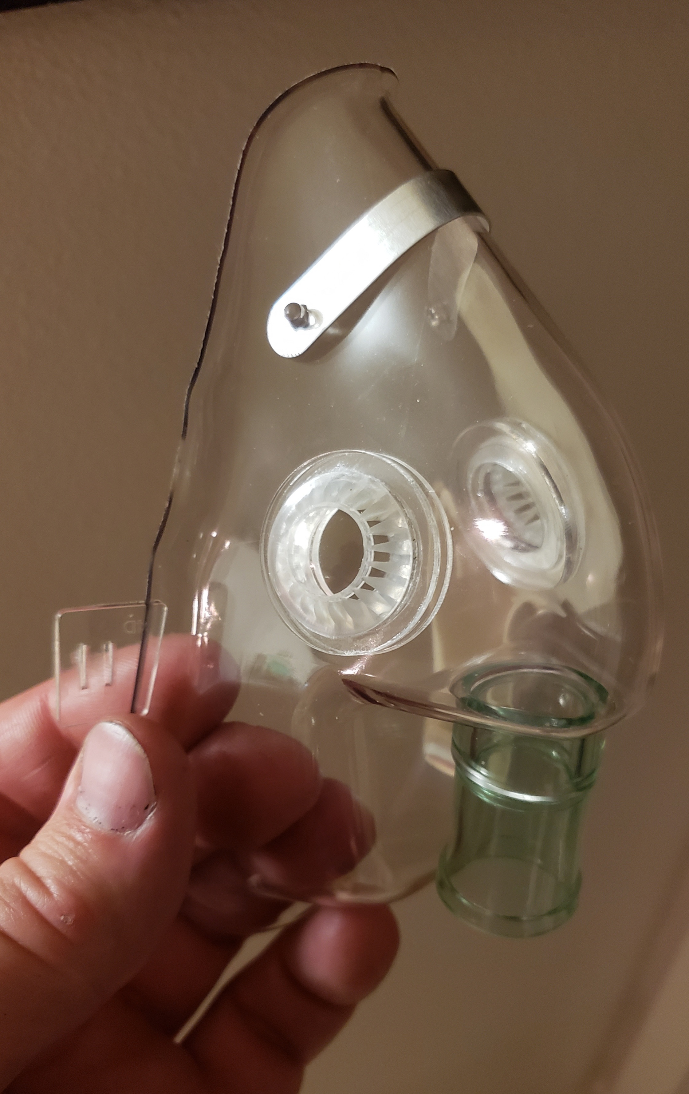

woodywaverider
Ok I don't have the exact hose because ordering that thing unless I'm a medical practice ain't going to happen. This is my Leia mynock cave respirator. The vents I made will have to do until we find out what those are. Thanks everyone for your input, help, and research. View attachment 1474941 View attachment 1474942 View attachment 1474943 View attachment 1474944 View attachment 1474945 View attachment 1474946 View attachment 1474947 View attachment 1474948
Looks amazing, very well put together, I actually have a sparklets syphon, so thinking of making one too if I can find the other parts, what did you use for the metal posts/washers next to the strap?
woodywaverider
Looks like the site with the spoons has gone, so looked for an alternative, found this chocolate mold with 24mm hemispheres
Also for the michael’s knob, I know Cameron used part from and extraco knife, I found these handles for £1 that are 14mm
I found the threaded part on my sparklets head has been glued in, not sure if that was from manufacture, or latter on as a repair? I’ll try some heftier grips, but if that fails I’ll have to cut/drill it out.
Have a bulb holder ordered (fingers crossed it is the right one)
Still need to find the correct vents, have some promising leads, but nothing confirmed yet.

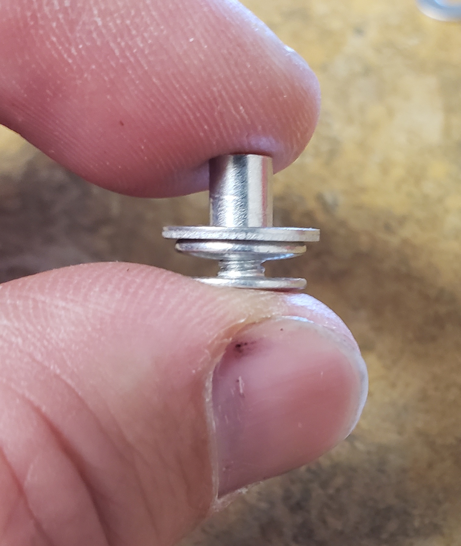

Ryan Clinton
Looks amazing, very well put together, I actually have a sparkler syphon, so thinking of making one too if I can find the other parts, what did you use for the metal posts/washers next to the strap?
Thank you very much, the posts are aluminum Chicago screws. I painted the inside so you wouldn't see the threads. I filed down the flange of the screw so it was very thin. Then I glued the aluminum washer to it. Aluminum has a more accurate color. Then I just drilled a hole and screwed it in place.
