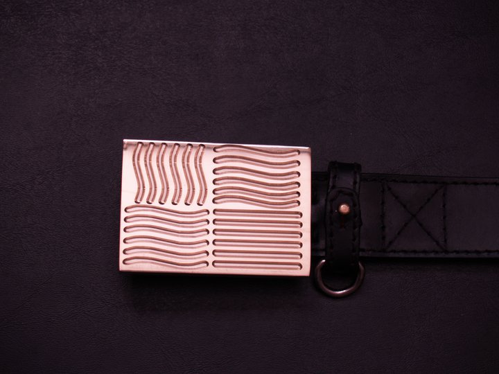

Saw the other threads going on this prop and just had to make one for my self.
I machined this from solid brass. I will probably machine it from the back to bring it down to a thickness that looks closer to the real buckle. Right now it weighs about a lb.
Polished up it looks really good, but the whole Idea is to make it look old, so ill probably let it oxidize.
Really nice looking, did you start with a CAD file that was then tossed into a CNC setup? Or was all of the carving done by hand?
I did it in CNC. Only took about an hour to machine. But I was only running at 60% speed because I was not sure how smooth the cut would be.
I used Rhino to place the screen shot of the buckle in the back ground then traced the lines on top. I based the size on the brass I just happened to have in the shop so I set it at 2" x 2.75 inches. So it is scaled a bit to fit my belt.
