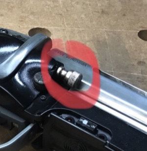

Got a question, did you manage to unscrew the „whateveritscalled“
Read somewhere that it’s hard to remove, haven’t really given it my 100%, but I couldn’t move it an inch, feels like I would break it if pushing it to hard.

Ah, no, I left that alone. I actually thought I'd read it was molded in, and I don't need it to be "a real one." :)

It is called a "binding post" (from a military EE-8 phone) and you can remove it carefully with a pliers turning it left and right.

Right. Binding post (I didn't have quick access to my parts list when he asked and I wanted to say weaver knob, but knew that was wrong!) Good to know! Actually I read the whole tips thread yesterday and found that out. Still not planning on replacing it though, personally.
The Binding posts on Tomenosuke are just friction and pressure fit in, they can be removed. Problem is the hole on the Tomen is too big for a real one. What you would need to do is fill with epoxy then when the epoxy is starting to harden screw the Binding Post in, let it harden, then slowly work it back out. It will create some threading for it to use so you can screw it in and out. I do the same for my Weaver knob when I had to redrill/tap for the real one since I accidentally grabbed the wrong size tap.

That's incredibly useful info! Thank you :)
