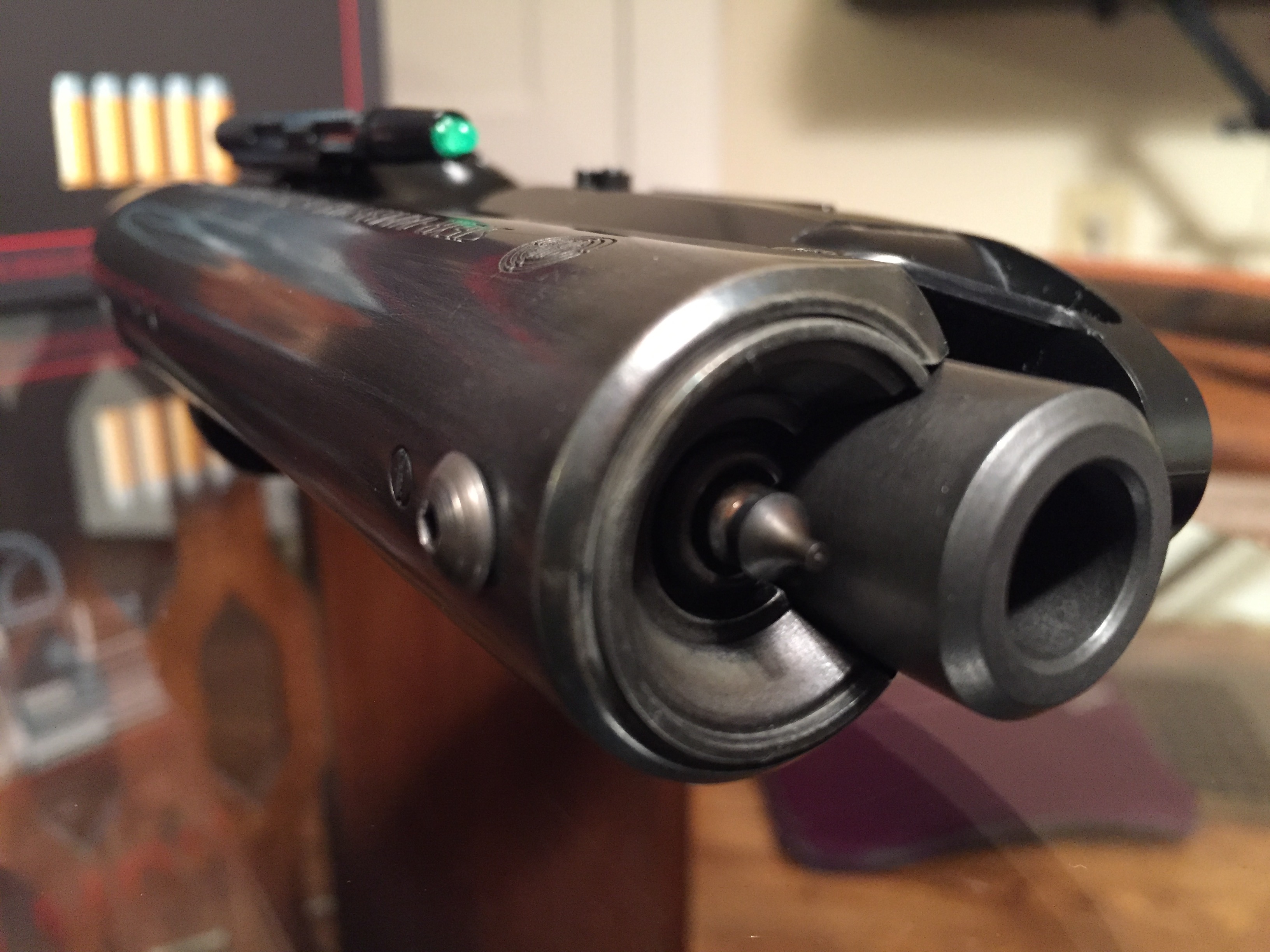

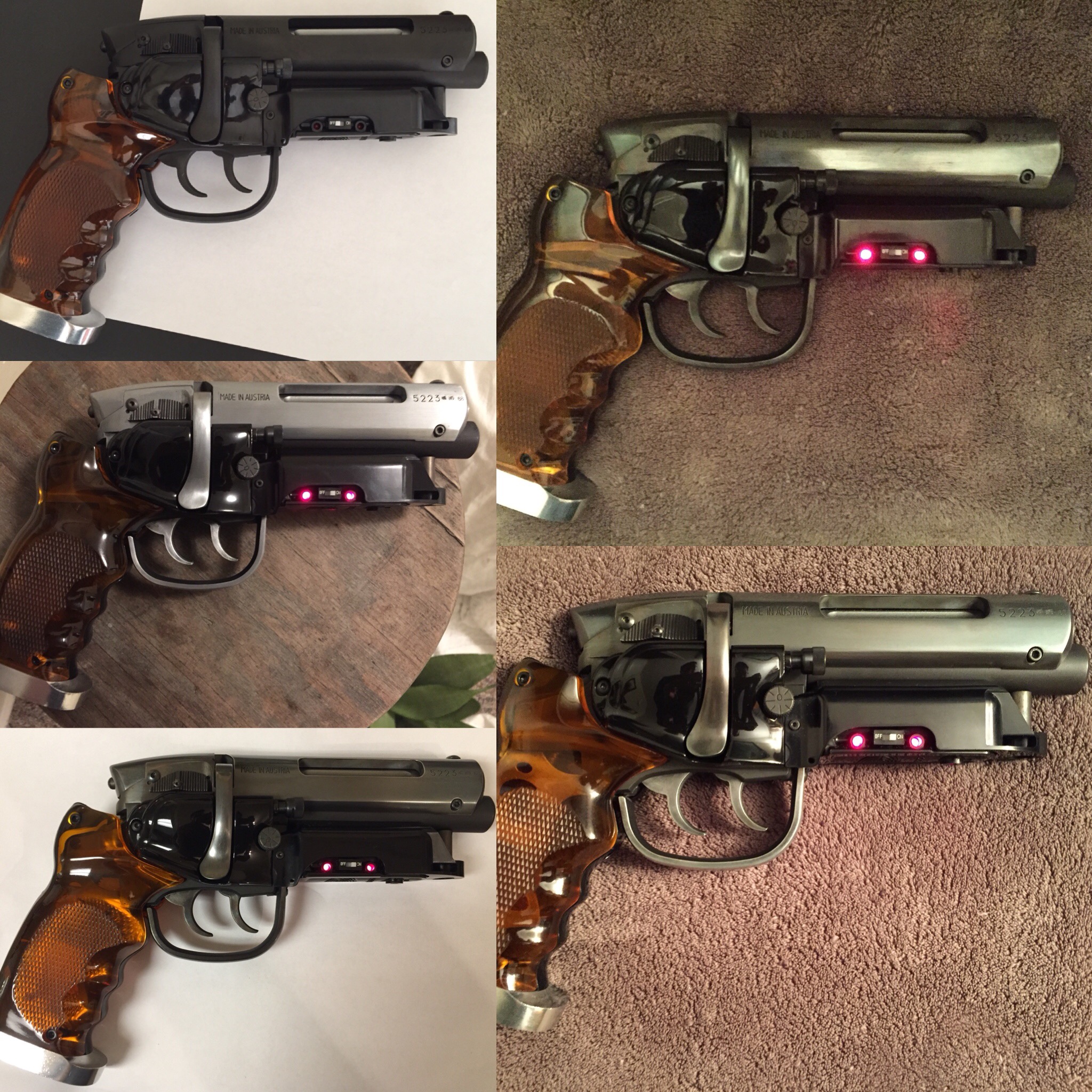

Okay, per the discussion above: I've taken a "work with what I have" approach and used *only* 0000 steel wool on the barrel and bulldog frame to bring out that metal flake (I tried very hard with sandpaper but, again, didn't seem to be accomplishing anything.) I haven't done any bluing yet as I'm out of Perma Blue (more is on the way), but I'm already immensely impressed by the shiny gray the barrel now has. Again, this was accomplished on the stock parts with a steady, even scrubbing of 0000 steel wool. I did use sandpaper (400 then 600 grit) to remove the black from the interior frame, since that was supposed to be silver shining through the grips. Here's how my blaster's evolved over the past two weeks since I received it—larger pics on the first post. More to come.

Who wants some glamour shots? I finally got my Barricade Rust Preventive and Johnson's Floor Wax (a great, cheaper alternative to Renaissance Wax), so I was finally able to oil and wax the metal pieces. Here's what we're looking like right now. These photos should look familiar to anyone that's studied Karl's (or the other photos included in the Tomenosuke photo booklet)... I basically copied those. :) Enjoy! I know there are a few rough spots (and I should probably clean up the fuzz in the trigger area), but I'm so happy with how this is turning out. I'd like to add some wires for the laser sight, though I won't actually be wiring it up.... can someone suggest the proper gauge and type of wire I need? I saw a post a while back that said to use 28 gauge teflon wire, but I honestly have no idea where to even get that. Help, as always, is appreciated!

And the rest of 'em... I don't think I'll have anything to add at this point until I get those wires, so again, if someone can advise, I can continue on!
Absolutely beautiful! Been bedridden with a monster flu so I haven’t done much on mine. Will follow your steps as soon as I am back on the bench.
