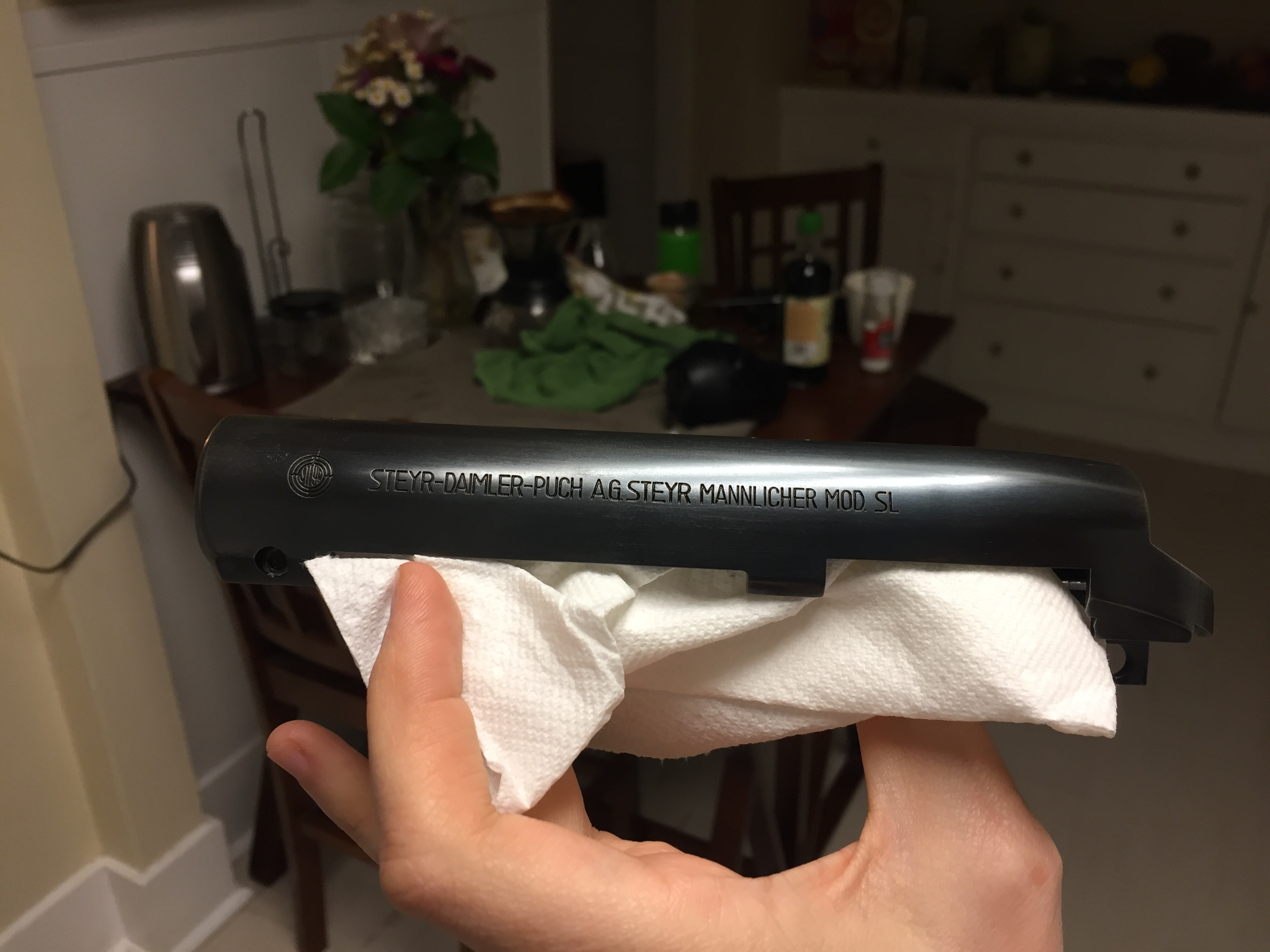

BLUING
4) Now onto the bluing stage, but first, an important question: do you want your blaster to be gray or blue-gray? The steps in the bluing process will be the same regardless, but the oiling and waxing step will be different, so skip ahead to "SEAL IT WITH OIL AND WAX!" if you'd like that info now. I applied Birchwood Casey Perma Blue using cotton pads/cotton rounds (from my wife's makeup bag, naturally) for the base coat, then wiped down with dry paper towels to help even out the finish. The fluid will cause a reaction right away and it can be difficult to remove splotches/dark patches if you try to cover too much ground at once, so you can either touch up those spots by applying more fluid and then immediately wiping it off with the paper towels, or you can finish bluing unevenly and use steel wool afterwards to blend the finish. If I had figured this latter point out sooner, I probably would *not* have used an entire 90ml bottle of Perma Blue on a single project. Anyway: when you first start, your finish will take on a rainbow hue (like when you see a patch of motor oil on the ground.) Don't worry; this is normal. Applying 5-7 coats should get you to an acceptable color.
**Pro-tip I discovered when trying to smooth out rough spots: if you skip the cotton rounds and add your bluing fluid to a paper towel, it's easier to work out the smudges as you don't have to frantically find a clean spot to put down your cotton pad and then try to grab a clean paper towel before the chemical reaction is complete. Using a wet (with bluing fluid) paper towel also helps add a bit of an aged look, as while you're rubbing the parts with the wet part of the paper towel, you're also rubbing it with bits of the dry part at the same time. I'm not sure if I'm explaining this correctly, but give it a try if you want; you may find you like what you see.**
5) Once I'd finished bluing, I used more 0000 steel wool to gently rub out any remaining uneven patches/dark spots. Tread very, very lightly here as the wool will undue your hard work (which is a huge pain to fix!) if you apply anything more than the lightest of touches for this task. Just glide your wool ever so lightly (almost like you're dabbing away a tear from your eye with a handkerchief; what I'm saying is to be delicate, like Roy Batty is with words) over the uneven spots and everything will come together very, very nicely.

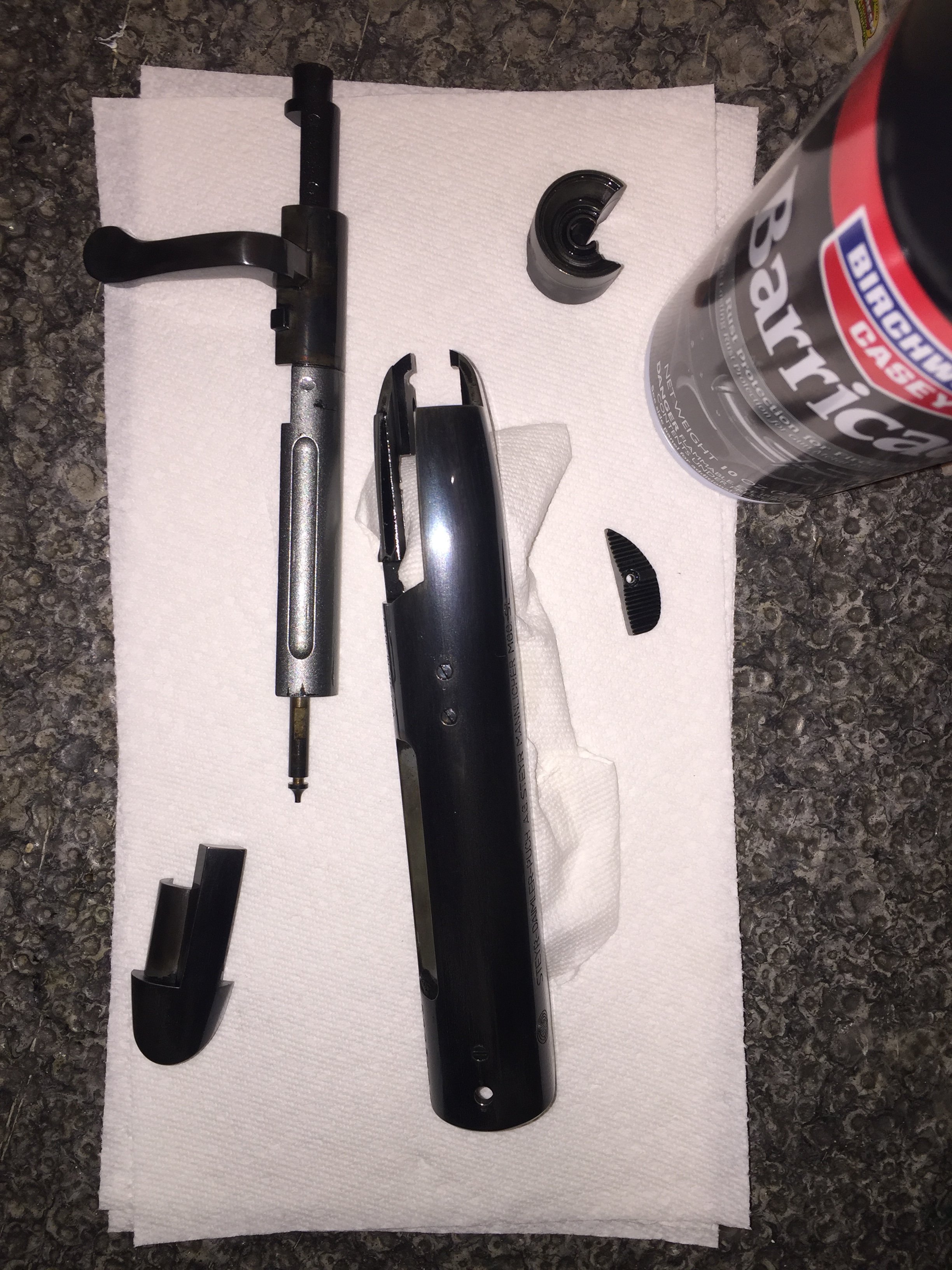

8) To seal the finish, you'll want to first decide whether you're after a gray (more screen-authentic) color, or a blue-gray color. For gray only (my preference), skip the oil and go straight to the wax, which is what I've done since originally writing this guide (after stripping the bluing and starting over.)
Otherwise: I started with an even coat of Birchwood Casey Barricade Rust Preventive oil, which comes in an aerosol can. This stuff smells like bug spray, so please use it outside and away from food (or children!) Coat all of your metal pieces evenly, then leave them somewhere to dry where they won't be disturbed (and where your loved ones won't be abused by the scent.) This will give the pieces a deep, smooth, and shockingly sexy blue-black finish... but you will need to dry it off eventually, so don't get too attached. Make sure to soak up any excess oil that might be hanging off the sharp edges of your parts. If the oil is drying unevenly (or if you get smudges or fingerprints while moving your parts to dry), it's okay to spray a little on a paper towel and rub over the uneven spots.
I left this on for 2-3 hours (I know some folks let it sit for days... it's your blaster, so it's your call!), and while doing so, I watched a video starring an older gent with a shotgun, explaining that while both oil (and wax are great for protecting the finish of your gun, the two of them together are godlike. So, after wiping the oil off with a sock, I took my Johnson's Floor Wax and started to apply it over each part, rubbing in little circles. You don't need a ton—just enough to cover every surface you want sealed. Let it dry for 5-10 minutes, then take a non-abrasive cloth (like the kind you use to clean glasses) and buff the wax away in firm, straight lines, leaving a smooth finish that should last for many, many months... probably even longer if you don't handle the blaster regularly. Note if you skipped the oiling phase because you wanted your finish to be gray instead of blue-gray, the gun won't be protected as well... but since you're likely going to have this on display somewhere inside rather than leaving it out in the rain, it's not going to matter all that much. Choose whichever you prefer, and don't be afraid to start over and re-do it if you want to try a different look!

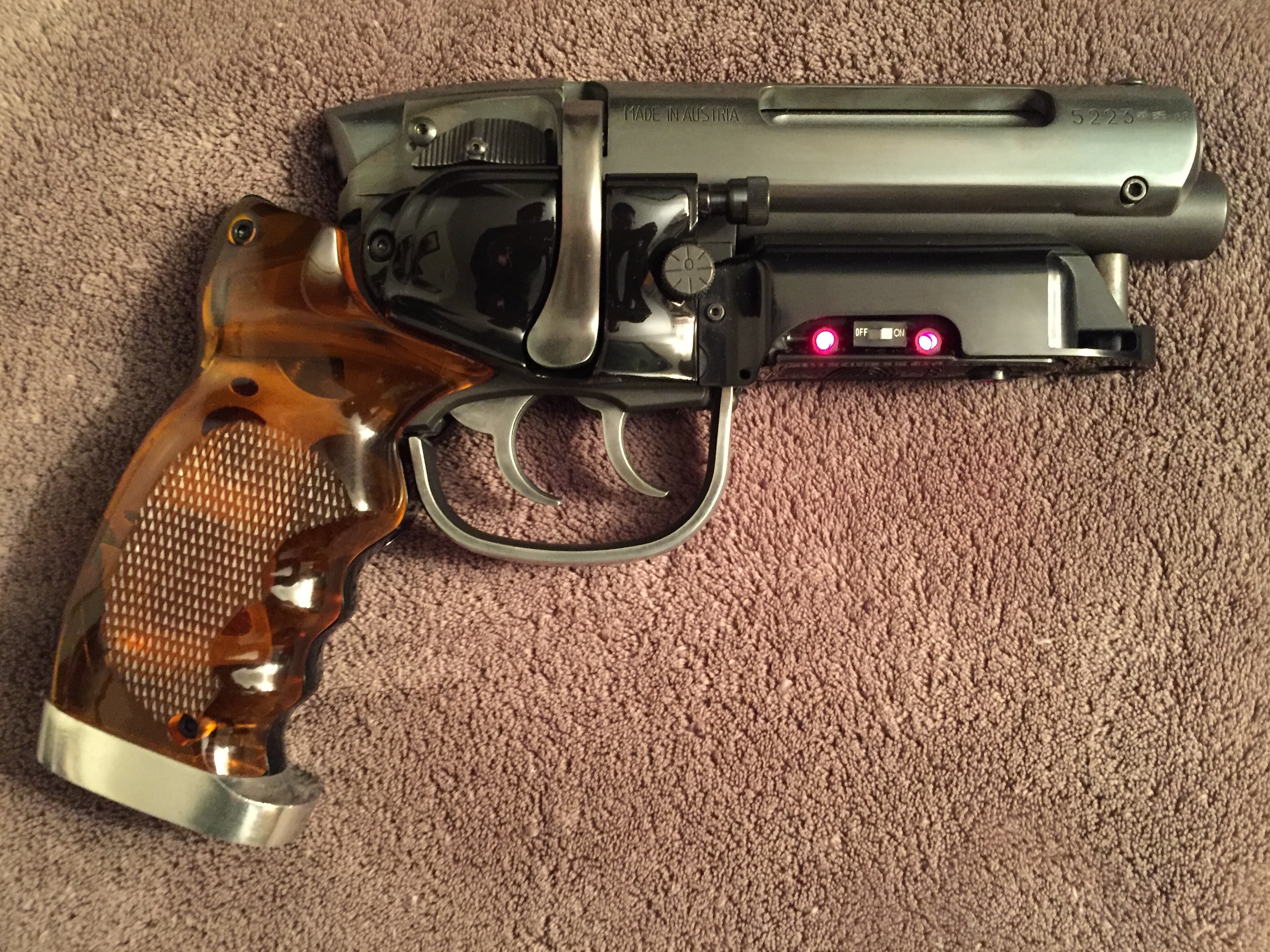

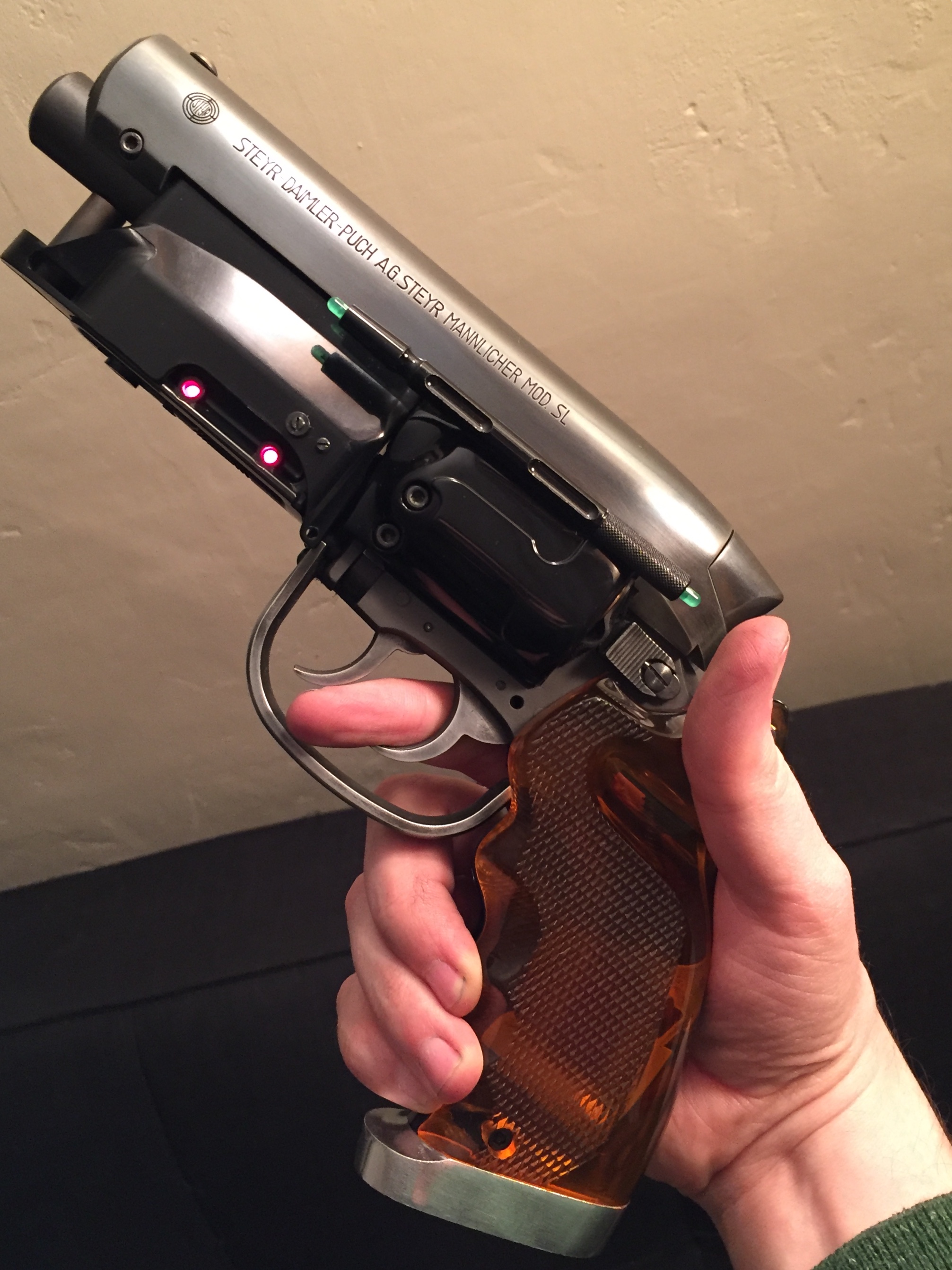

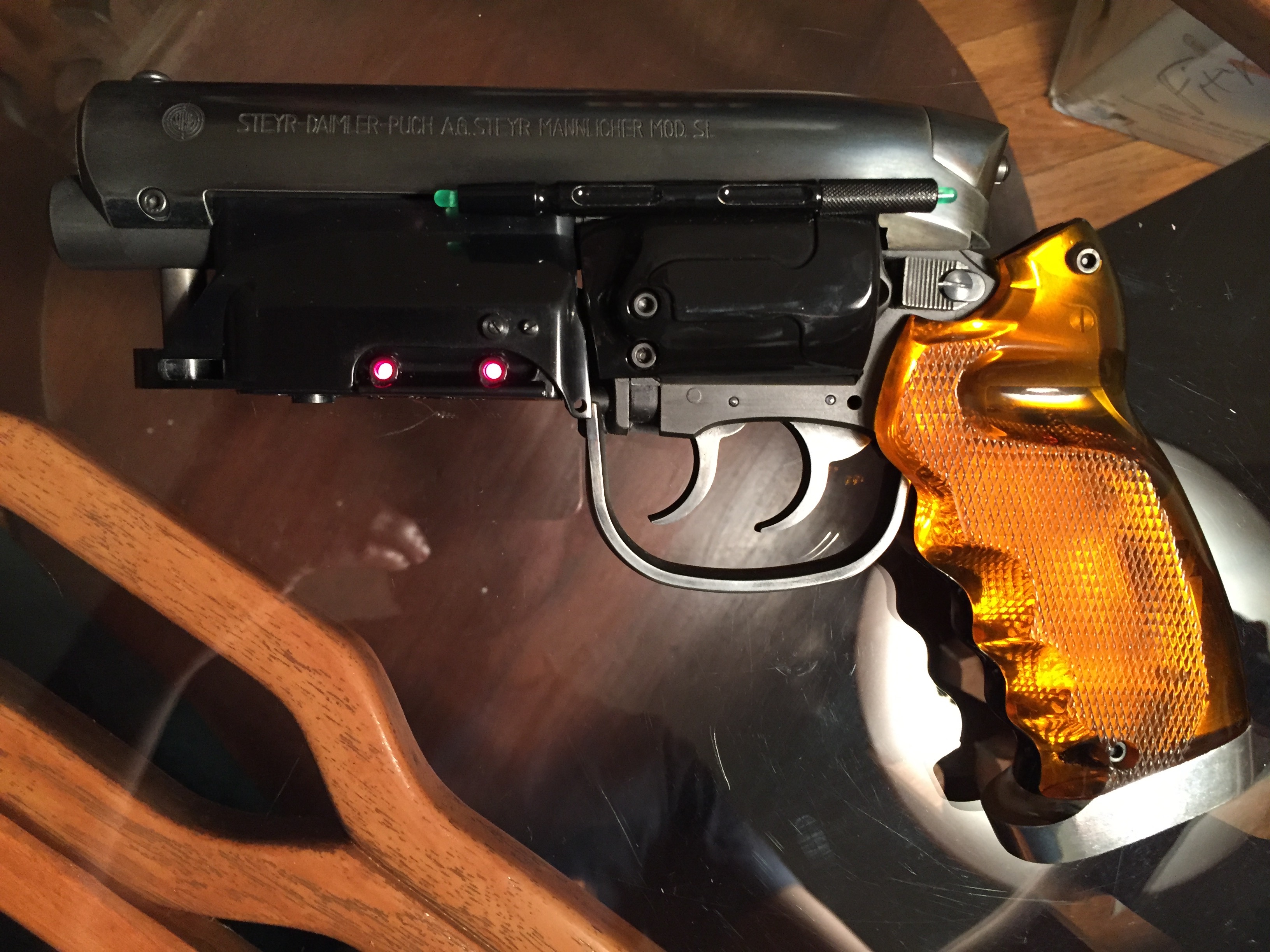

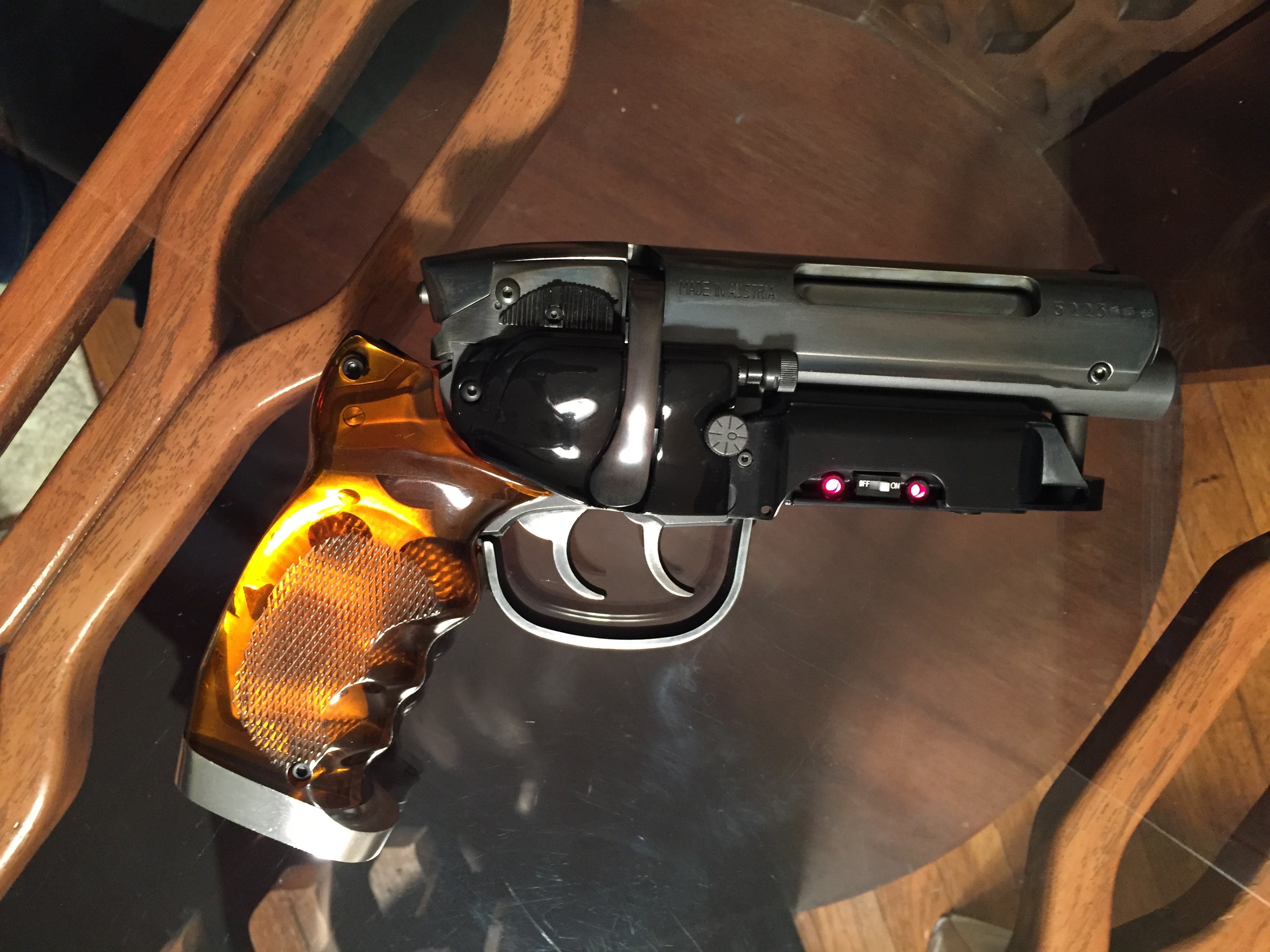

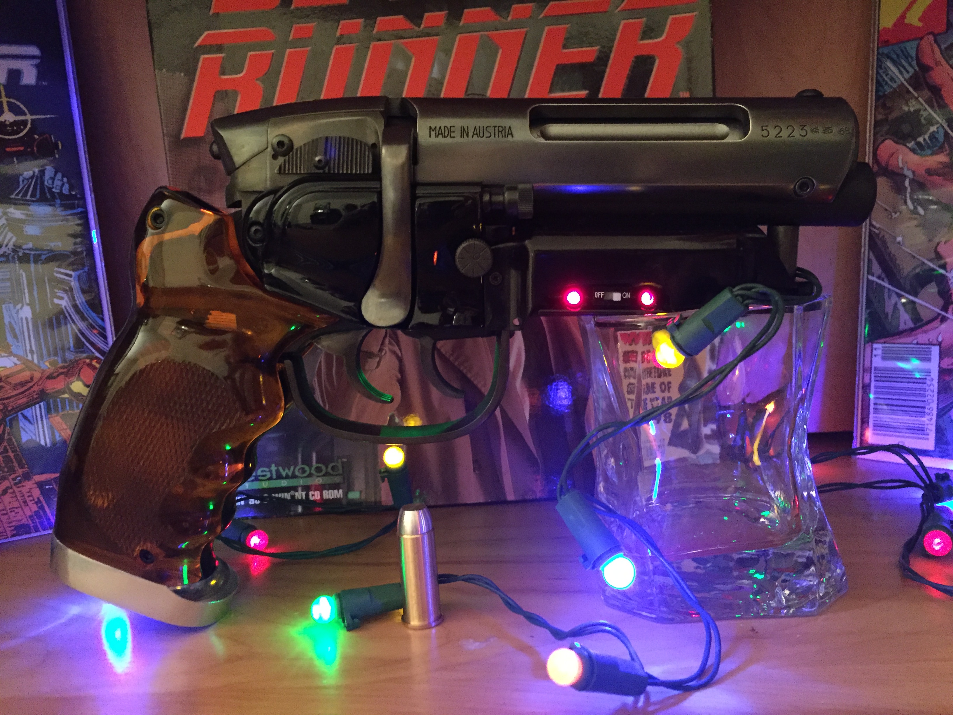

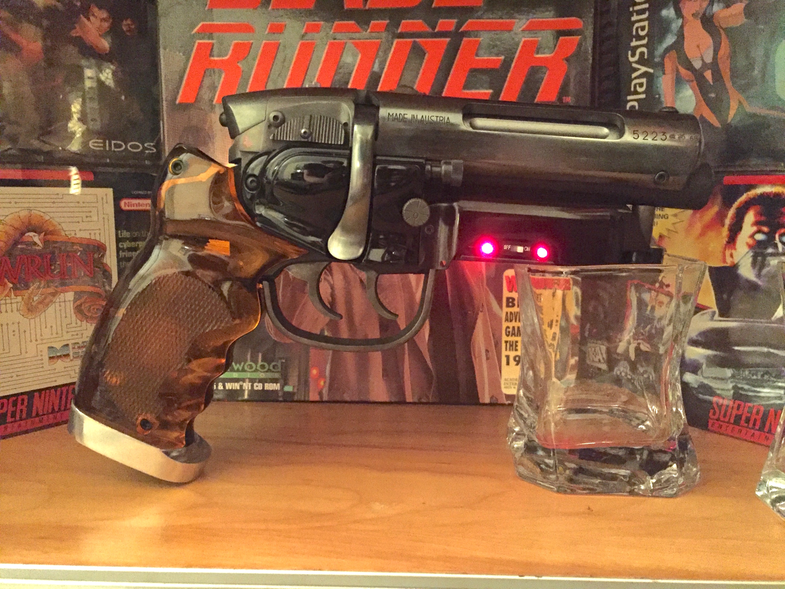

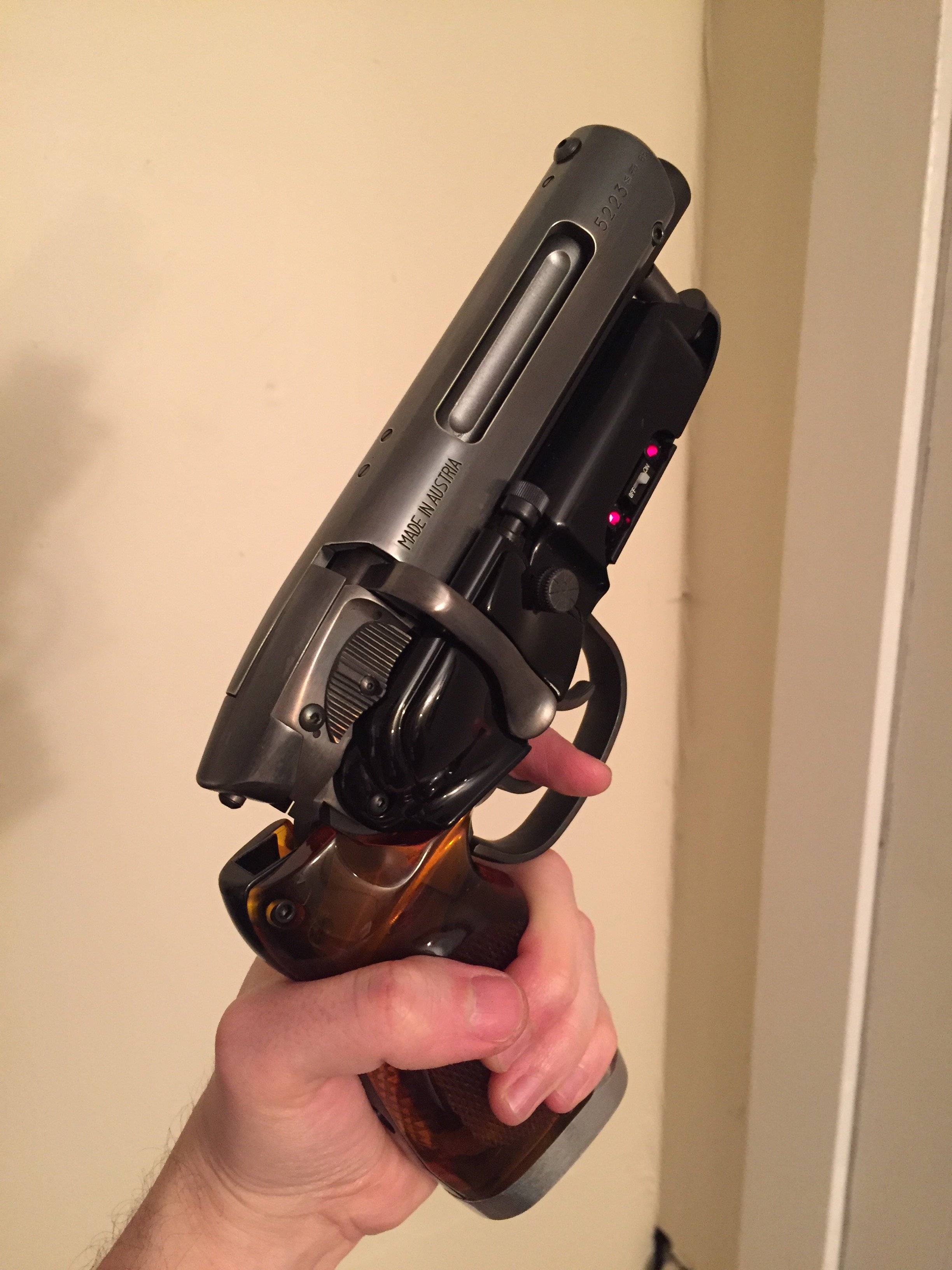

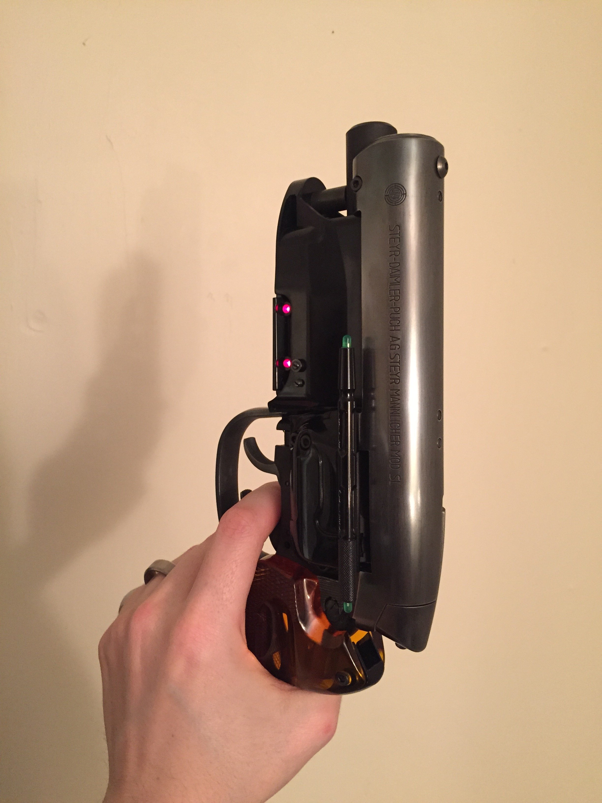

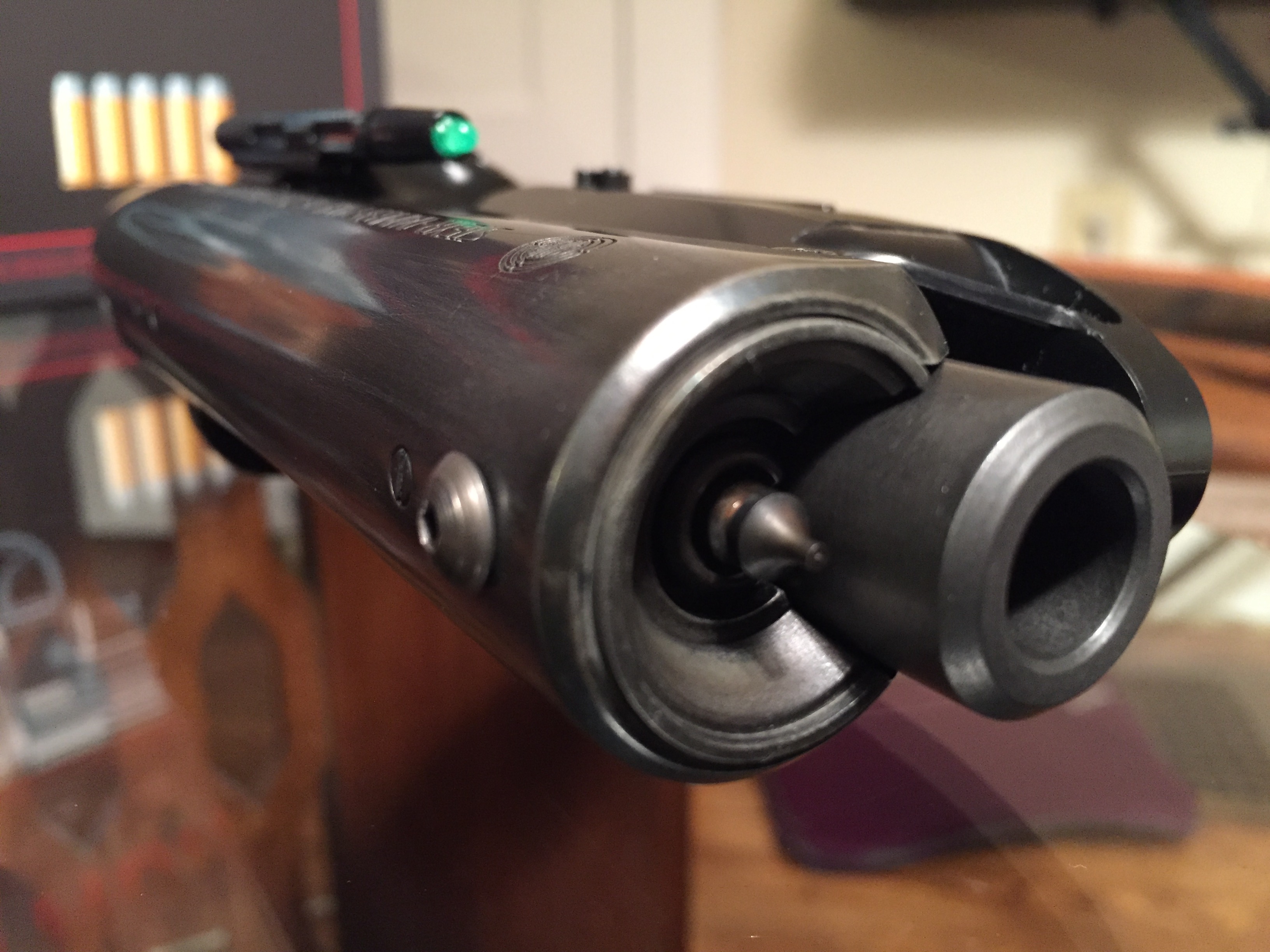

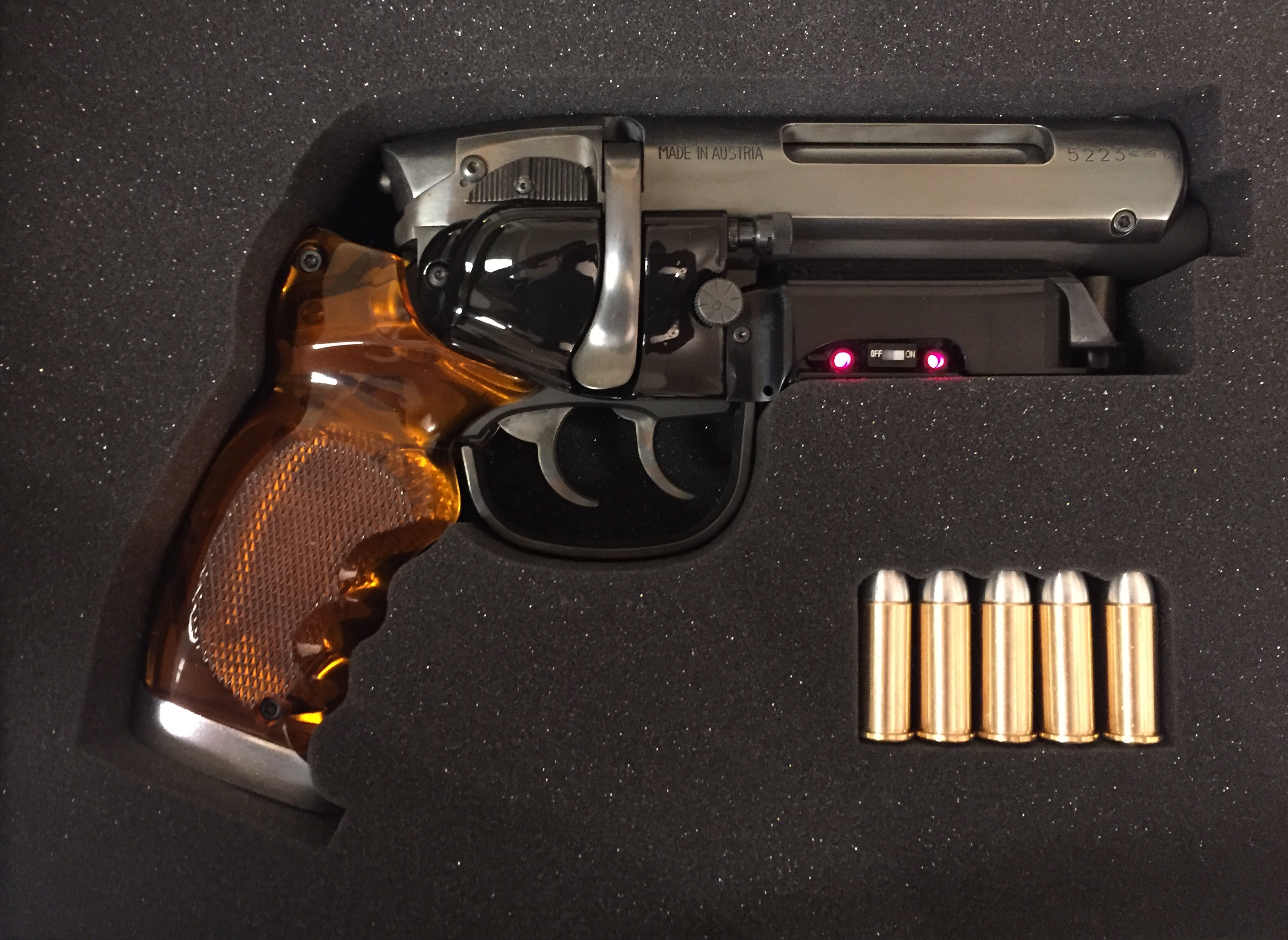

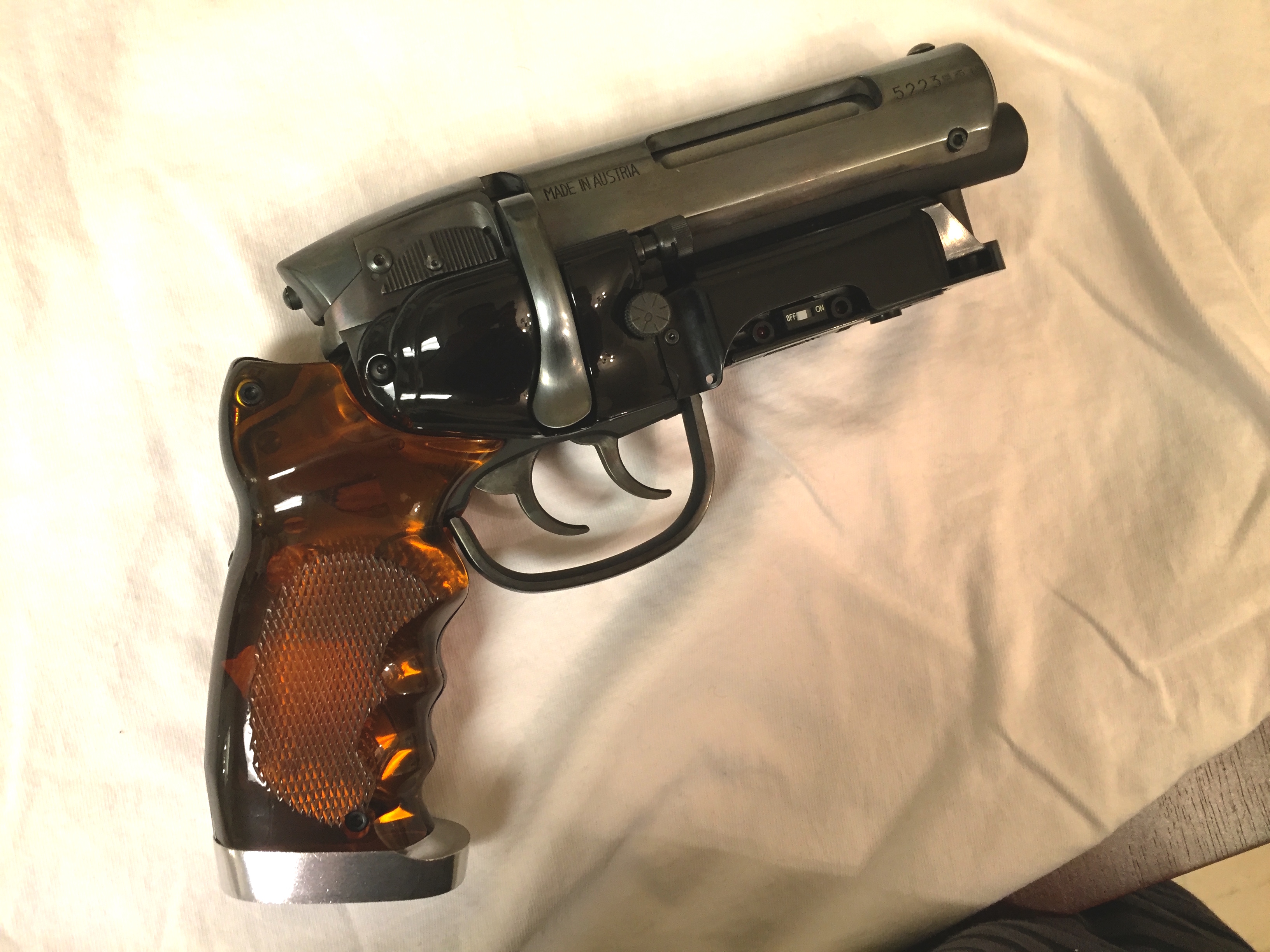

UPDATE 3/22/18: some post-cleanup shots, experimenting with different lighting to see how the blued steel would absorb different types of light.

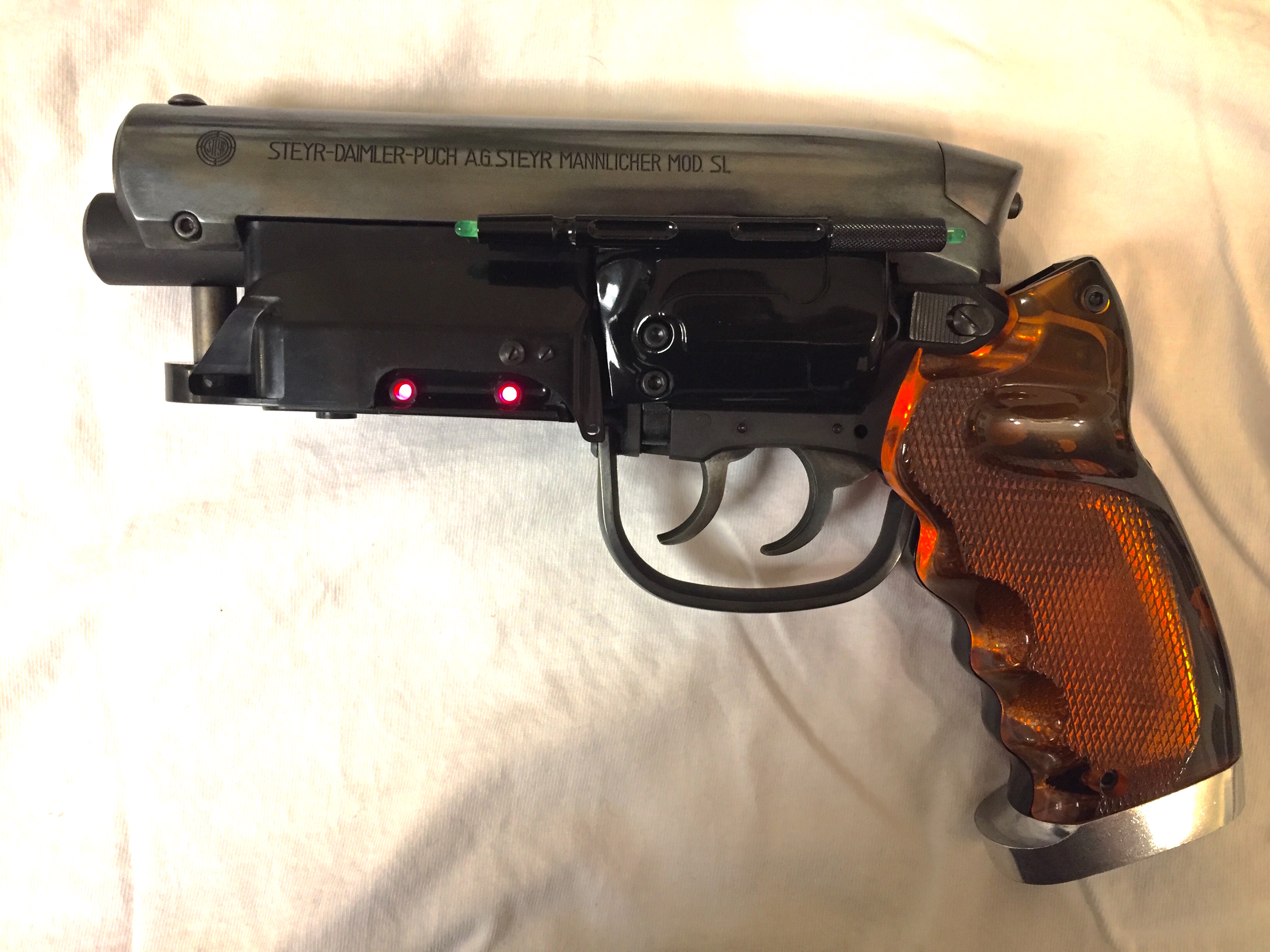

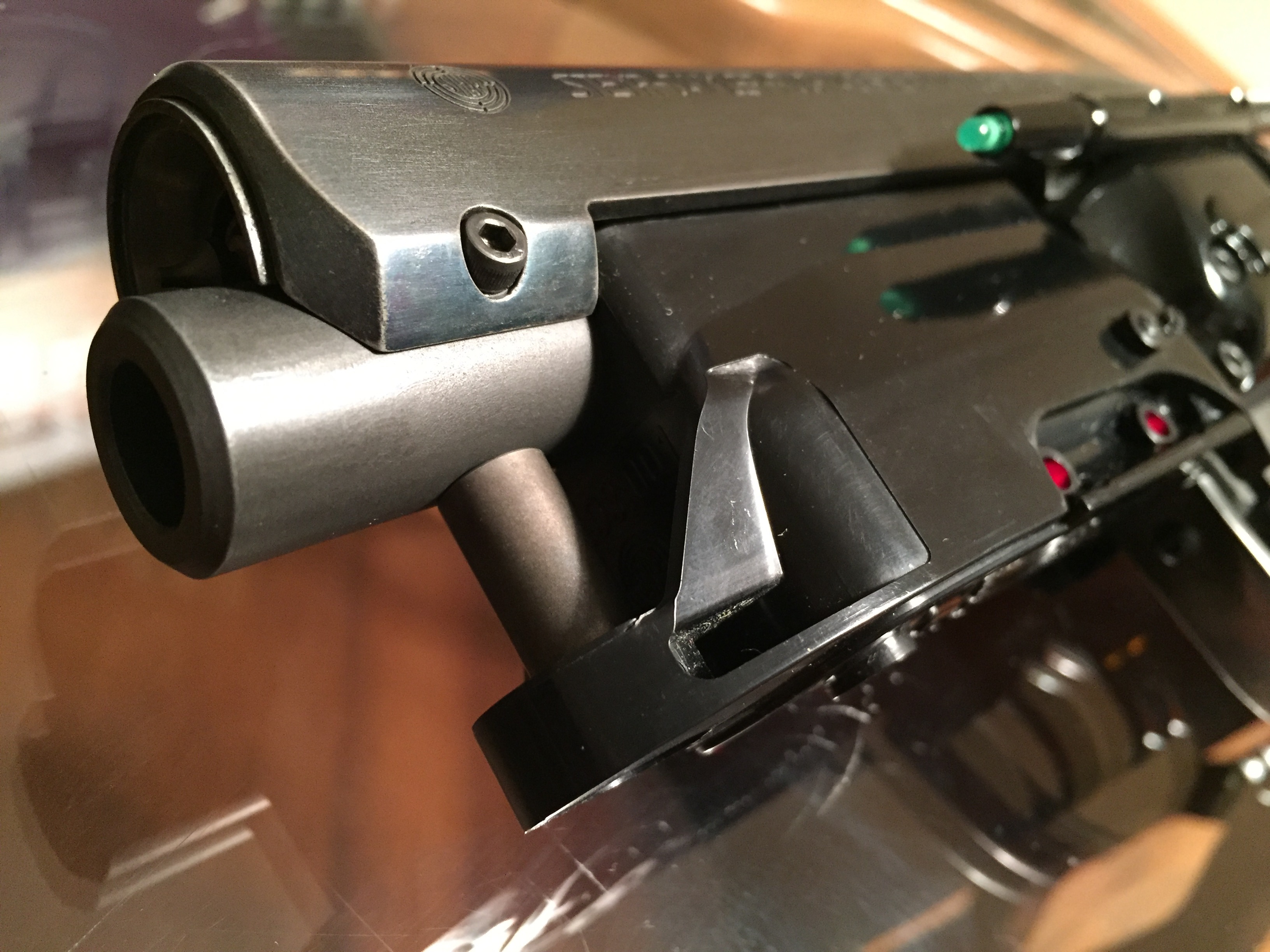

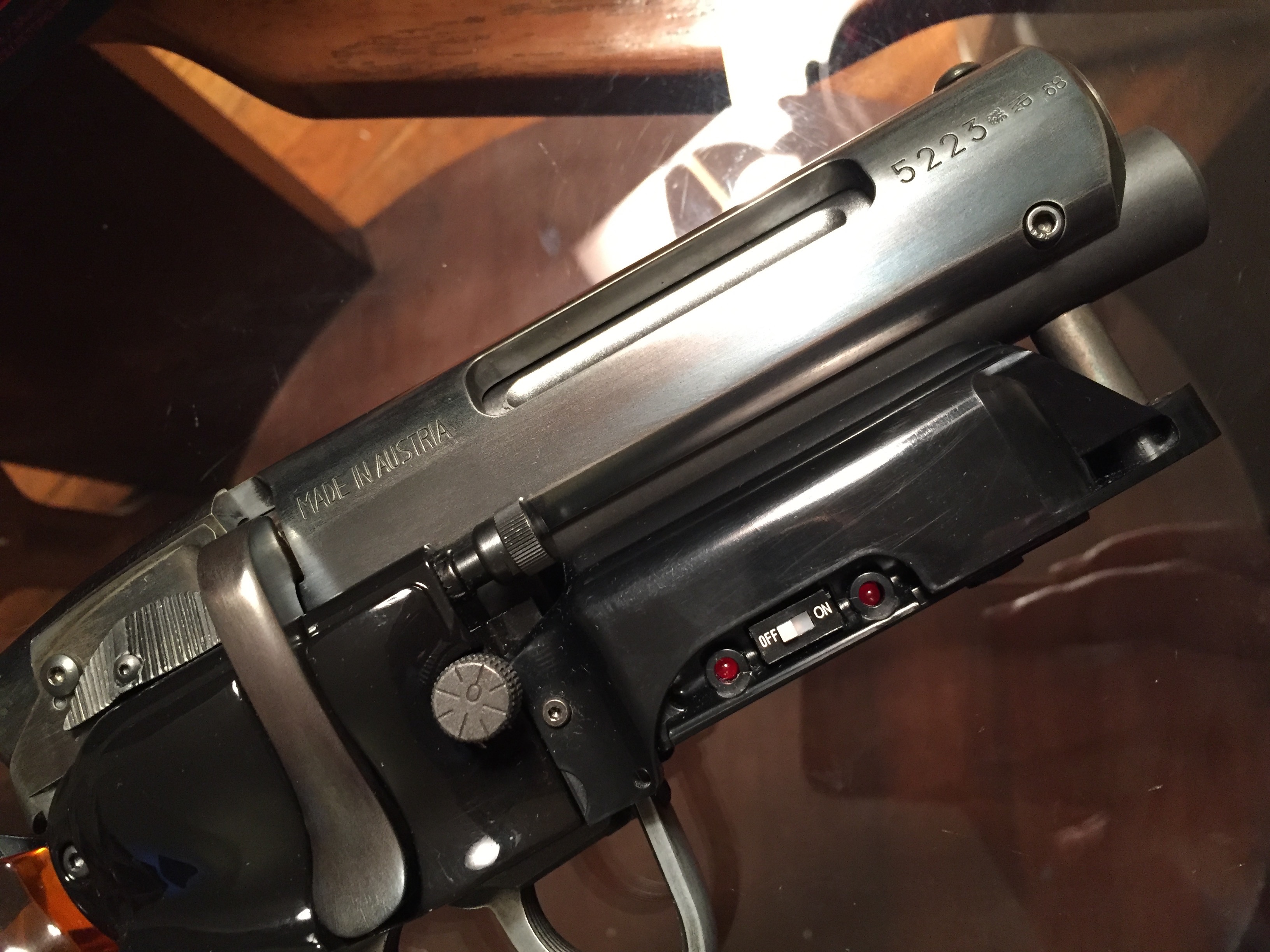

Updated 3/26/18:
More progress! A few days ago, I scrubbed most of the blueing off the trigger guard to get a mostly silver/dirty look that matches what's seen in the movie. Then today, I rubbed the included bulldog frame and barrel down to a deep gray shine using 0000 steel wool. I haven't blued the frame and barrel yet but already it's looking gorgeous (though it really makes the blue in the Perma Blue on the receiver stand out.) I also sanded down the frame handle underneath the grips so you can see the silver underneath. I did a rough job at this just to see how it'd look once I re-installed the grips, but will need to do some aggressive sanding to clear out some black pits in the metal. Not a priority... at all. Once I get the blued parts sealed, I might add some wires next. Have to get 'em first, though!
UPDATE 3/28:
Oiled and waxed!
View attachment 805955 View attachment 805958 View attachment 805959 View attachment 806004 View attachment 806008
