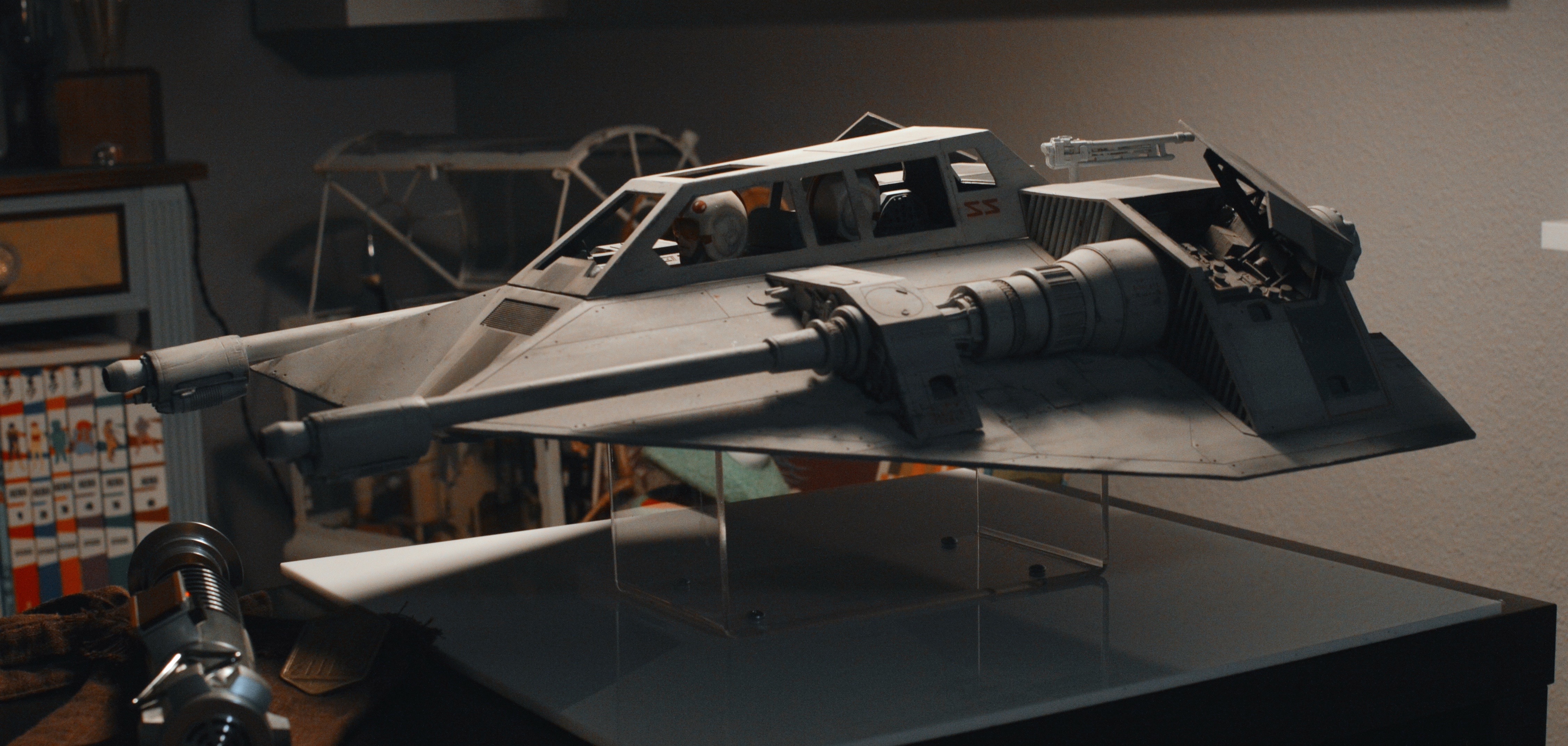

I’ve been working on this Nice-n snowspeeder kit for a couple of months now. I’m taking my time with it, being my all time favorite Star Wars vehicle, I wanted to make sure I’m happy with the finish. Some modifications were made to the model, the biggest being a new scratchbuilt canopy. I’ll be rebuilding the opening flaps on the engines, as the resin ones came very warped; probably easier to just build new ones out of styrene. Overall, it’s a beautiful kit—and a heavy one too.
The cockpit and canopy have yet to be glued down. I’ll be doing that once the bottom of the ship is all painted up. I’m also modifying the pilots to fit better inside the cockpit.

Small update: made orange tinted goggles for the pilots. (The other guy is still being painted). It was a much needed detail! I sculpted a little buck out of epoxy putty found at the hardware store, and used a heat gun to form them from cut pieces of trading card toploaders—they were just thin enough to do the trick. They were then tinted orange with Tamiya translucent orange spray paint (Really cool stuff).

Thanks! For the base coat, I used a combination of these three Tamiya colors. I don’t have an airbrush, but really love these Tamiya paints. I just start with the AS-20, and then will do alternating mist coats with the AS-16 (which warms it up slightly), and a bit of the darker AS-2. The weathering over the top (various layers of light mist coats, enamel (a couple Archive X colors; weathered black and engine black), and also the occasional pastel for helping with gradients) significantly shifts the color as well. Generally, I try to create a surface that has a lot of subtle contrast in it from the weathering. Matte clear coat—either Tamiya or Mr. Super Clear—is applied during the process to help seal the finish. The final result is a very matte, almost ‘dusty’ looking surface that I really like. For the darker panels, I just made a custom mixture from a couple tubes of Vallejo acrylics and brushed them on.
When I finally finish up this model—just need to weather the rear and bottom hull—I’ll take better photos under more ideal lighting conditions.
