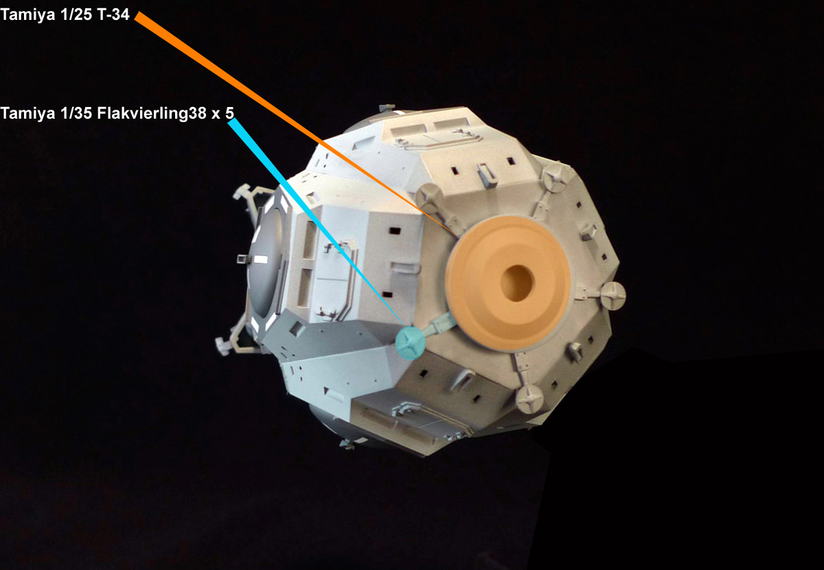

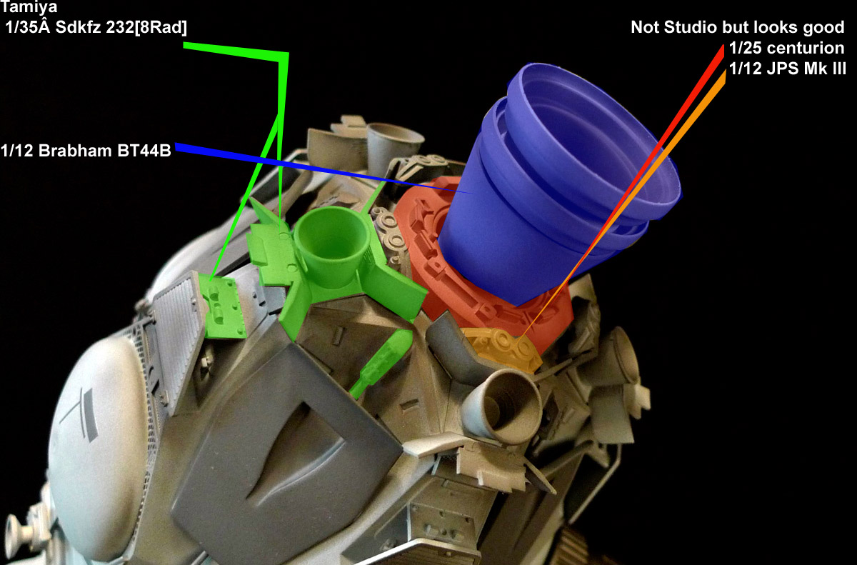

Well here goes my first endeavor into SS modeling. Be gentle I'm a virgin SS modeler. I have almost all the kits I need to do both the pods and have been sitting back going through all my kits and matching them up the part maps im putting up aren't complete but I figure I would show you were I am anyone on wanting to point out a part here and there I would be happy for the help save me some time. Here is pod 232.

Thats the spirit. The small parts mounted to the Plastruct domes are from the Flakvierling, and the finned round parts inside the Plastruct shades on the rear, are from the Karl buddy.

Went ahead and updated the maps a little. Maybe you guys can help me out here. I'm quite sure I know the correct part here but for some reason it just wasn't looking right to me. The part between the 8rad and the mercury vapor lamp I believe is a flak38 part but I wanted some confirmation on here. Also I'm planning on getting a nice big order of plastruct parts for my current and future builds anything that when you guys do a build up on here always seem to run out of that you would recommend getting.
