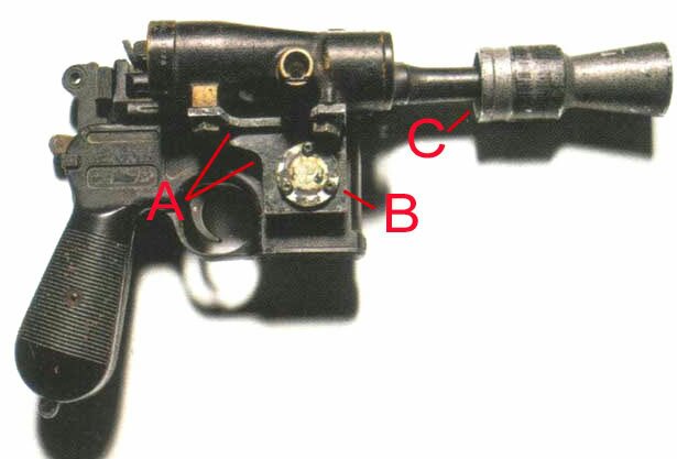

I hope you're planning to recreate the crazy Hoth scope mount.
You know, this crazy thing.
It's a little smaller than the Bespin mount, has the different mounting hardware with the three little hex screws. Possibly more curves involved where the feet come out for the scope to sit on, etc.

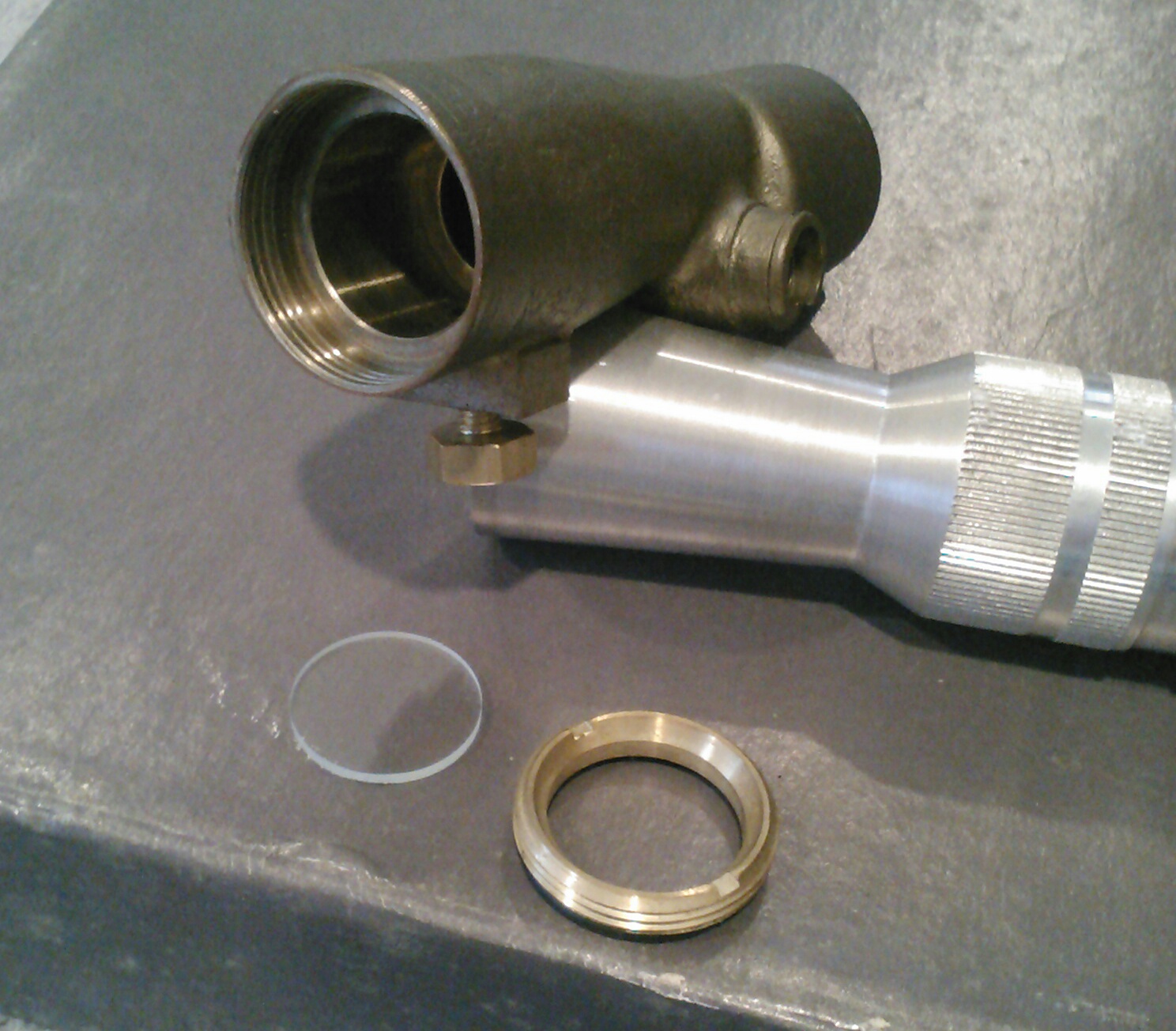

Think Jedi has confirmed that he will provide cast brass M-32 scopes and pistons
His preliminary prices are $80 for the scope and $20 per set of pistons.
These prices are only slightly higher then the last time I did this version which was more then 10 years ago so I am very excited about that considering how much metal and fuel cost have increased
All of the scopes will need some basic machining to remove the sprus and to drill and tap the feet for the bolts.
I will also offer a machining process that hollows out the scope body and adds threaded lens rings so we can use glass lenses for the front and back.
I can not remember how much that cost but everyone agreed that it was worth the added expense.
I also had the correct brass bolts machined to mount the scope, they were more expensive then standard bolts but due to their peculiar dimensions (7/16 head / 10-23 threaded section) they had to be machined.
