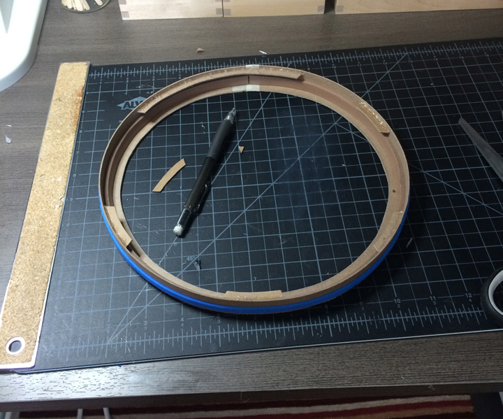

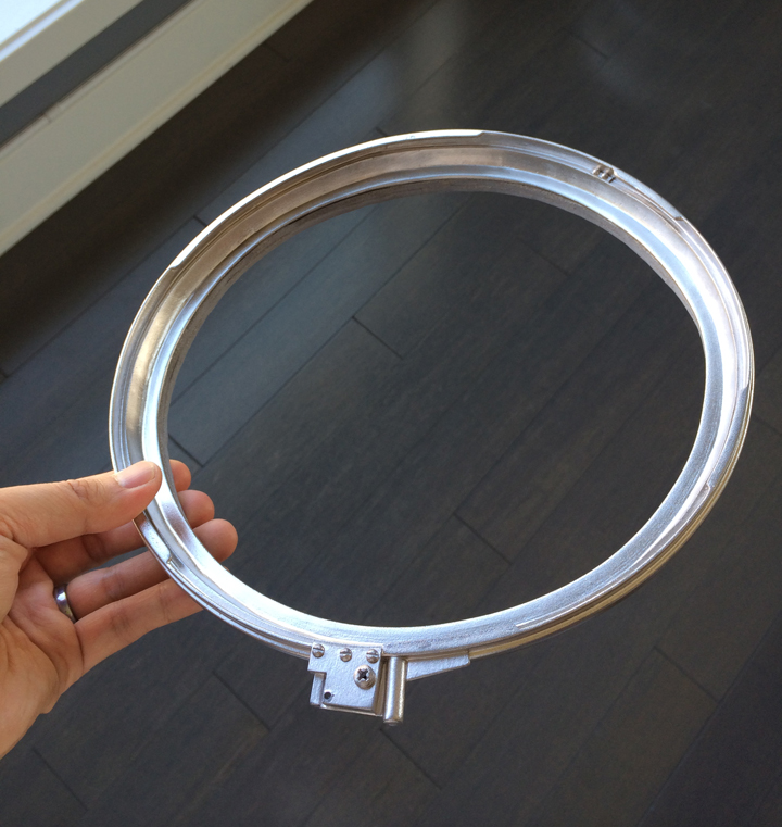

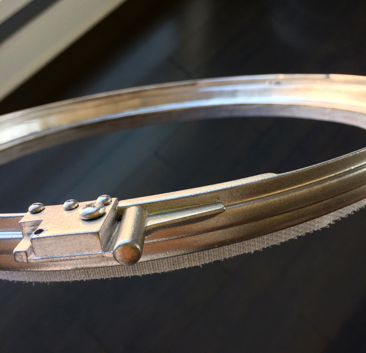

Thanks again for the compliments. A couple people have asked me specifically about the neck ring, what is was made of, and whether or not it was an original part. I had a Navy Mk IV helmet casting from Stephen210, so I used that casting to get the proper dimensions for the suit neck ring, which the helmet sits in. It was a 2 step process. I first made a rough version out of chipboard and EVA foam. I then made a mold and cast that roughed-out ring in resin. I cleaned up the resin ring, added the details, sanded and primed the surface to be clean and smooth etc., then molded it again. The final casting is resin with metallic pigment brushed into the mold. Since the helmet comes in direct contact with the ring, I wanted a more durable finish than paint. The ring doesn't function exactly like the real ring, which had moving parts. It's just a simple twist lock system. The ring then connects to the suit with velcro, which you can see in the last photo.

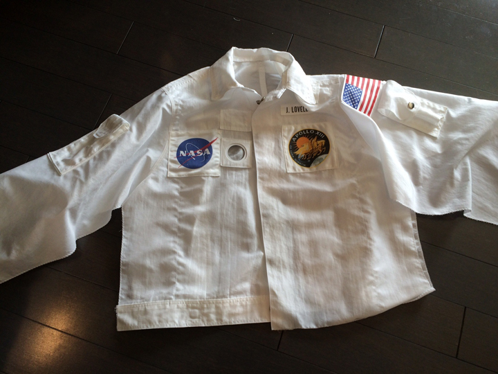

And here is an in-progress photo of my Apollo coveralls, which I hope to have done by Halloween. I found a fabric that is very close to the 100% teflon fabric used on the originals.
