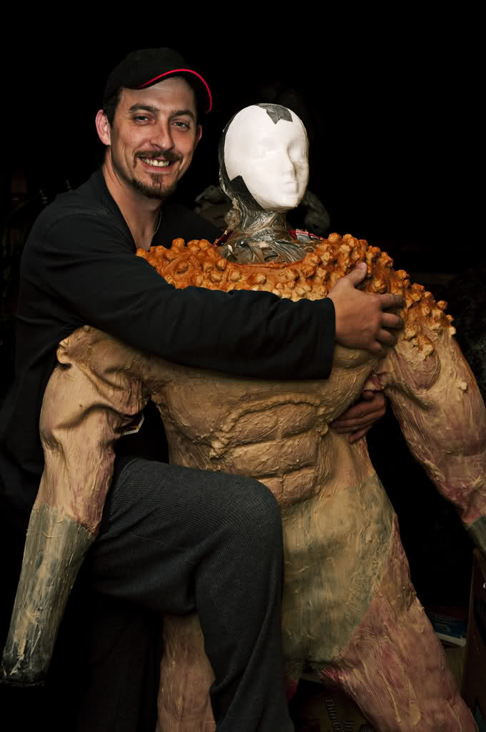

Me in the old Mr I suit, makin sure it fits
Old Tapey
Trying to envision the finished product. VISUALIZE PPL!!! I'm tellin ya!

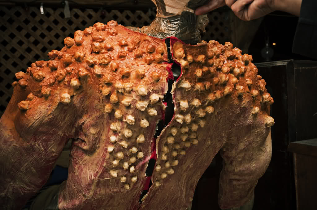

First, I dab the pom poms in the latex and stuck them on the suit. Later I realize "Tis better to have put a coat of latex on, prior to applying pom poms, then to have no coat of latex, at all"
Now it is just a matter of layers upon layers, and drying time. We don't need a caption for each of these. ;)
this is how it sits now.
While I've certainly seen better, for my first attempt, I'm satisfied this will look ok once the paint has been applied.
Any tips or tricks are welcomed and appreciated, and I ran out of latex and used my extra scratch for armour, so this will have to do for now. :S

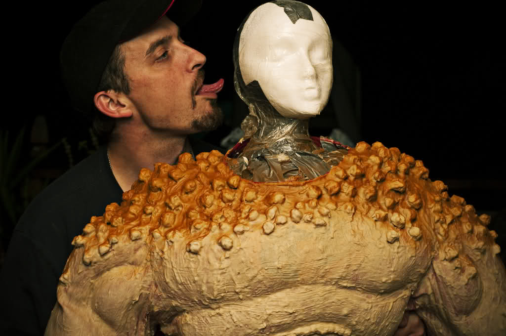

Ol Tapey was getting a bit of base coating done. First small bit of color on him, and I can't wait to see more.
you can REALLY see the details in the shoulder here. hey, the shoulder. Stop looking at his tongue.

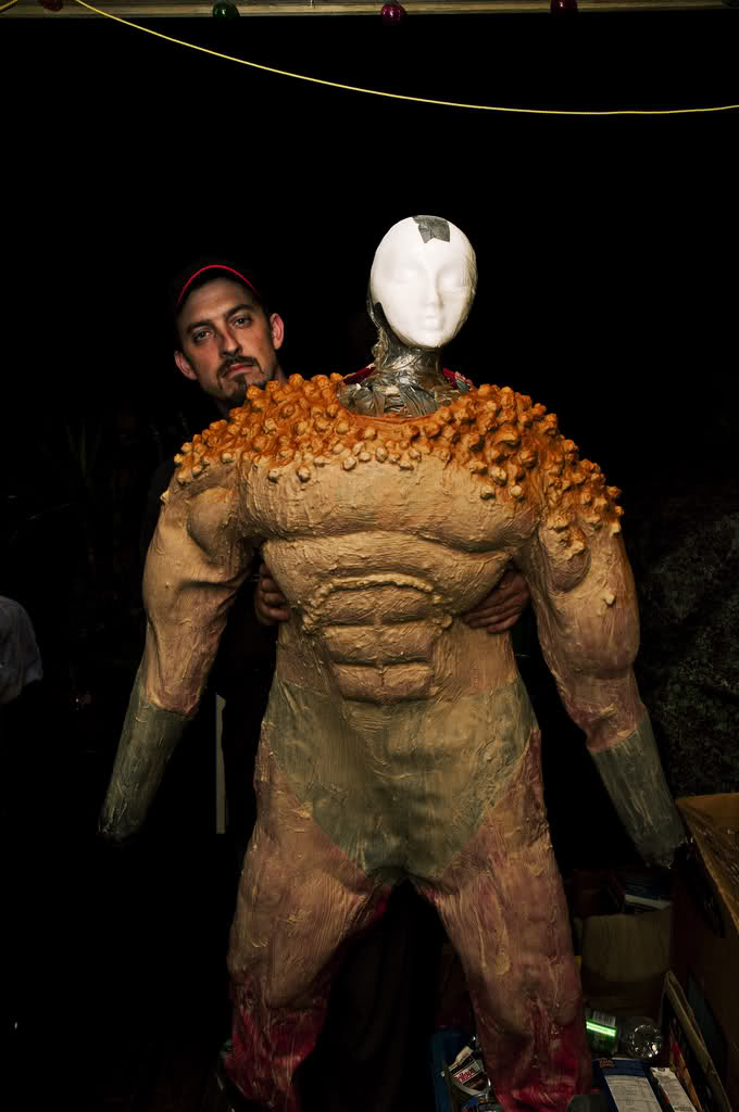

Mocked up the armour on the skin. yes I know it looks lopsided but when its on me it isn't. the Dummy is experiencing structural integrity issues. LOL! scored some more liquid latex today to patch some areas and add some more details. more to come.
The suit and paint up look really good. The armor is really unique and looks great! Can't wait to see your suit progress even further.

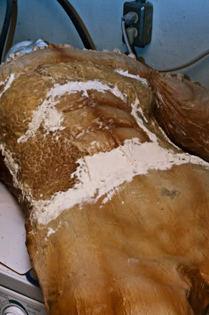

I did some skin grafting yesterday. I'm still filling in the "seams" areas and will do some light sanding to blend them in. Though I must say, as he stands, he looks quite battle scarred, and I digs it. :)
So, here are some photos. I did some quick and dirty edits in PS to show the details. sorry for the size, but its all I'm allowed. if anyone wants a high res dl, lmk, and I'll send them to you via flickr.
Anyway, I made these bits of skin using a cobblestone fondant mold meant for cake decorating. I think it gives it a fairly reptilian feel. Yes I realize the latex appears thicker on one side, and there's a good explanation for that. it is. as most of you know, liquid latex is friggin expensive if you have a big area to work with, so these skins are from my very first learning attempts with using latex, so they aren't all uniformed thickness. once they are painted and the netting goes over no one will notice.
