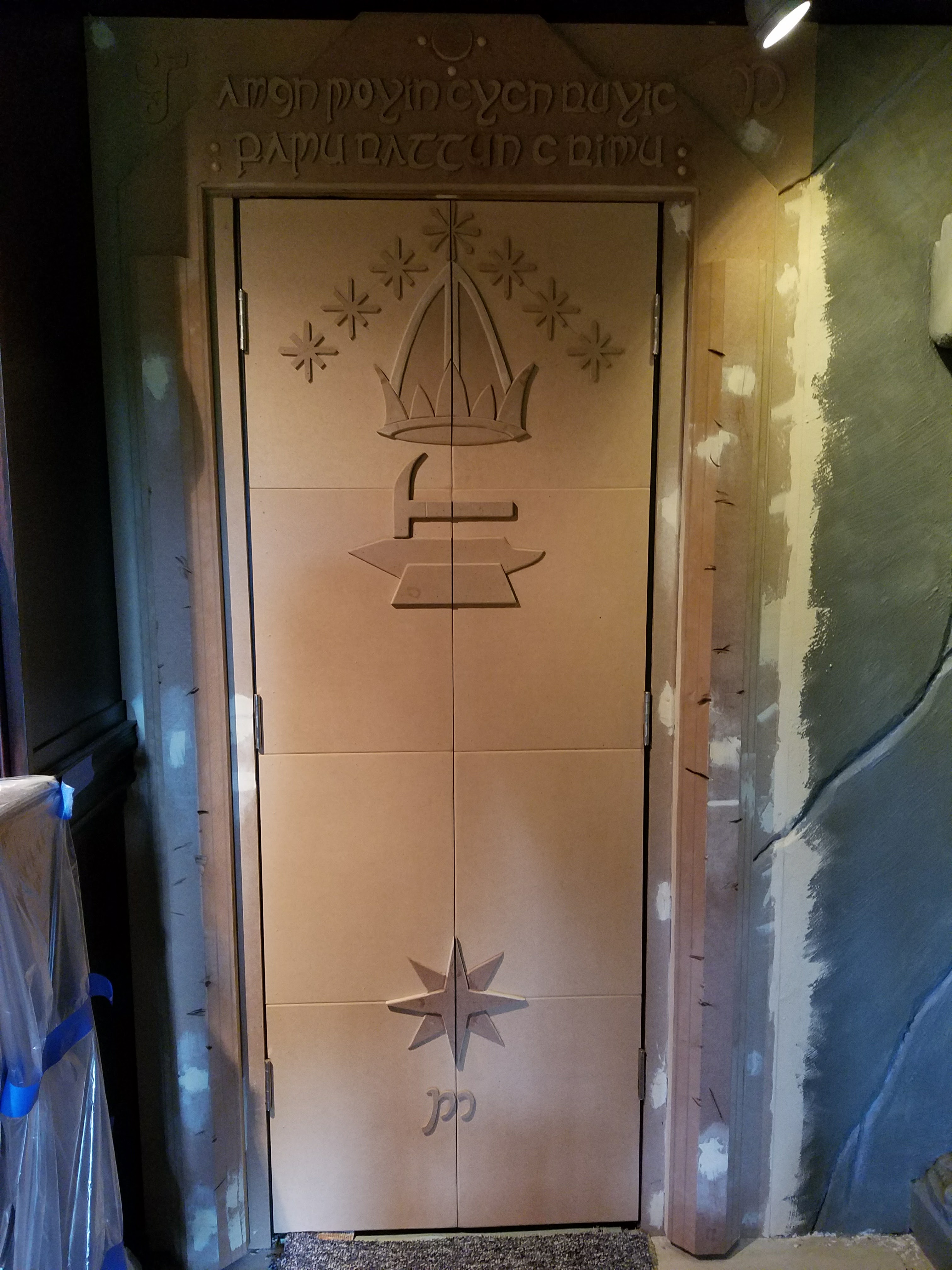

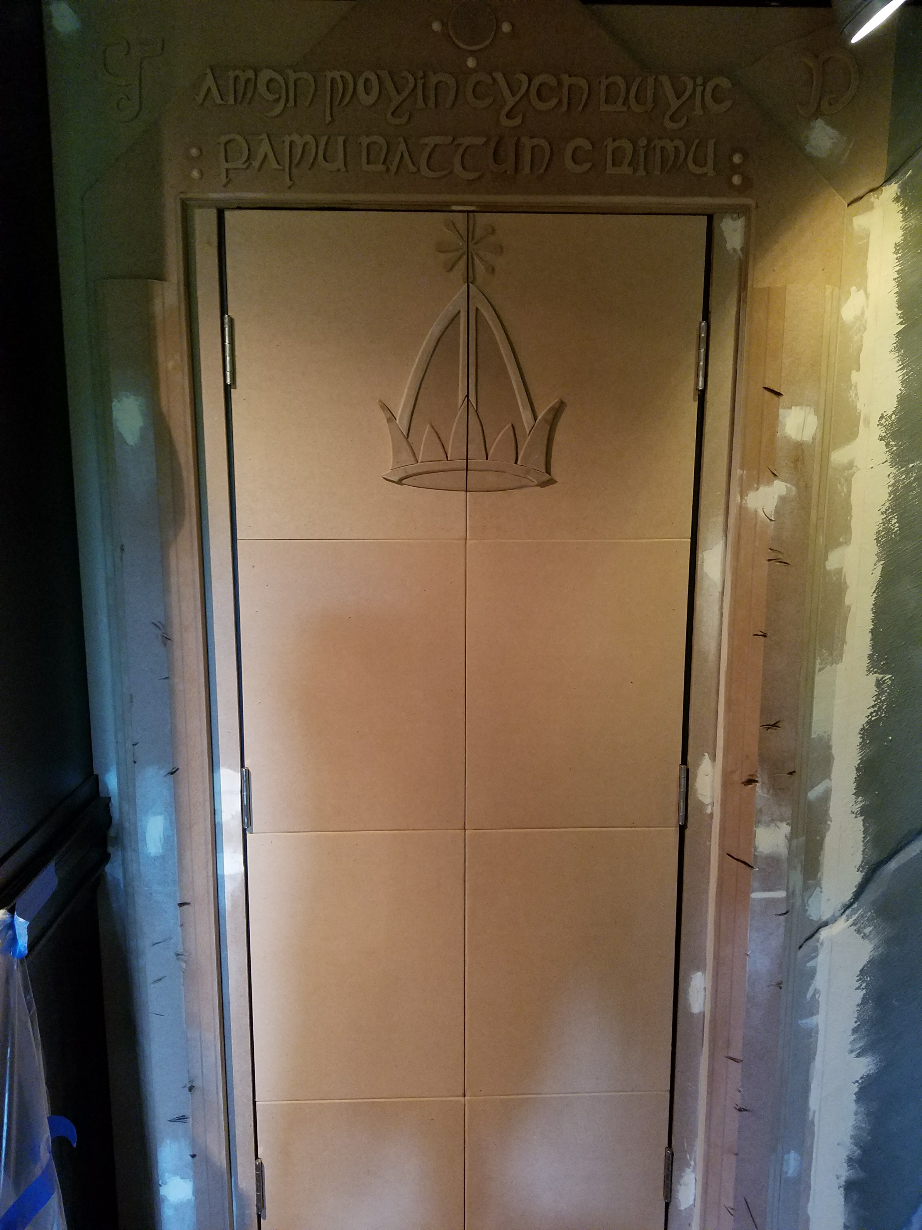

Ok small progress report. I have installed the double doors for the Doors of Durin. That was nerve wracking, making 2 doors fit perfectly in a frame intended for a single, hollow core door! Needless to say I had to reinforce the frame substantially to accept the 2 solid wood doors! So here are some pictures to show the progress thus far!

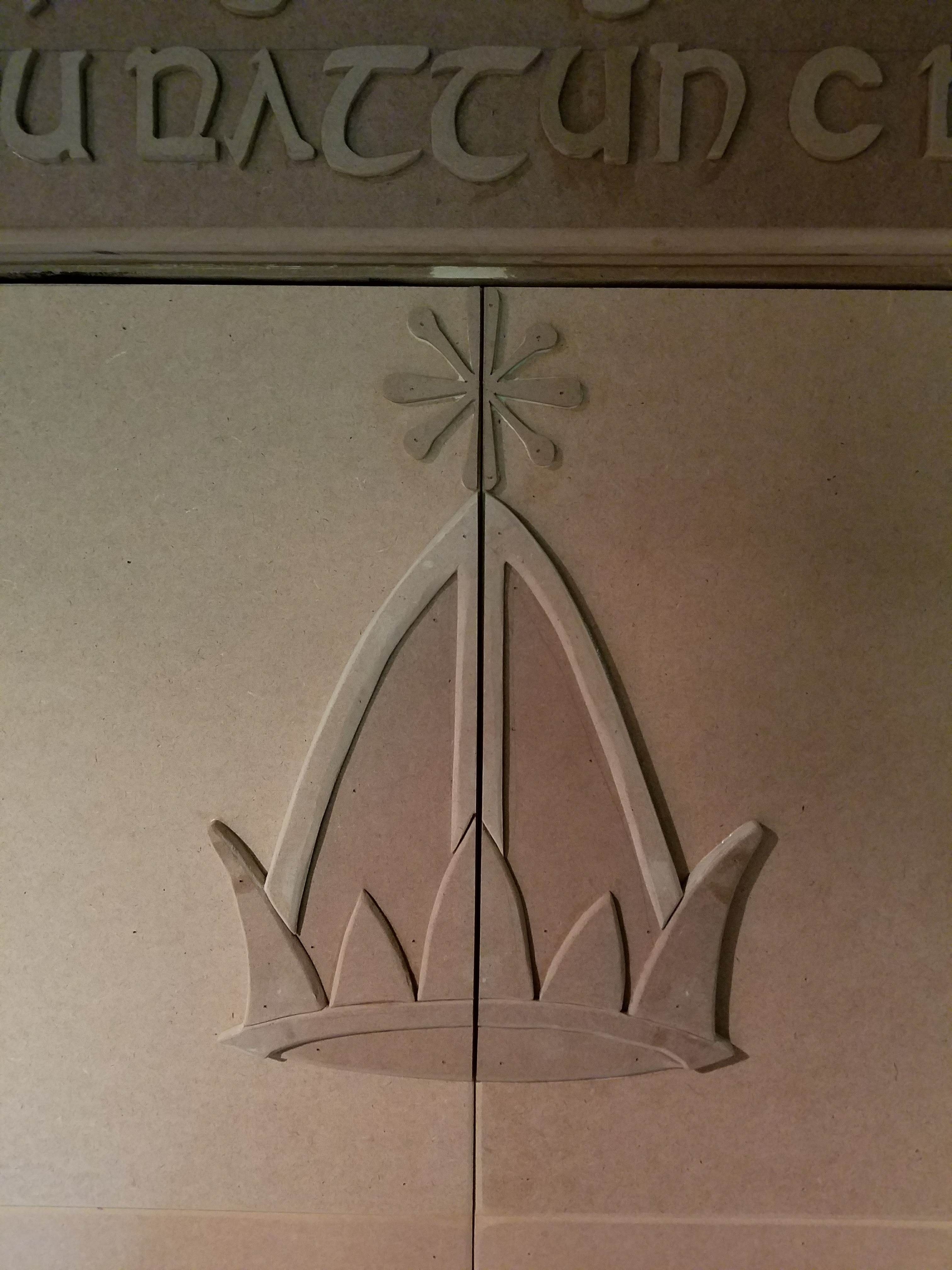

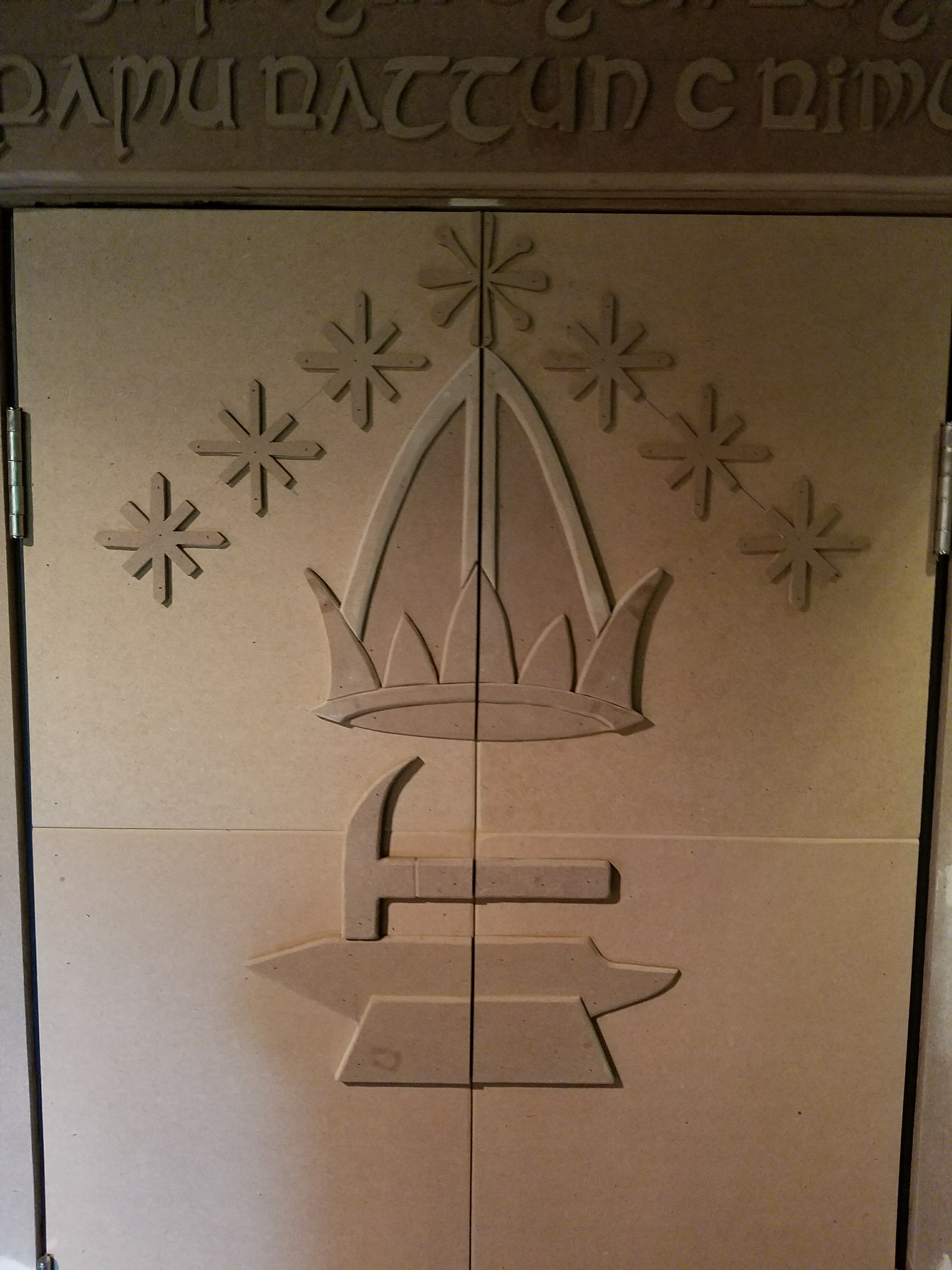

Here is the doors with the stone panels already attached. I also began attaching the door pieces, here is the crown and topmost star.

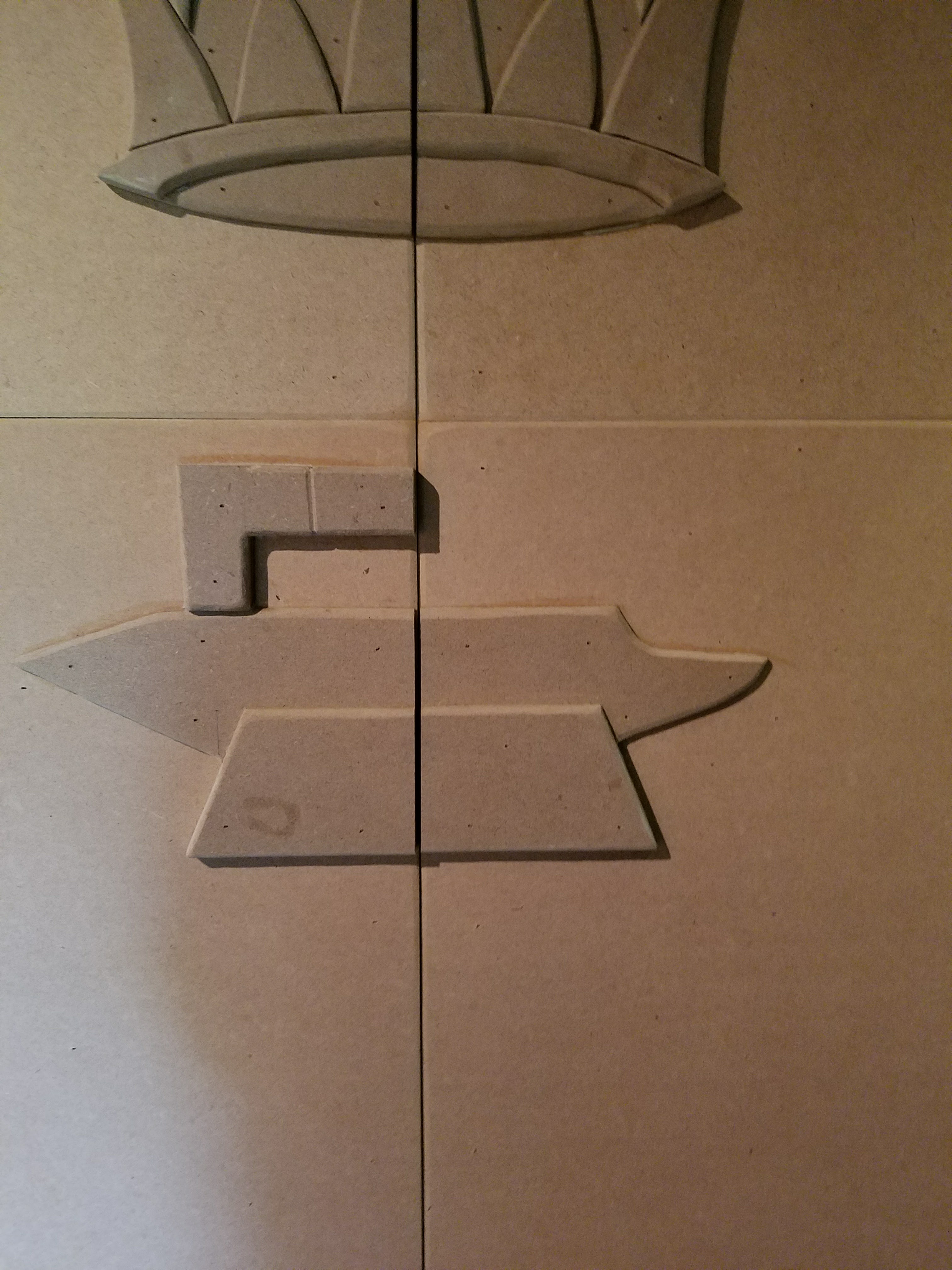

Here is the hammer and anvil

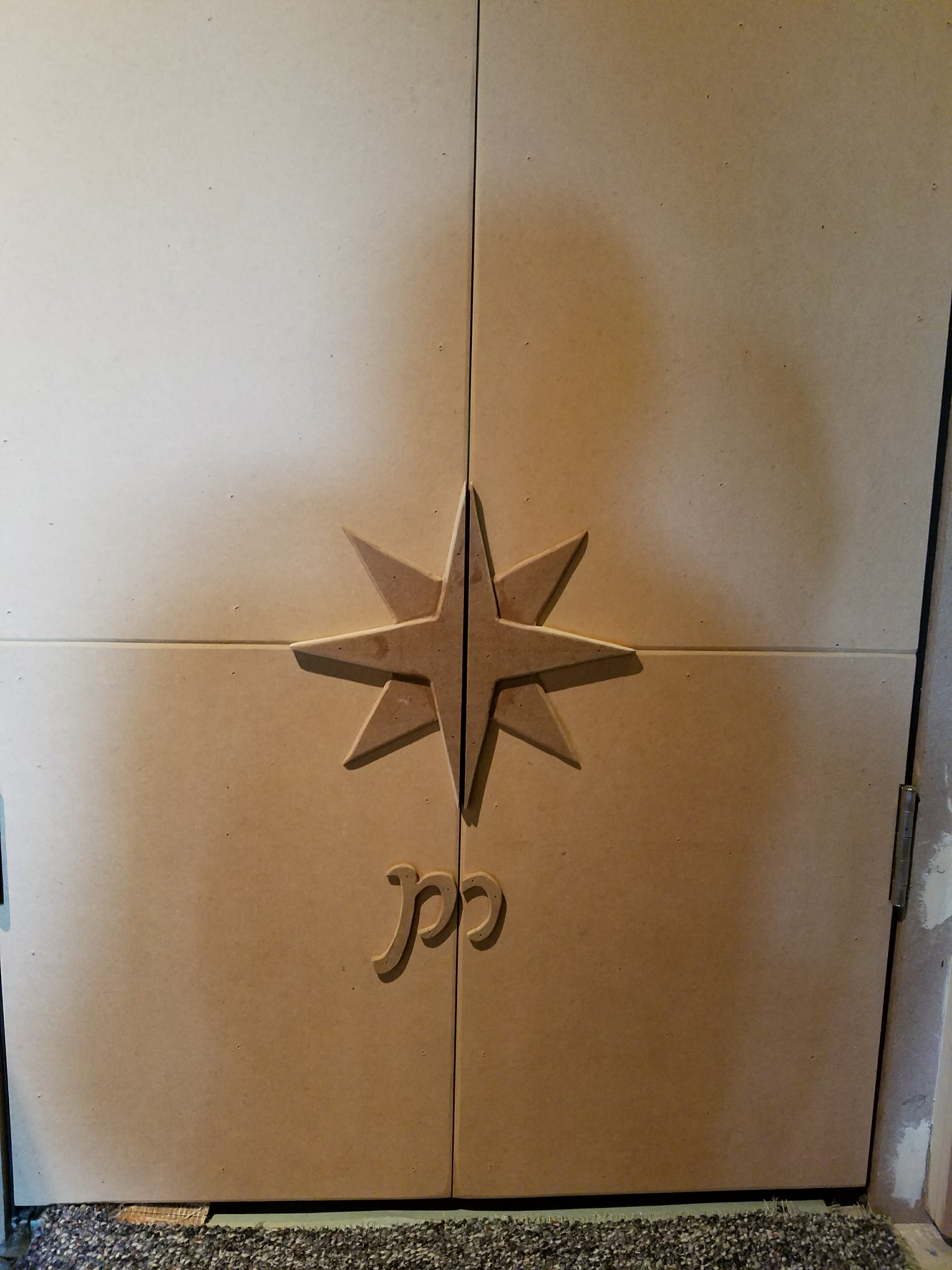

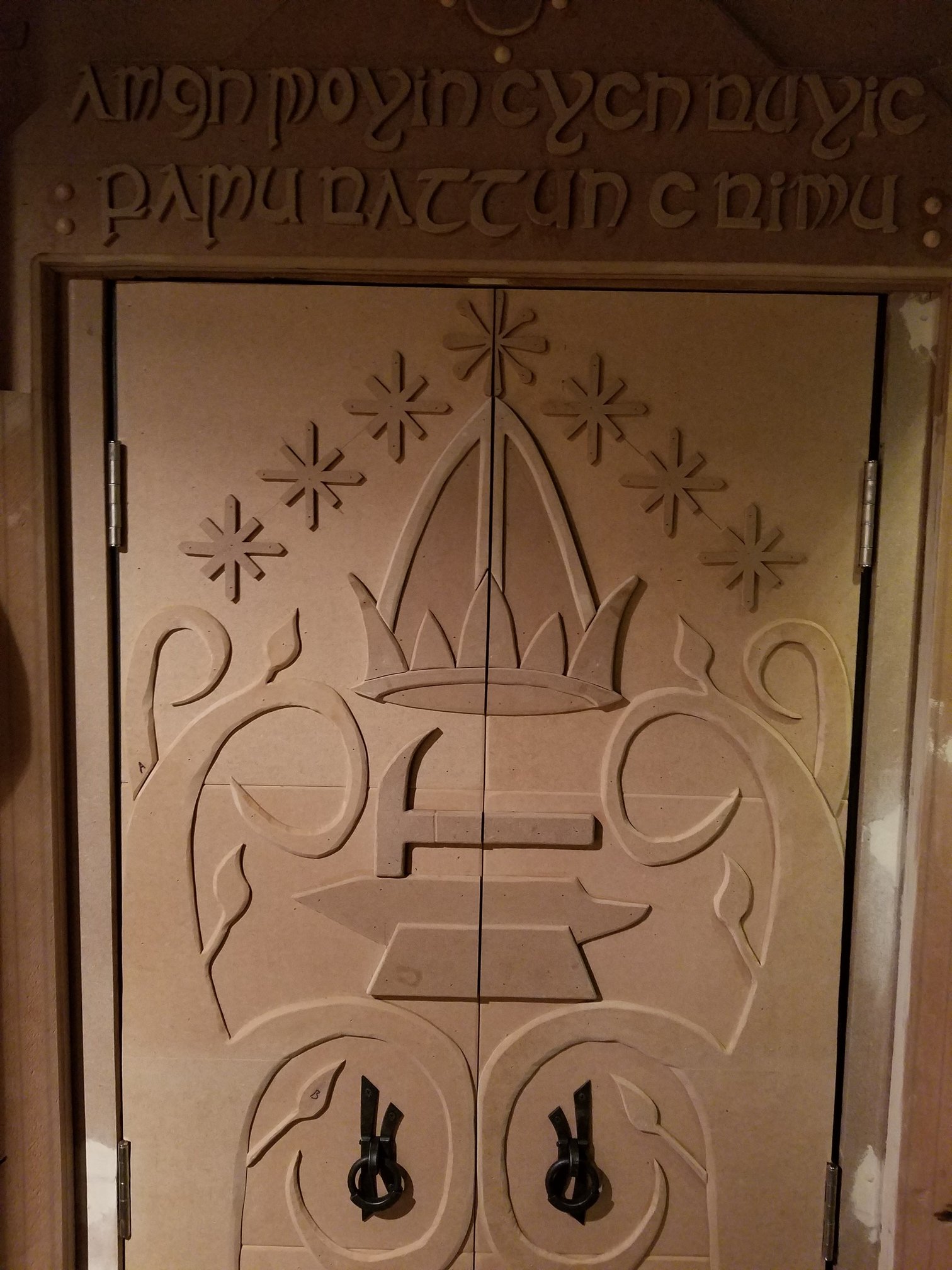

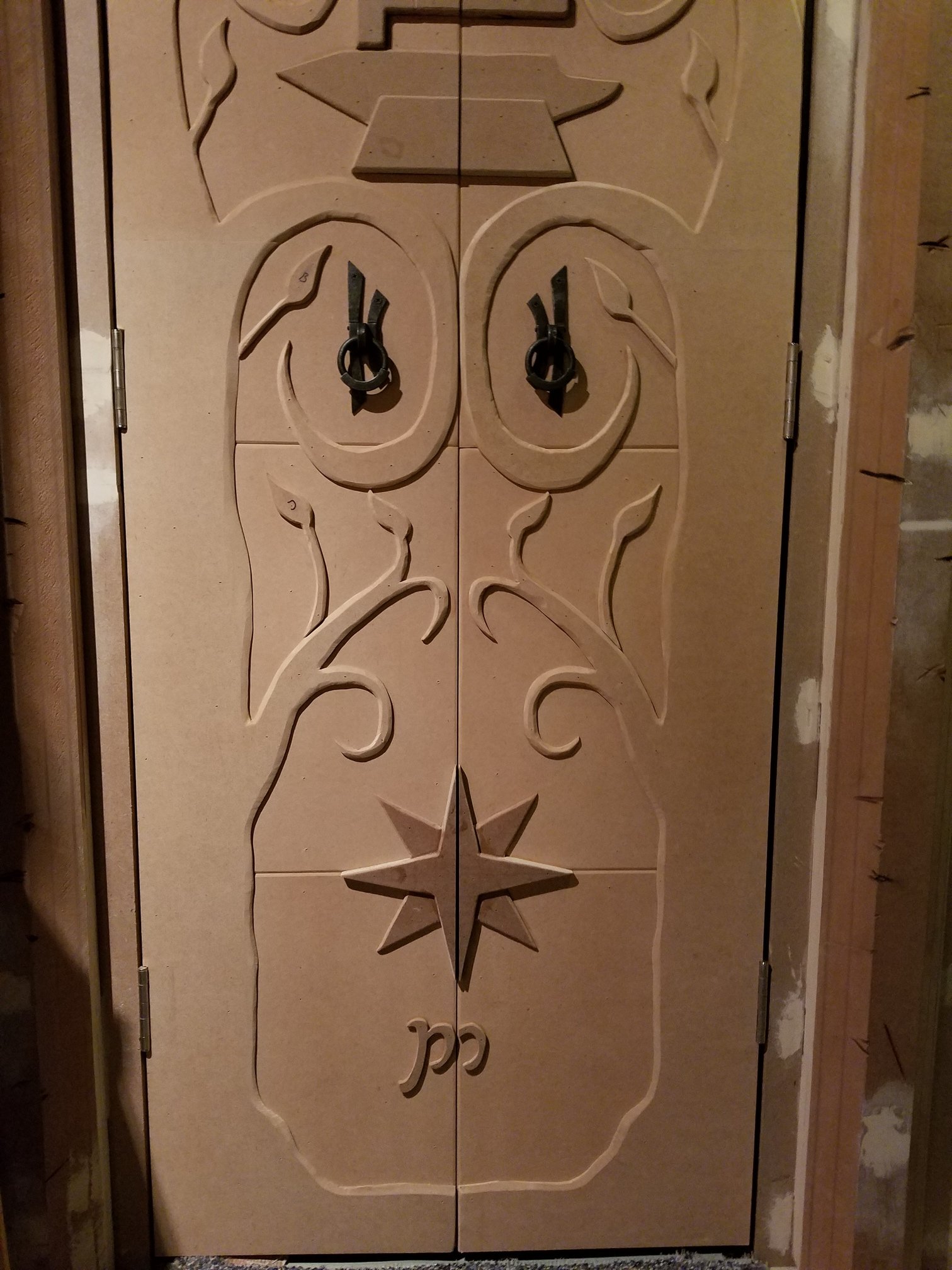

Pretty much the rest of the door pieces except the trees! Hard to see but I attached the symbols in the upper corners of the wall as well.
Close up view of the attached pieces.

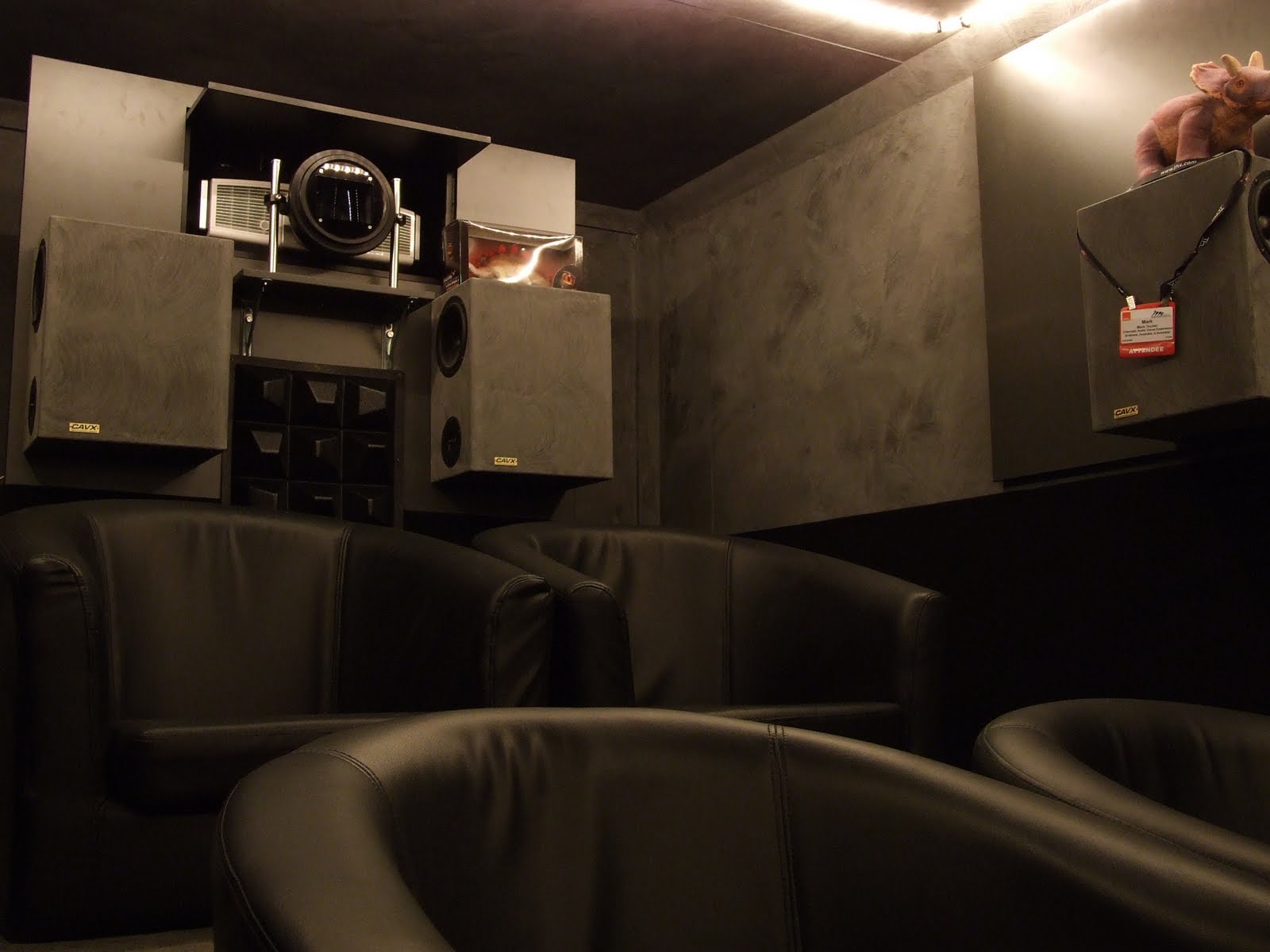

You get echos in a room like that when you have flat, parallel surfaces - ie side walls, end and screen wall and floor and ceiling. Sound waves bounce around the room like billiard balls. Room modes can be worked out because they are essentially the speed of sound divided by the distance between any two surfaces, You add odd shapes (like your statues) and you start to break these up. The more solid these shapes are, the better they work, so if the statues were made of foam, they would not be as efficient as statues made from wood or even plaster/concrete.
You still need to treat the surfaces of the room as well. In my room (pictured), I treated using both absorption and diffusion. The absorption panels are floor to ceiling for the first 1/3rd of the room, then the bottom half for the other 2/3rds. At the front of the room, there are no echoes at all and that is what I wanted. You clap your hands and all you hear is a dull thud. Basically the only echoes I want hear at that end of the room are what are coming out of the speakers. This make dialogue really easy to understand and it is not that hard to do. The rest of the room is half live so there is ambience with the surrounds.
The first diffusion tile I added can be seen between the two back surrounds. It has been move up slightly (and shelf removed) since this photo was taken, so it is in direct line with the centre speaker. I want a about 7 more to place around the room next to the other drivers of the surrounds.

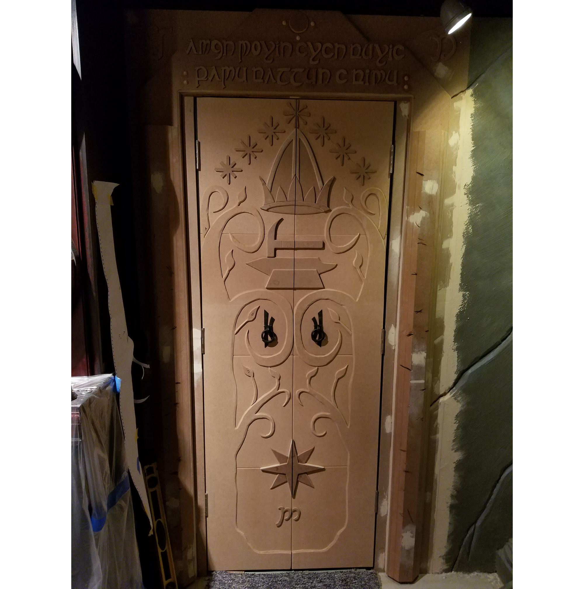

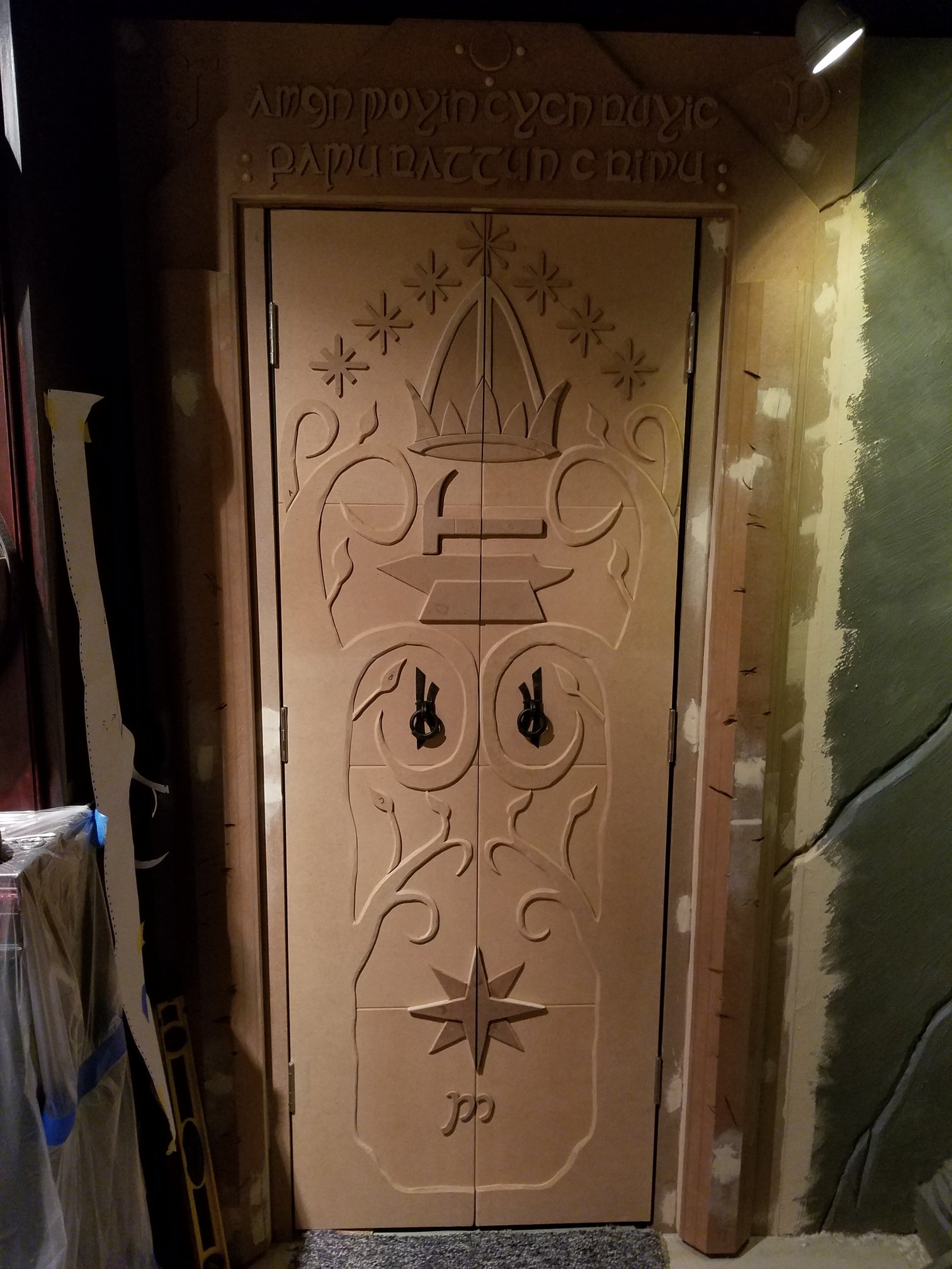

Ok quick update, I have finished and installed all of the door parts. I still need to build the upper and lower column parts, hard coat, paint and outline. Then this section is finished! I know the handles are not from the original image but seeing as I had to make it functional these felt right. They look dwarven, hand forged steel rings, I really like them! As always, any ideas, please let me know!
