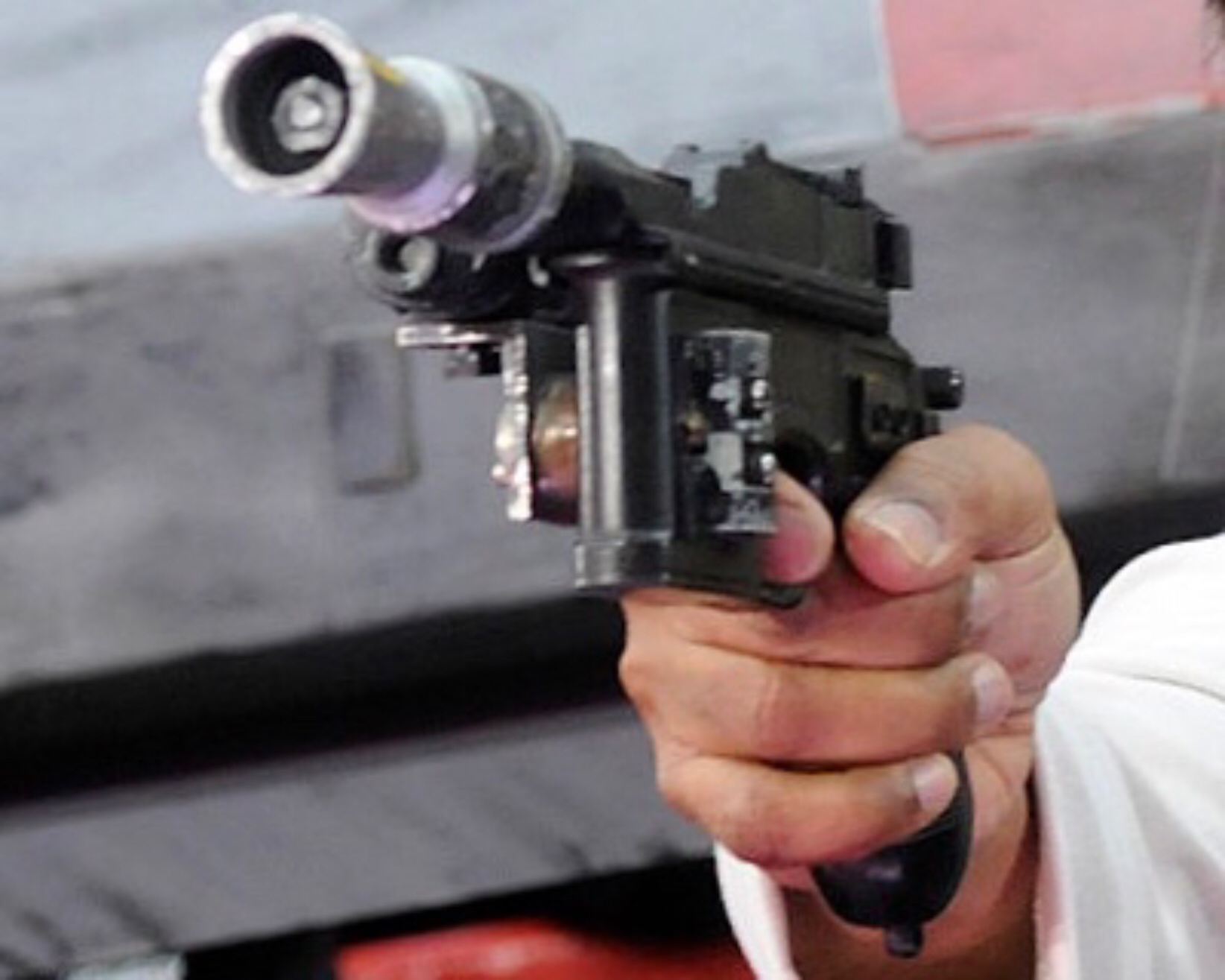

I've been thinking about this mount a bit. Do we know the wall thickness of standard square stock or angle stock aluminum? I'm guessing that they just cut it out of whatever they had on hand. I think the bolt head sizes were found to be the same size, but the front one isn't screwed in all the say which you can see a small gap.
Mortifactors estimate on the disc was 3mm which looks right, and the bracket is almost the same, so i think i estimated 1/8" (not sitting wity my props atm)
Now, the stock they used was larger because theres no extruded soft edge on the bottom. I also thought i saw the top was thinner than the bottom of the bracket but that may be an optical illusion. I just did a boatload of comparisons in my mgc thread, maybe we can nail down measurements, the spacer seems to be 4.5 screw heads from the bottom of the gun but im worried it moved over the years..
This is from DL44 Blaster dude, I... think... it's an optical illusion and both sides of the bracket are the same thickness.. the bracket is a hair thicker than the disc, which might be 3/32... so 4/32 or 1/8" I don't have a real M19 bolt to measure though, the bracket looks similar to the bolt head.

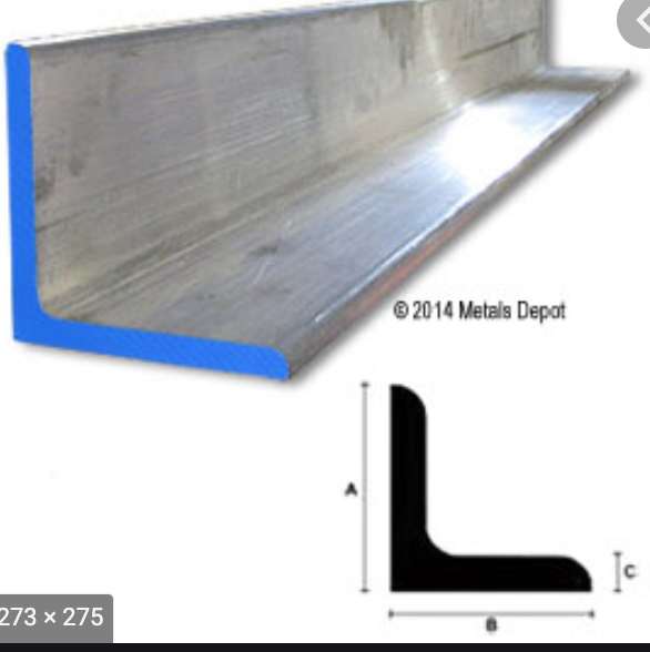

Also, what I mentioned earlier, most of the general aluminum I get looks like this, so if the part you need is 20mm, and you order 20mm, you will get this curved edge. You either need to find some cut straight or get a wider piece like 25mm and chop it yourself. Actually the real mount doesn't have a curved inner corner!

That inner angle is the first thing that jumped out at me, definitely not correct. I wonder if square stock has that too.
