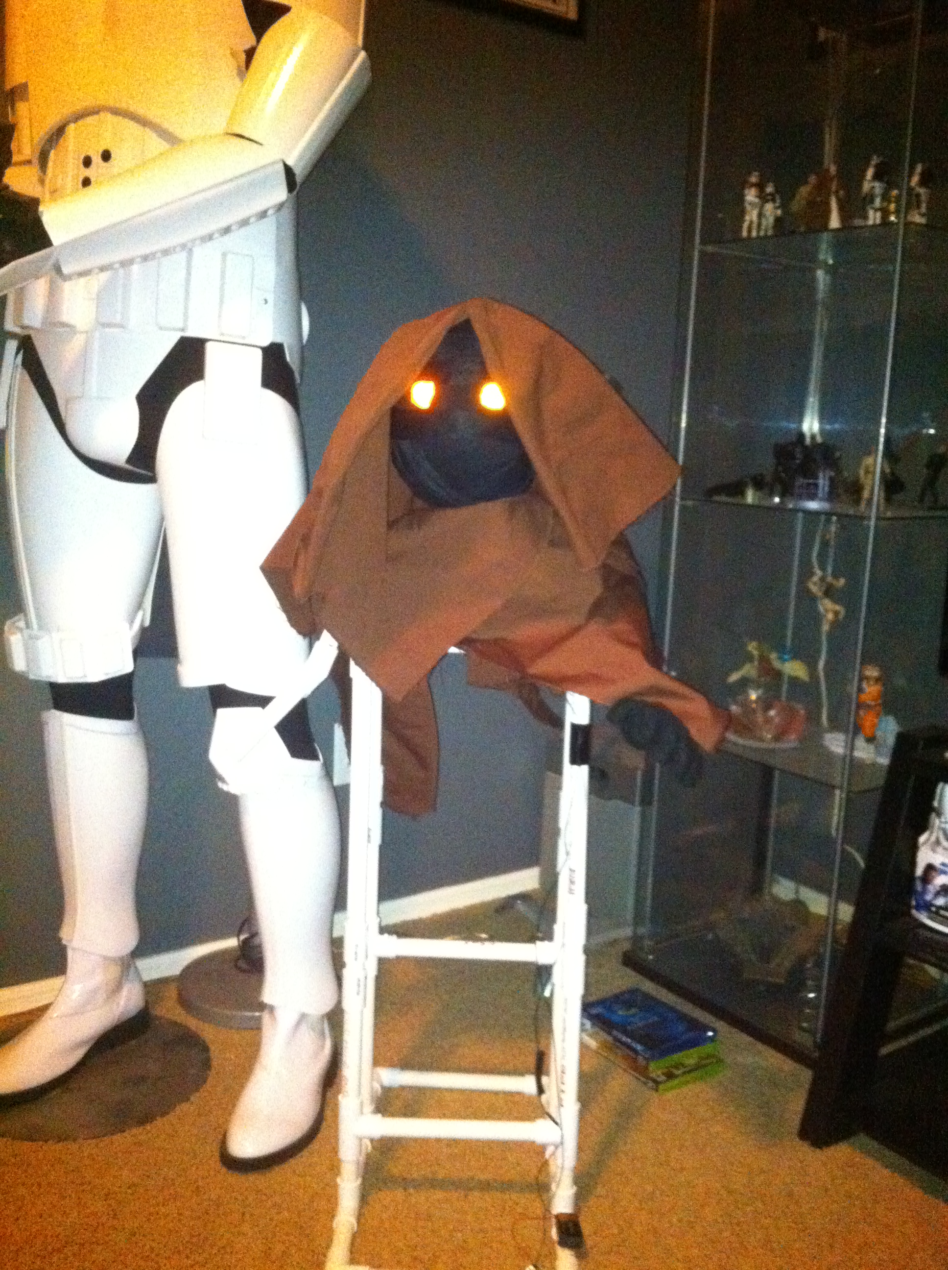

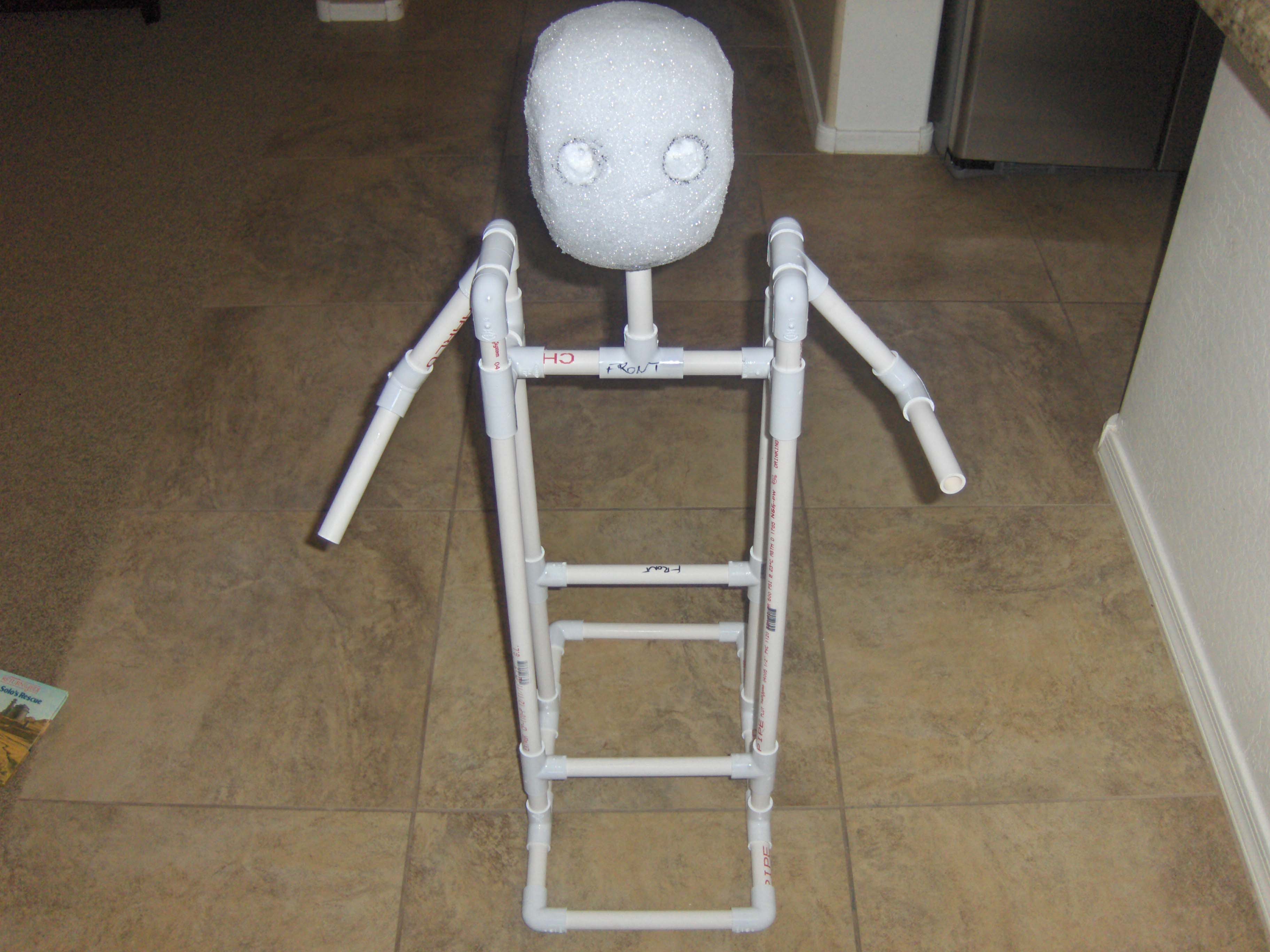

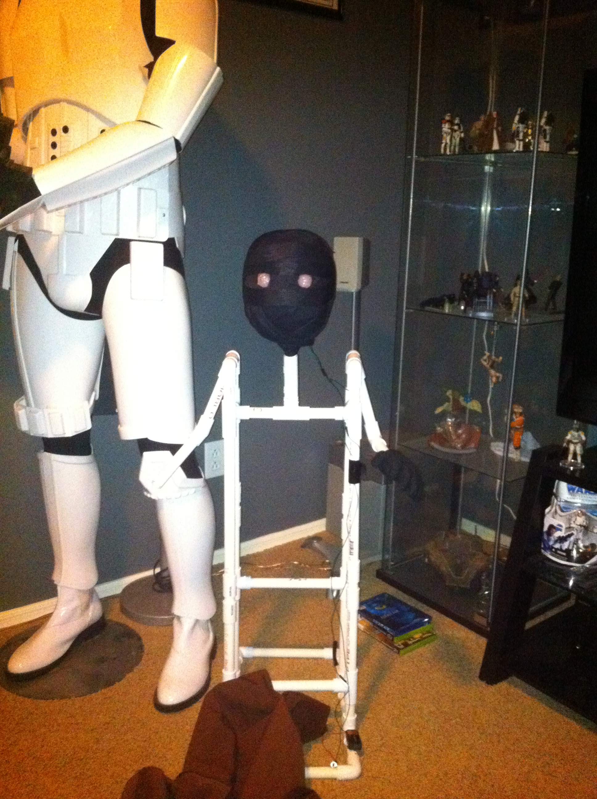

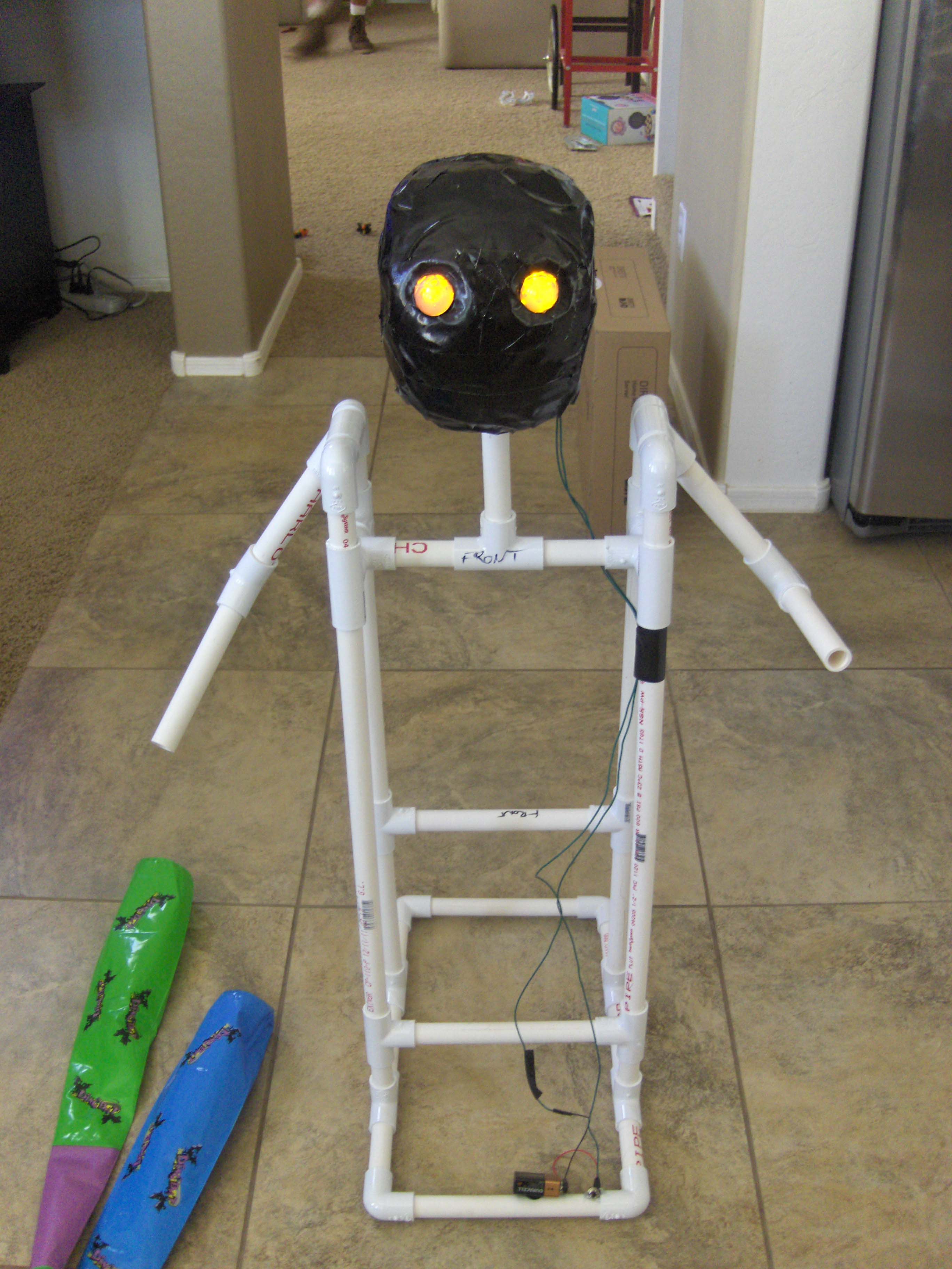

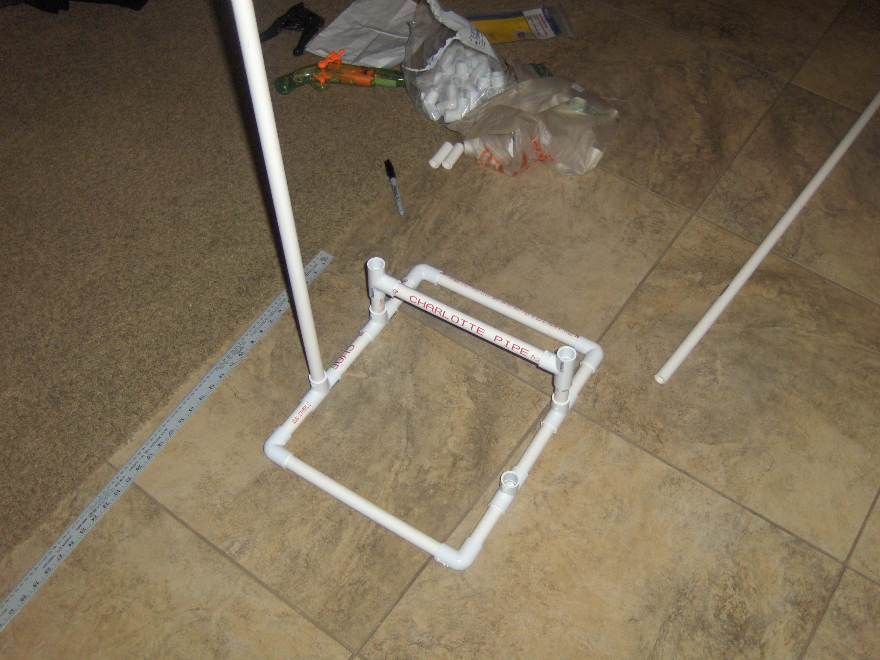

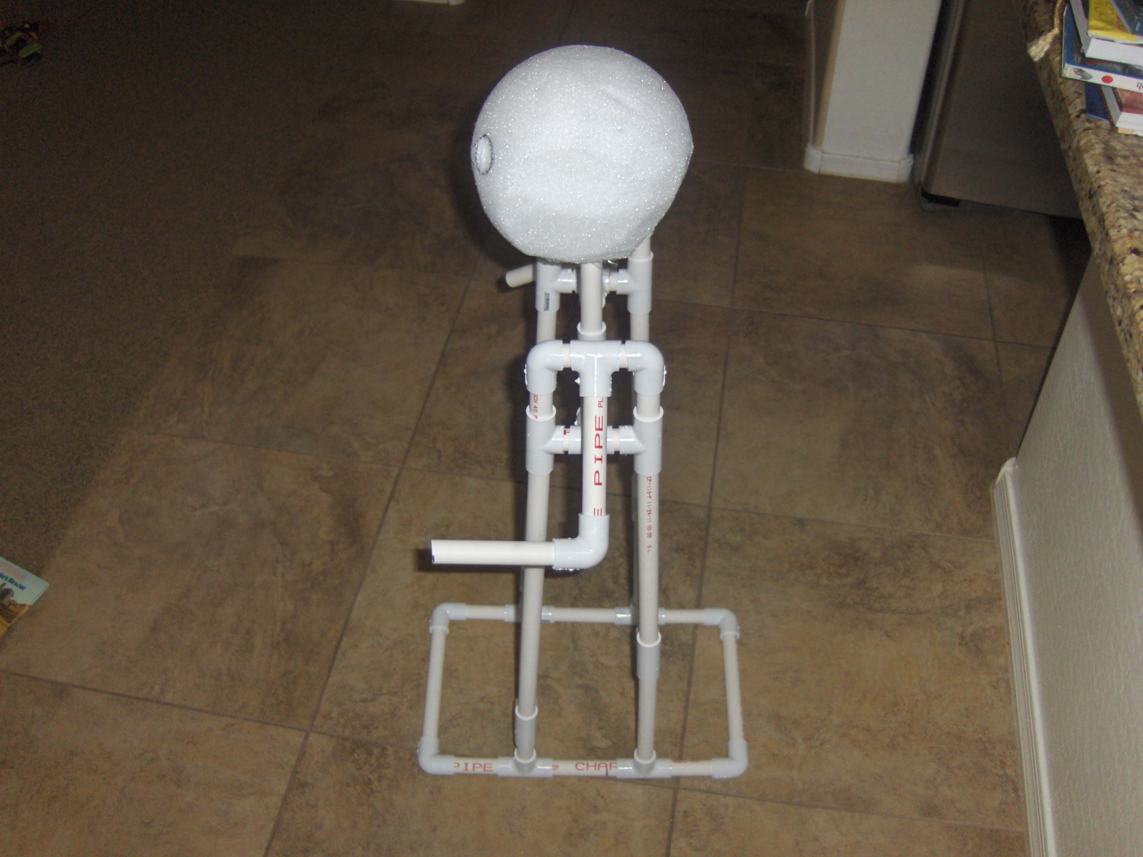

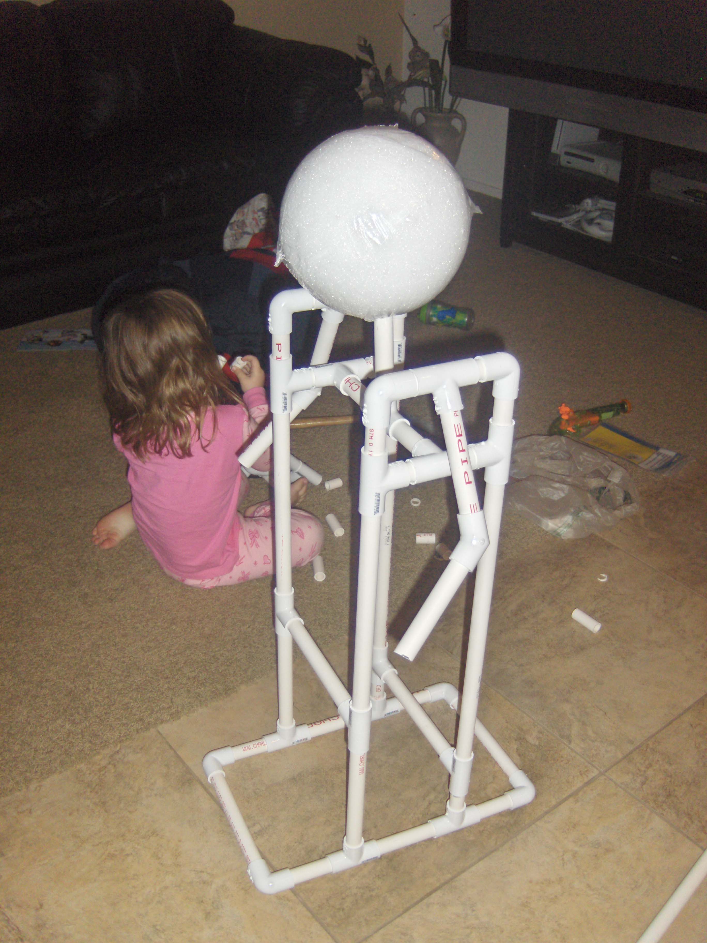

The body frame is being built with 1/2 schedule 40 pipe. The head is a styrofoam ball from Walmart.
After stepping back I noticed the frame was a bit too wide and a bit too broad at the top of the shoulders. I am using my 3 and 5 years old to get some approximate sizing. I decided to take the top of the shoulders in a bit and pulled about 2" out in the body width.

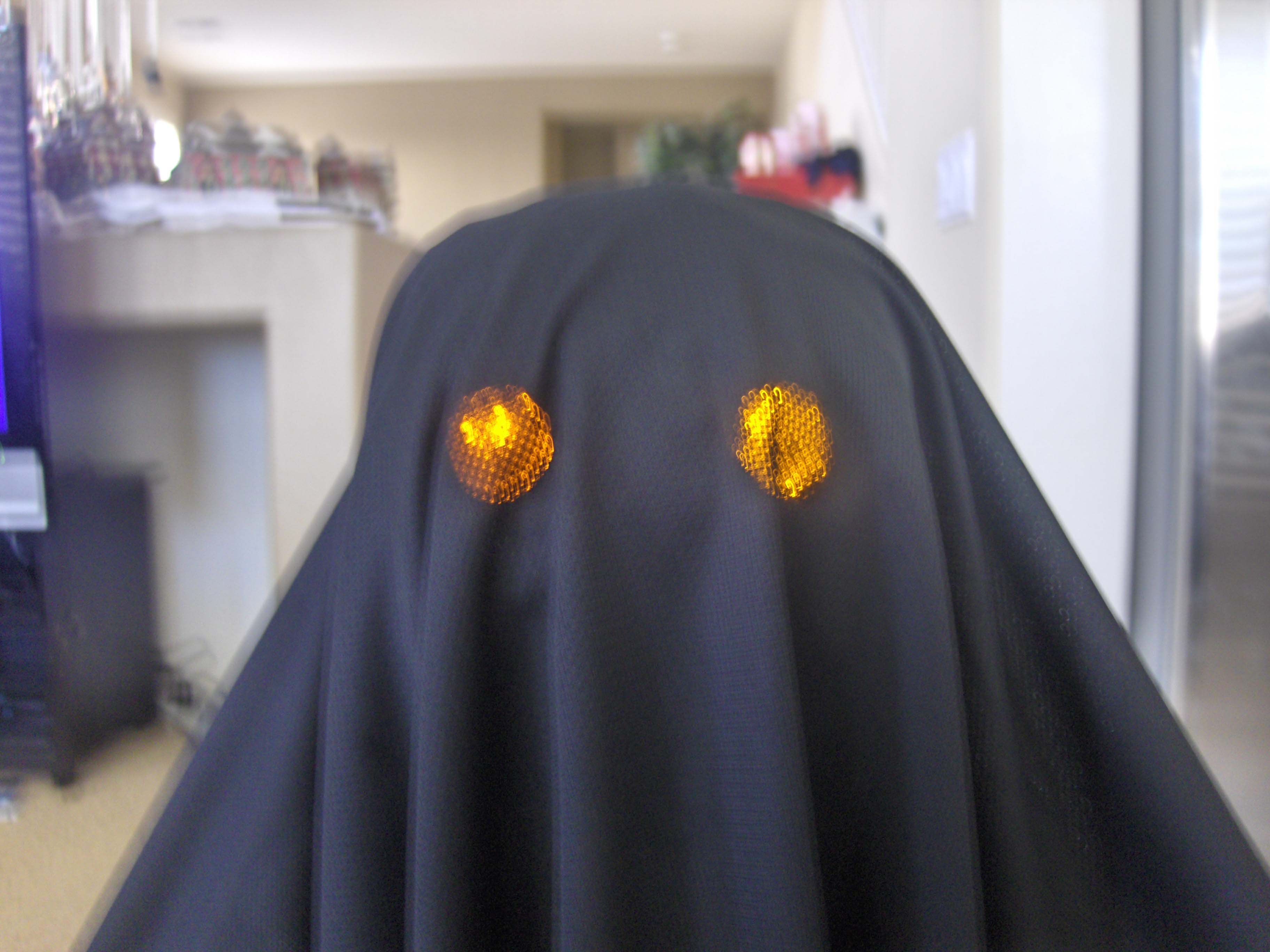

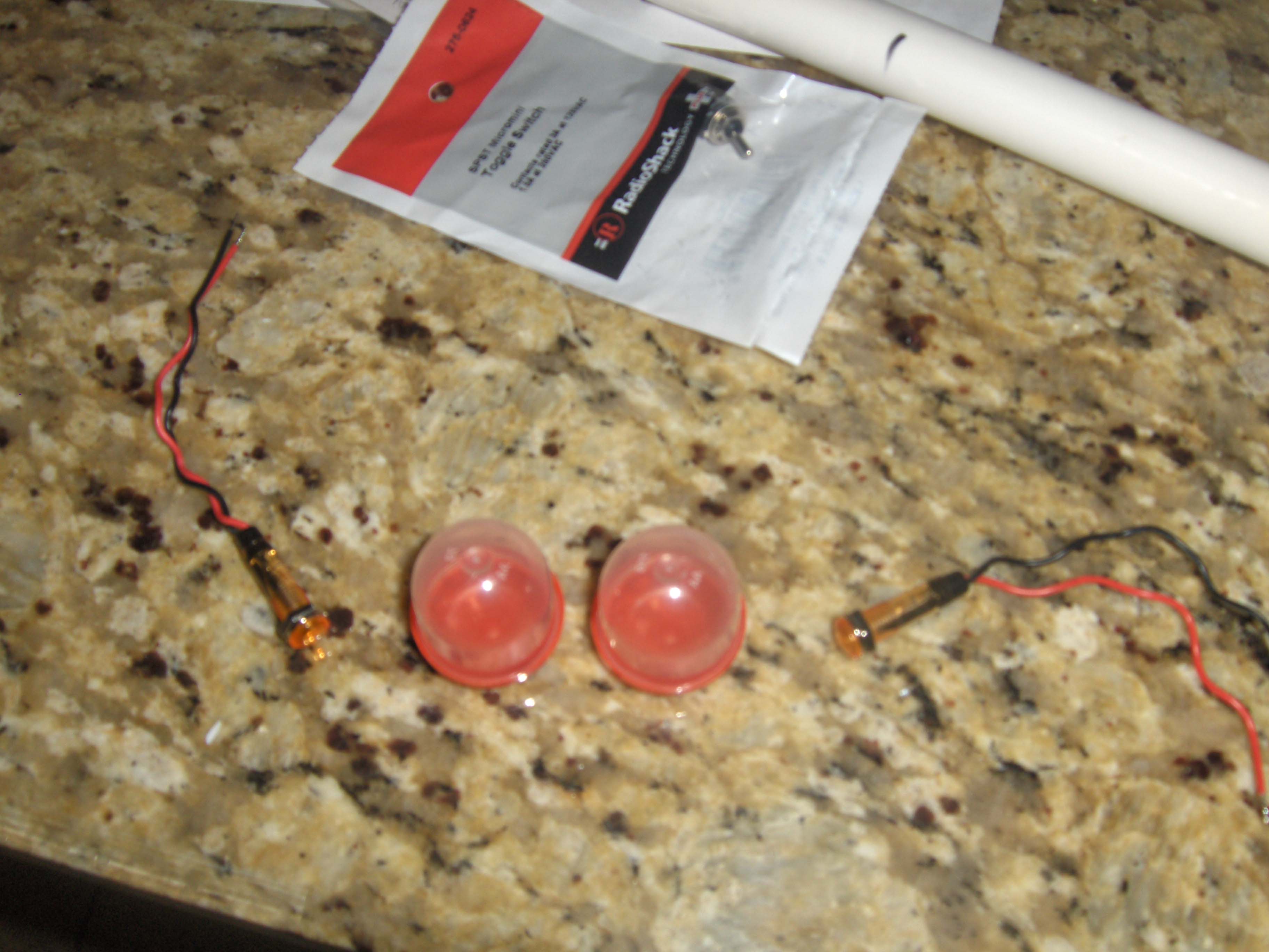

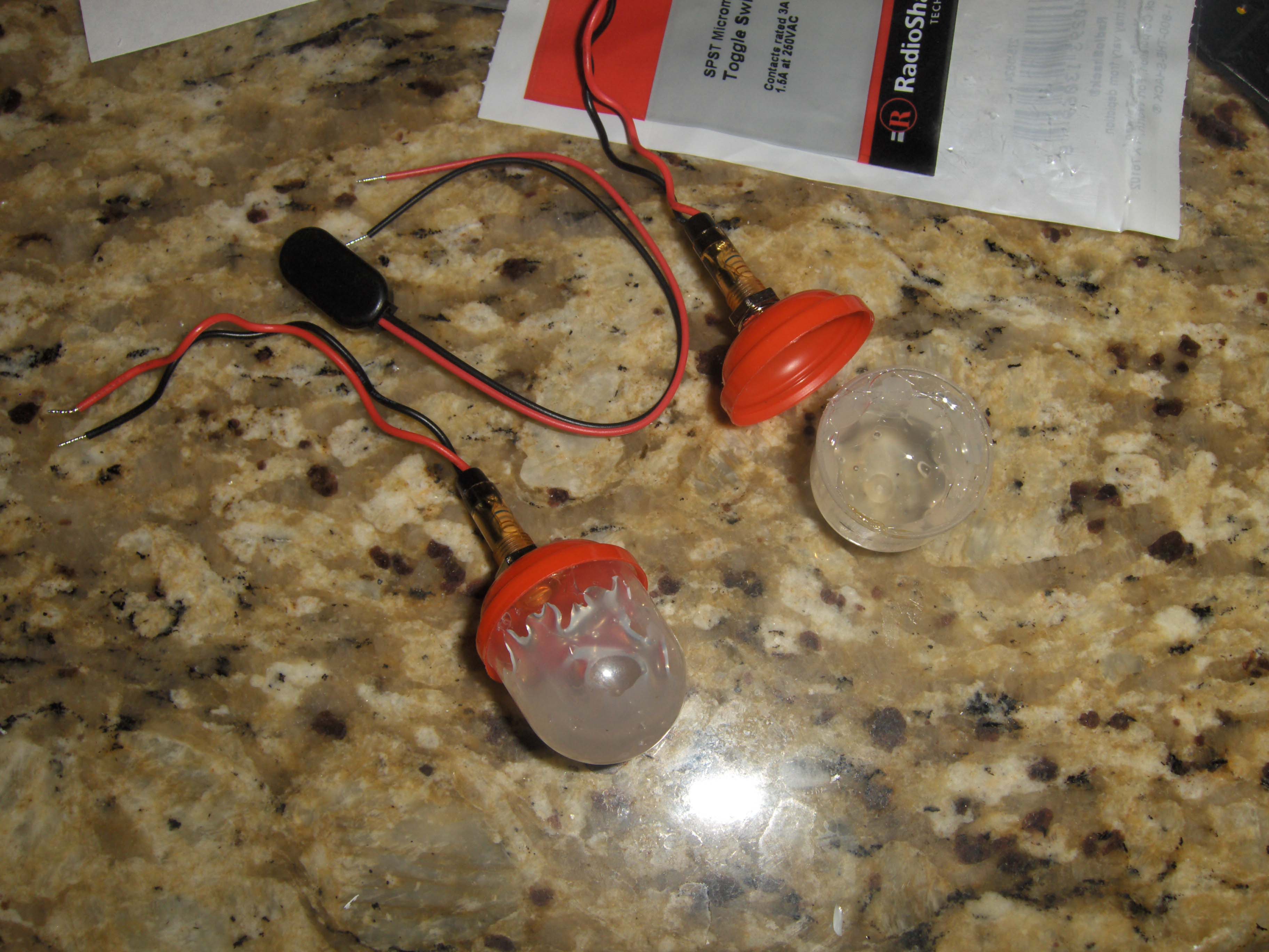

I am using the same trick for the eyes that I used on my HIC panel. Those 25 cent toy machine dispenser capsules, the small ones. I bought 2, drilled holes on the bottom, and added 2 orange LEDs on a resistor so I could power them with one 9V battery. I then partially filled them with hot glue to help diffuse the light.
I shaped down the head, added the eyes, and placed a toggle switch at the bottom that can be accessed from under the Jawa's cloak. I also wrapped the head in black duck tape.
I bought some real cheap fabric, $2.00 a yard, that I'll wrap the head in. It has a pattern that you can see in front of the eyes that I think looks real good.
