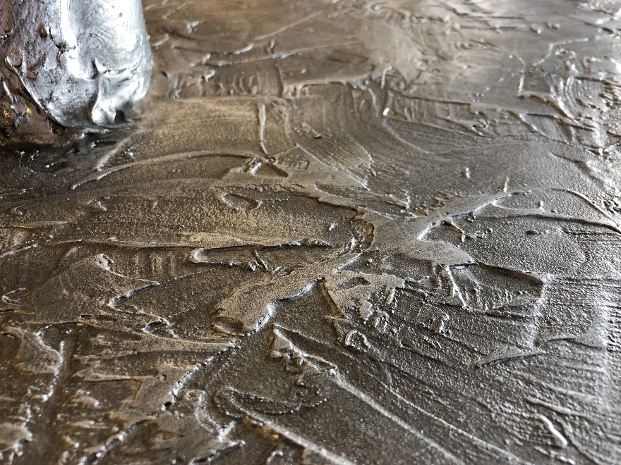

Once the clothes were dry, I taped off a 3” edge around the top. Inside of that edge, I used Bondo wiped on the surface of the top roughly to create a nice texture around the body. I used the Bondo to blend in where the pieces of the body were attached to the top.

Once the Bondo cured, I sanded down any high spots with an orbital sander and 80 grit paper, which gave it a nice look. I then covered the entire box with two coats of automotive primer. This is where you’re able to start to see what the finished product will look like.

The next day I applied the black craft paint. I mix the paint 3-parts paint, 1-part water and a few drops of dish soap. I read the dish soap helps the paint mixture spread out more evenly and into the grooves. I applied this to an area of about two square feet. The tricky part to this is letting it dry long enough, but not too long. I think about 4-5 minutes was about right. Anything less than that and too much of the paint came off leaving just the aluminum. I used a dry, microfiber shop towel to rub off the black. What surprised me was how much rubbing was needed to get a good effect. My arms were sore by the end.
I noticed a few spots that I thought had a little too much black paint after it was completely dry, but I was able to use a damp scotch bright pad to those areas. I was very happy with the finished product.
