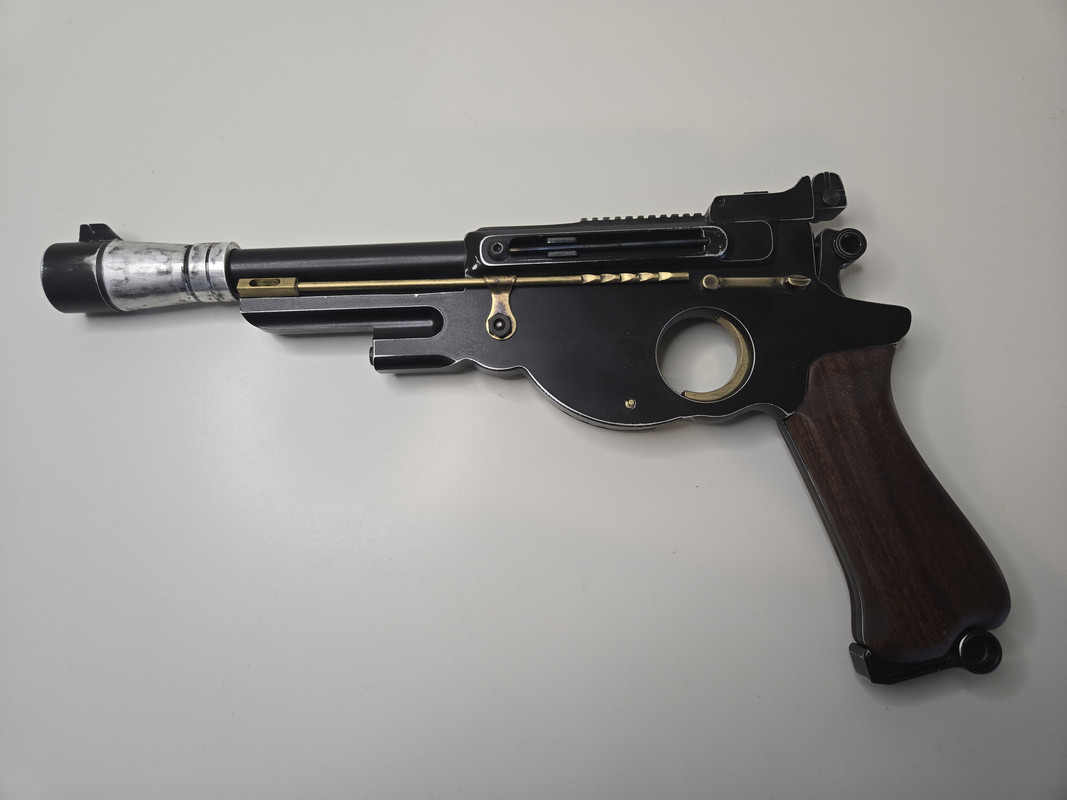

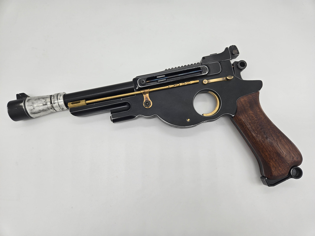

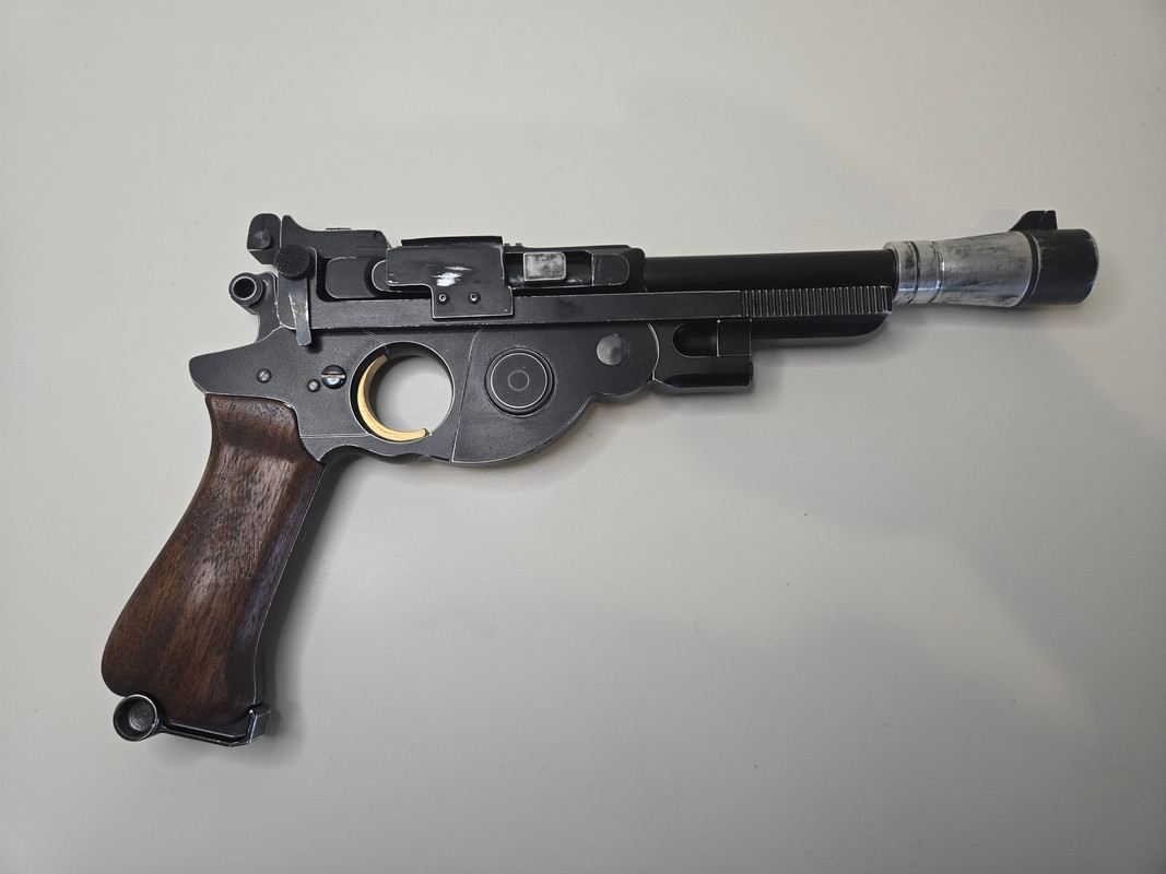

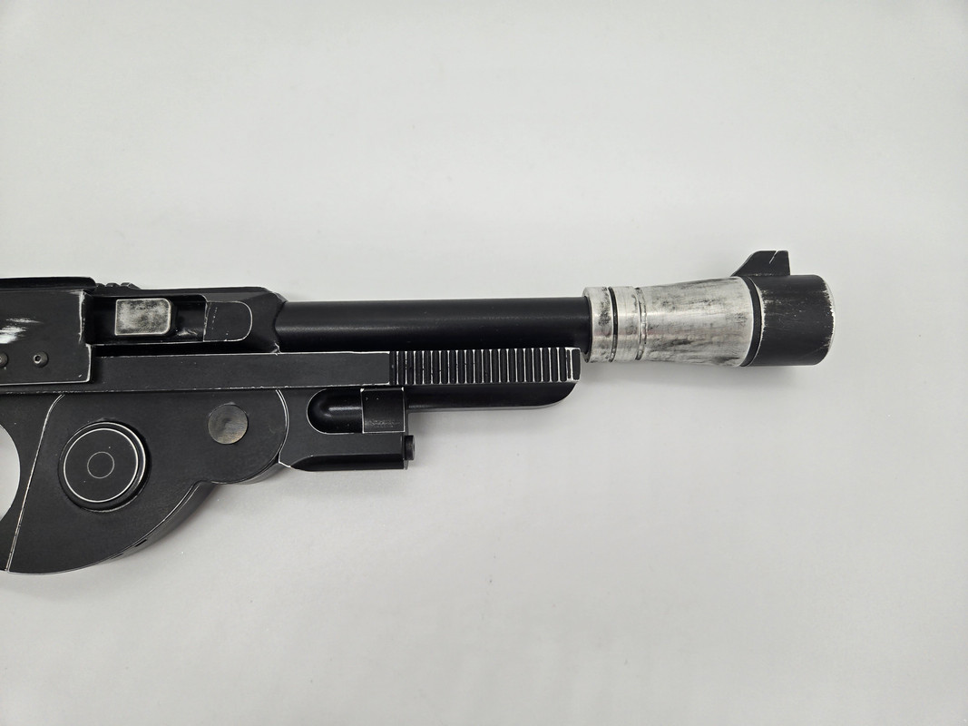

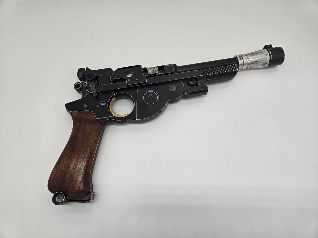

Here is my blasterfactory aluminum Mando Blaster.
The blaster is painted flat black (couldn't get a good finish with aluminum black), and I flame blued anything steel.

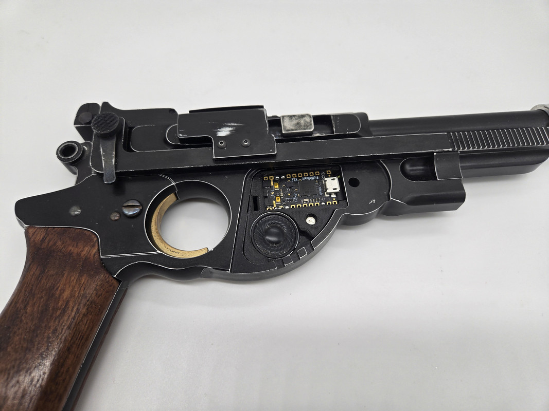

It also has a proffie v2.2 board, 13350 battery, 20mm speaker, single accent pixel and large 20 pixel ring for muzzle flash.
The battery is in the grip, I used a cnc to open up the frame and make recesses in each grip panel. Its pretty tight. I also used a cnc to make the wire paths and opening the frame for the proffie chassis. I designed a switch holder and the chassis and 3d printed them.
It was not part of the metal blaster kit. I planned it out the electronics and did it my self. The kit is considered static display, I suppose.
I am pretty fond of and active in the proffie board install community, as it were. The sound board, as its called, is pretty capable of almost anything. I have done many lightsabers, and a few blasters. I also have a tricorder using a proffie board in the works.
I order my electronic parts from thesaberarmory, or saberbay. Lots of cool led options. I then use fusion to design the chassis (the holder of the electronics) for them. Its a fun hobby! I think blasters are my favorite!
