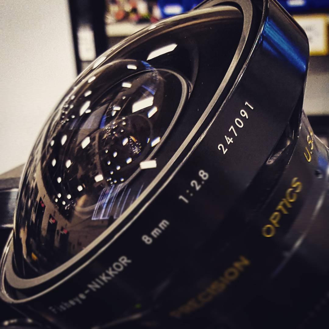

I actually came across several o the real hal lens model at work on a job awhile back. Century housed a bunch for film cameras. Not sure how much about the exterior barrel is changed but the internals are definitely covered in black enamel. (This is the T2.8 lens that was the capturing optic and the bigger lens, not the smaller prop one that was an F8)
edit: my instagram is private so here is an imgur upload
Putting the red led behind the rear element perfectly recreated the look.
ironically enough after testing them the edge sharpness wasn't good enough and used Canon 8-15mm fisheyes instead.
If you are in a major filming city and are extremely polite post-covid you could likely convince a rental house to let you take a look at one in person if they have them. Worst case you have to pay for insurance for a day (maybe 50-150 bucks) and then just rent it (maybe 100-300 bucks) for a weekend to study it.
I bet Sim Digital on the west coast could source it. Though they are pretty unfriendly to indie productions, let alone hobbyist prop makers! Keslow camera actually inhereted a ton of clairmount's stuff (the original weird/specialty camera rental place back when film was a thing) but a lot of their weirder stuff is down in LA and you have to pay extra to get it shipped in if it isn't a part of a larger rental package)
Hm. I’m not sure what you mean. Nikon 35mm film lenses aren’t described in T-stops since they aren’t motion picture lenses. They use f-stops. And the Nikkor 8mm f/2.8 lens couldn’t have been used for anything in 2001 since that model was introduced in 1970, after the film came out.
