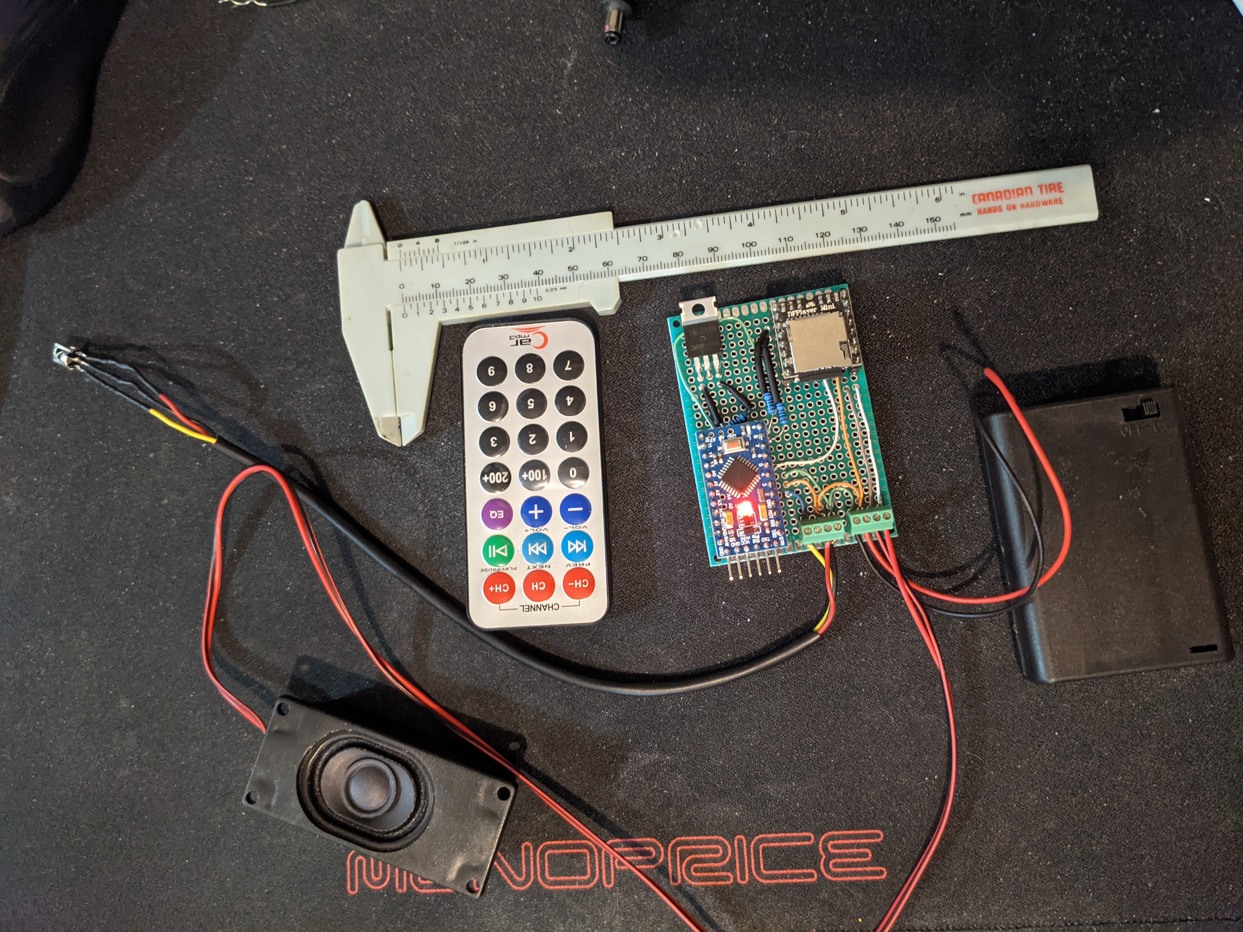

I've seen light and sound kits sold for the Moebius kit as well as people's jury-rigged solutions for sound but I didn't like any of them. They all either had an ugly physical switch which I didn't want to see visible, or they were playing randomized sounds, or they were made of the cheapest possible toy components, or they relied on poor quality recordings through a built in mic. etc.
I wanted to do better for mine. So my sound solution is quite complex comparatively speaking. It's an Arduino that runs off of AA batteries in a low power sleep mode so that it can be left on for extended periods of time and be woken with ease by activating the sounds which are stored on a microSD card inserted into a DFPlayer Mini MP3 player. There will be an IR receiver hidden behind HAL's speaker grill which will receive signals from a small remote that can trigger up to 29 different sound files on demand. This is all hooked up to a 3W 4Ohm speaker which pumps out decent sound at a good volume. I had an aquaintence assemble it for me since my confidence with wiring and soldering is low.
Very nice to see your progress. I see that you use the Arduino Pro Mini - that's usually my preferred choice too.
For the speaker, I would recommend that you maybe try a slightly bigger one. It really makes a difference. A slightly improved response to lower frequencies adds a lot to HAL's voice. Maybe just try it once, to see if you notice any difference - e.g. with a simple PC speaker from a thrift store (that's where I get mine).

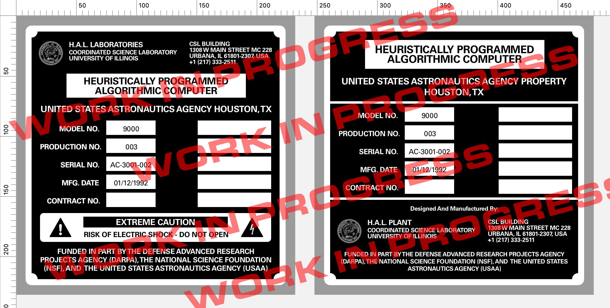

Working on some ideas for a name plate tag for the back cover of HAL that will be hiding the ugly guts within.
My thinking is that I'll rivet a name plate to the back cover.
It won't be silk screened though due to costs involved/minimum quantities so it'll likely be a custom printed decal on a small metal plate.
Any feedback so far? I tried to incorporate as many known canon details as possible while imagining others.

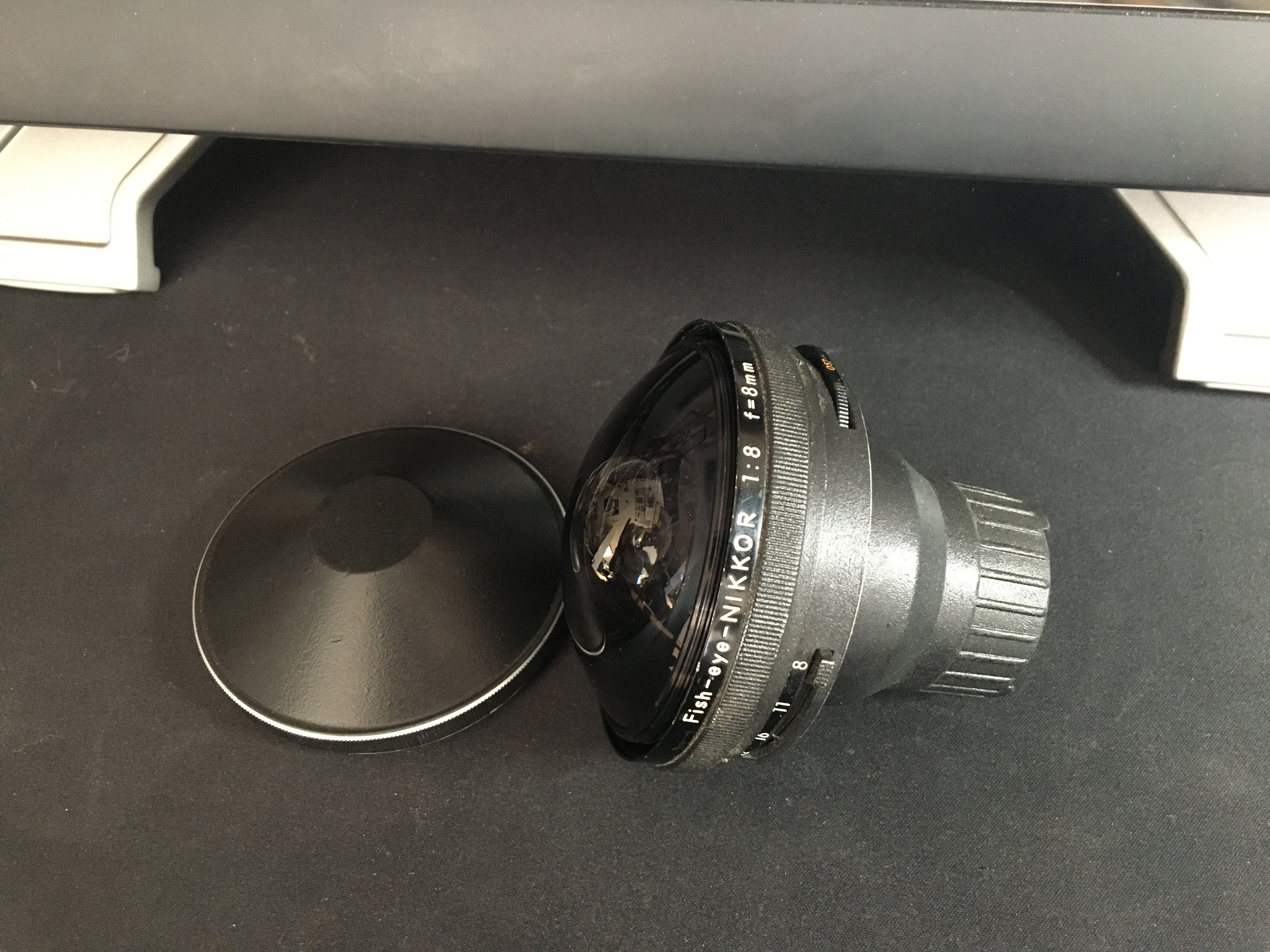

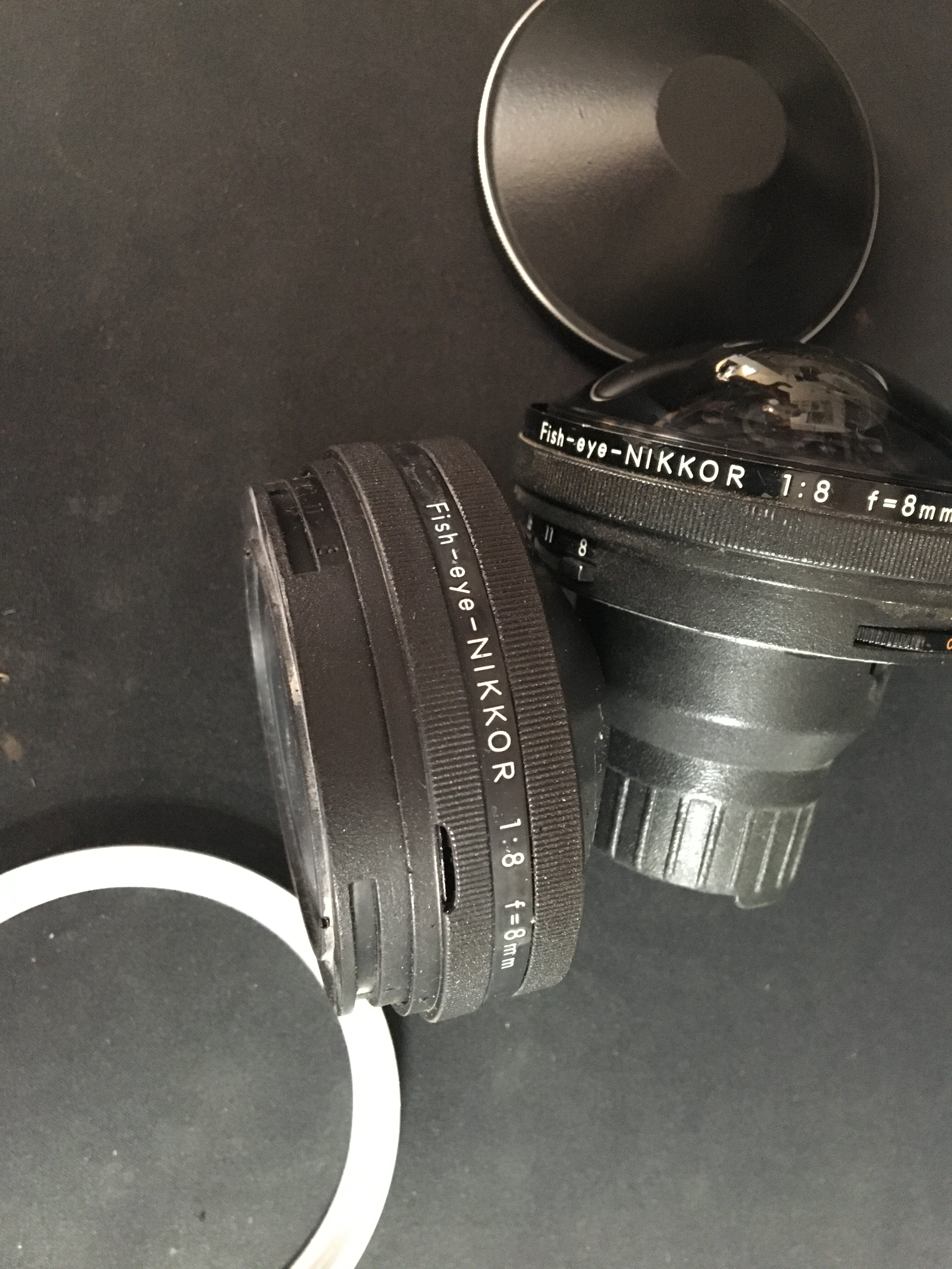

I have a Fish-eye-NIKKOR 1:8 f=8mm lens that I got when making my Hall. I was make 8 for friends one who actually work on 2001so I ended up molding the lens and keeping the real lens as I show peace. I have rejects from the mold I never through away if you want to make sure you get you letters write. Message me.

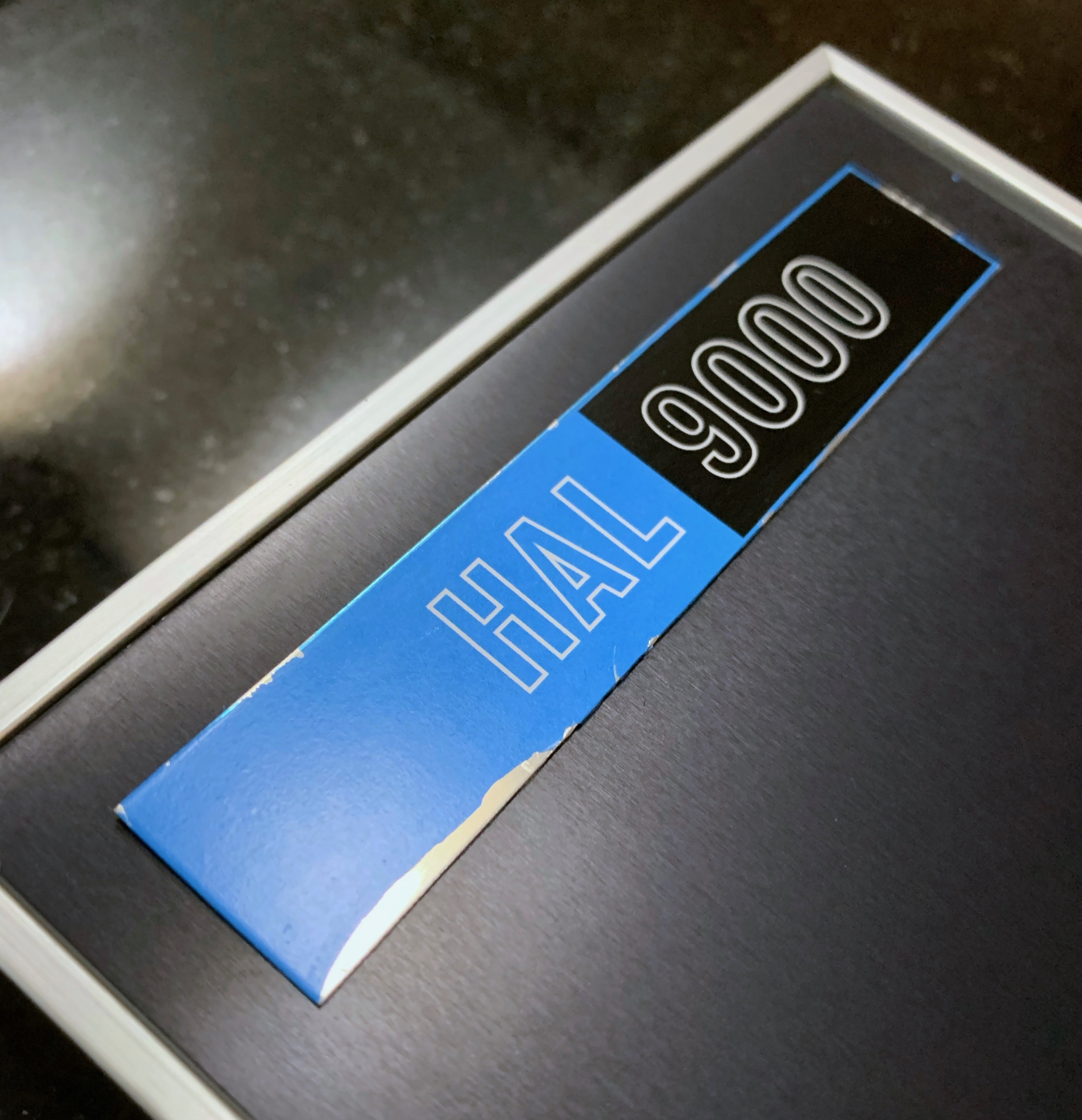

Here's a photo of my failed attempt at a water slide decal on metal plate.
I've scratched the edges up further since the initial failure and now it kinda looks like an authentically aged screen used plate or something.

Love the build and the electronics also. Careful with the speaker. When hitting the side of your frame it has that "snare" sound.
That is: the sound is making your alu frame vibrating, hence distorting your sound. You could surround your speaker with some kind of rubber
or absorbing medium to avoid that problem. ( "Snare" sound: as a drummer, when your snare is ready to play, the steel spring under it make any sound, around your drum kit, vibrating through the snare...hence "Snare Sound";)
At max volume sitting on a table separate of the frame it still sounds similar. But I agree that it needs some padding. I may use some anti-vibration pads meant for laundry machine feet or something. Also the speaker sounds a bit better when muffled/covered a bit. If I cover the speaker with my hand the high ends are muffled a bit and it sounds... better(?). Maybe I can reshape the sounds a bit with some audio editing software to optimize them for this speaker with some EQ tweaks.
That or changing the size of the magnet behind your speaker;)
