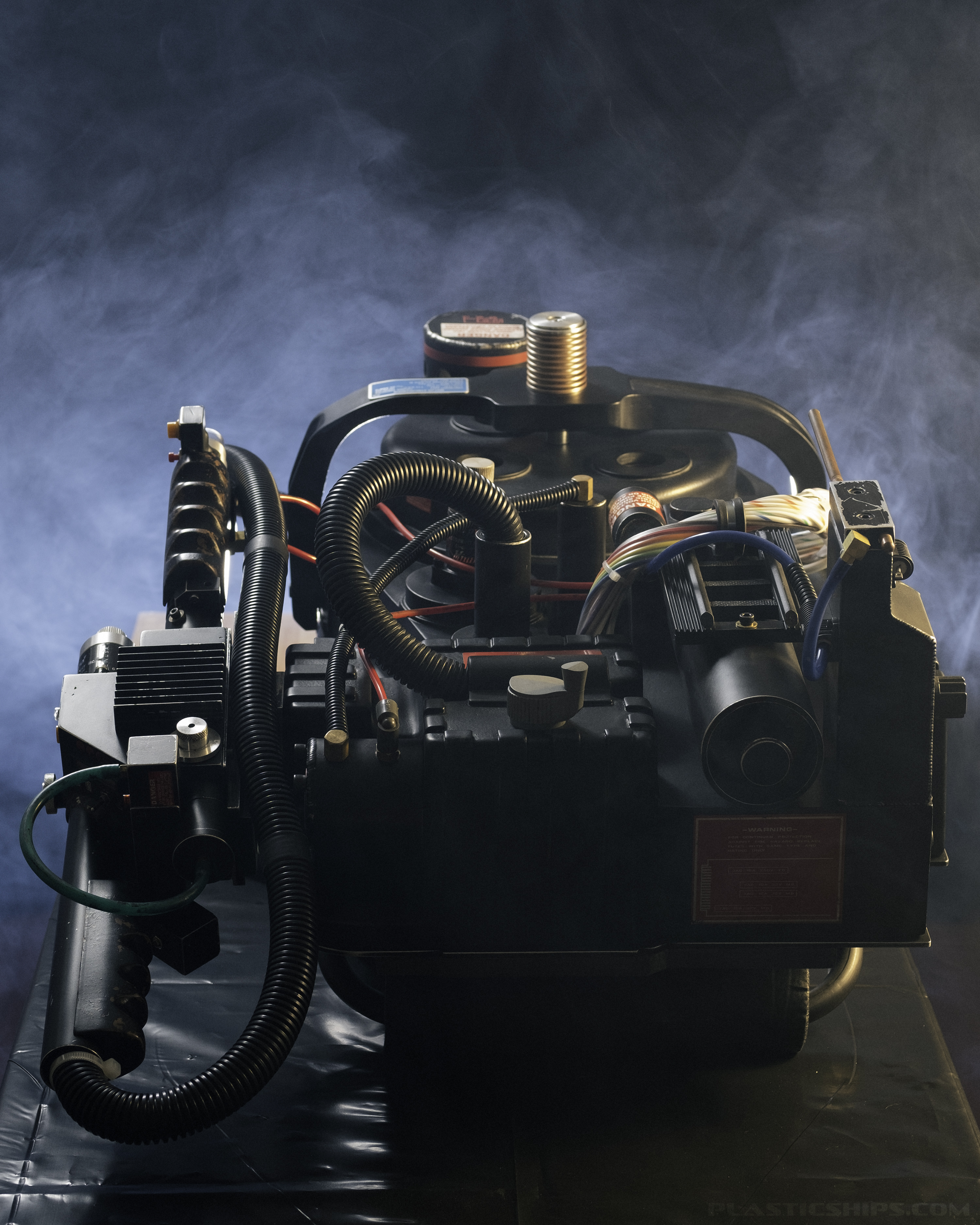

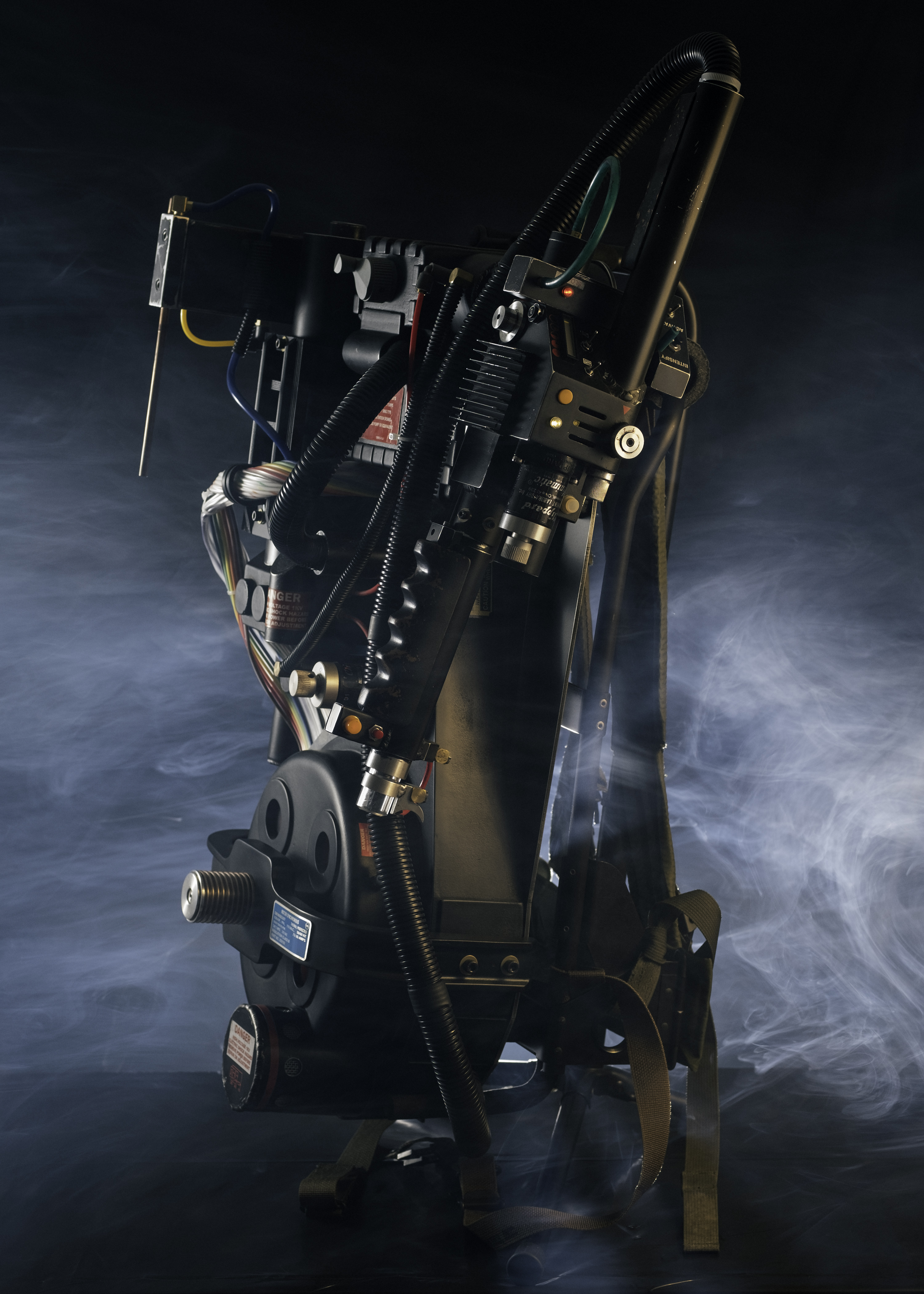

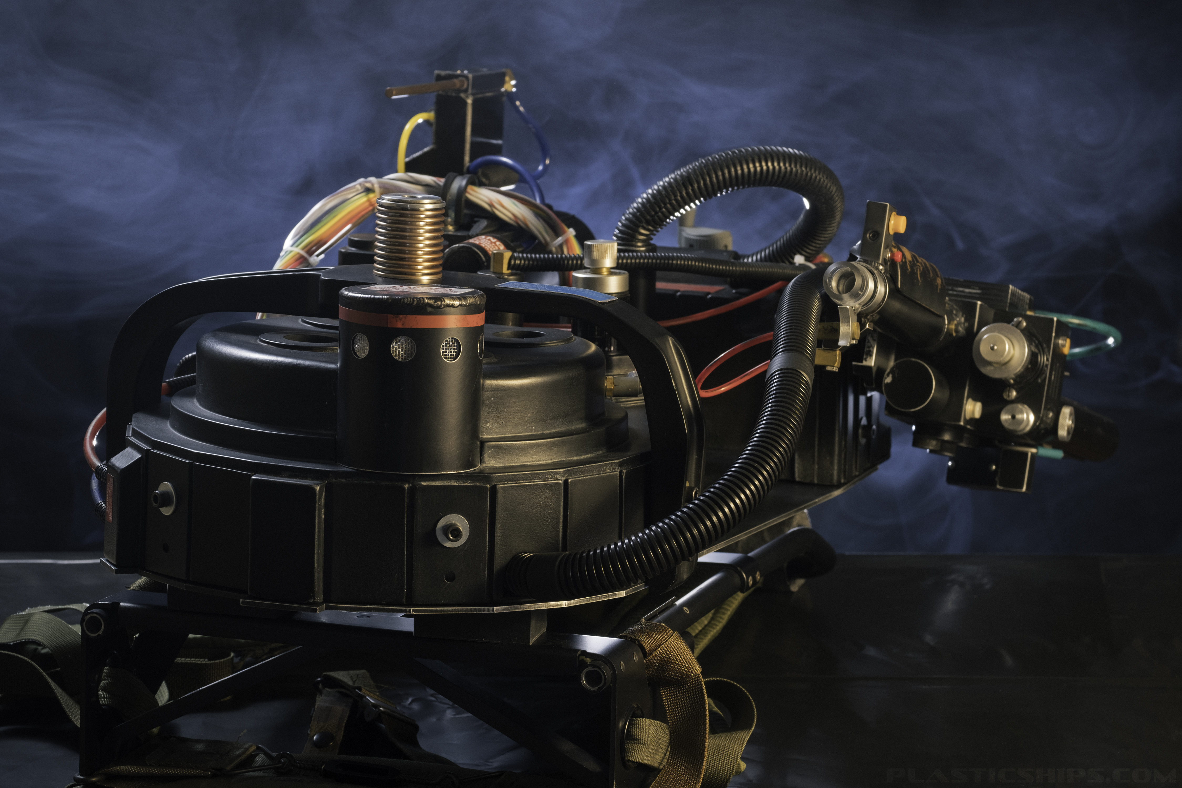

So then... I recently finished my first piece; a hero Proton Pack.
Spooky photos:

That looks fantastic!
Wow! That’s gorgeous! Love the smoke effect too!

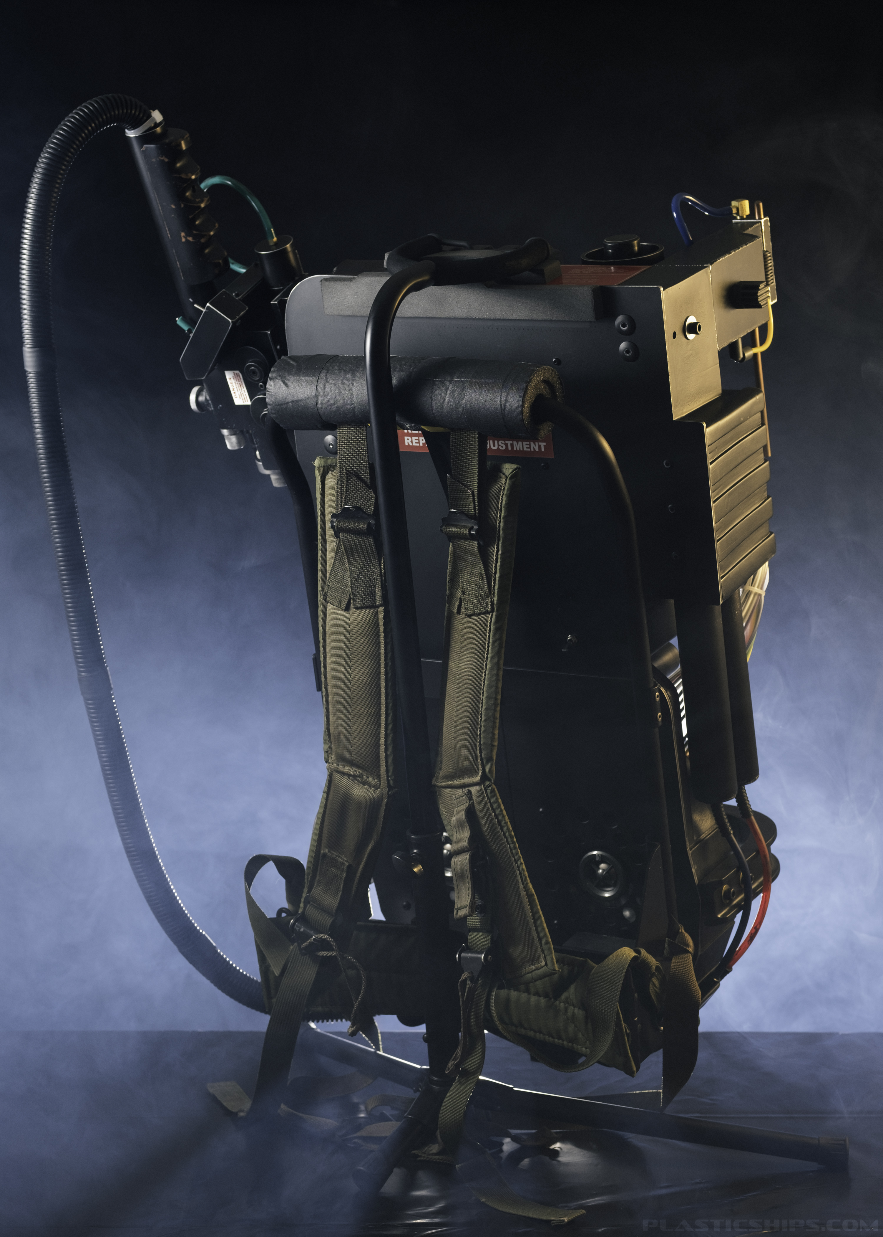

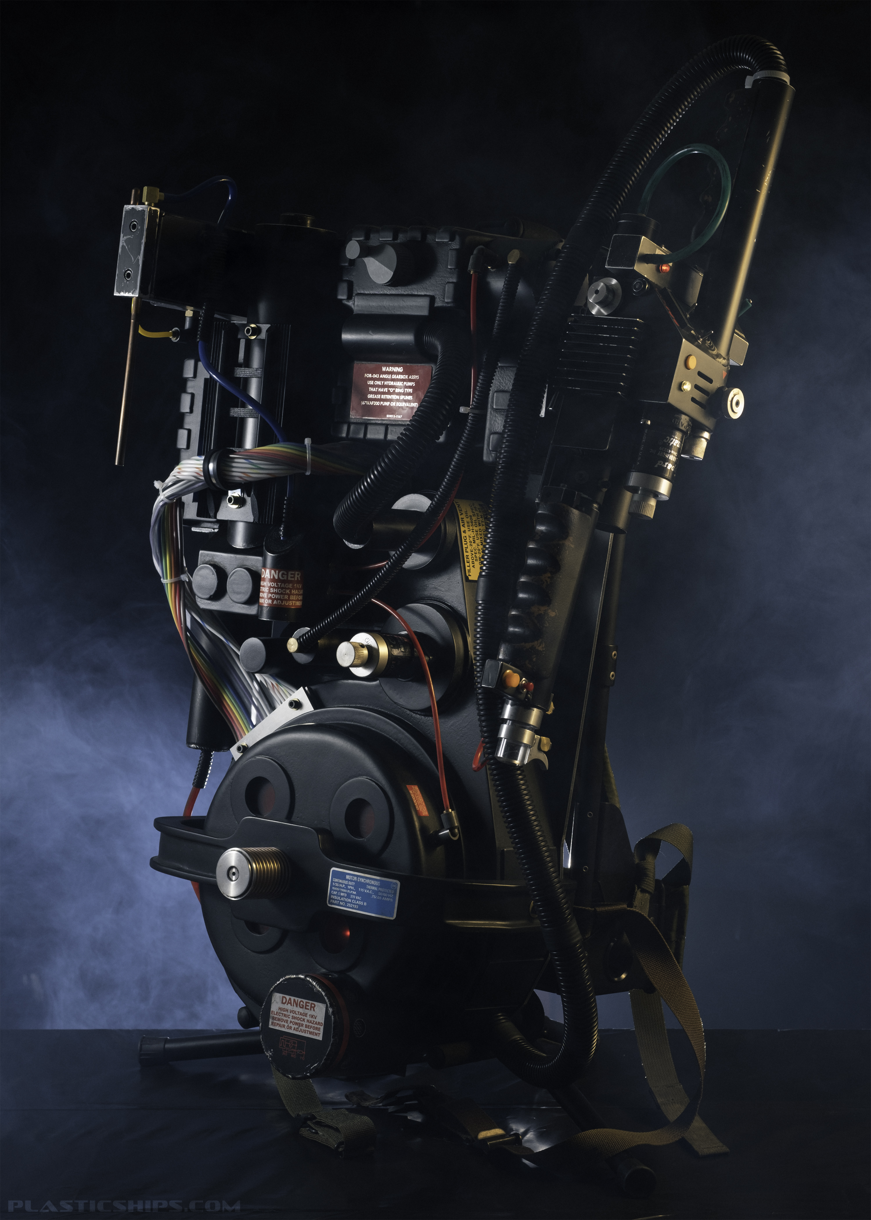

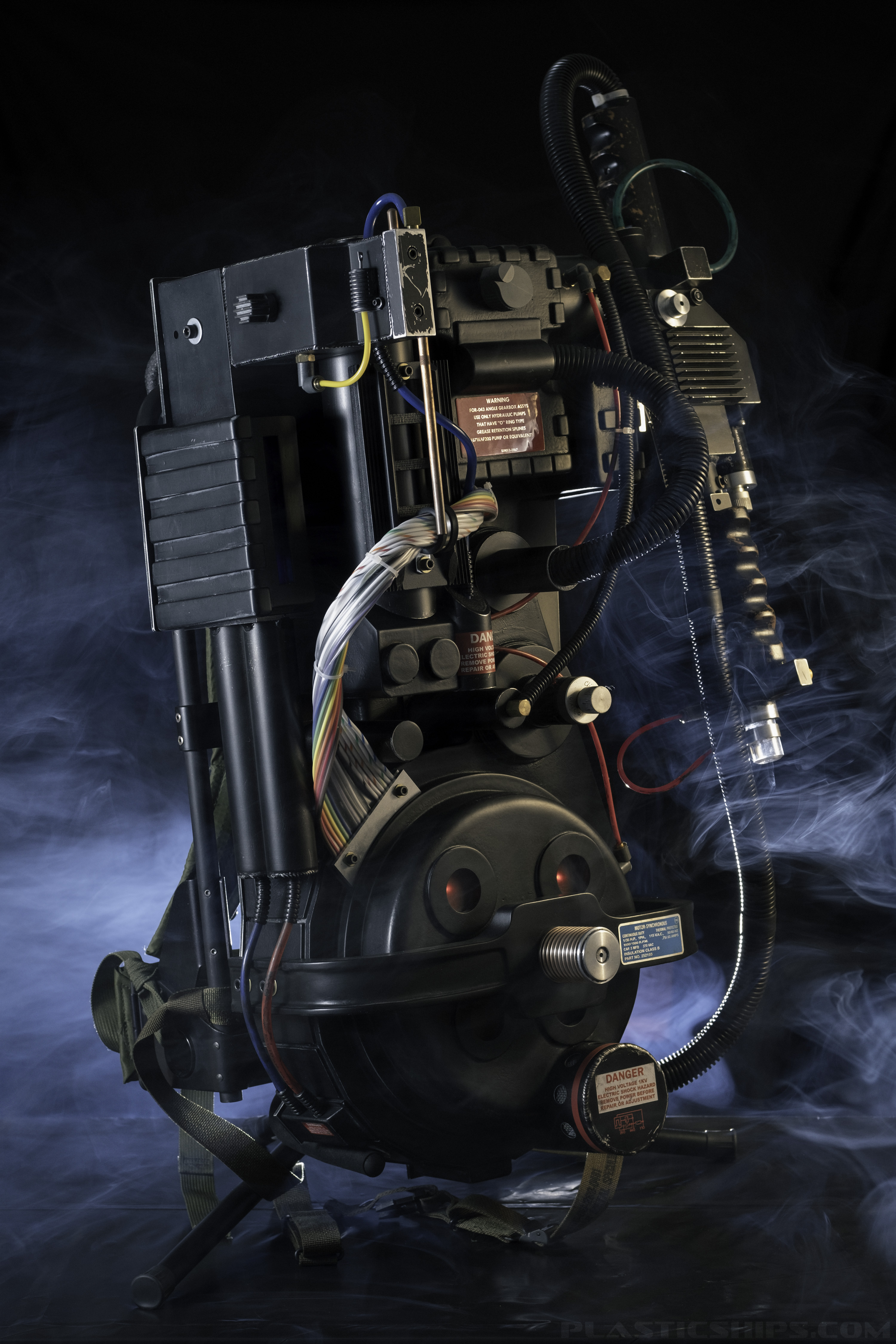

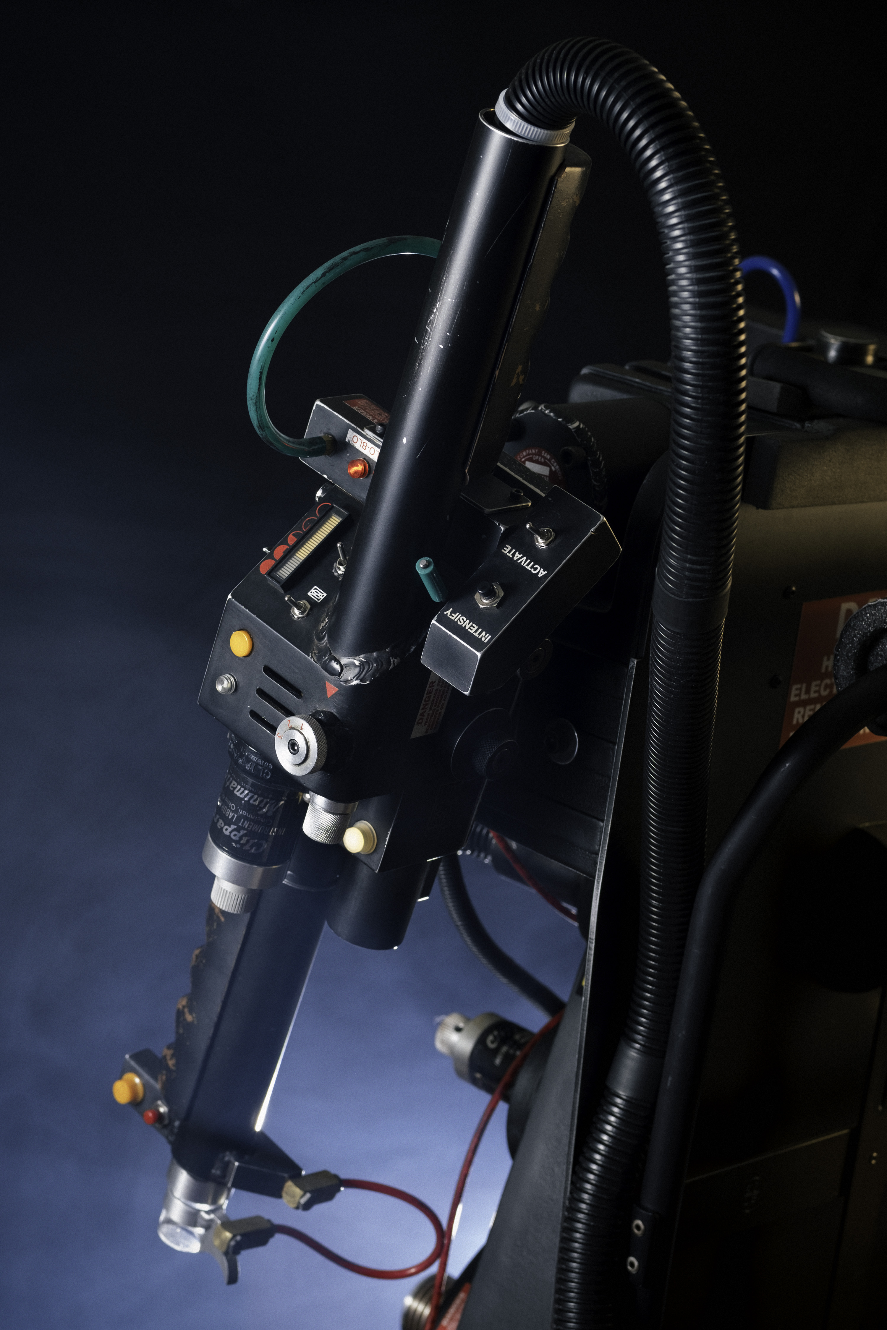

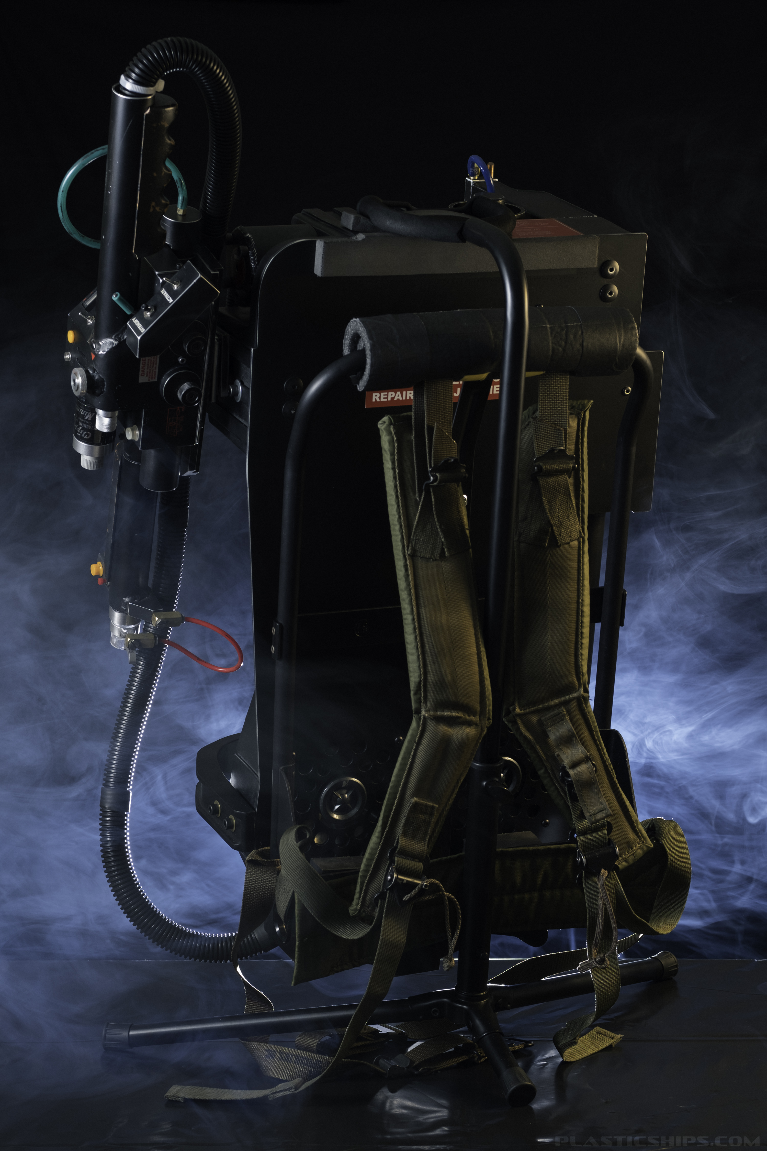

Most of the parts I got second hand from a single Ebay auction lot. I couldn't tell for certain their origin, I know they aren't from any of the current crafters out there.
The auction lot was one of those dream scenarios where you have half a jigsaw puzzle with randomly missing pieces and here comes this one auction with the exact matching complement. It had a full set of impeccable aluminum parts. Like the Ion Arm is totally GB1 accurate with copper rods. There were vintage clippard valves and milky white hat lights and metallic labels and dryrub transfers. Screen cast wand handles (that suck). Cast rubber ALICE spacers. I wasn't even considering this level of accuracy at first because no one really offers this stuff anymore.
So after getting all that I had to adjust my approach. I had a BenofKent shell that I love, but I decided to get a GBfans shell for this build since its shape has more of the nuances of the original props. I replaced an LC-2 ALICE with a new-old-stock LC-1 complete with thin uncomfortable straps.
Any thoughts of it being light weight went out the window. (it's 32 pounds)
Most of the hardware is real and vintage. The legris elbows are 5mm instead of the screen accurate 4mm. The clippard barbs are new but I sawed off one prong from each of them. (modern ones have 5, the old ones had 4. Big difference.)
They gray resin bumper/ladder are from Heavyprops, also sold on the GBfans store.
The Bumper Bellow is an old aluminum one from Exoray. I really like this. There are a few people who sell aluminum ones today but the profiles are totally wrong. And real bellows are too fragile IMO. I lightly airbrushed the aluminum to get the bronze look.
The GB1 ribbon cable is from Fincher technologies and regularly sold on Ebay. I have 4 of these now all from different makers and Fincher's is the only one anybody should consider.
For the wand cable I used non-split loom tubing because I prefer solid shafts over slits, and the little rings are heatshrink instead of electrical tape.
