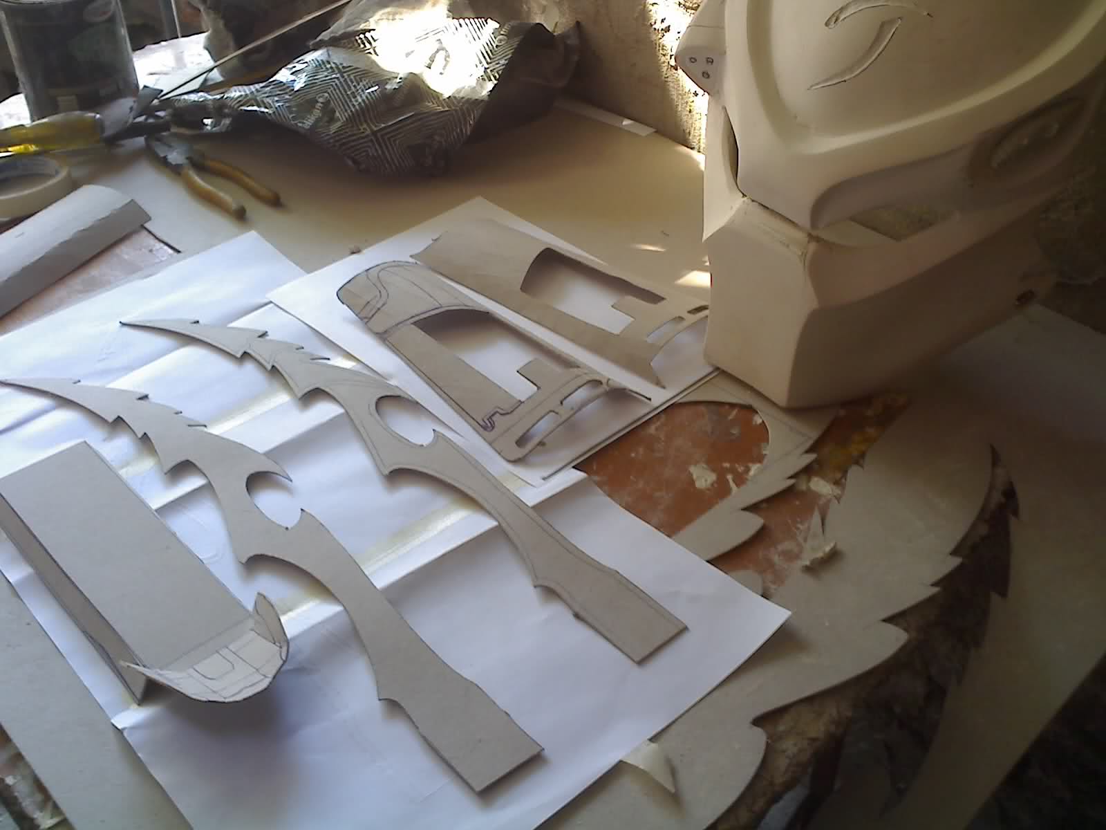

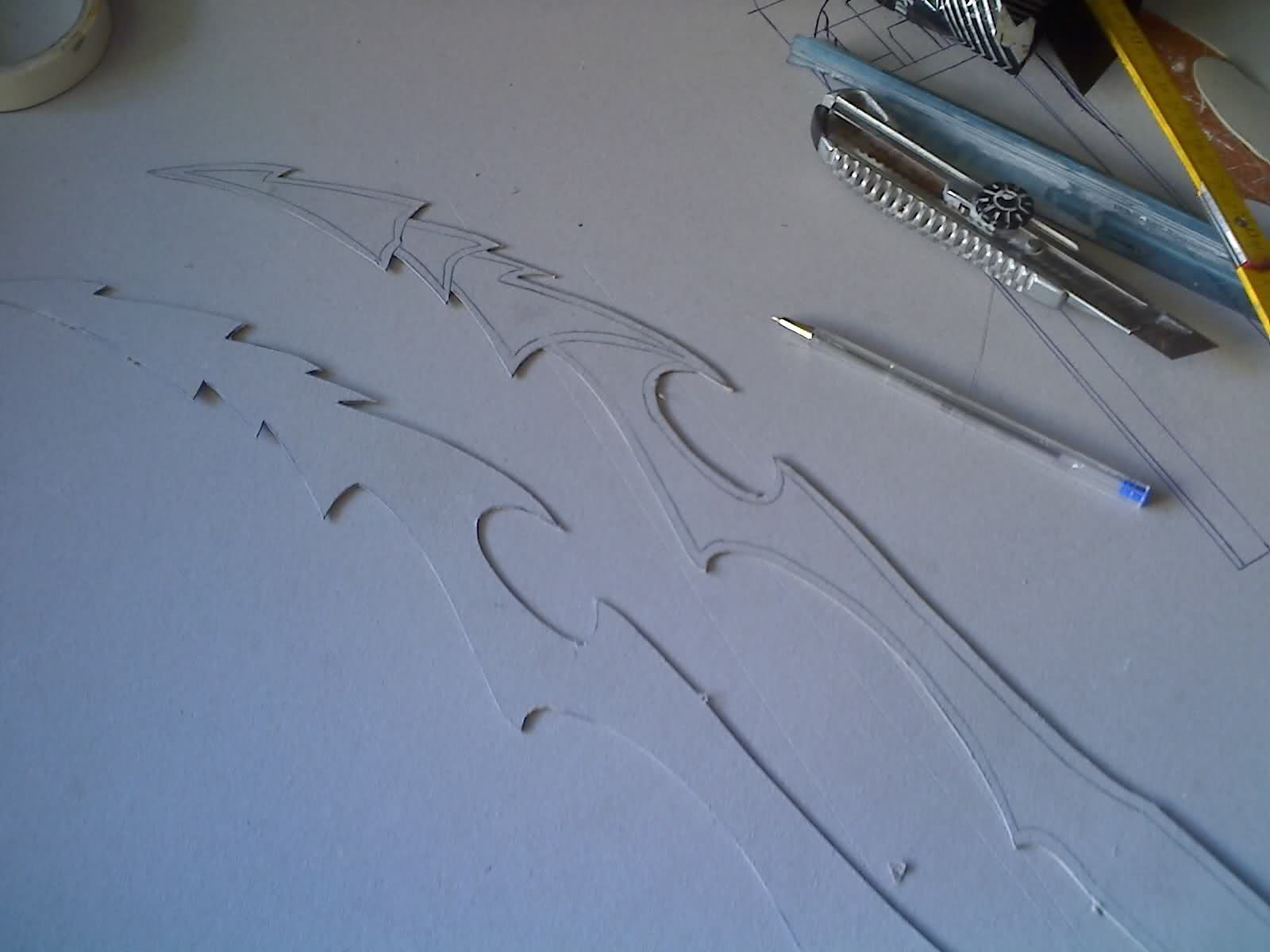

here is a reference pic so you can see how i will do it. first i draw the helmet over cardboard and then cut and assemble parts after this i will give a coat of ployester

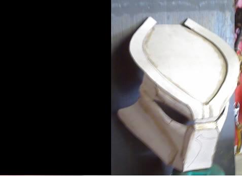

hi guys, well here i have my carboard bio i used some pics to build it the next step is the finish coat
I think by being a model scratch, I see quite achieved
any suggestions?

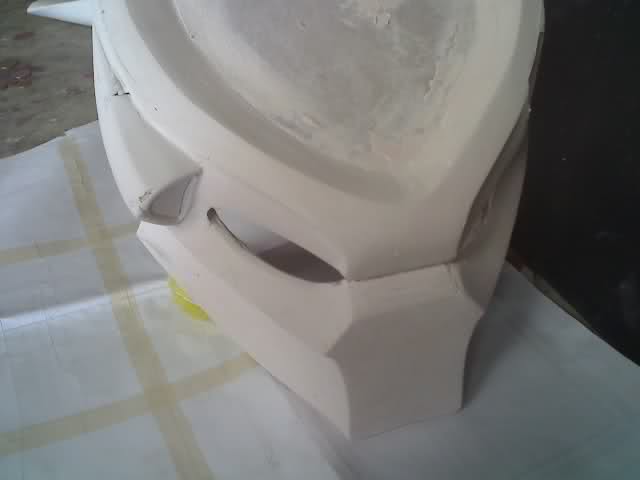

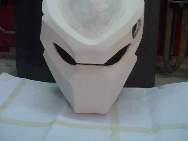

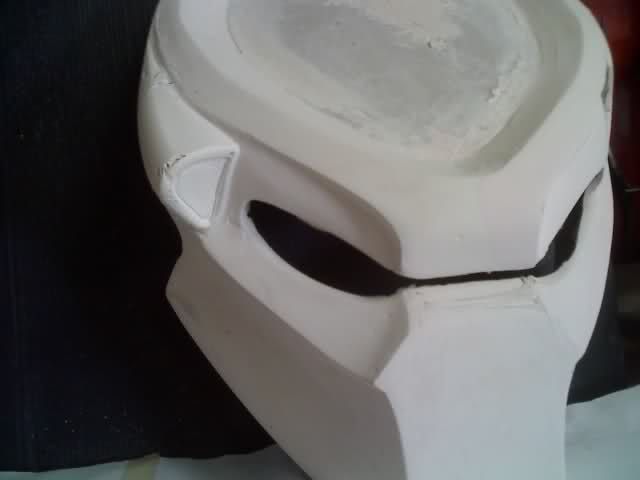

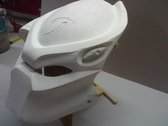

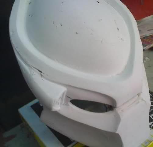

here i have my bio with a coat of polyester and sanded is a custom bio because is not the same as the original but i like how it looks
the cheeks, eyebrows and the upper ring has more sharp this gives a more agressive look!!!!
i will call this bio........ warrior predator :) :)
criticisms are welcome
:) You managed to make that out of cardboard!!! You said you used a coat of polyester, is that some sort of special putty or paint you can buy? Because I might give this a go see what I can do. :)
yeah anbush this bio is out of cardboard as you saw in the first pics :)
the coat,is polyester putty for car repair!!!! is not a paint .first prepare the putty. that is two parts, putty + catalyst is applied with spatula and then is sanded. the termination is going to be according to the skill you have with the sanding

Wow so basically cardboard and bondo (don't know what body filler is used in the rest of the world) that's really impressive
grindi this bondo is use for boat repair too!!!!!

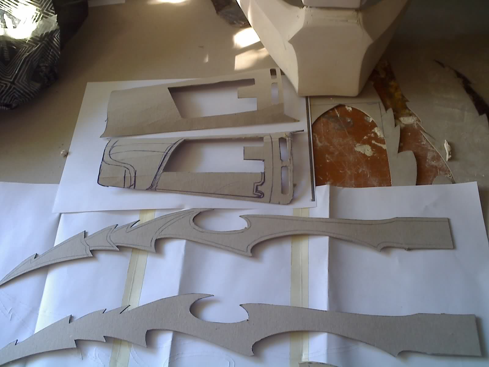

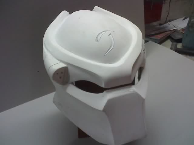

well updating my warrior predator work here i made the system to attach the laser. i hope you enjoy it :) :)
Thats a helluva nice bio, I would have never thought cardboard and body filler would work so well. Keep up the good progress.

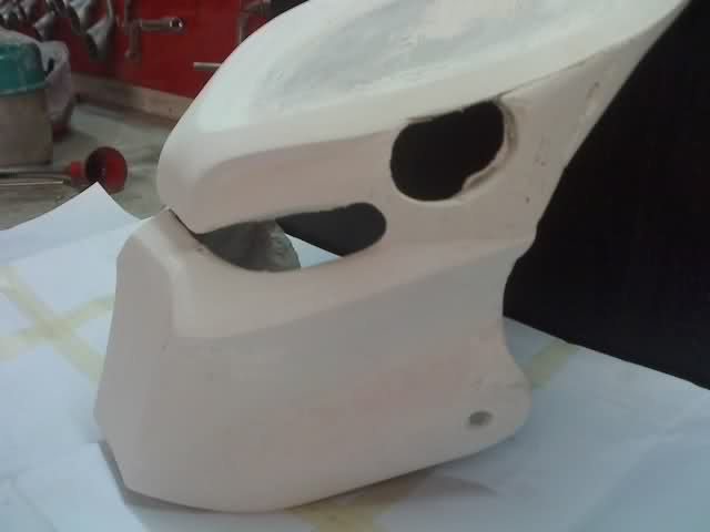

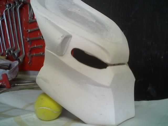

well here i made the upper part of the bio
i need some ideas for paint i thought to leave the bondo holes looks like battle damage, but i don't know really
any ideas guys?
Looks like its coming on well! Keep the bondo holes, think about it a real predator wouldn't always have a perfect bio if hes hunting. Buy some primer first and do a few coats so the paint can stick better.
thanks mate!!!

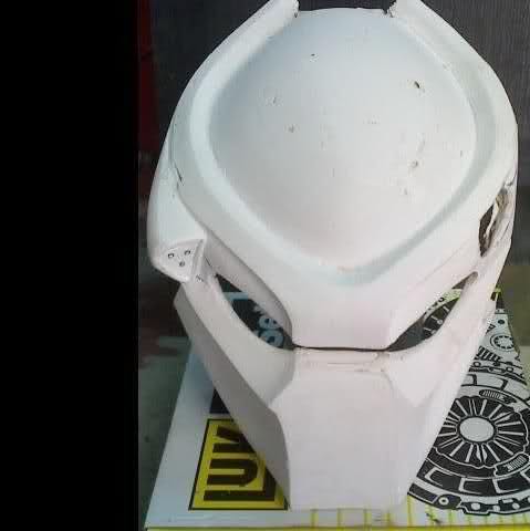

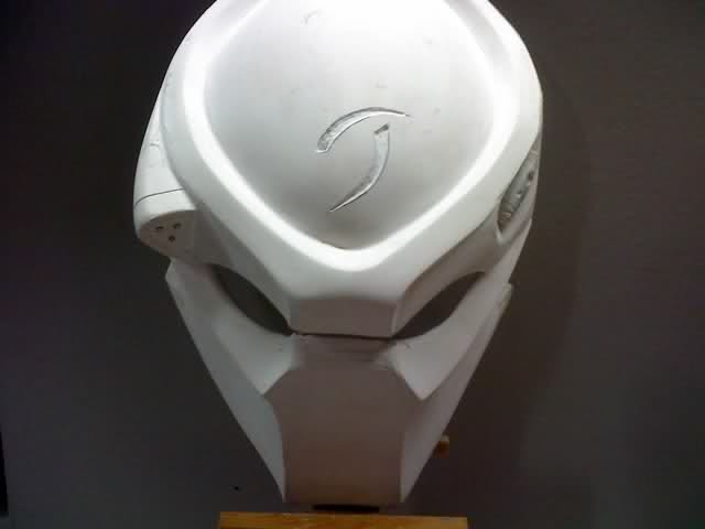

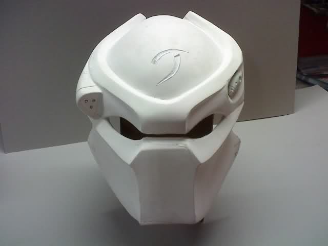

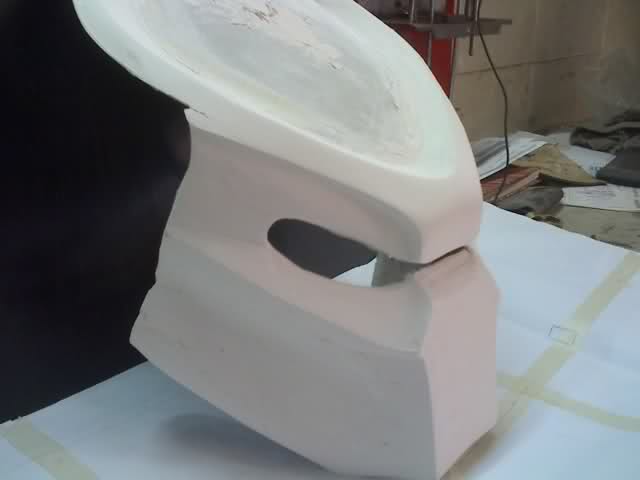

well i finished the bio, a hard work!!!! i will give a coat of primer and think about the color
guys how it looks? opinions? :)

Pretty sweet. I think you got some pretty good details there for body filler. Just hold the sander on a spot for just a second can screw it all up. Nice job :)
The hammered paint should look real nice on it.

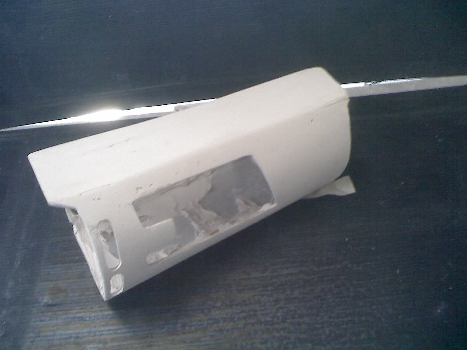

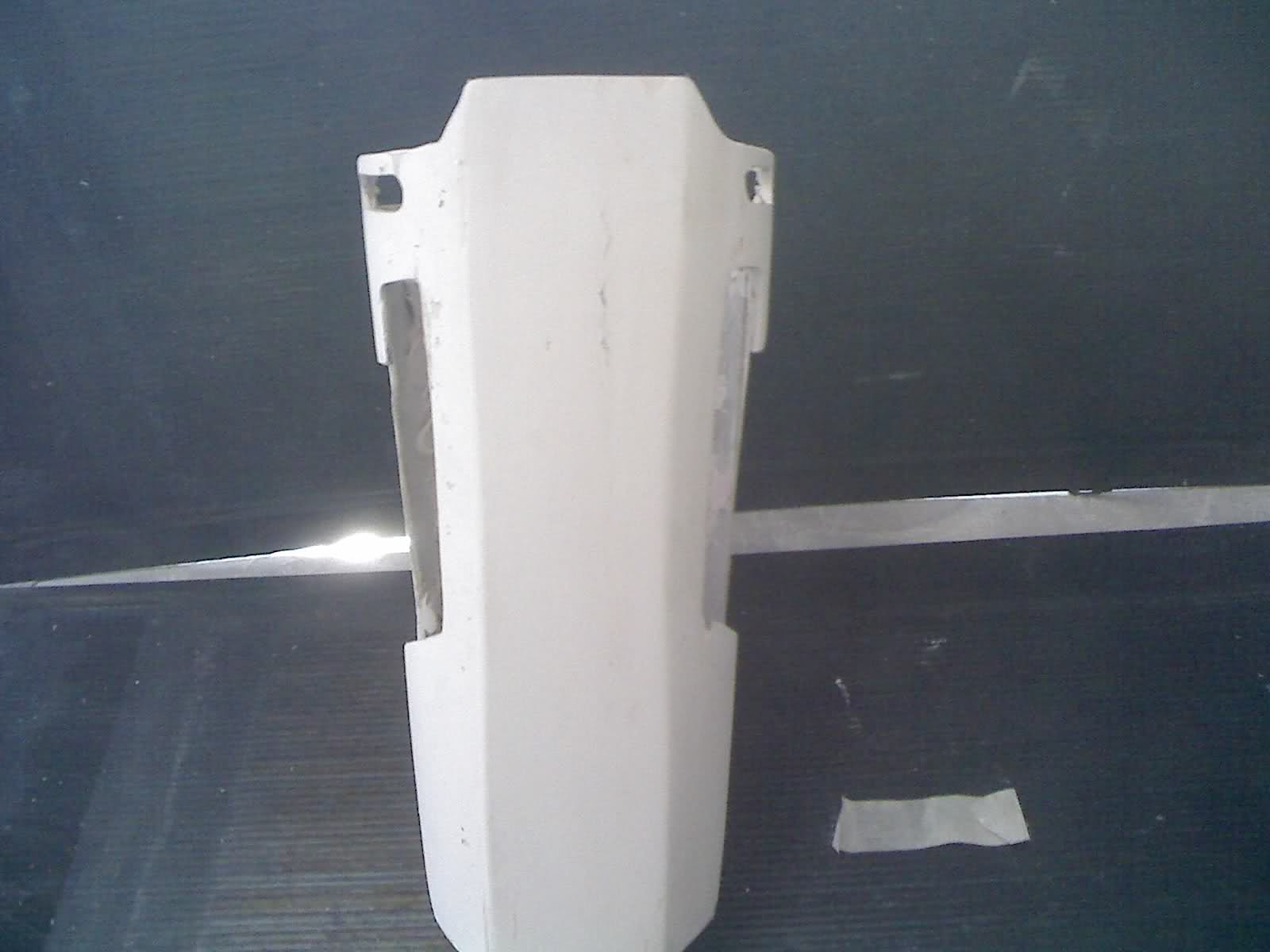

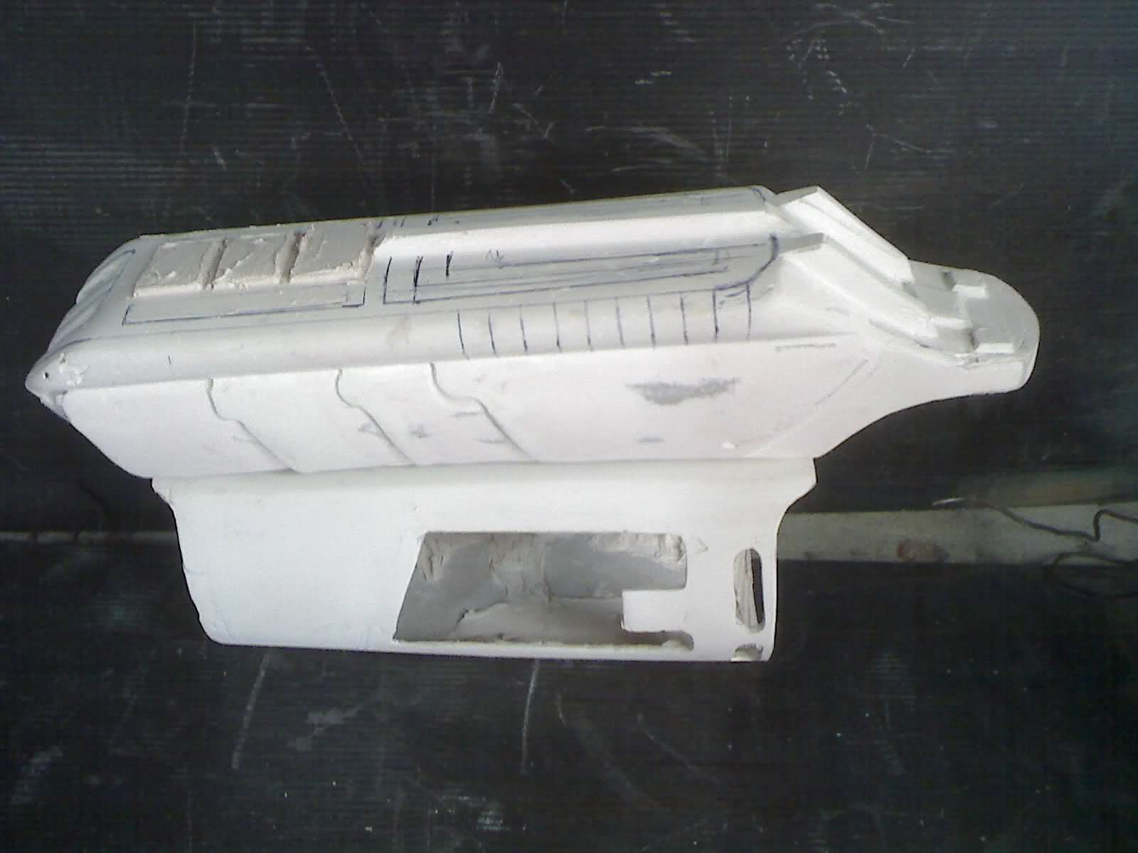

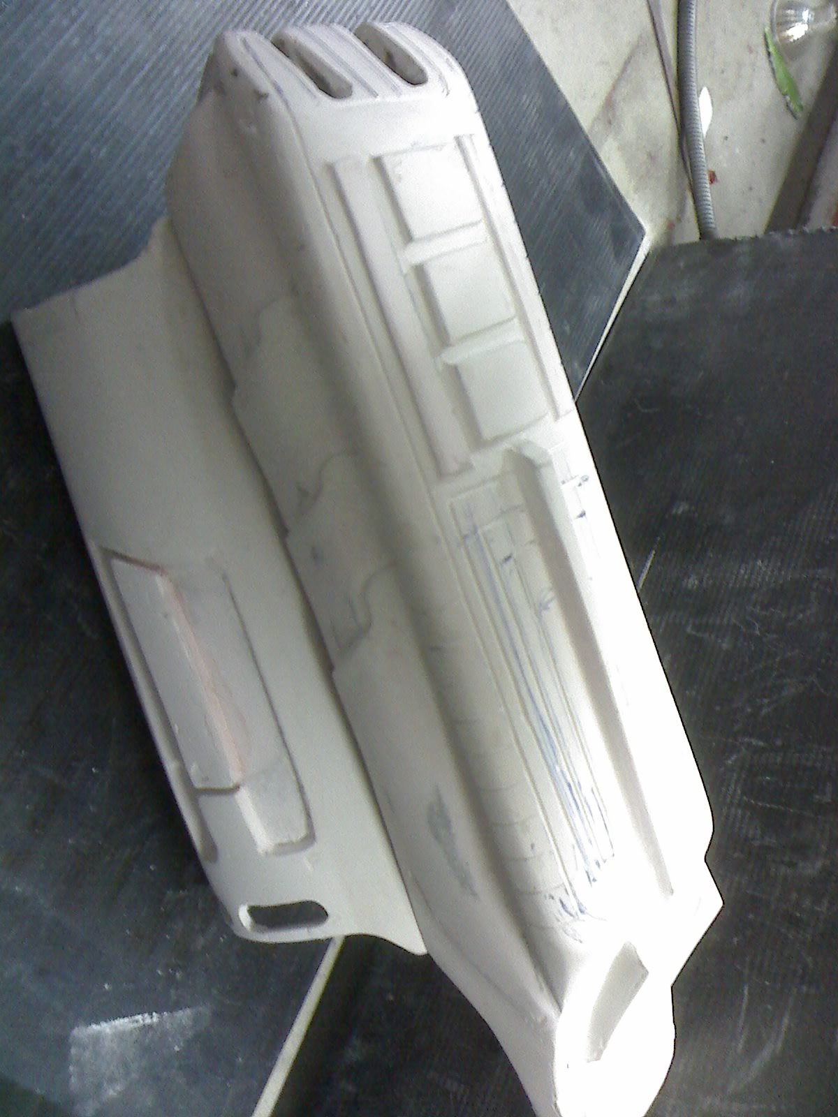

here is the gauntlet in progress i was looking for some perfection but as you said predators has some damage on the armour so i've follow the advice of you, guys and leave holes in the bondo so it looks like battle damage

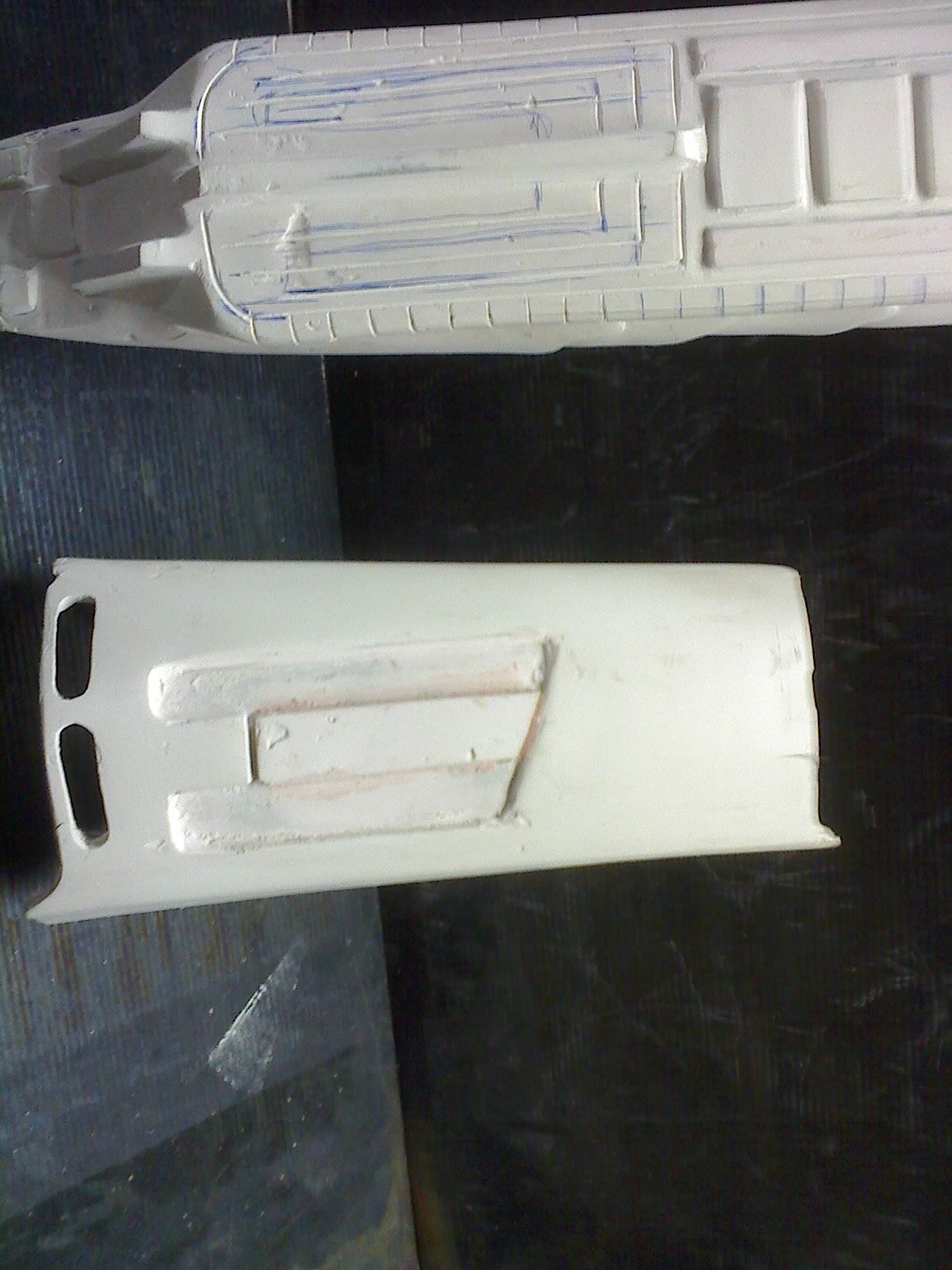

updating my gauntlet

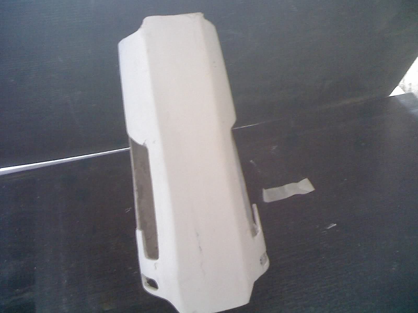

i build this part with some pics as reference but i made a different design i like how it looks!!!
opinions? :D

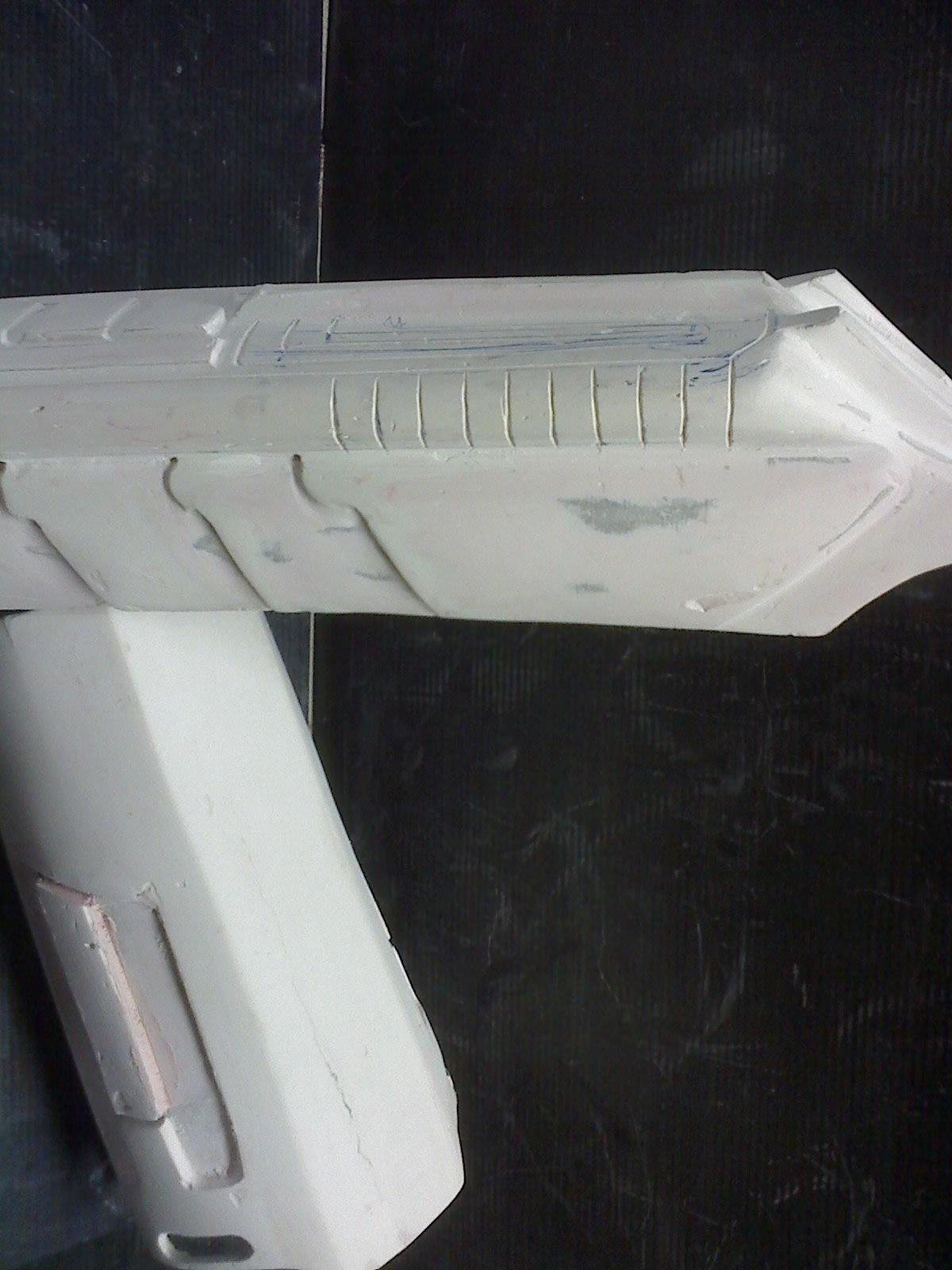

hey guys here i have more progress !!!!!!!
i finished the upper part of the gauntlet well (i don't know the exact word) i made a few lines on the sides and top
