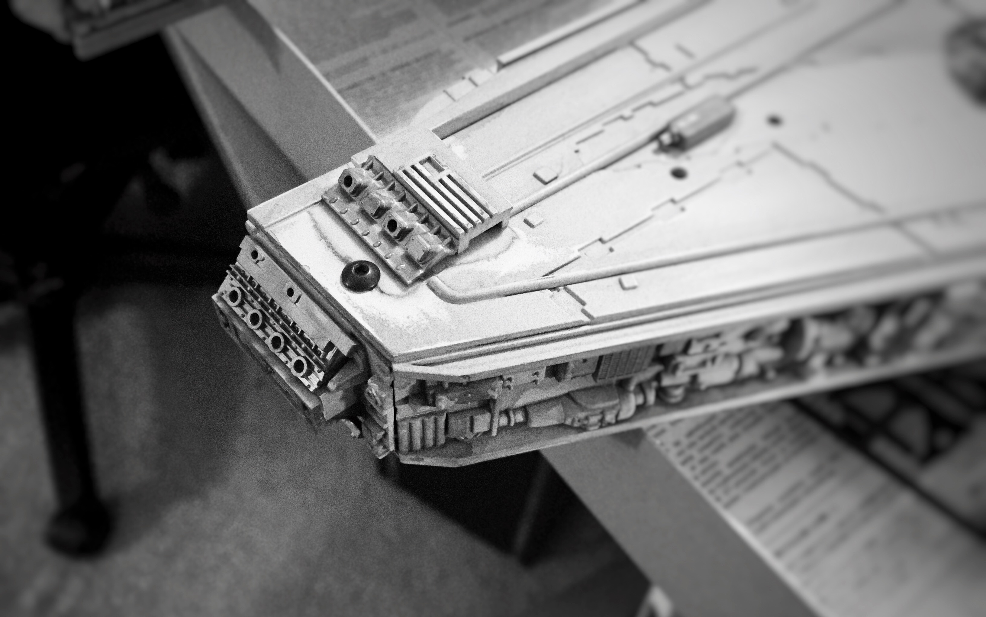

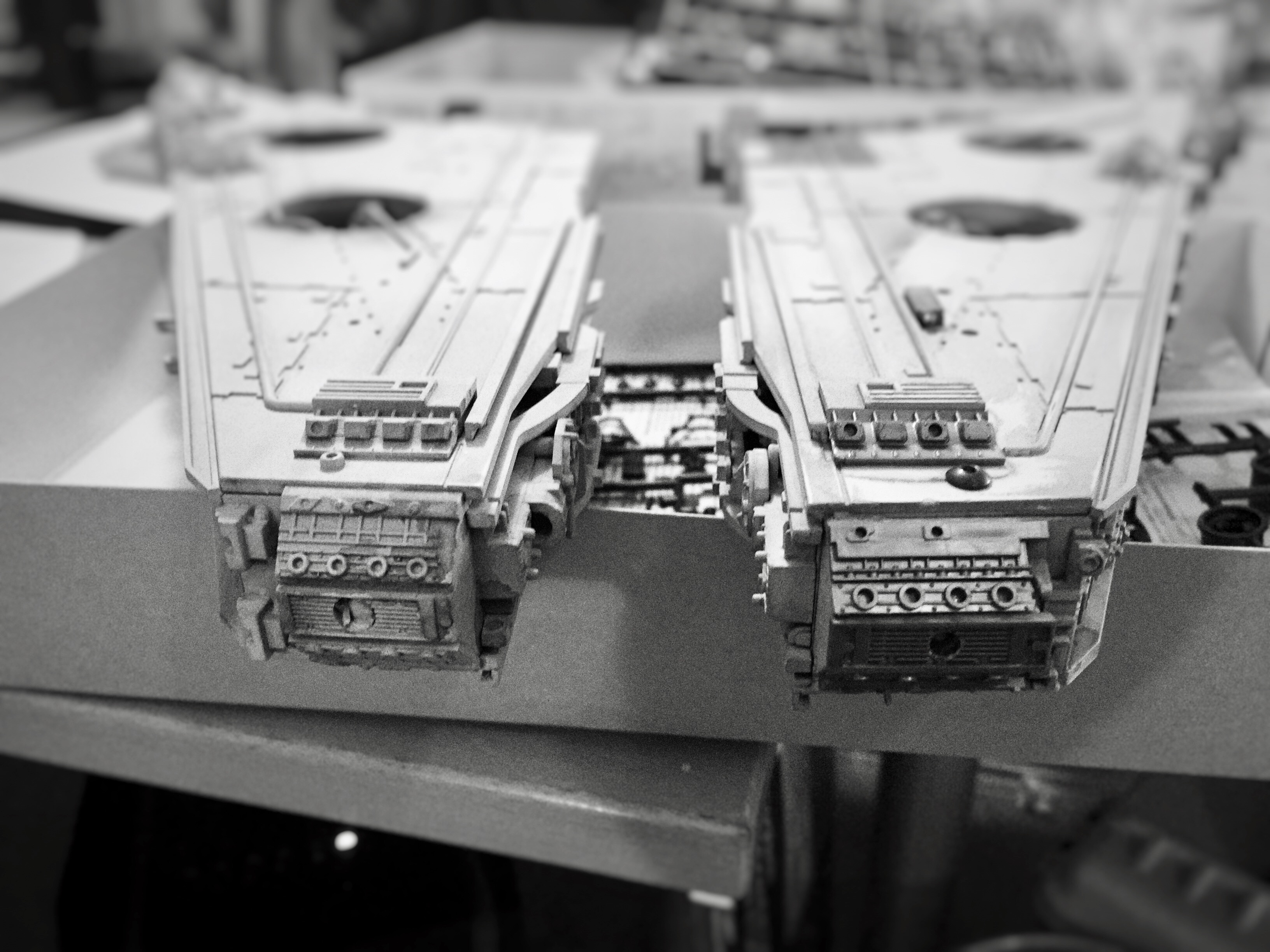

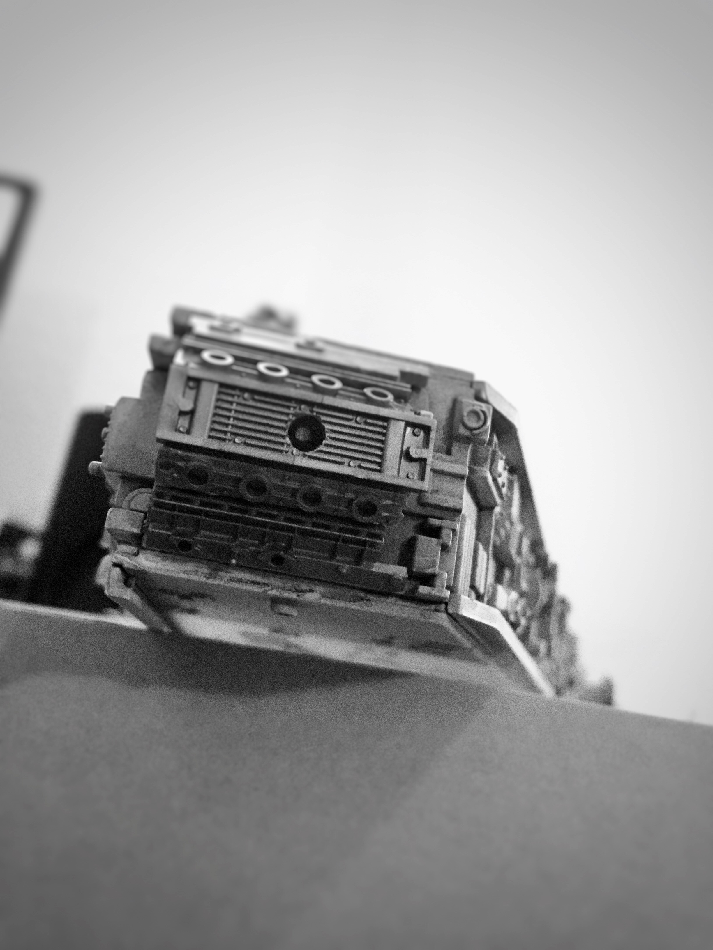

Rebuilt all the front mandible details with the P34 parts! Totally worth it, looks much better!

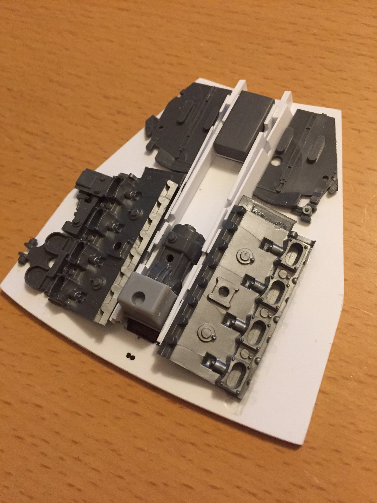

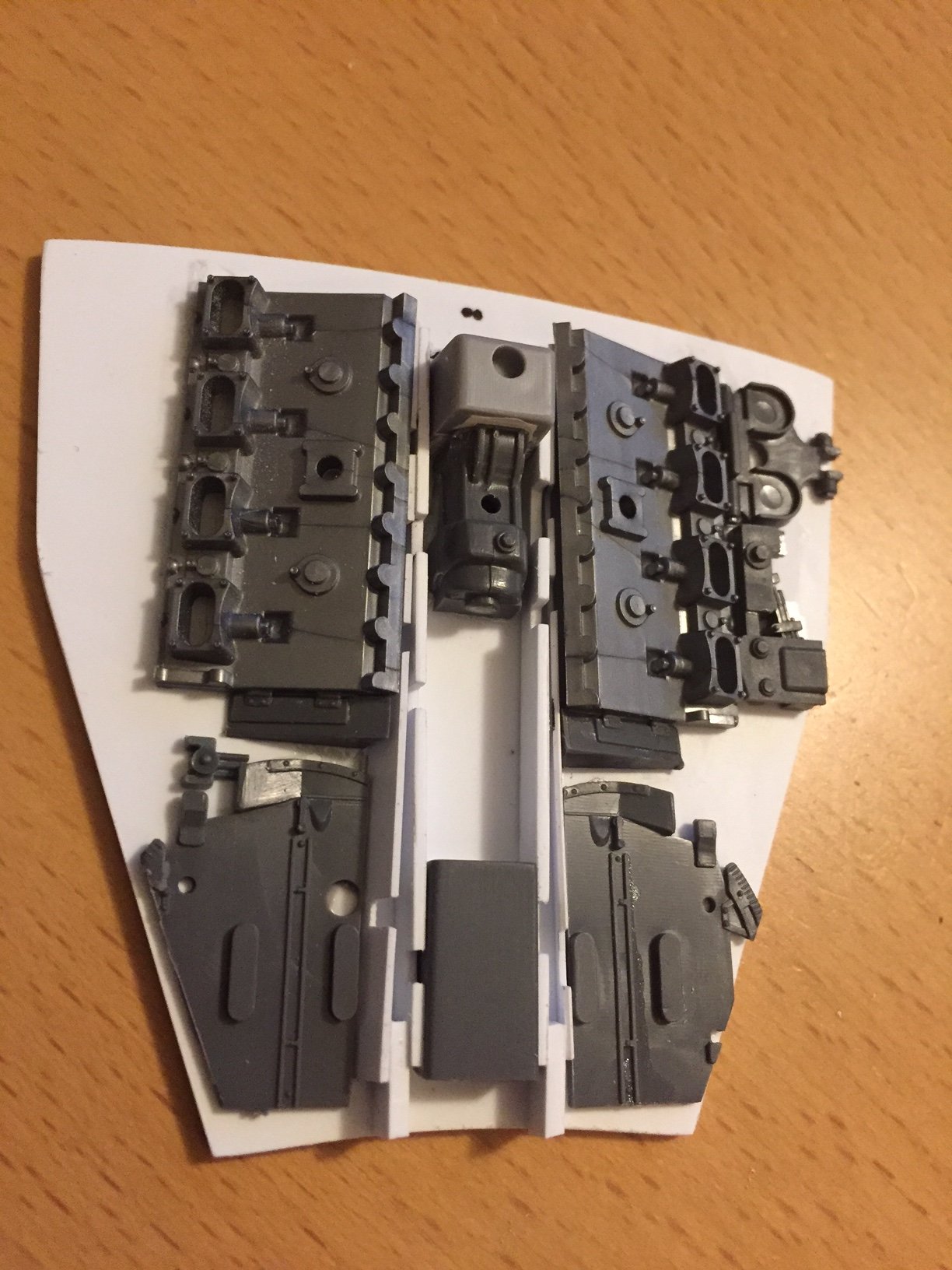

You can see the original DeAgo castings on the left and the updated kit parts on the right!
Wow! That looks incredible! I don't suppose that you mind breaking down the parts and showing how they connect as I know there are a few parts their. Did it/does it take more than one P34 kit to complete the mandible fronts?
Yeah you only get enough in one kit for one side, I have a second P34 that I will use for the other side which is uncut and still fresh, i'll post a pic of how it all fits together this evening.

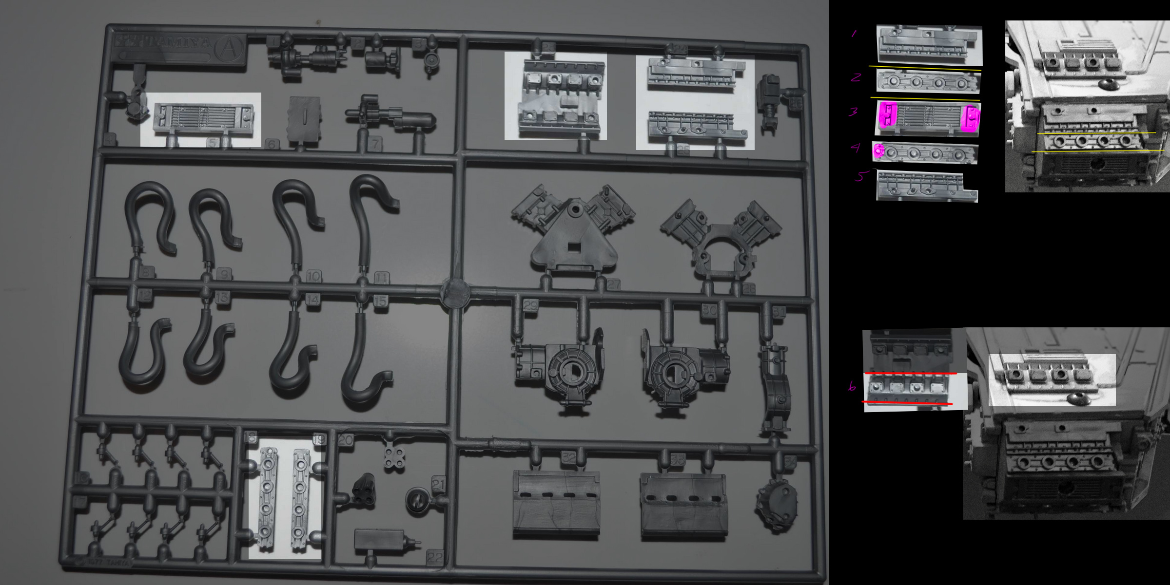

I think you would need to buy about 5 or so p34 kits ( at least I hanvnt actually counted all the parts used on the SS model yet but its a F@#$TON) lol they use soooooo many of a couple of those parts. I'm actually sending all those p34 parts off to a guy (gluejunky) who does reAAAALLLY good castings to get them cast so I can quit buying this darn thing! As well as the parts from the almost impossible to find OT shinano kit... I'll let you all know when he gets the molds ready.

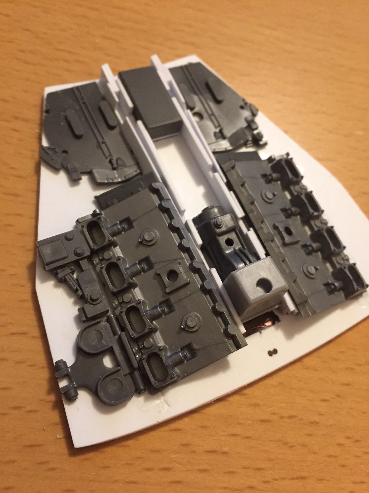

Here is how it all works out! Pay attention to the parts highlighted in Pink, the parts aren't symmetrical and need to be laid out in this manner to be accurate for the Port side mandible, also parts 1 and 5 are put one the opposite way on the starboard side, so on the starboard side 5 is on top and 1 is on bottom. MAN there is a lot of stuff like that to watch out for on this model haha, so fun to find all that stuff though!

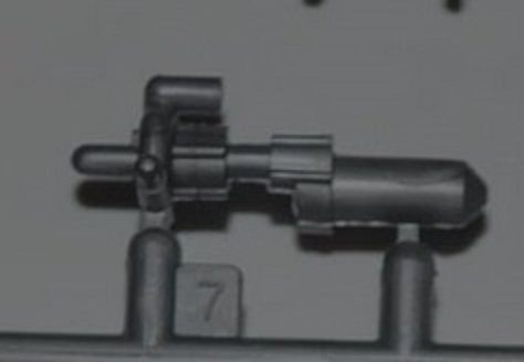

Also Im really temped to use part 20 on that Sprue for the quad cannon ends! I compared it and its the right size, if you just cut them down the center on each axis and cut in the grooves I bet they would look great, AND have holes for barrels!
Thank you so much for the tutorial. Now it all makes sense, but one final question. What did you use as the base to attach all these parts to? Did you sand down the original deago part then attach the P34 parts?
Yeah I used the DeAgo base piece since it houses the LED nicely. If I remember correctly the top and bottom parts just come off and the part across the front with the hole for the LED I just sanded down.
Cool, thanks so much, I assumed that you used the DeAgo piece, just wanted to make sure as I can't wait to make this upgrade myself. I have always preferred the 32" details for the mandible tips over the 5 footer's.

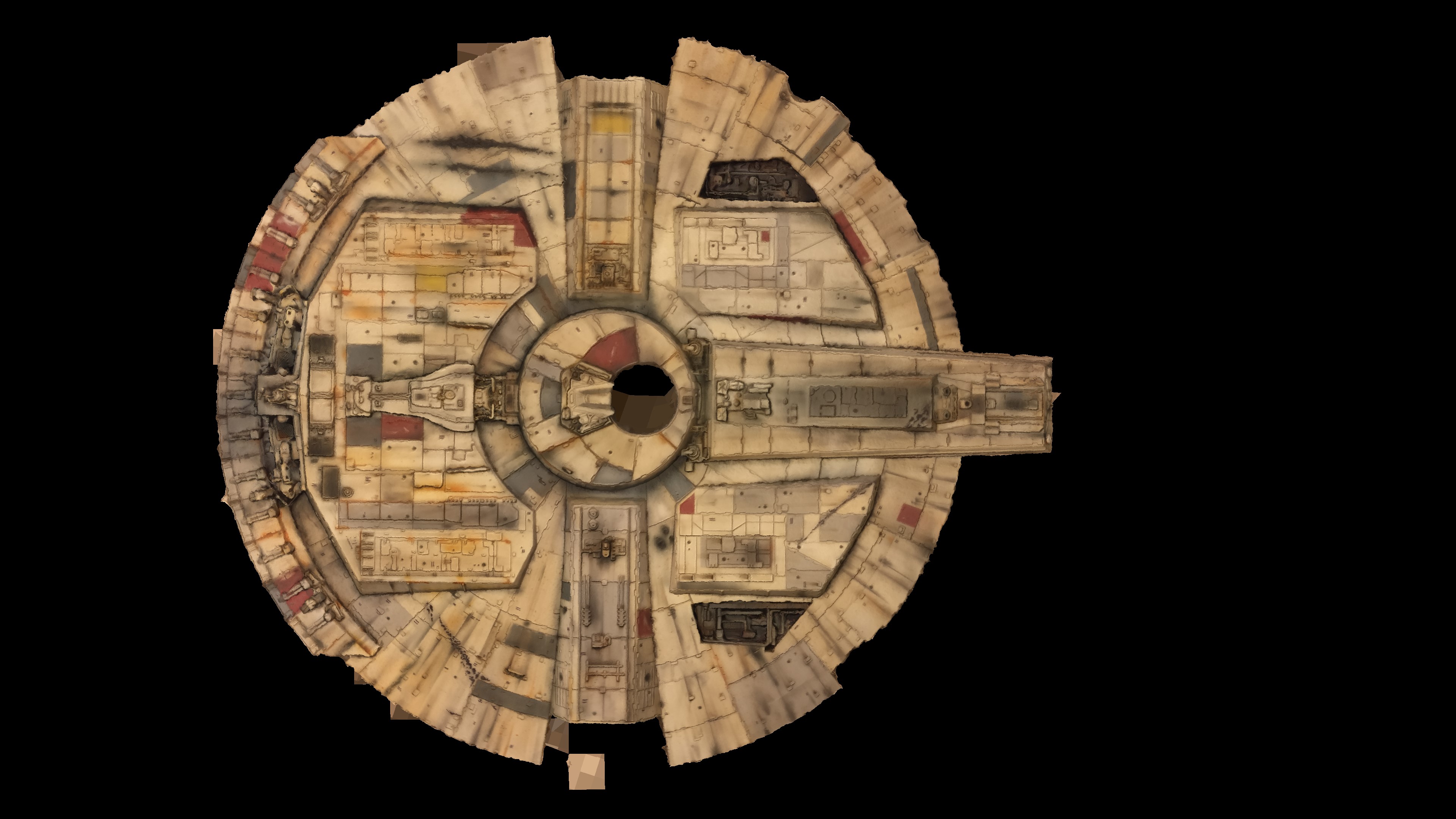

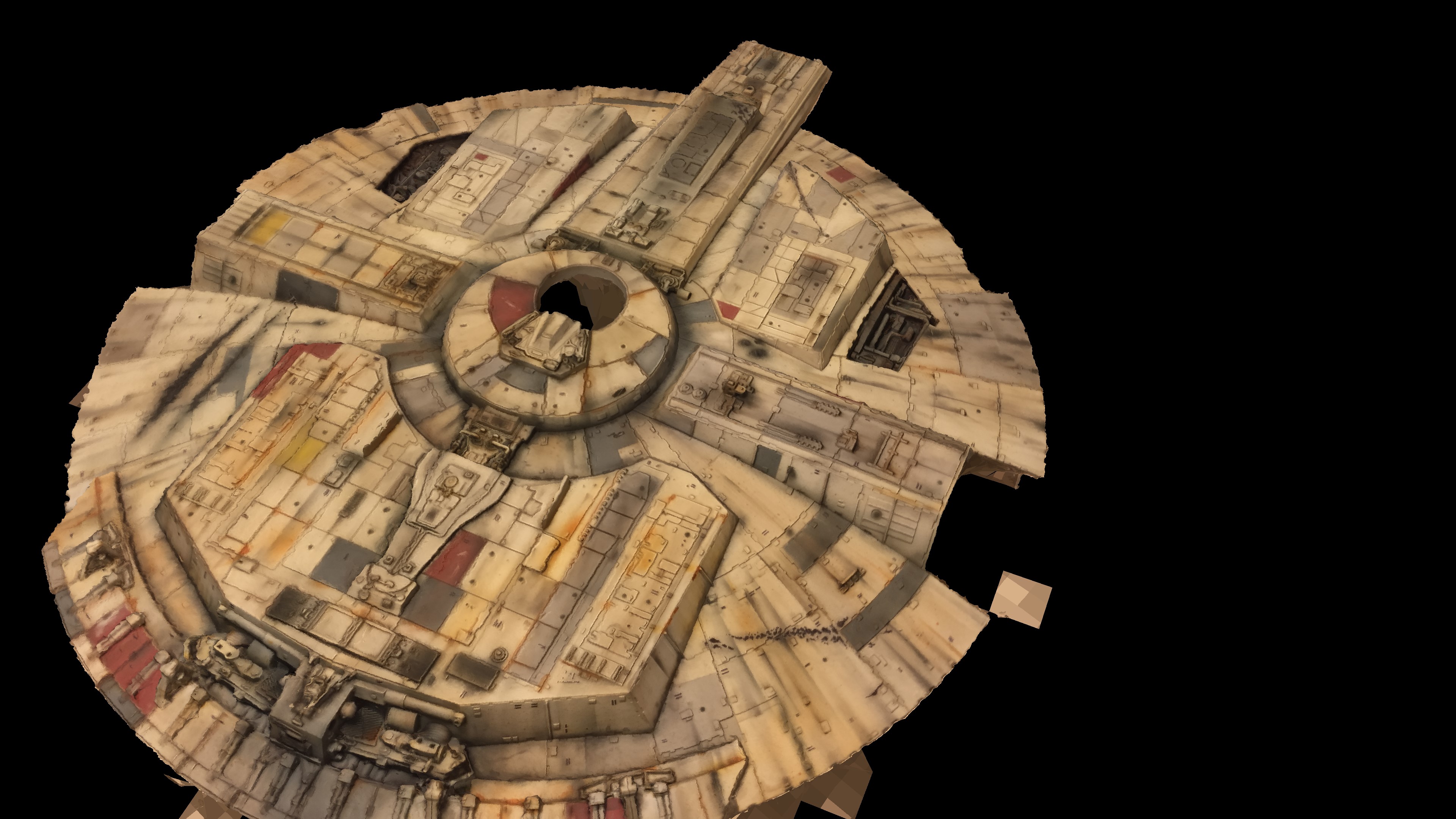

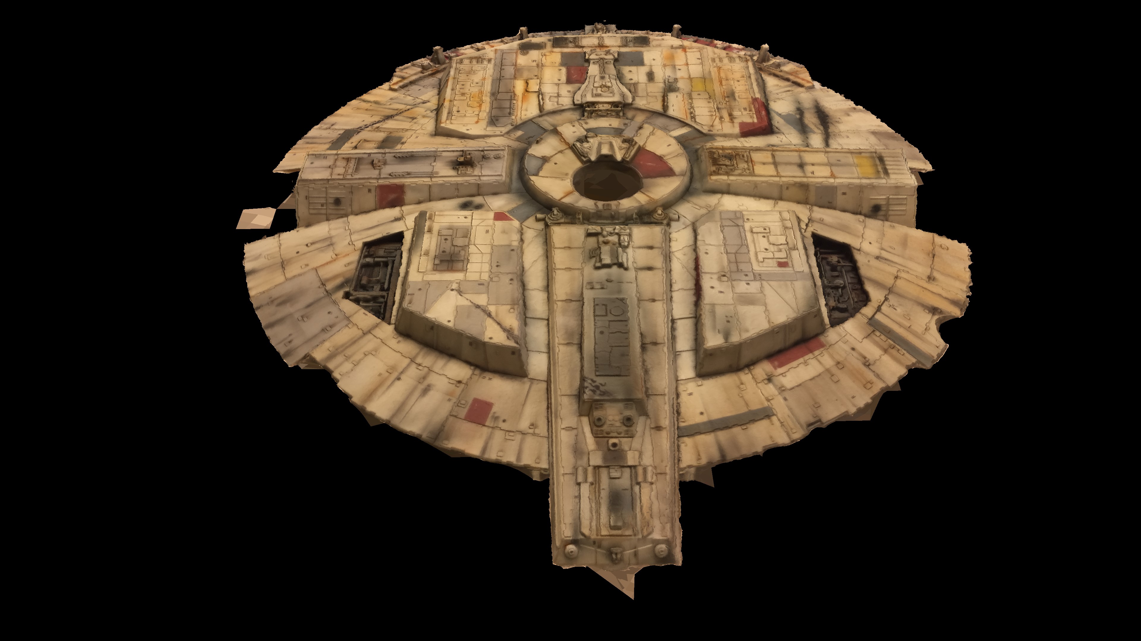

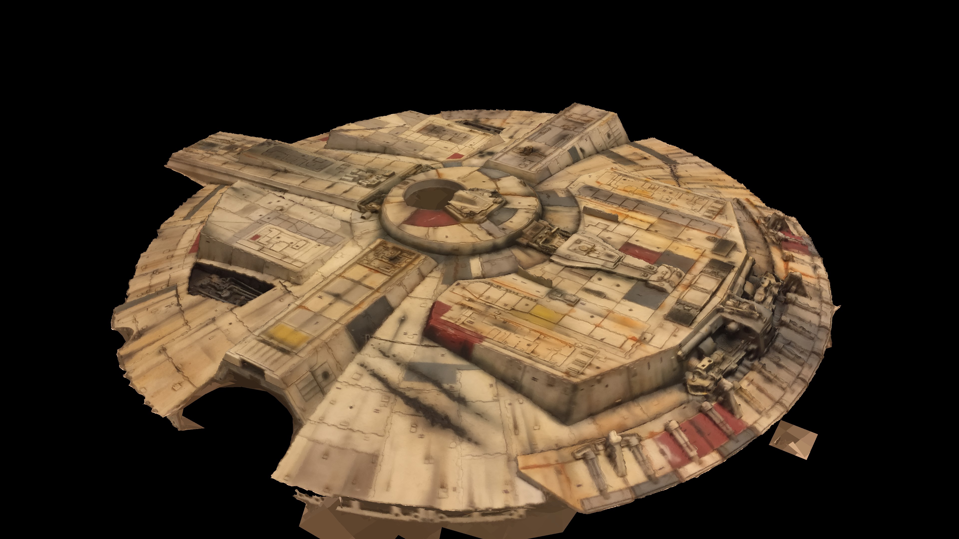

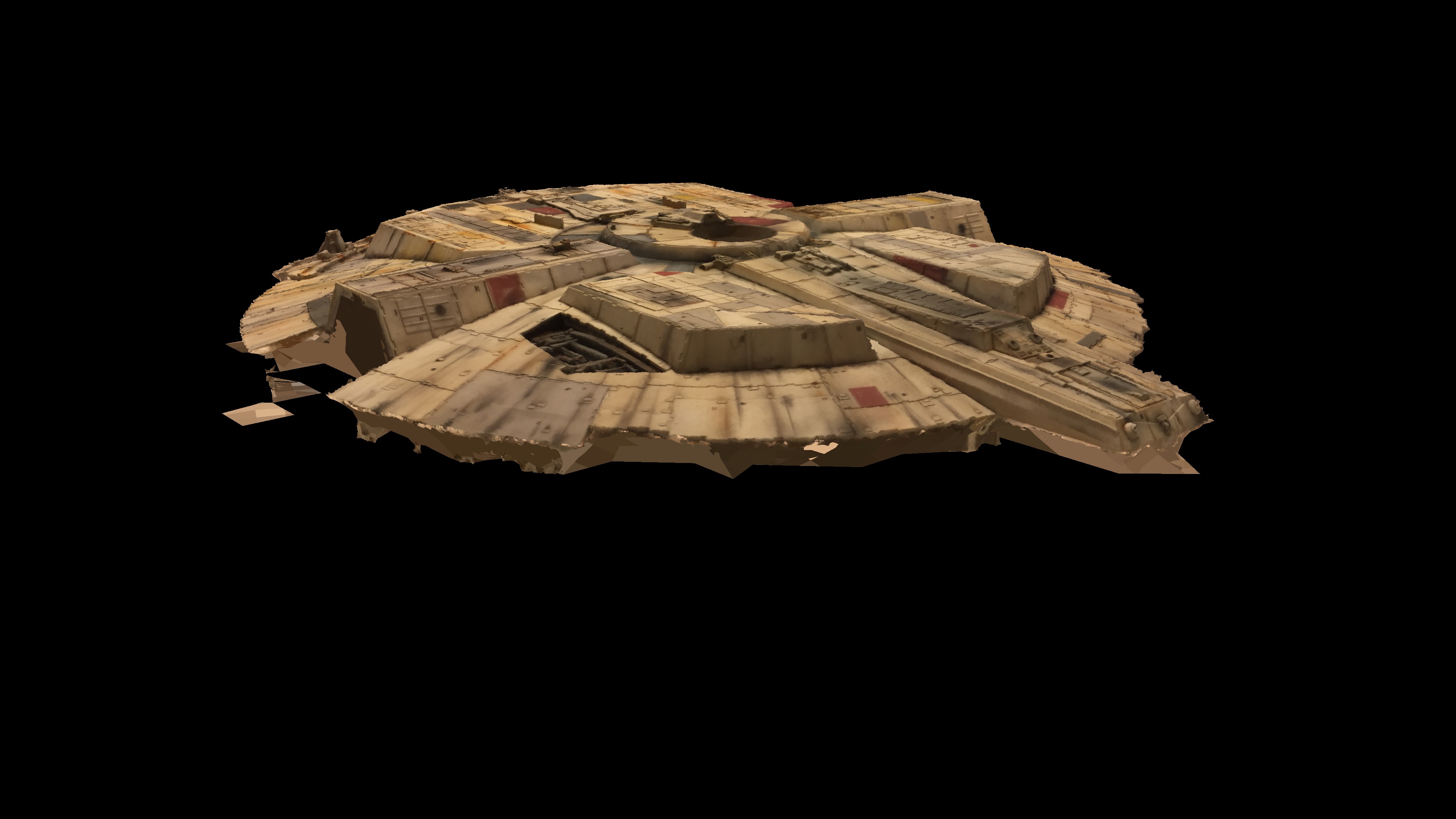

Using Photogrammetry software (realityCapture) I took a bunch of pics of my painted lower hull and created a textured 3d mesh, gonna use it to help me rebuild an accurate 3d version of the my final model!

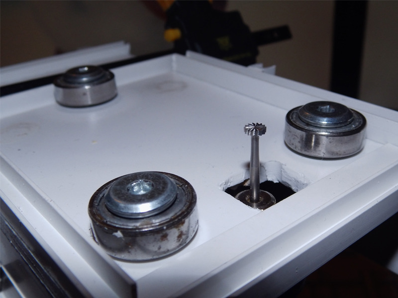

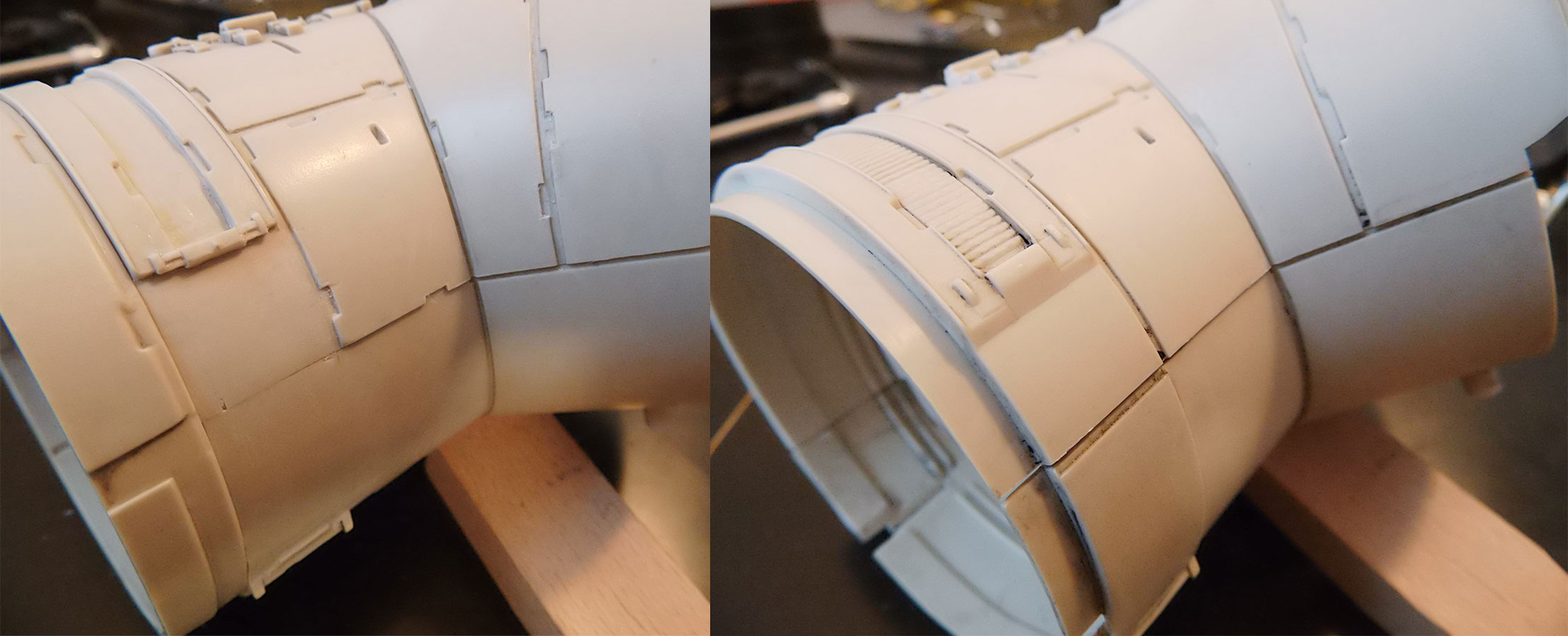

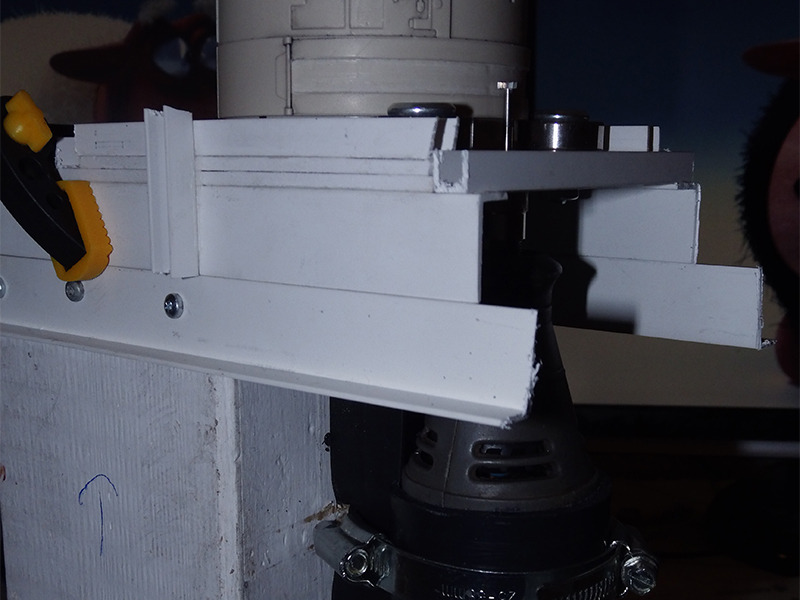

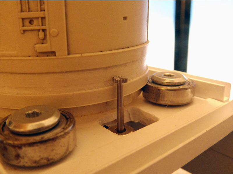

Check out on page 8 where I show this same correction, that was done only a small wood chisel and some 320 sand paper, this plastic is pretty easy to shape and sand.
That's a sweet table router set up you have going on there!
