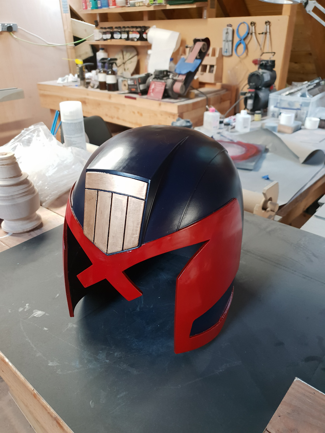

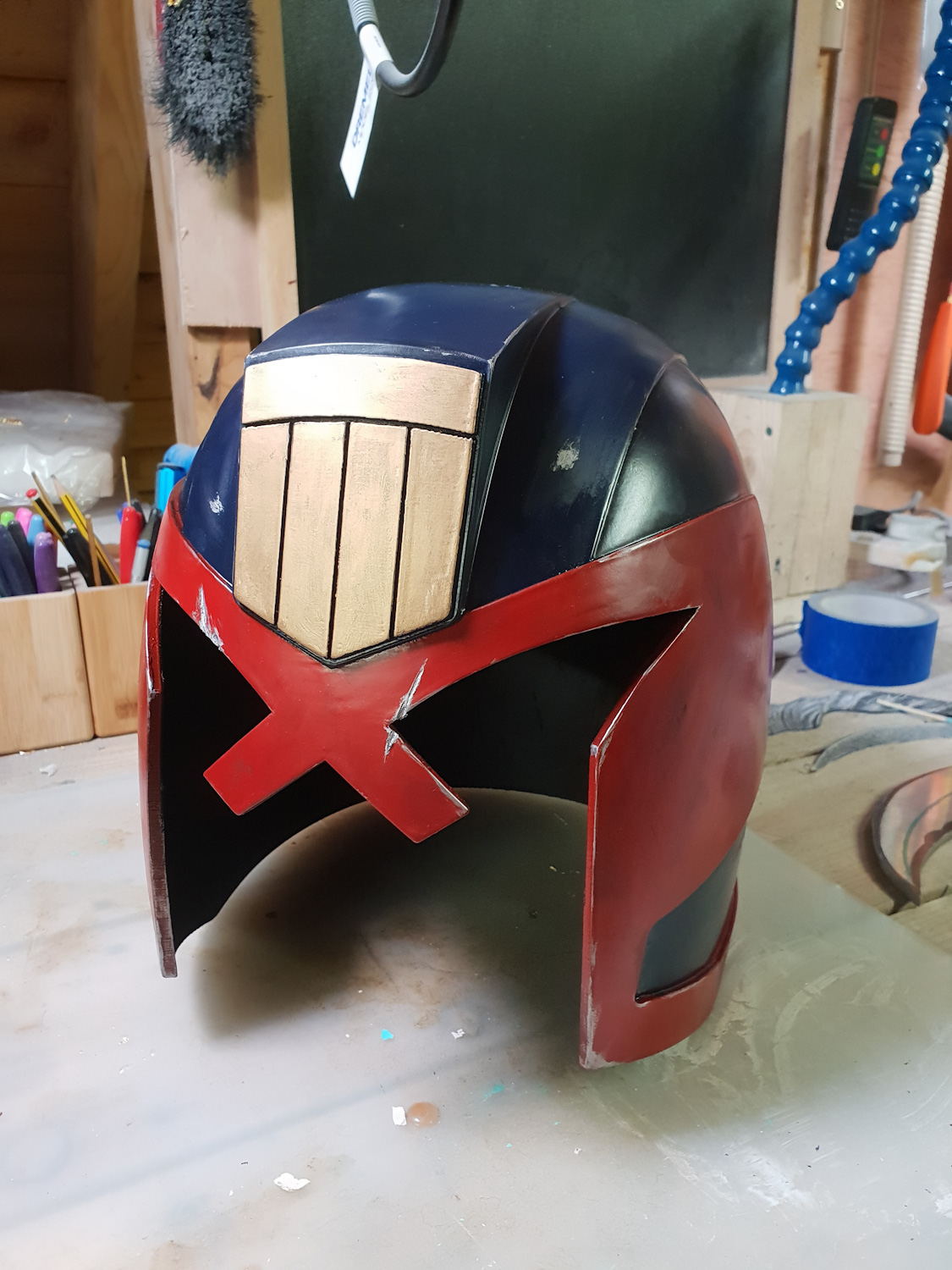

I'm doing a judge dredd helmet and i've used antique gold for the .....crest? whatever the gold bit :) anyway being terribly impatient after the red parts were dry and pulled off the masking tape and immediatly thought oh this will looks good with the gold on and applied it before i did a clear coat over the red - so question time can i put clear coat (this stuff...... 2 QTY Rust-Oleum Crystal Clear Matt Spray Paint Protective Top Coat - 400ml: Amazon.co.uk: DIY & Tools) over the rub n buff - i dont care to much if spoils the gold effect as i can reapply it, i just want to know if it will react or not stick or go wrong in some other unforeseen manner
on another note... for the visor i have some maybe 3mm acrylic which i'll dye black but i dont have a vacuum form machine (keep meaning to make one in fact i've got most of the bits already) so i was thinking about just heating it up and shove it in place and hoping it would mold itself to about the right shape - but it bring up a question - the helmet is 3d printed in pla will the acrylic be hot enough at a temp where it is moldable to melt/fuse with the pla? as that could be a disaster
ok got impatient and just went for it - figured if i had to sand it back and start again its would only be the gold bit and anyway it worked fine - amazingly it didn't even dull it down much - so i sealed it all and then i started on weather it - now since i decided to stick with the rub and buff i used the pewter to do the edges and scratches etc and then i got out and here where i made a mistake, oil paints, i normally prefer working with oil paint for its longer working time but the oil just lifted up the rub and buff - so i had to be careful where i applied it - did help one bit where i had gone over board with the rub n buff - anyway now i'll have to wait for the oil to dry before i go back with acrylics and finish the weathering

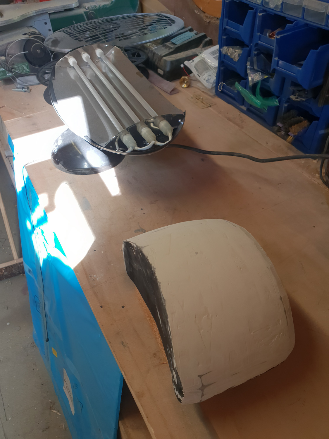

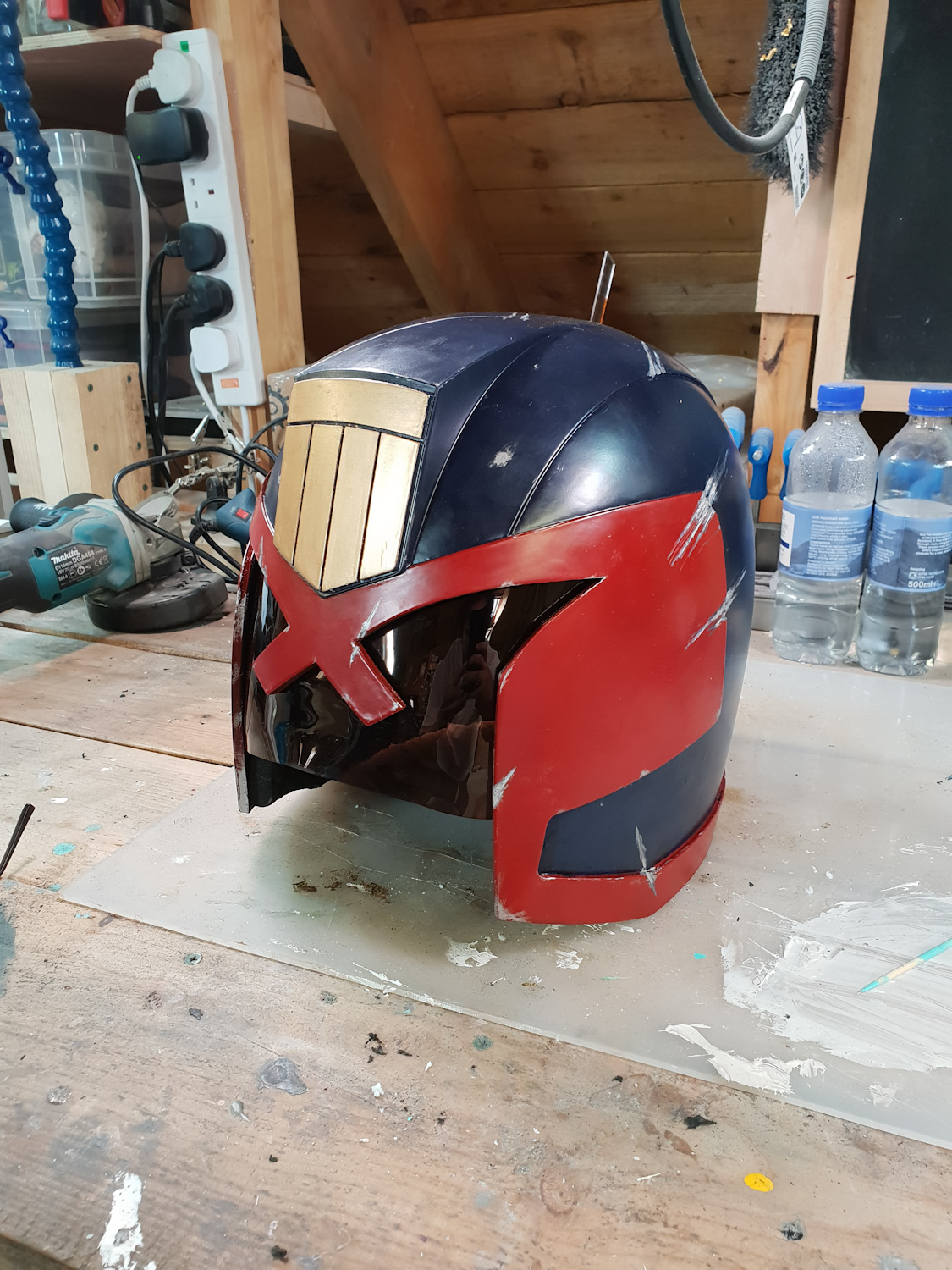

:) would need a vac forming machine for that..... i kinda hoped to make one but running out of space in my workshop so haven't got around to it yet - i was just trying to heat the plastic and draping it over the printed shape (didn't go very well as i suspected it started to melt and stick:() going to try putting some bondo over the visor shape - might have to find a better way to heat the plastic too as i think i was holding it to close to the heating elements as it started to bubble but was barely soft enough to pull it over the shape - in the end i might end up with a vac former yet :)
decided to make this a thread about my dreadd helmet build - so here what i've been upto - i bondo's the mold shape for the visor and that worked to stop it melting and the acrylic from melting - sadly since i was just holding the plastic over the heater by hand even with leather gloves there was a limit to how long i could hold it and it maintaining enough regidity to hold by hand so it wasn't quite soft enough so i call the visor only partially successful - it should look fine but the contact area on the hidden bits is less than i would like to get a good join - so i'm going to use hot glue to stick it on hopefully that will provide the contact area

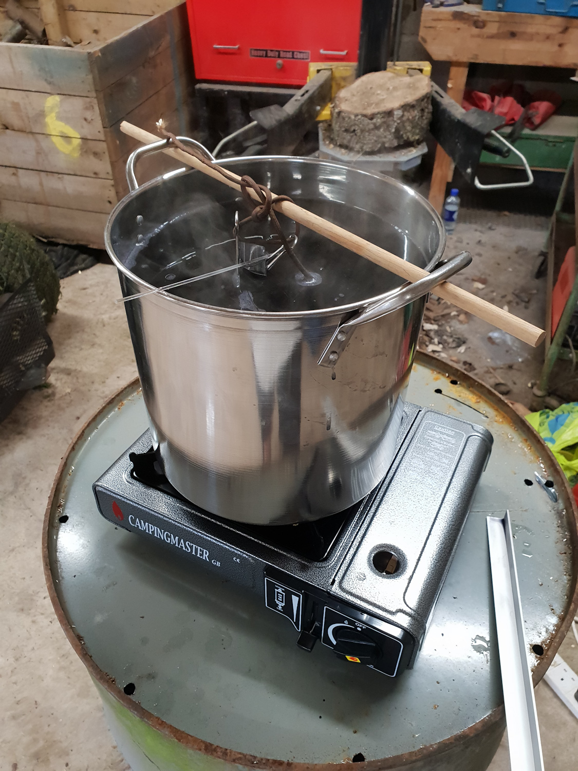

so anyway i've put the visor into the pot with the dye and its cooking as i type (fingers crossed) - was going to do this in the house but my pot doesn't work on induction hob :/ so using a camping stove barely able to get the water hot enough but think its close enough

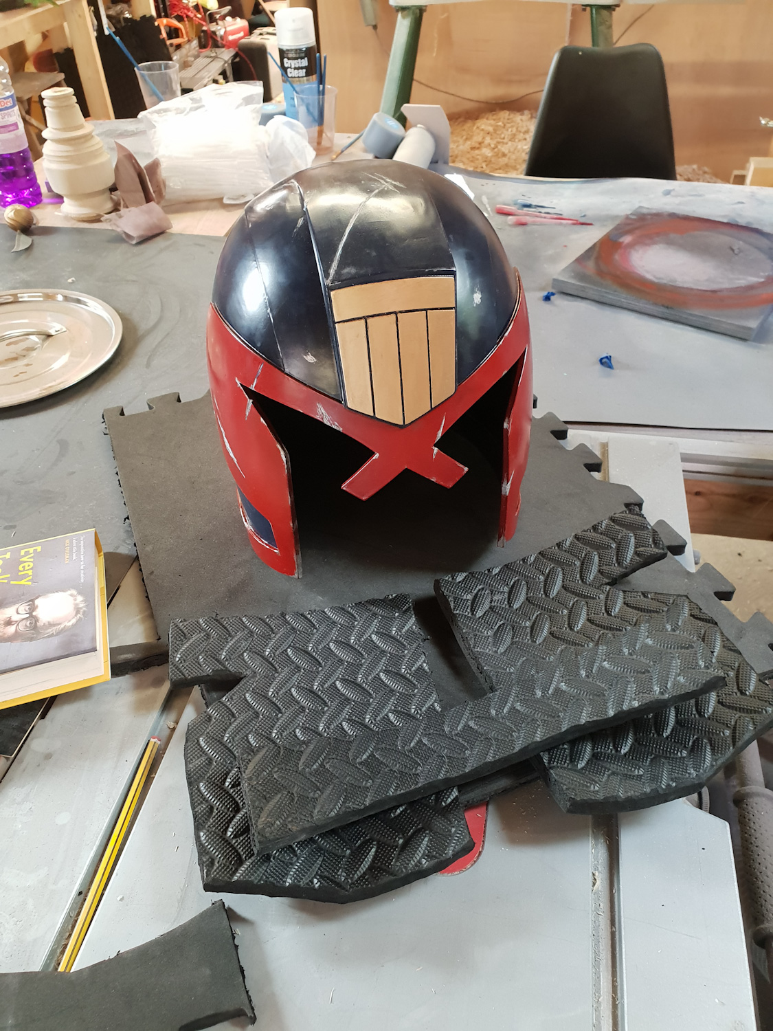

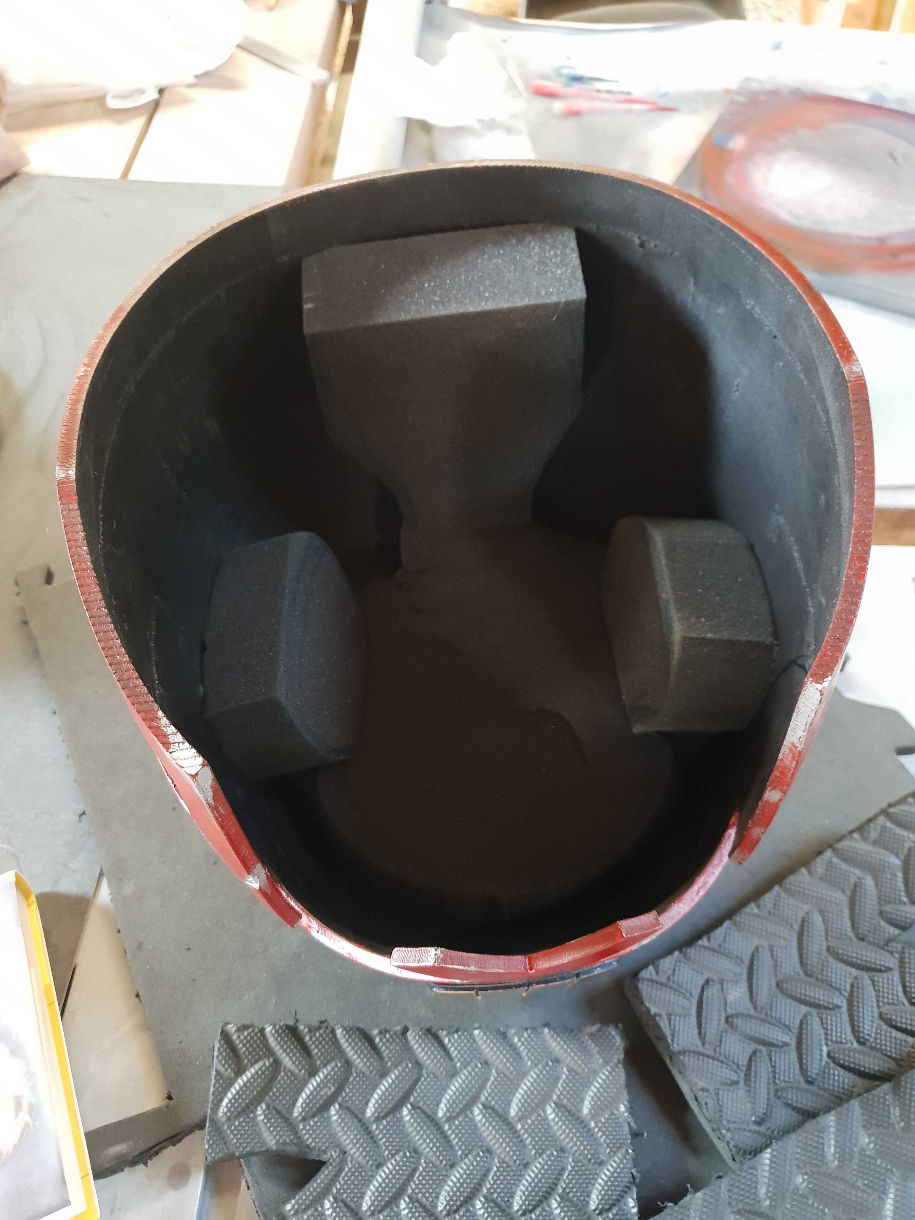

also been doing some quick foam inserts to make it booth look like the one on screen and be more comfrotable and fit correctly (not that i really intend to wear it much)

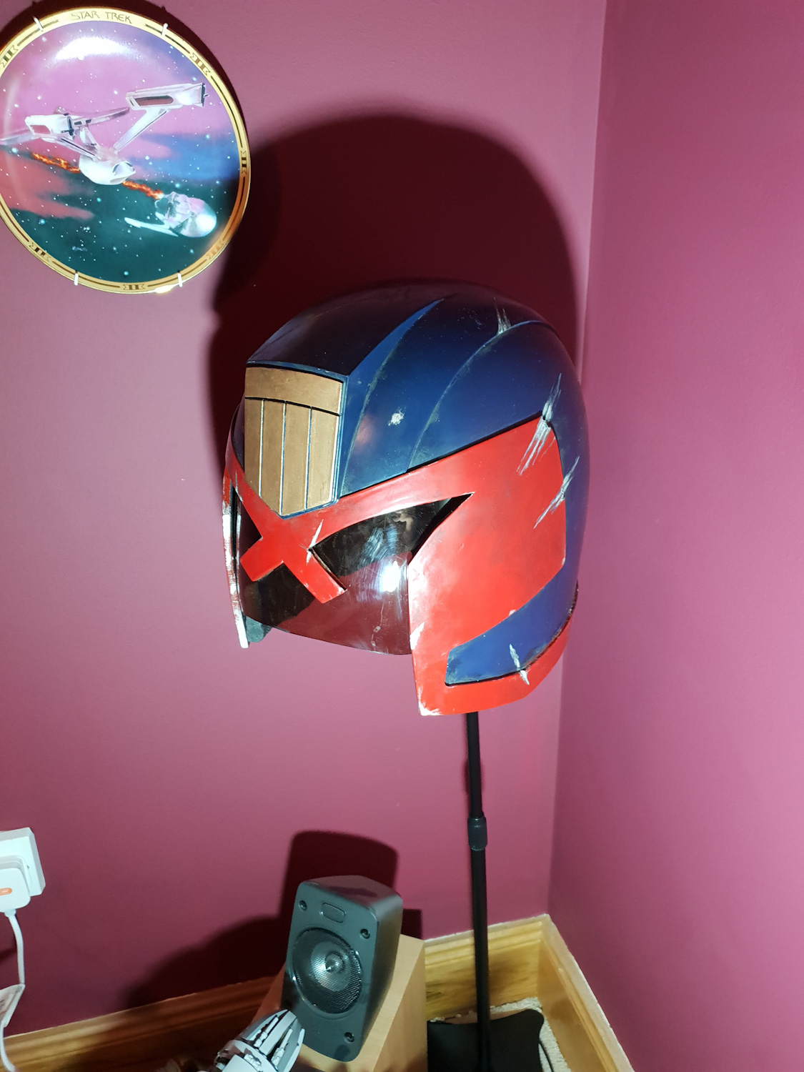

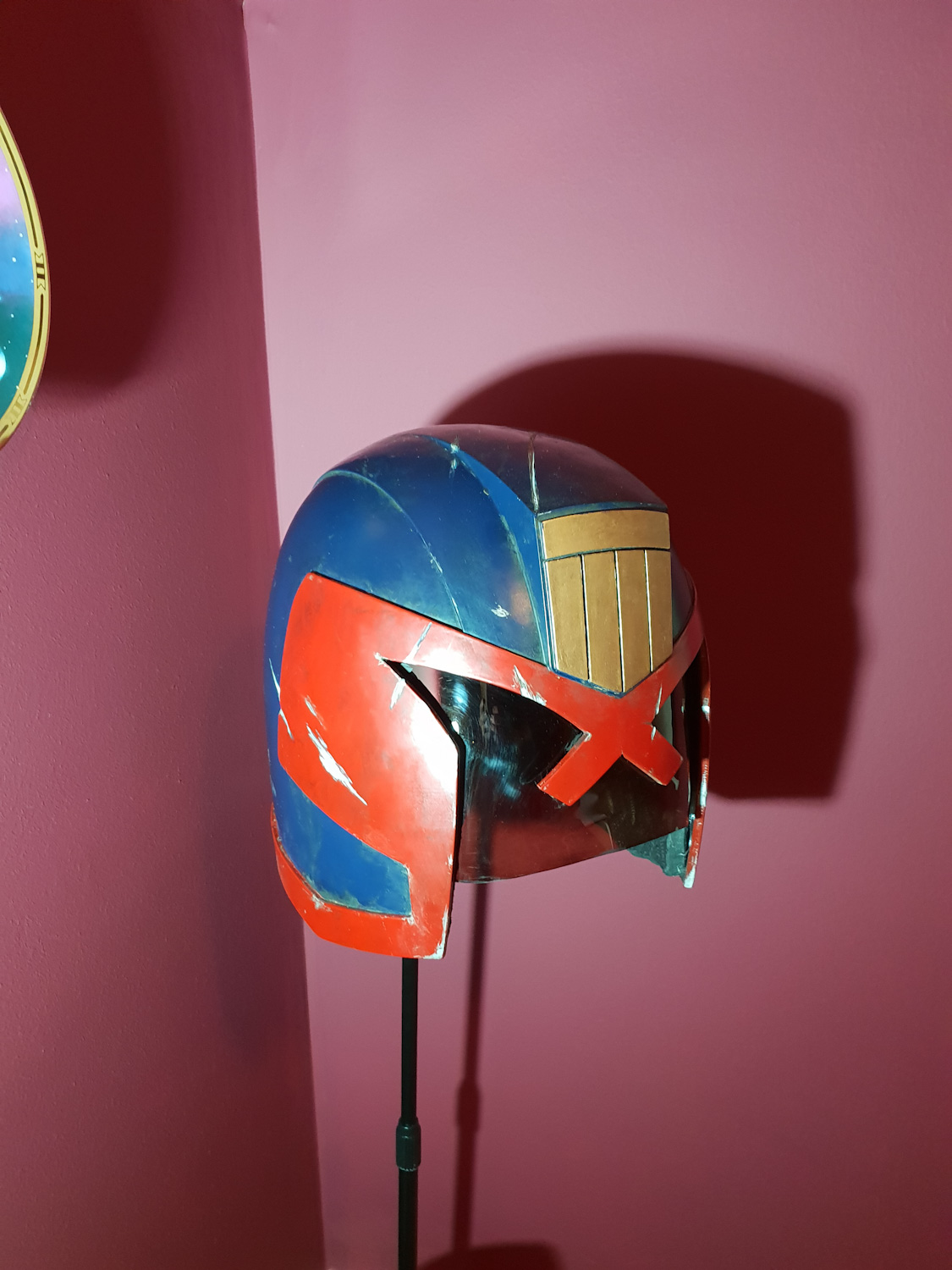

i checked the acrylic was actually 2mm - looked thicker to my eye so i even checked it with calipers and 2.1mm and its more than thick enough - but as kruleworld linked vid it might have been easier to use petg - to late for me but might be worth looking at for your one - but regardless i'm happy with mine (which is now finished - will post photos when i get it mounted for display in my home cinema)

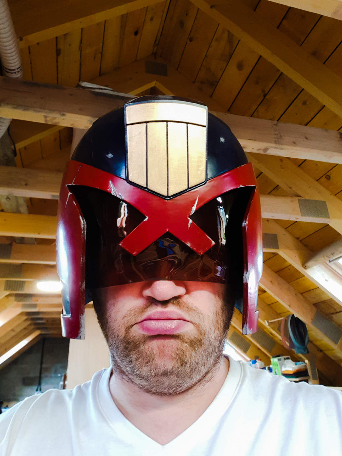

ok here the it finished - lighting in my home cinema isn't great but i'm pretty happy with the end result
