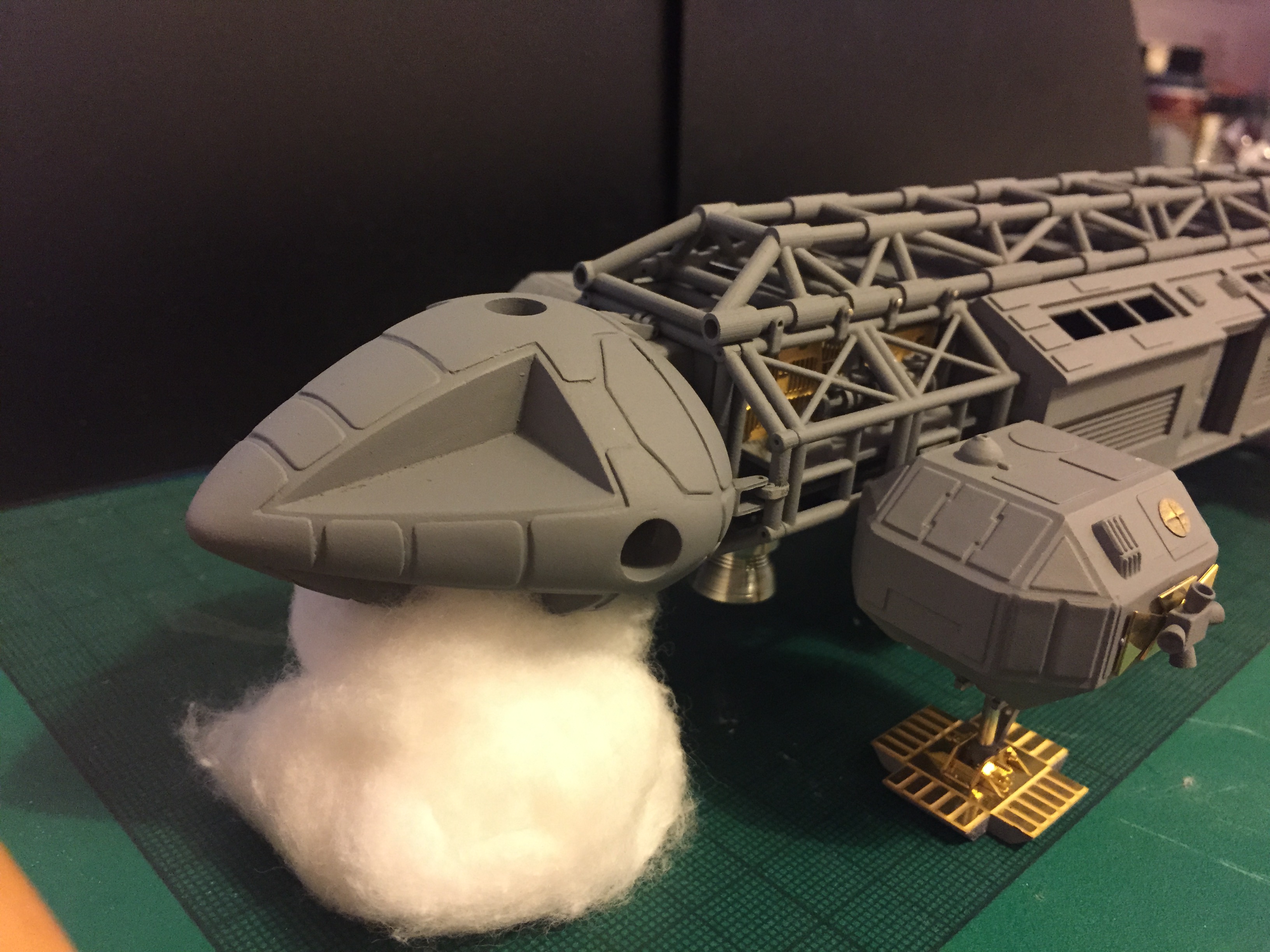

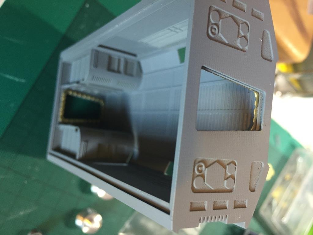

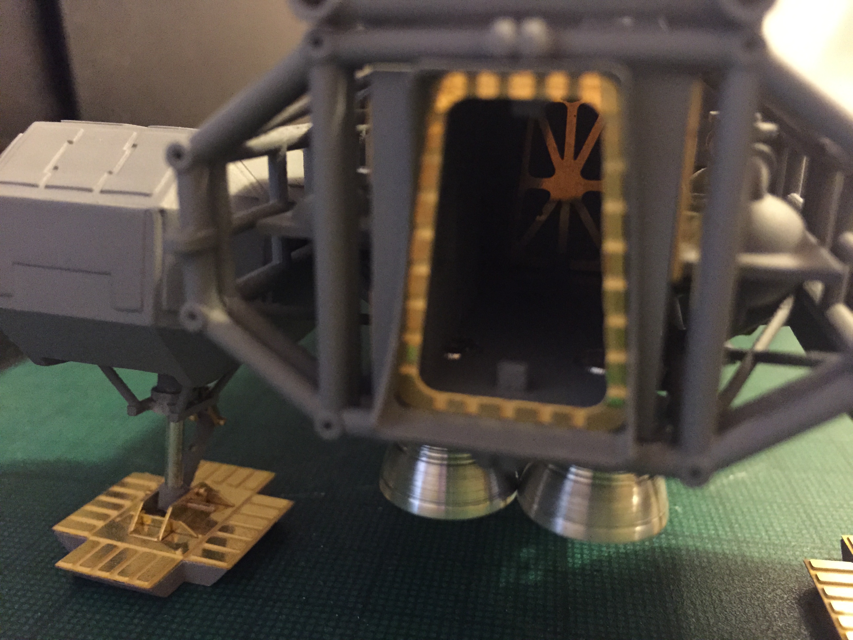

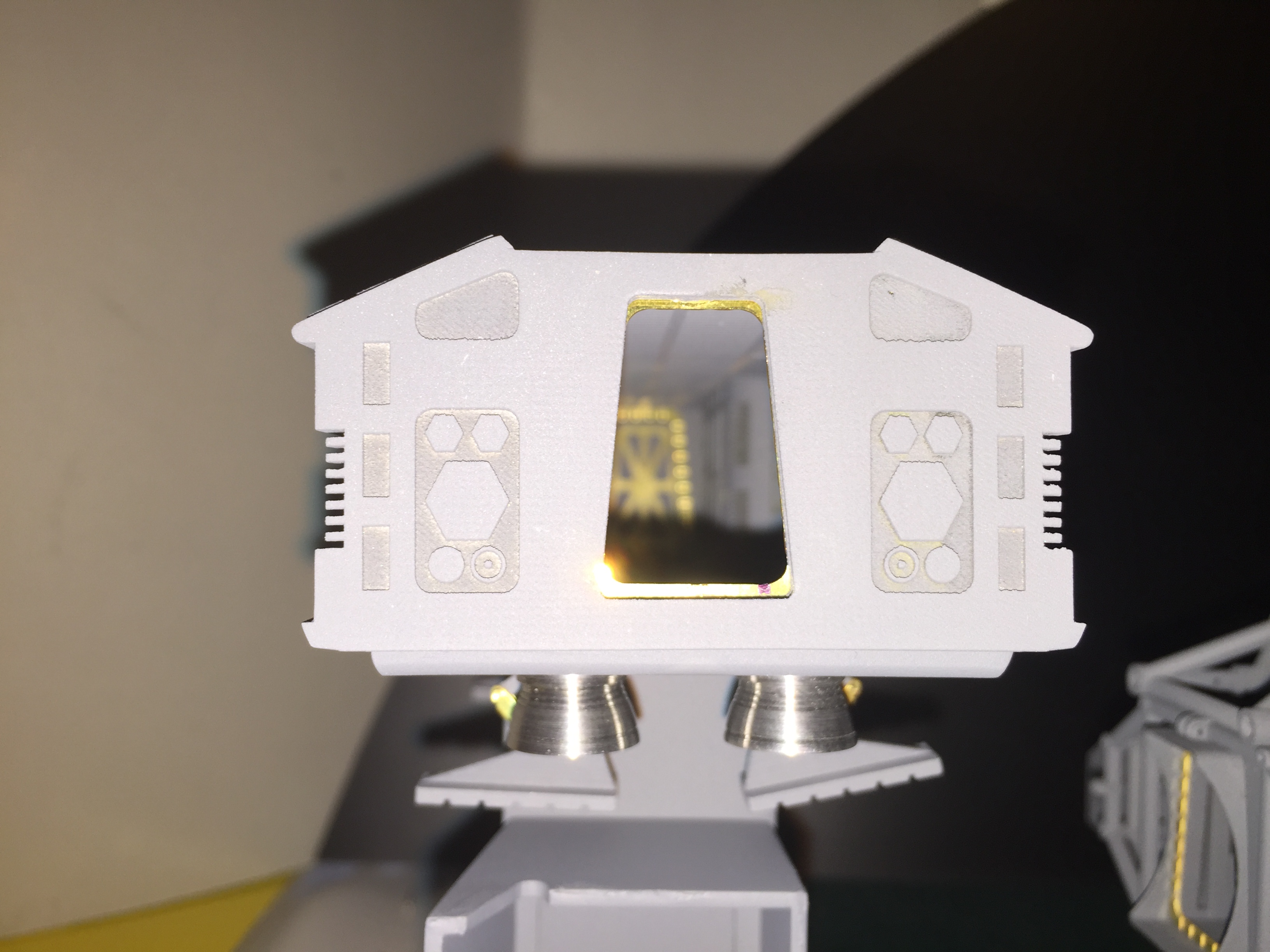

Some of you might recall a project I started a while back and posted to the “Space 1999 Eagle Transporter Build Club” thread, that was based around customizing the AMT/MPC/Airfix Eagle with a mix of scratch-built and custom designed parts in resin and brass. For various reasons, I had to park that effort a little under a year ago, but since re-starting a short while back it has taken a significant turn in development involving the replacement of many components with custom designed 3D printed parts. The main reason for this was the use of resin command modules which altered the proportions of the model to such an extent that most of the other parts needed to be resized. This meant that many of the previous parts were no longer viable so in a slight reversal of the original principles behind 3D printing, I used these parts to experiment on and scratch build raw prototypes which I then re-mastered through CAD and 3D printed. The end result of this is that there’s not much of the AMT kit remaining, just the main parts of the landing pods and the underside of the passenger pod, both heavily modified. The rest of the parts are a mixture of custom designed etch, supplemented by resin command modules and turned aluminium engine bells, thrusters and sensor dishes. The builds are finally complete in every sense but the final paint and decal job.

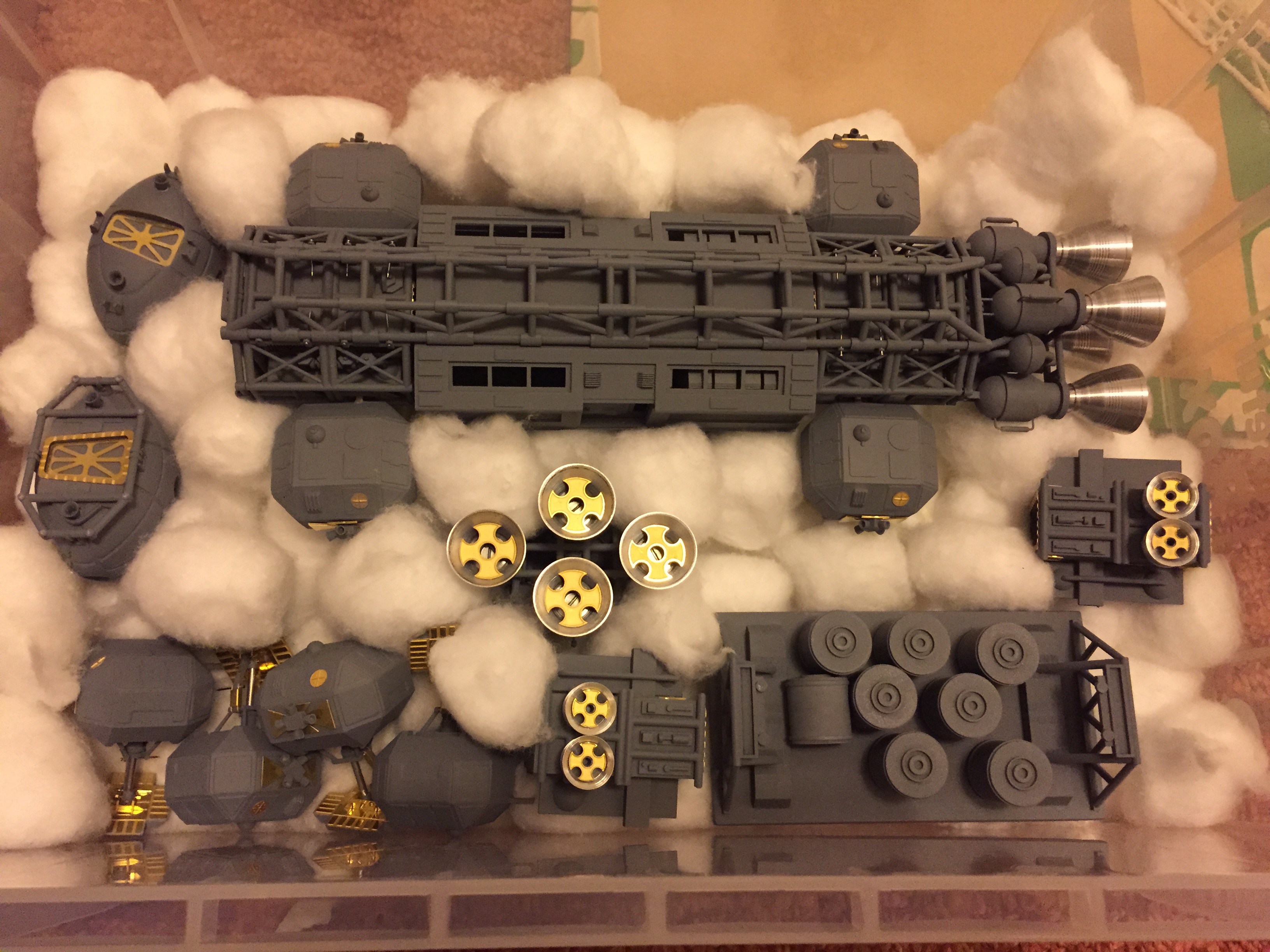

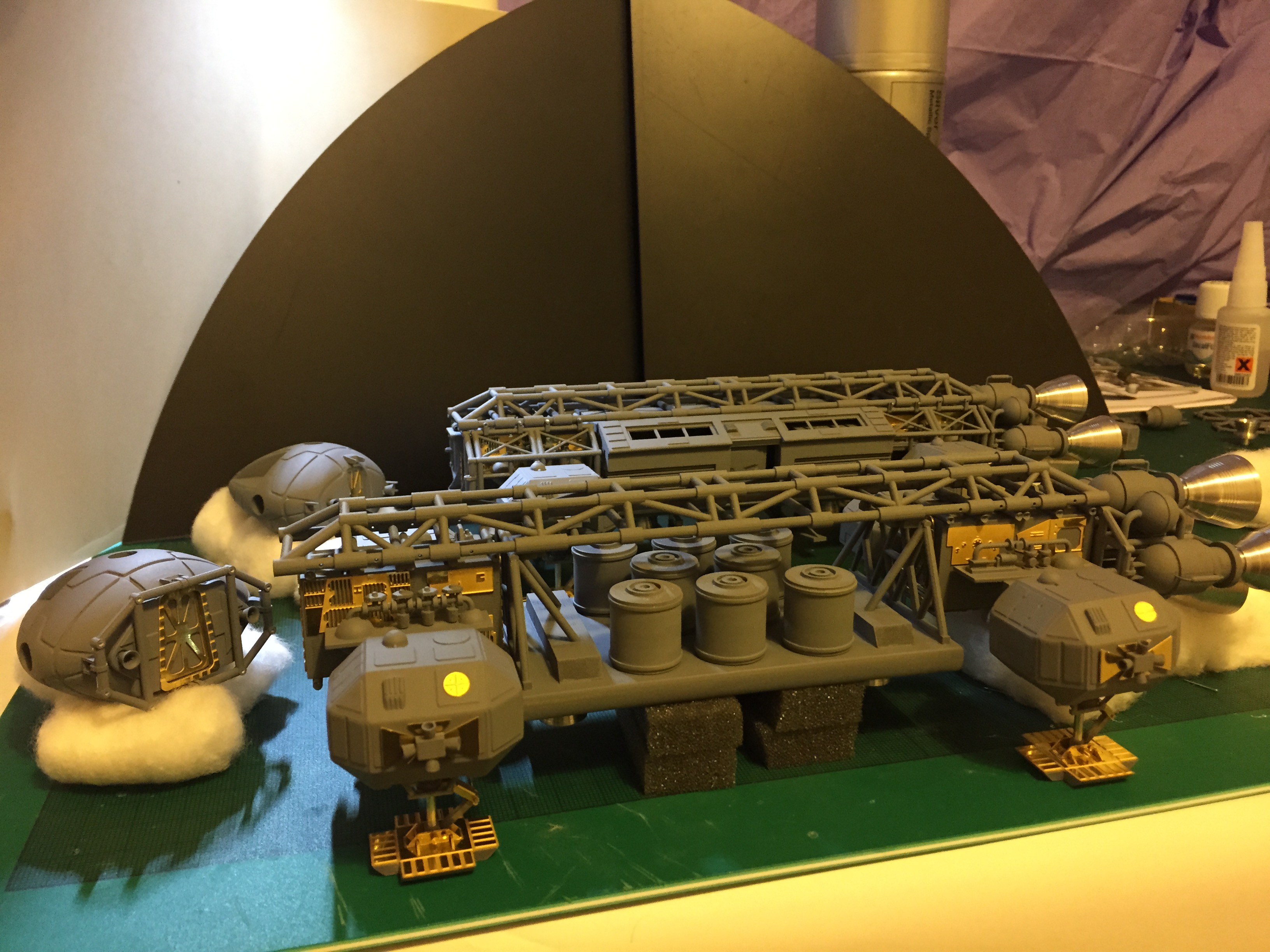

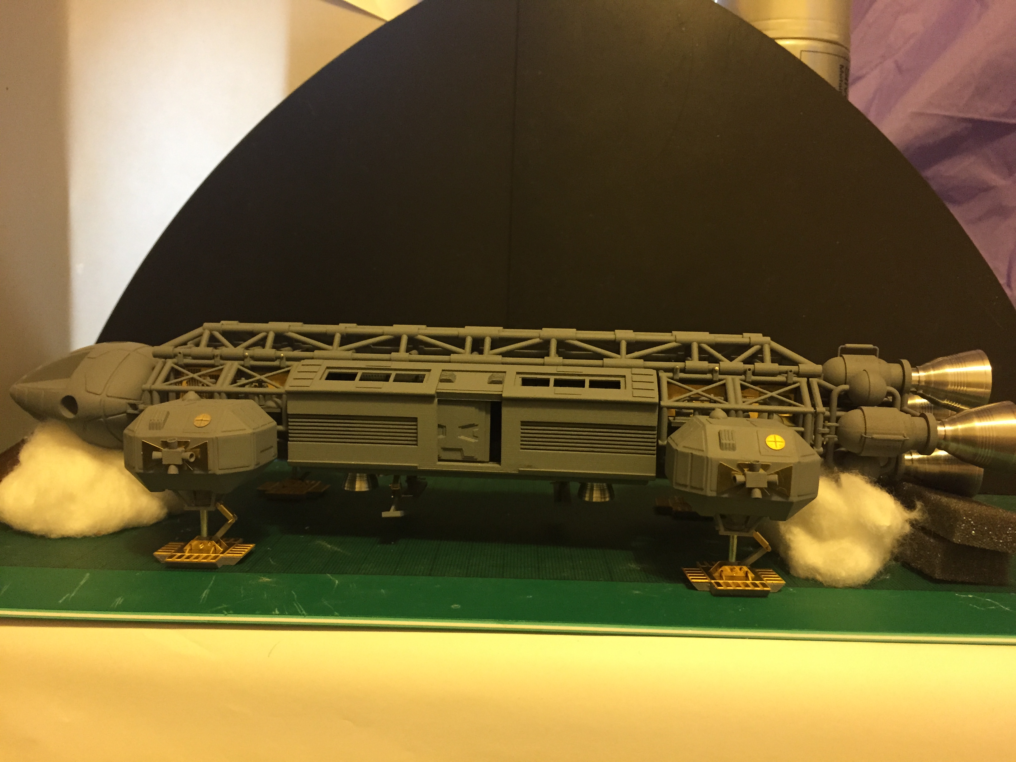

I have provided a “Primed” view of the two builds – first coat primed, with the custom etch (and aluminium parts) showing in all their glory. The Eagle Transporter is shown with the cages in place while the Nuclear Waste Carrier is shown without in order to better reveal the walkway detail. It’s almost sad that these parts will be covered up in the final paint job. Apologies for the wonkiness of some of the parts – this is a dry build so many are (precariously) held together with blu-tack – and some of the photos. The dry builds are meant to provide an impression of the overall builds.

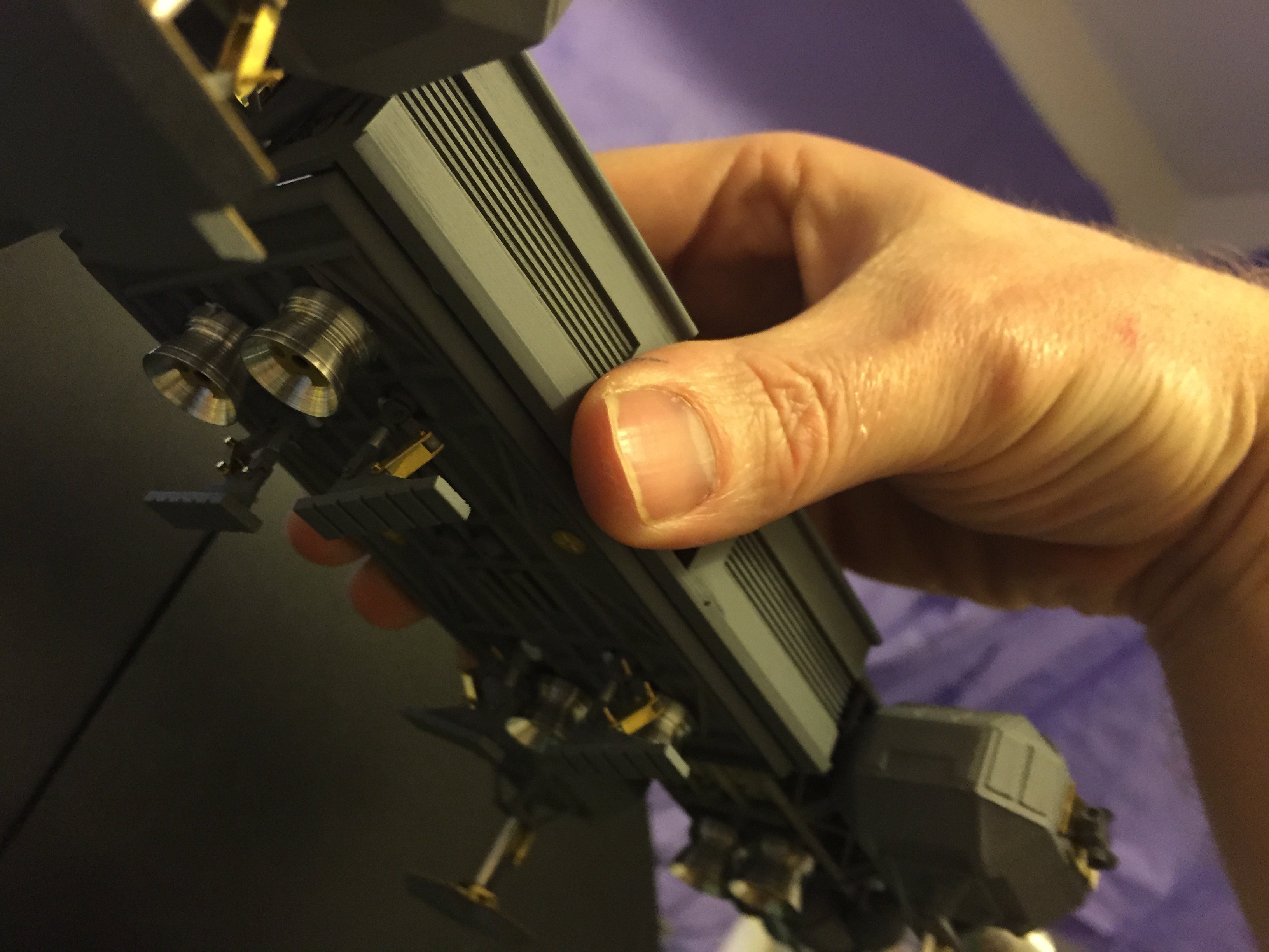

The highlights are as follows: The landing gear, both main and on the pods, is fully working (the gear for the NWC pod is not shown). The pods connect to the spine through tiny but powerful neodymium magnets. Although had to see from the pictures, due to the lighting and the grey primer, the forward walkway, passenger pod and aft engine compartment are fully detailed. These will be picked out better during the final paint job. The exterior of the walkways are detailed in custom etch. The engine and thrusters are supplemented with three sizes of custom baffles. The main doors to the passenger pod slide aside and the doors to the walkways are all removable. Although steel pins have been used for the dry builds in some areas, all connecting components – brackets, hinges, spine, including the command module and engine assembly, will all be connected using tiny brass hex bolts, to support both movement and disassembly. Some of these can already be seen in place. These will be removed and returned post-paint and then trimmed to the right length.
