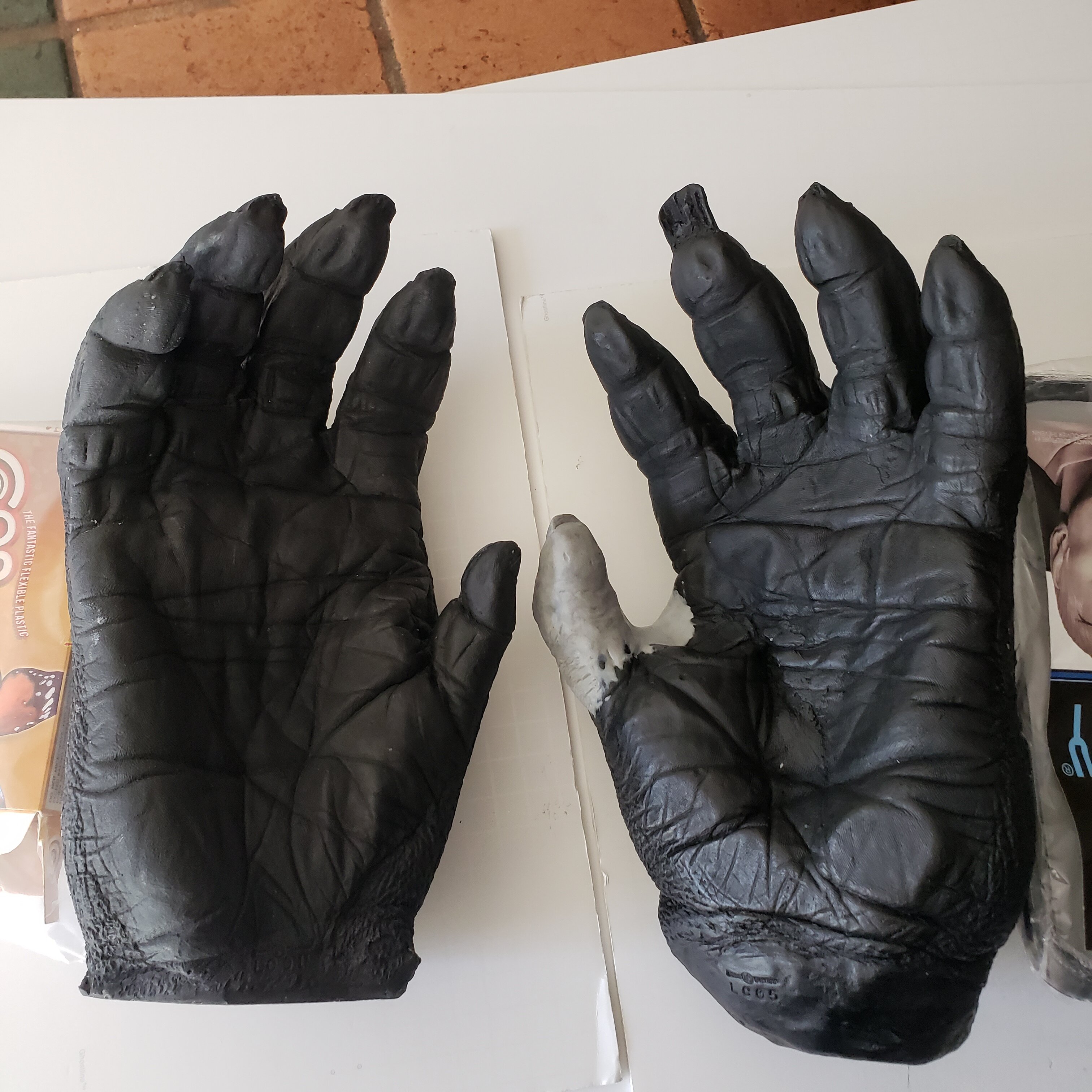

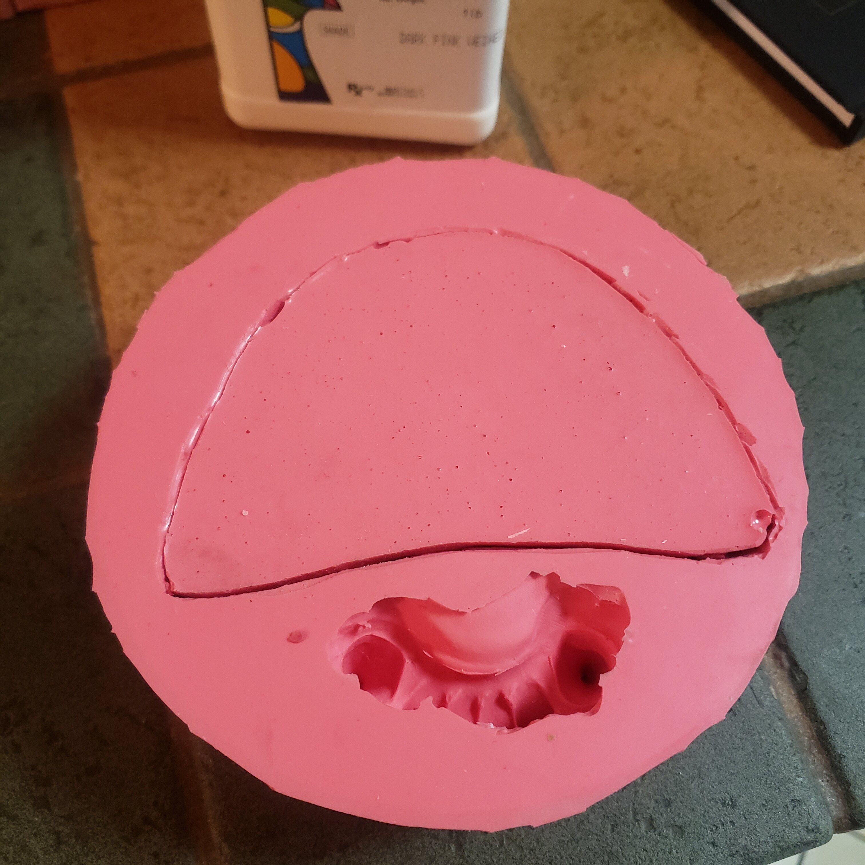

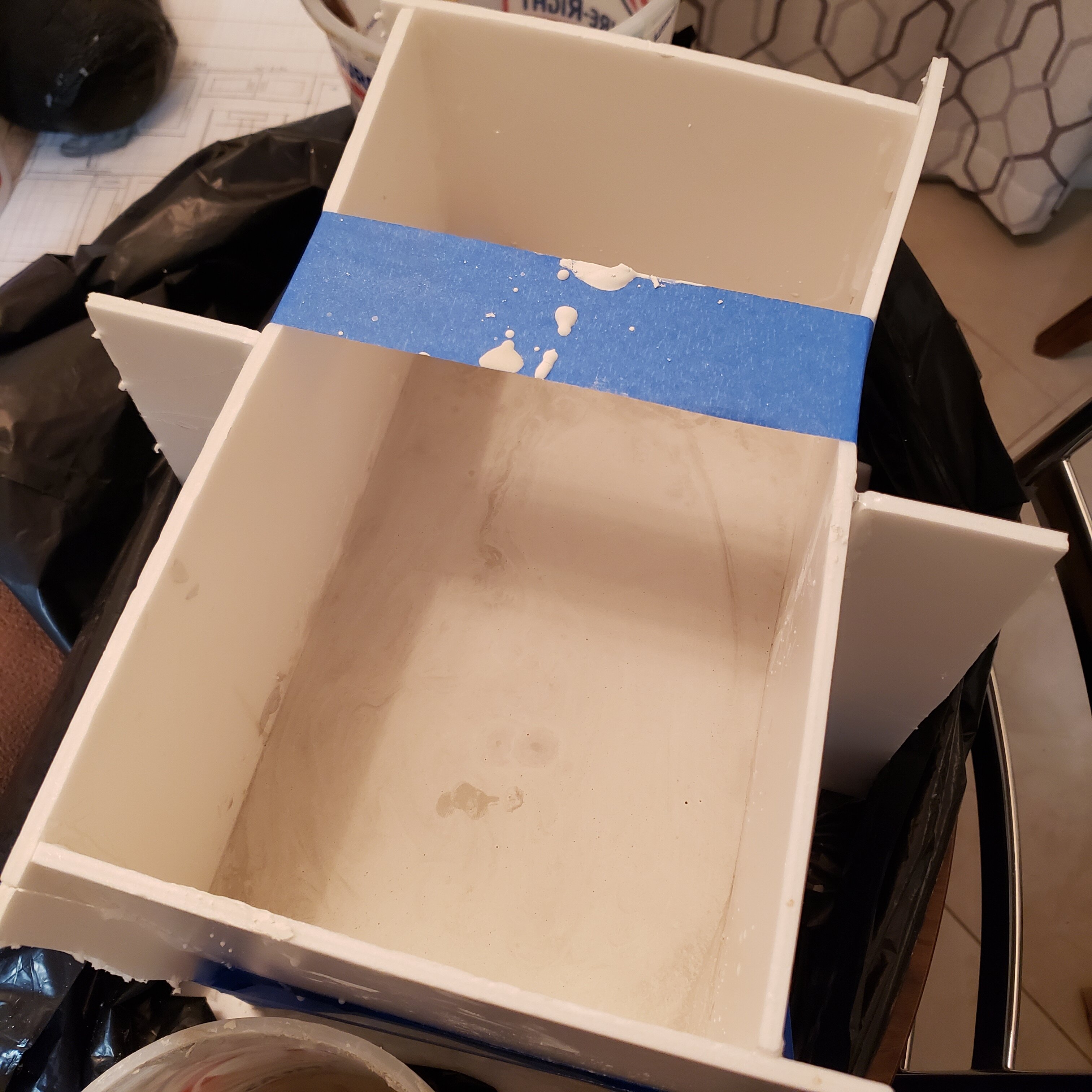

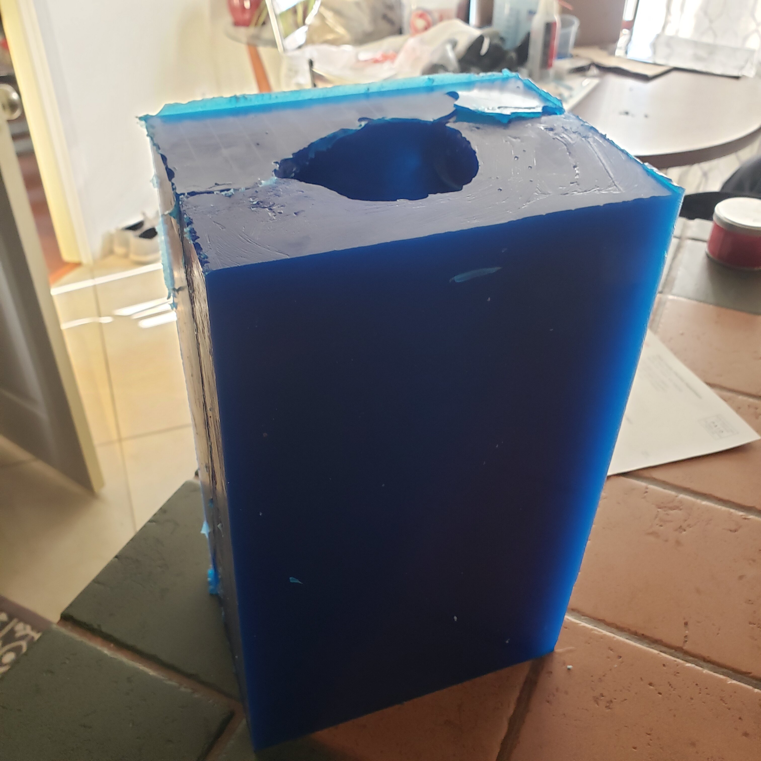

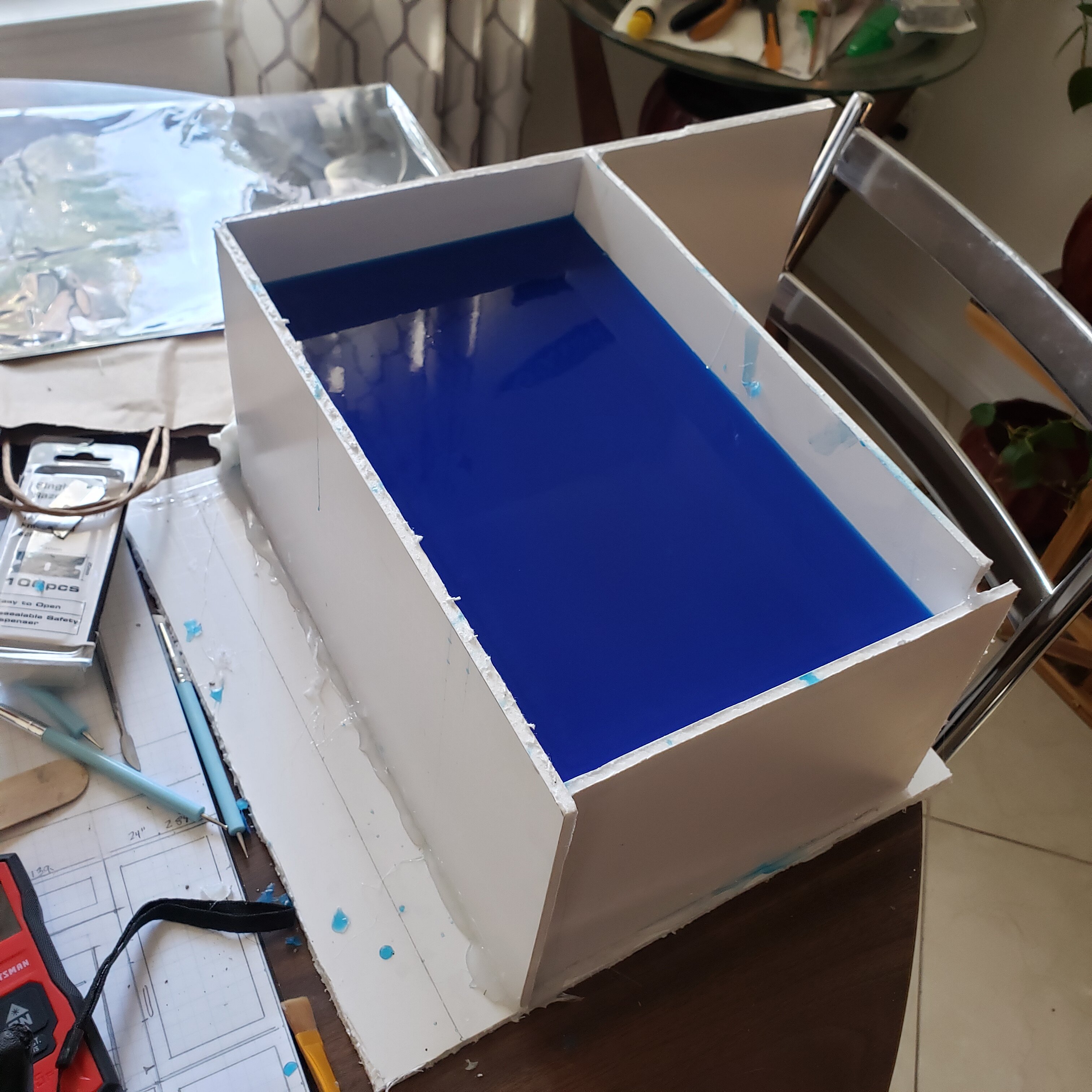

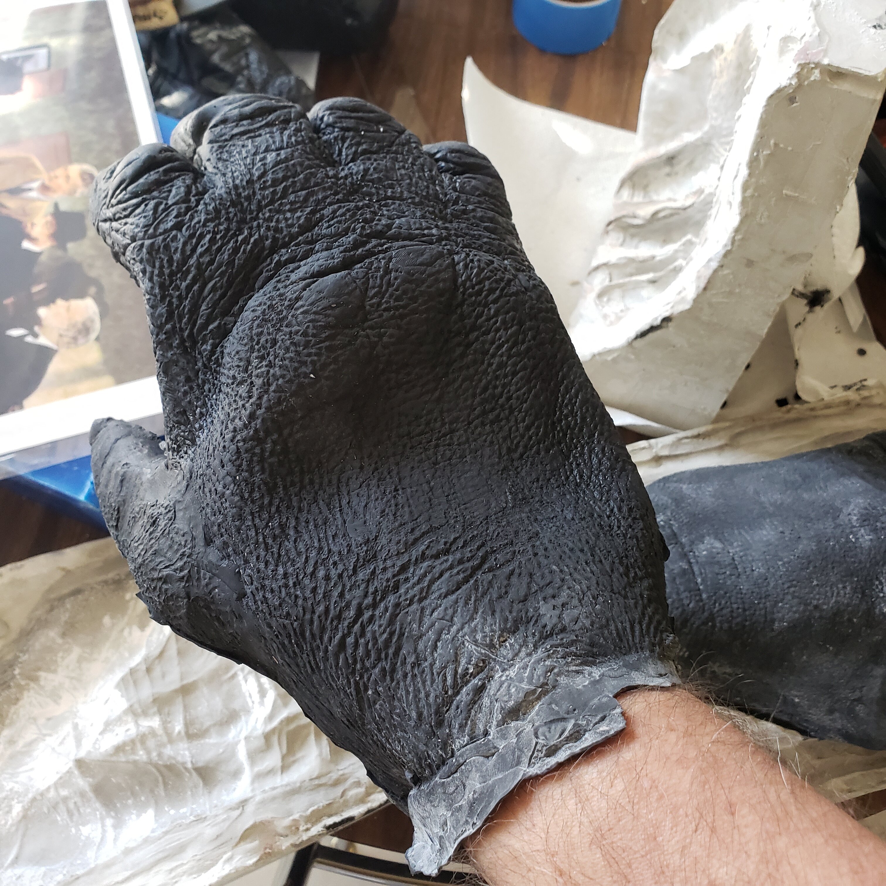

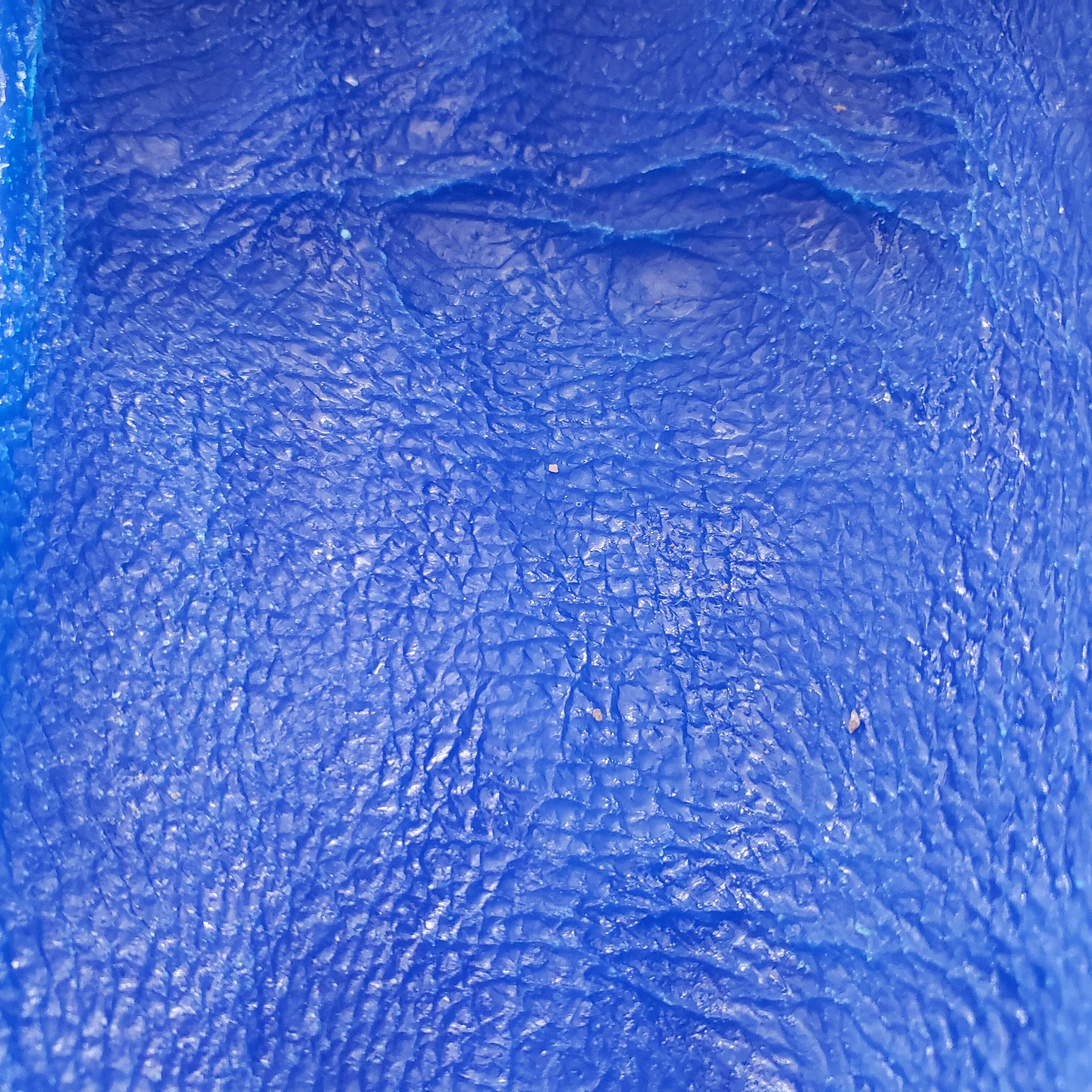

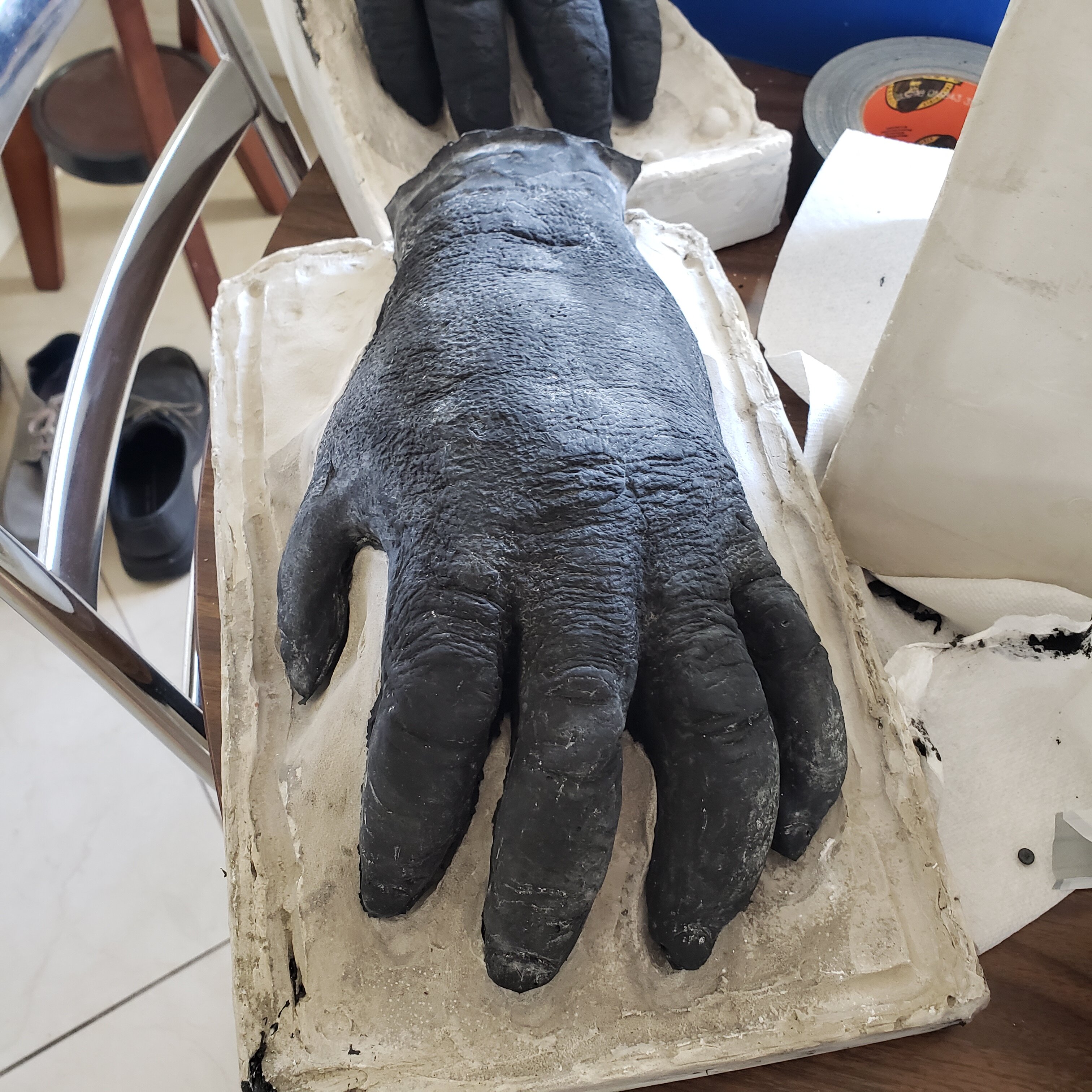

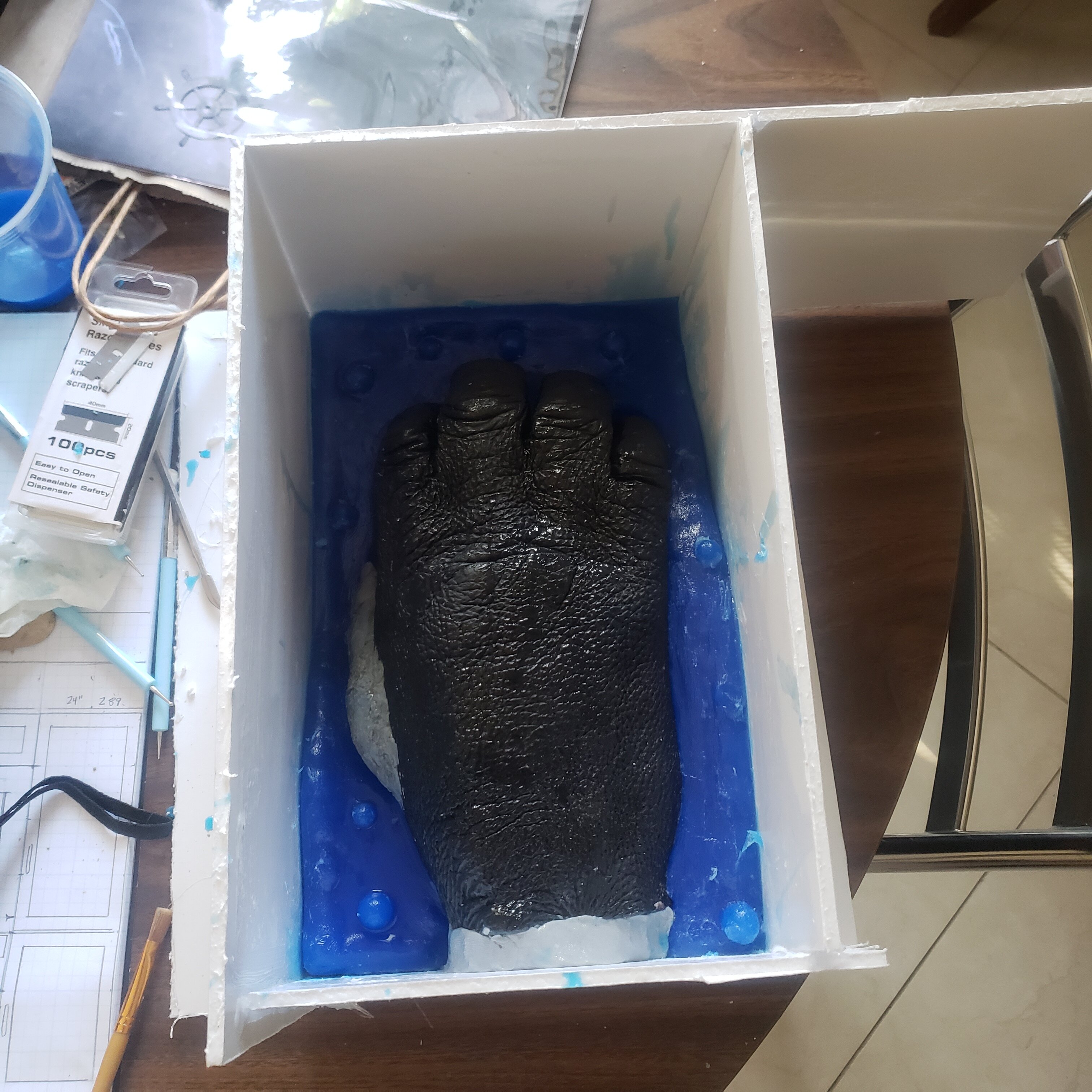

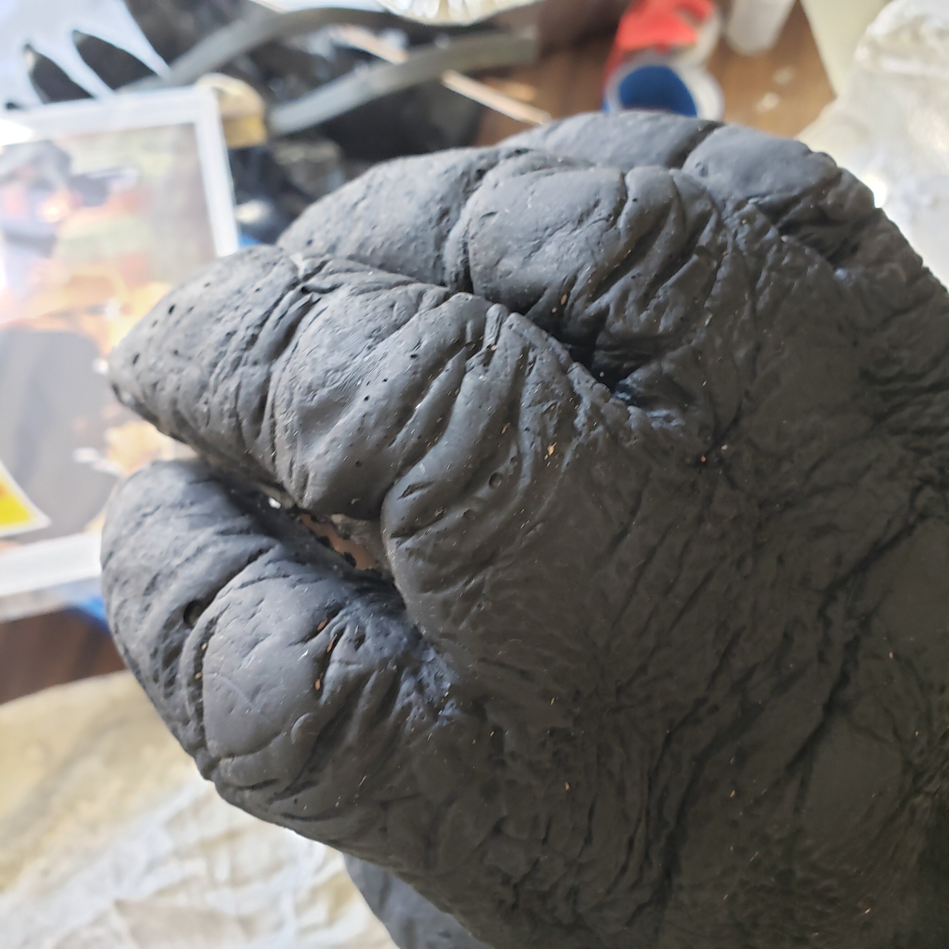

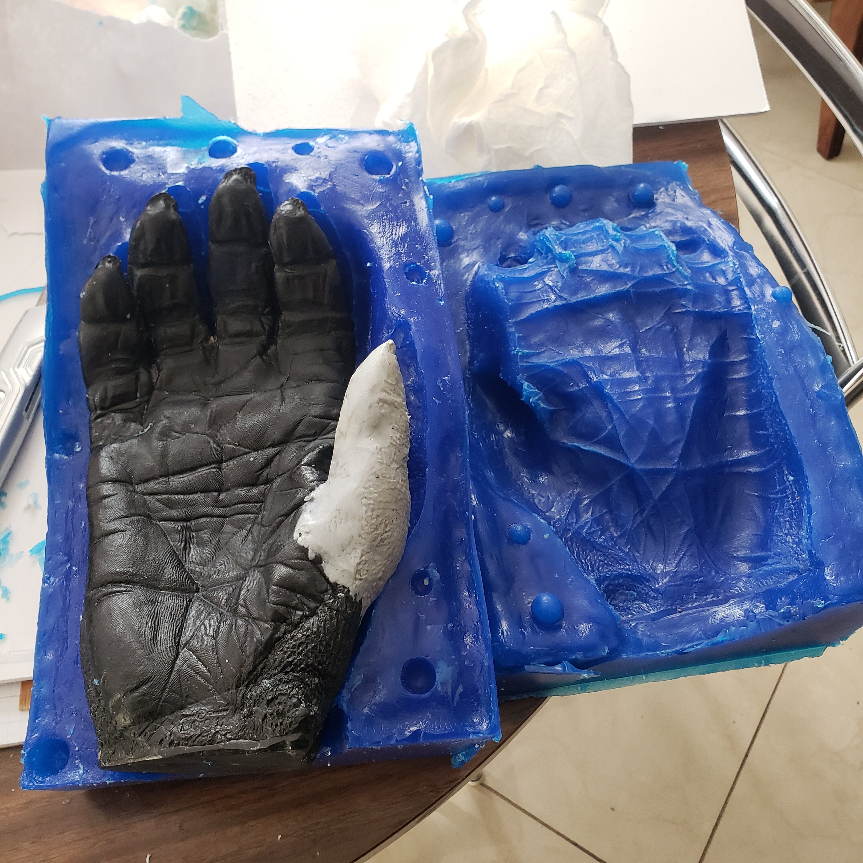

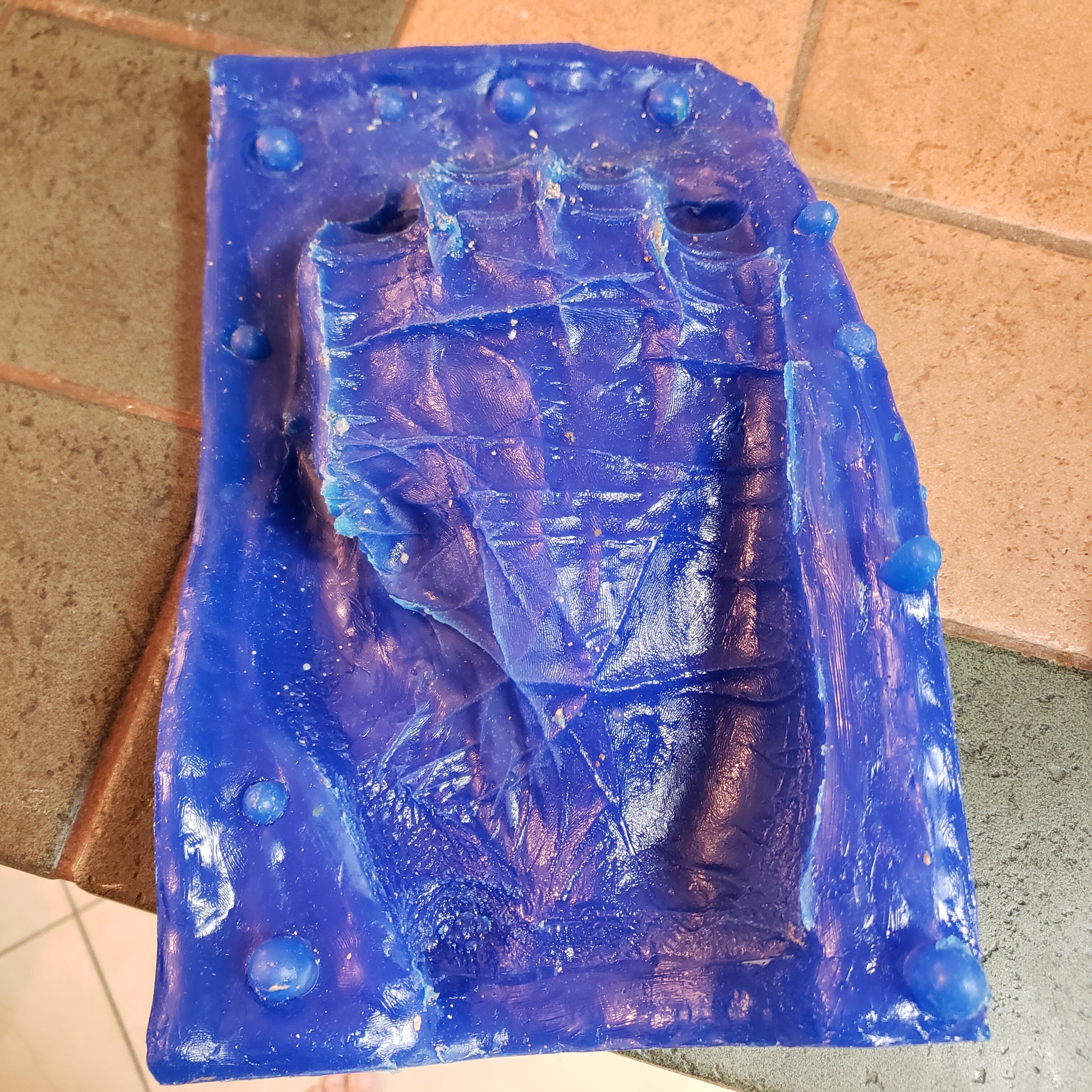

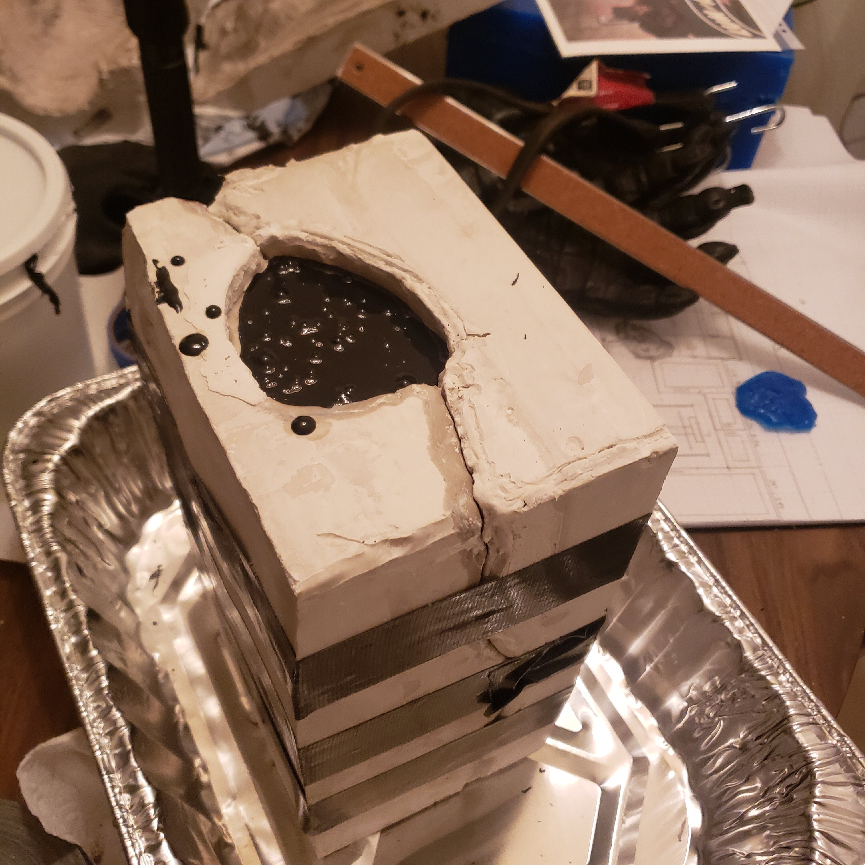

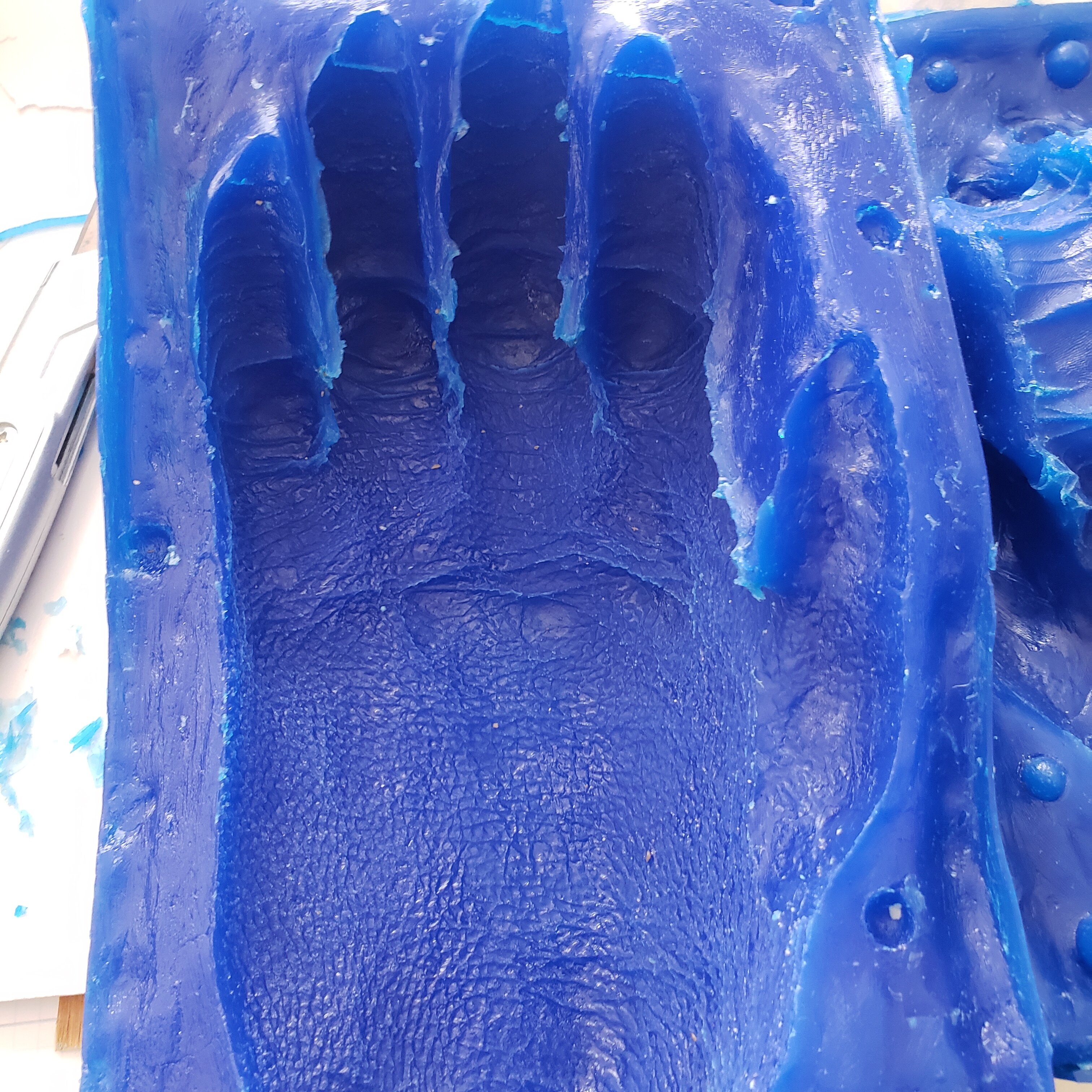

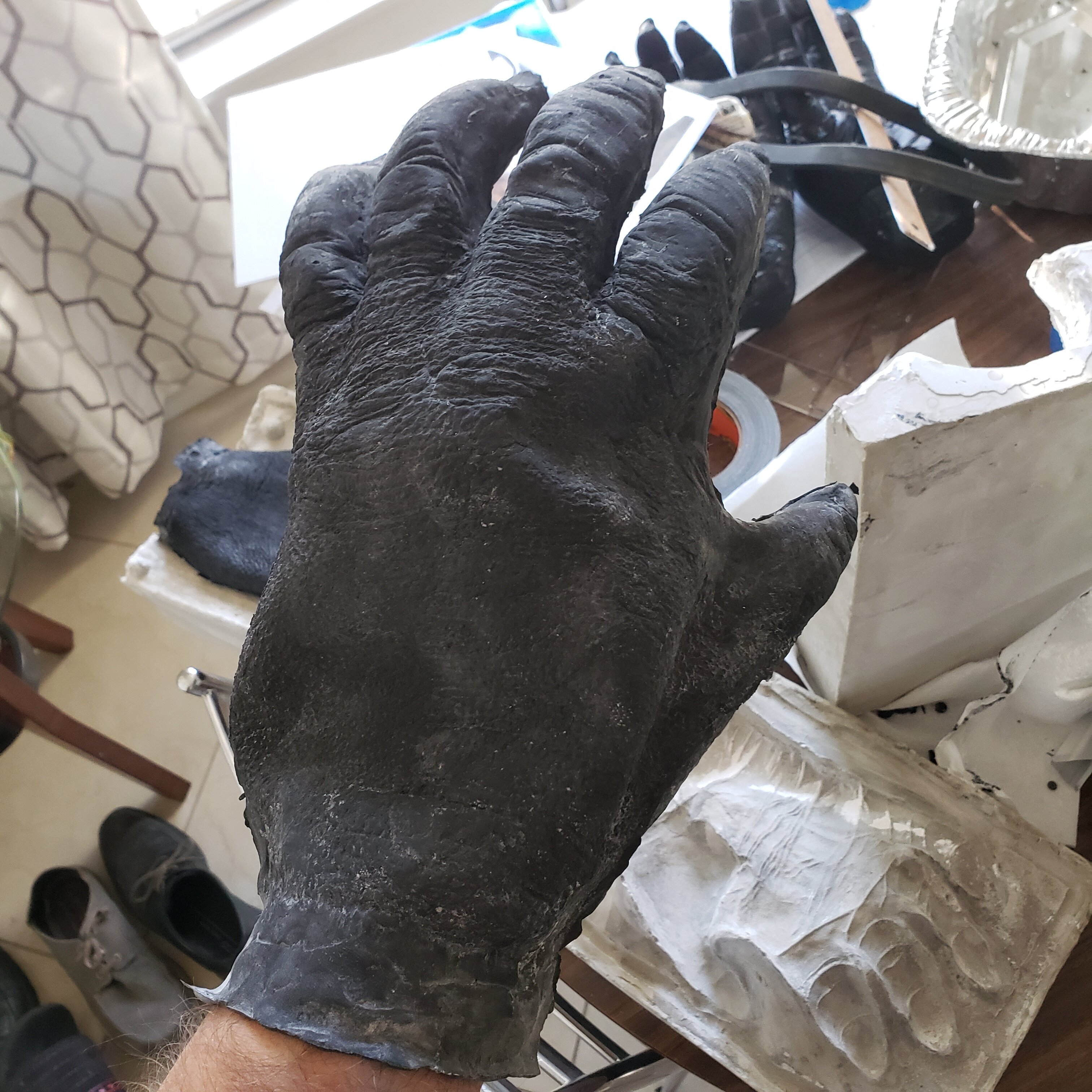

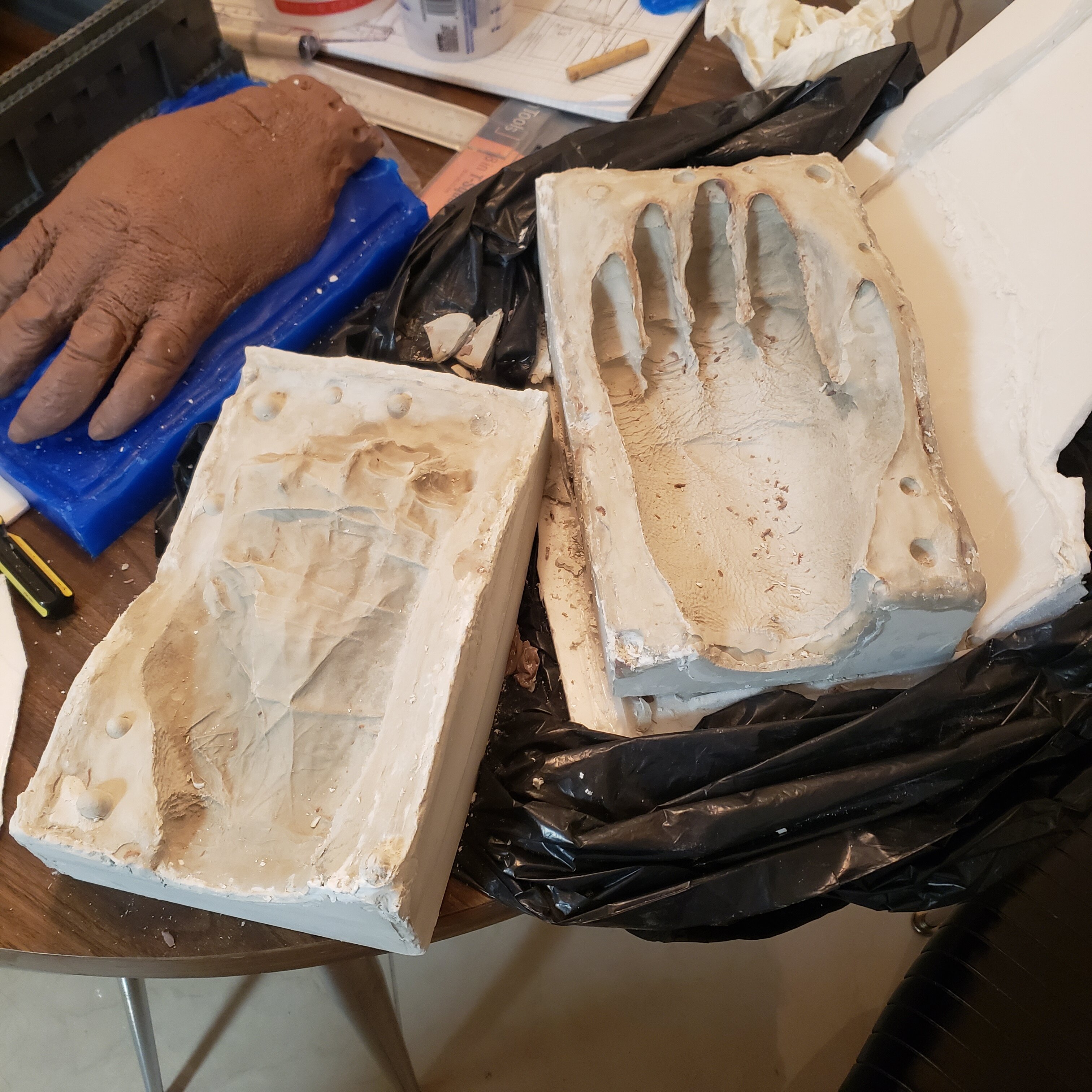

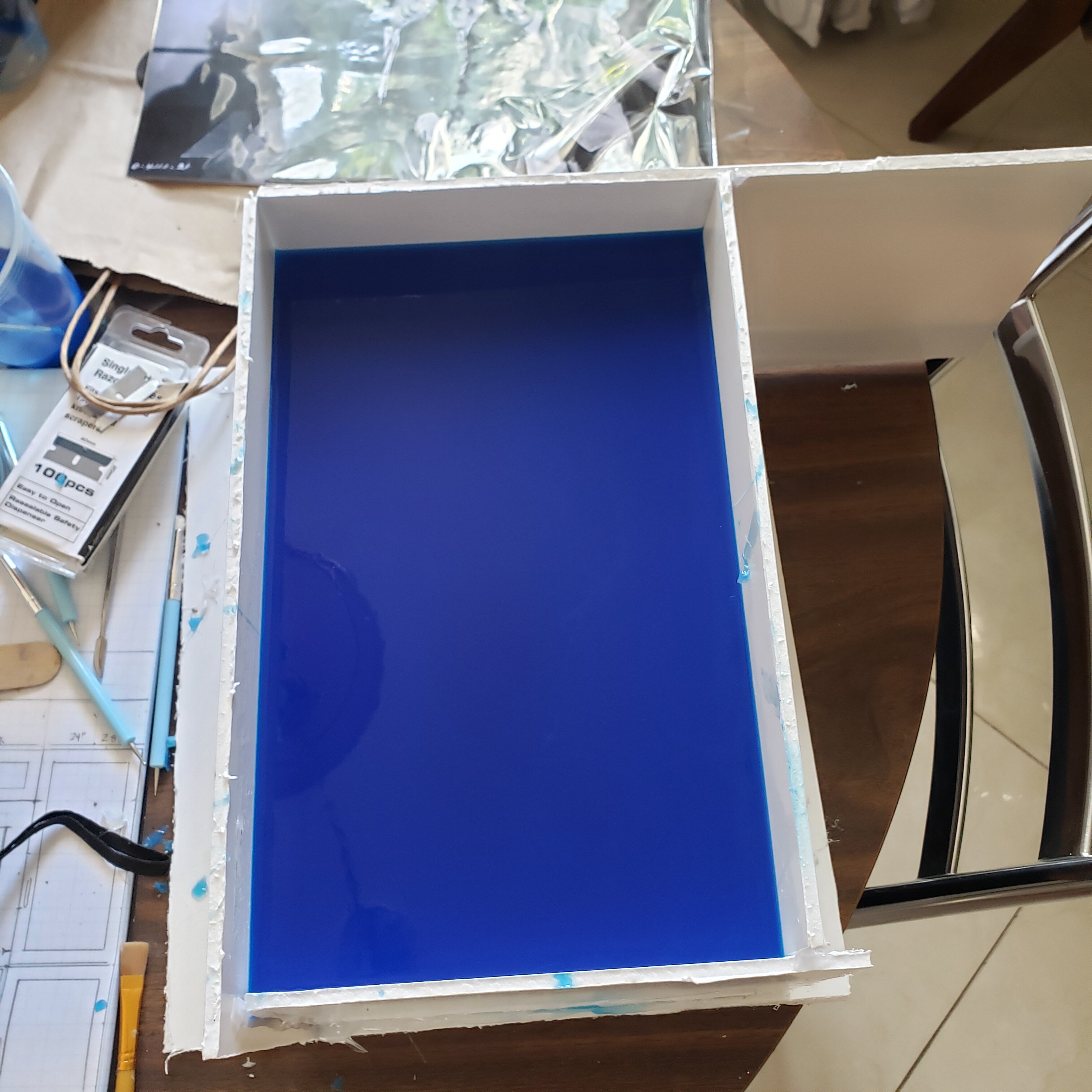

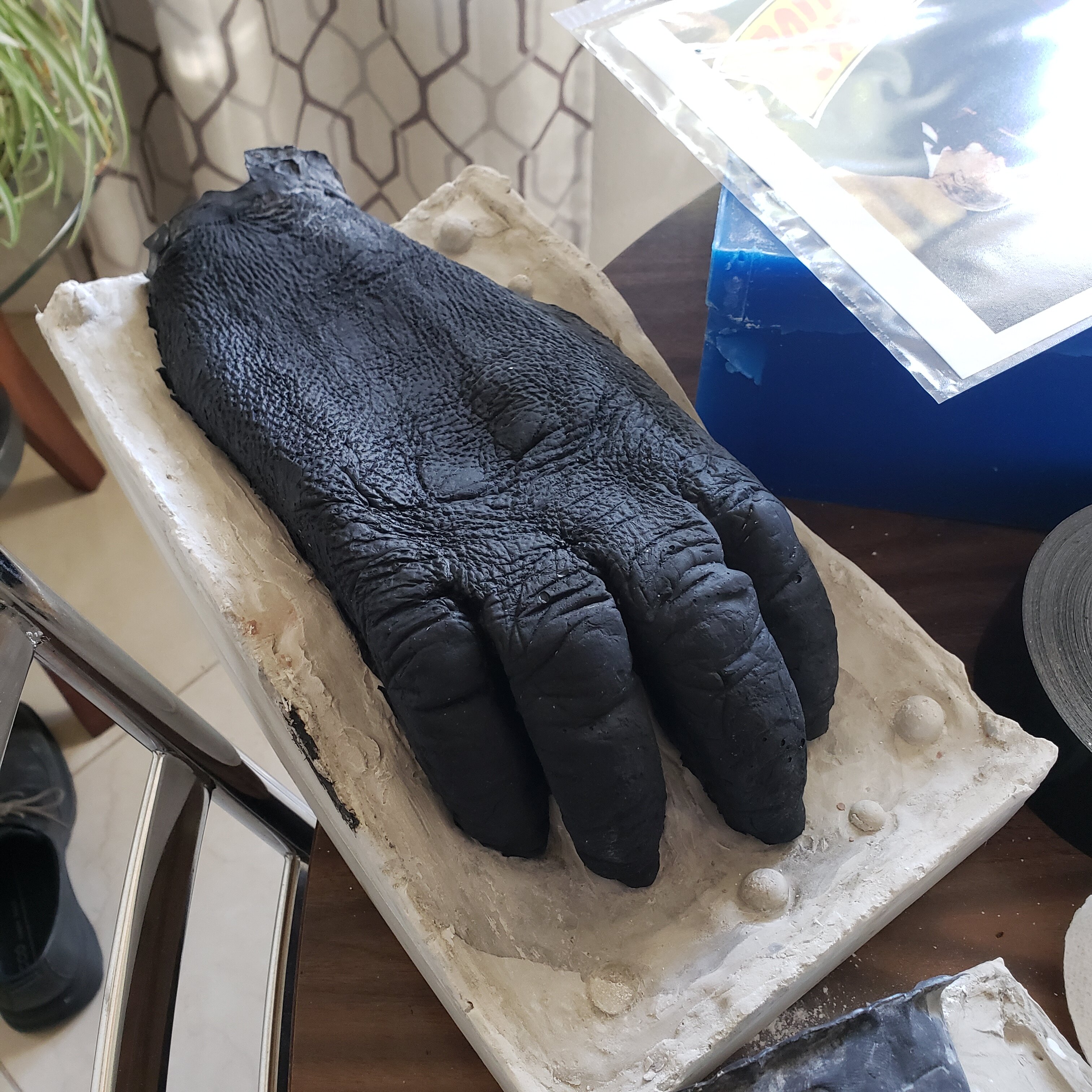

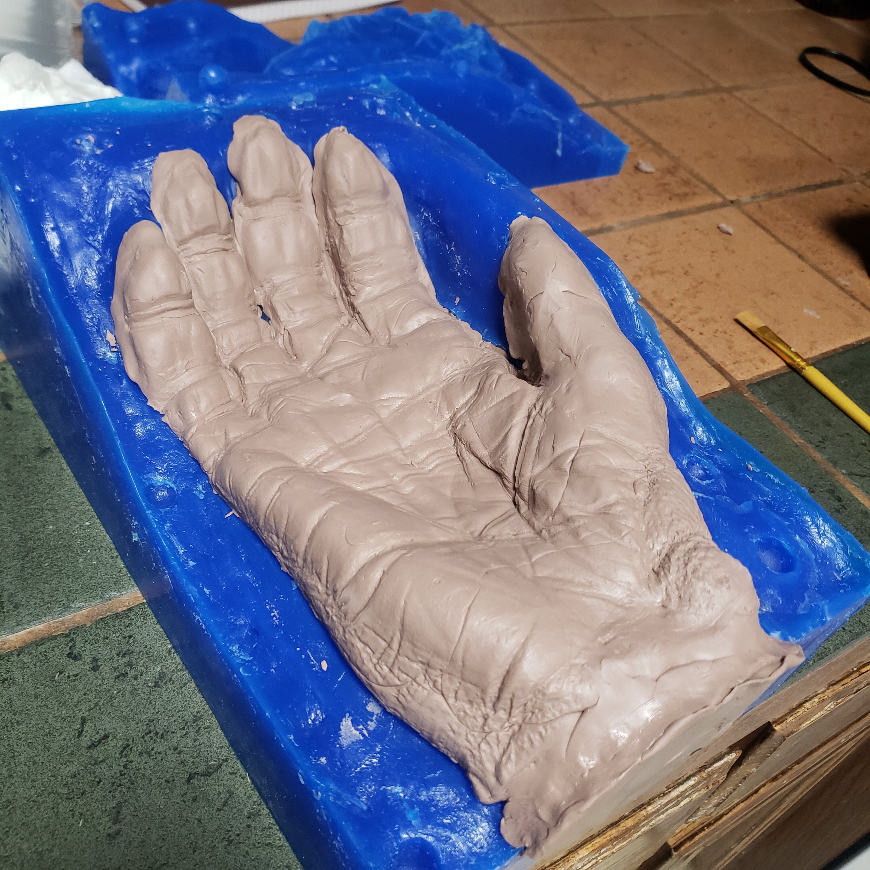

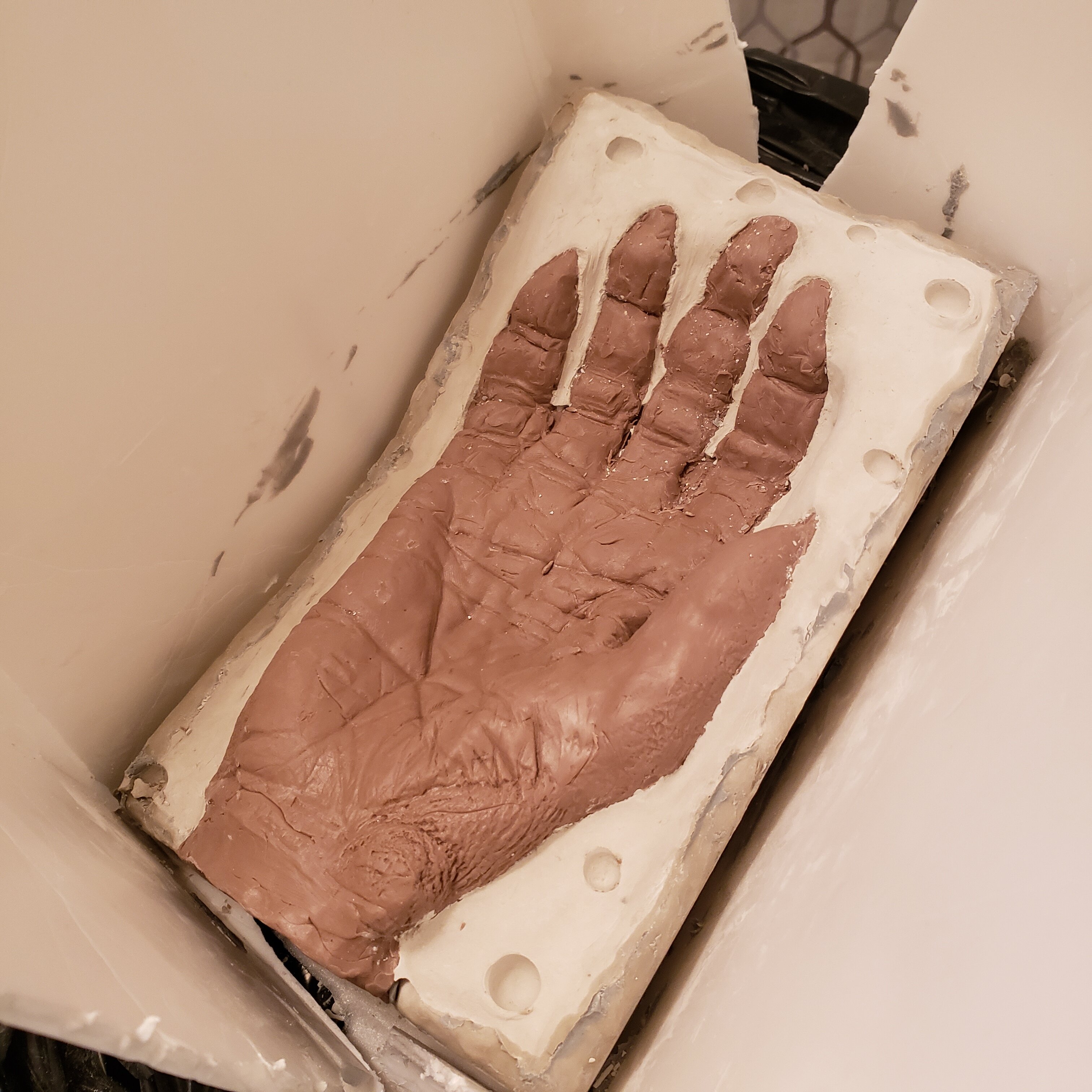

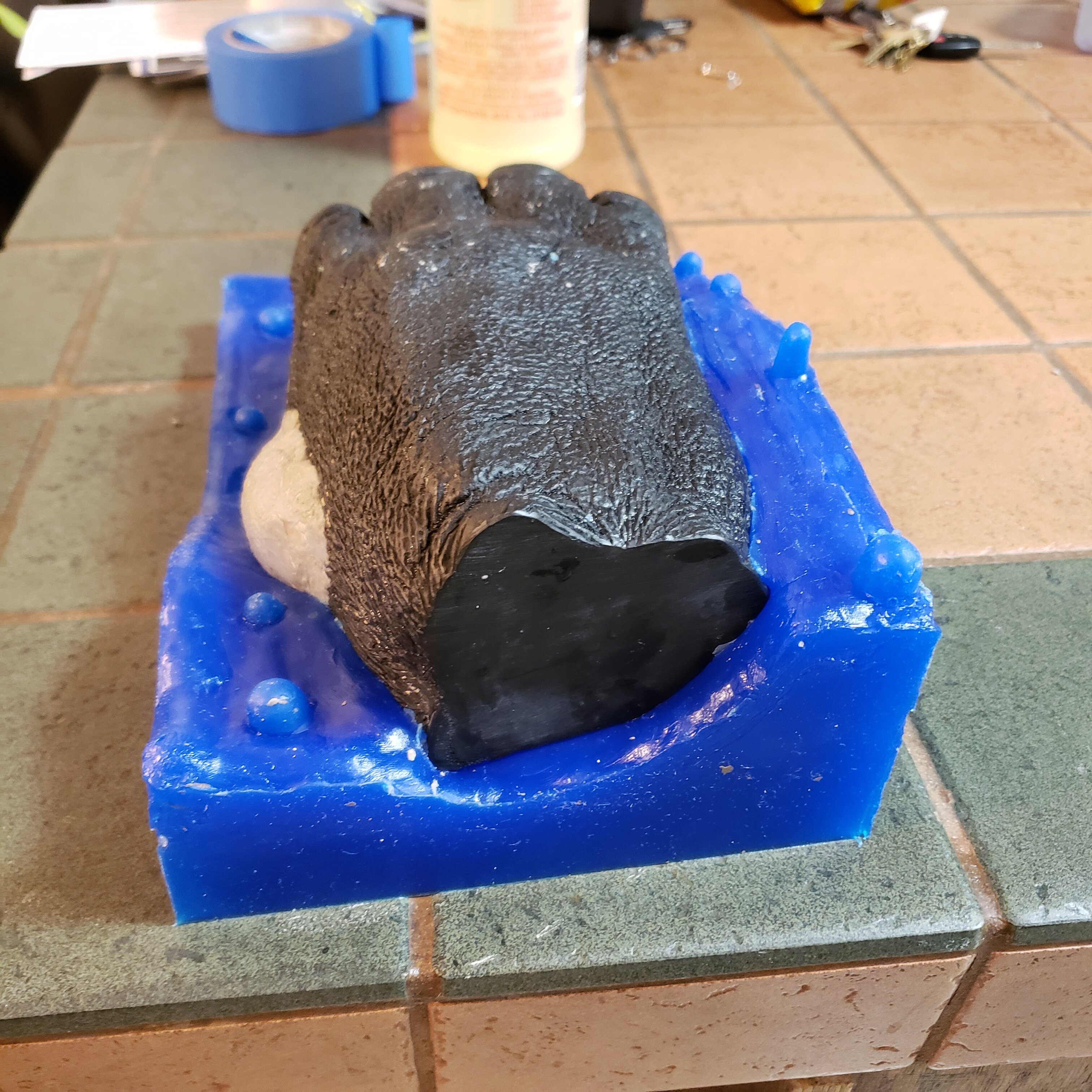

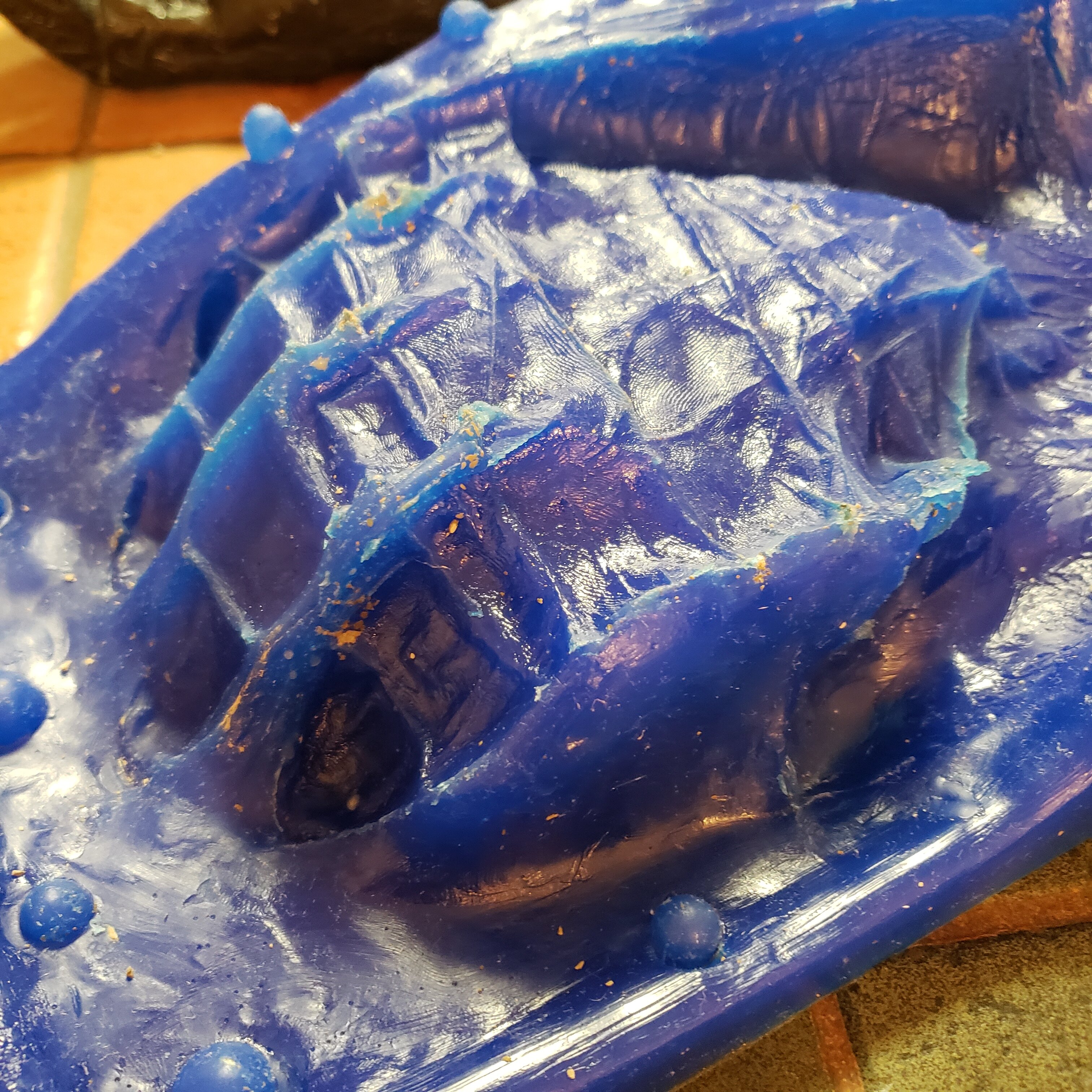

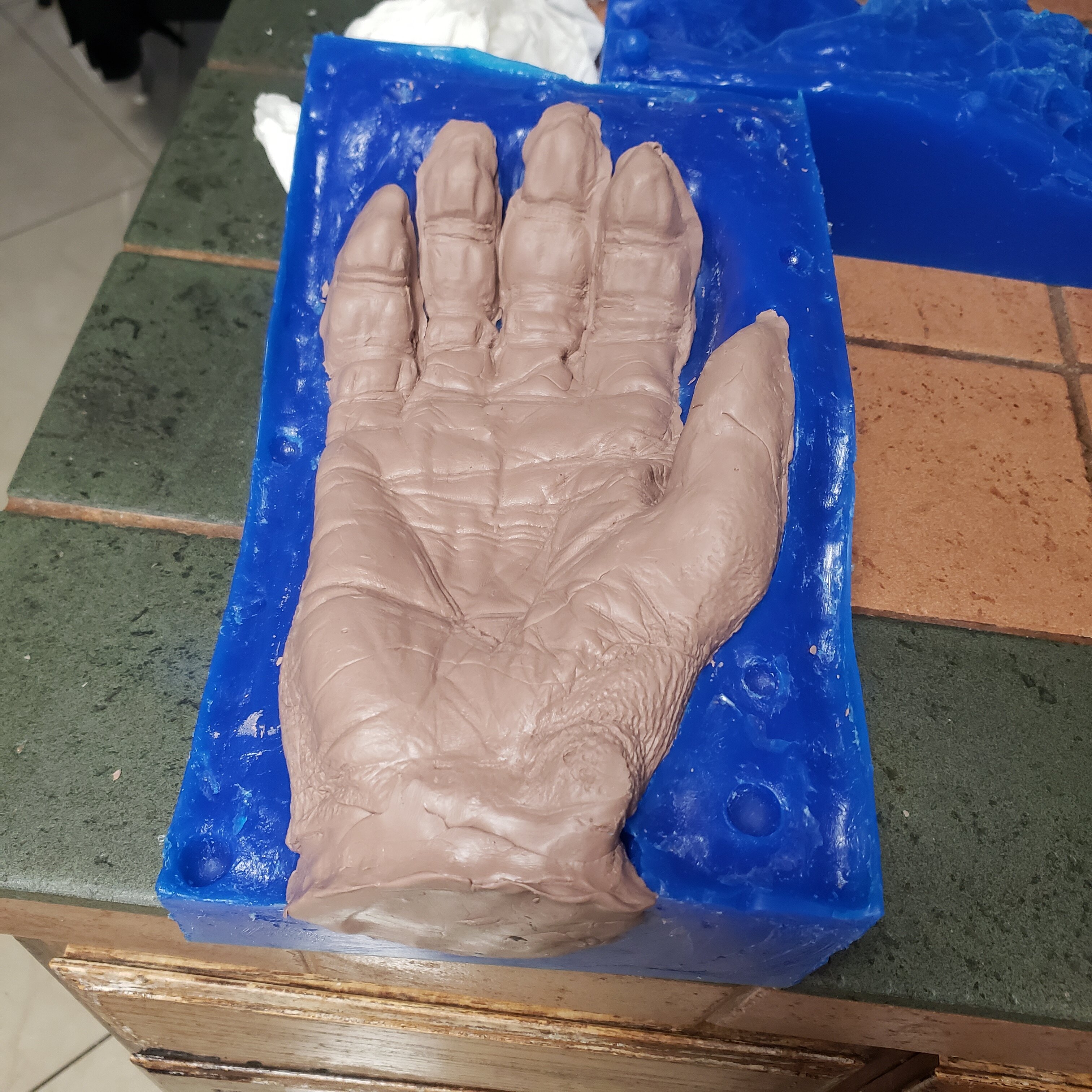

I made my Gorilla Hands. I took my resin masters and cast them in silicone. Once I got my silicone molds, I pressed hard Monster Clay in the molds to get clay masters that I could cast in Ultracal.

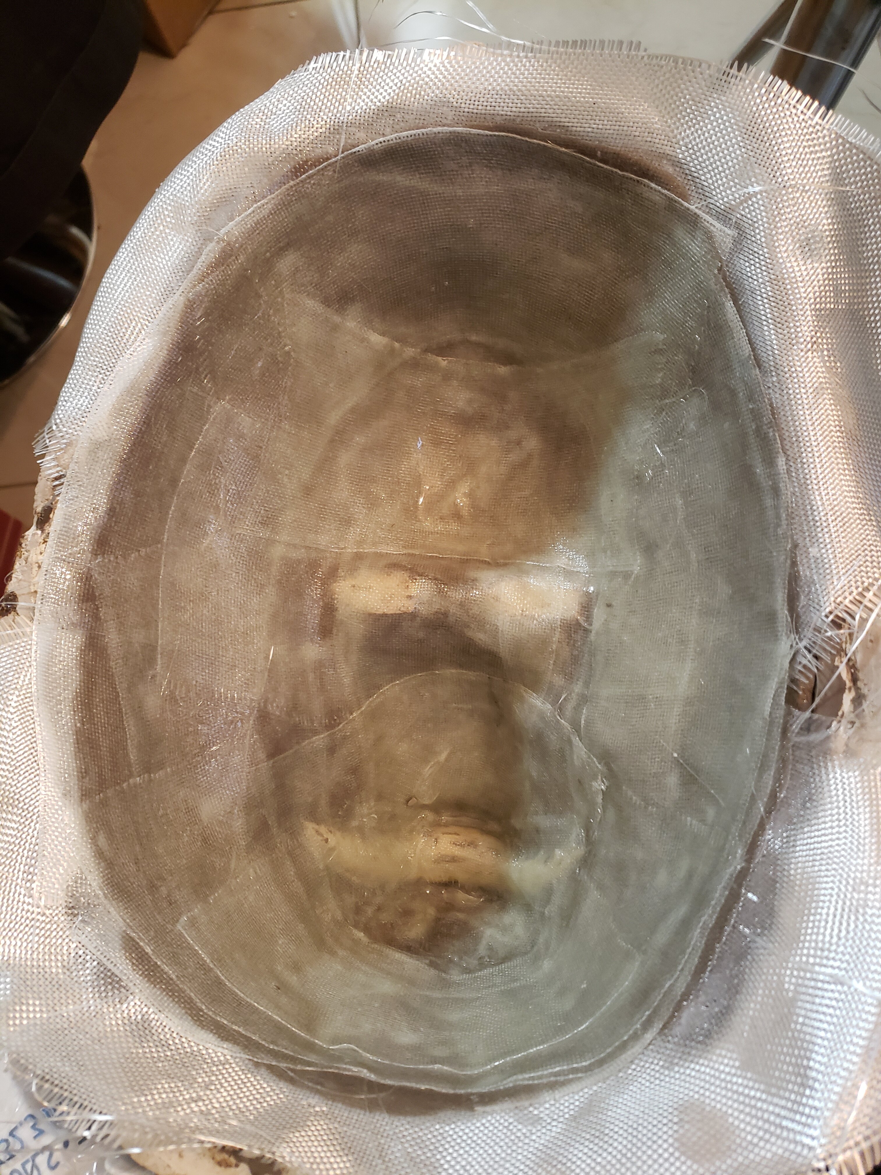

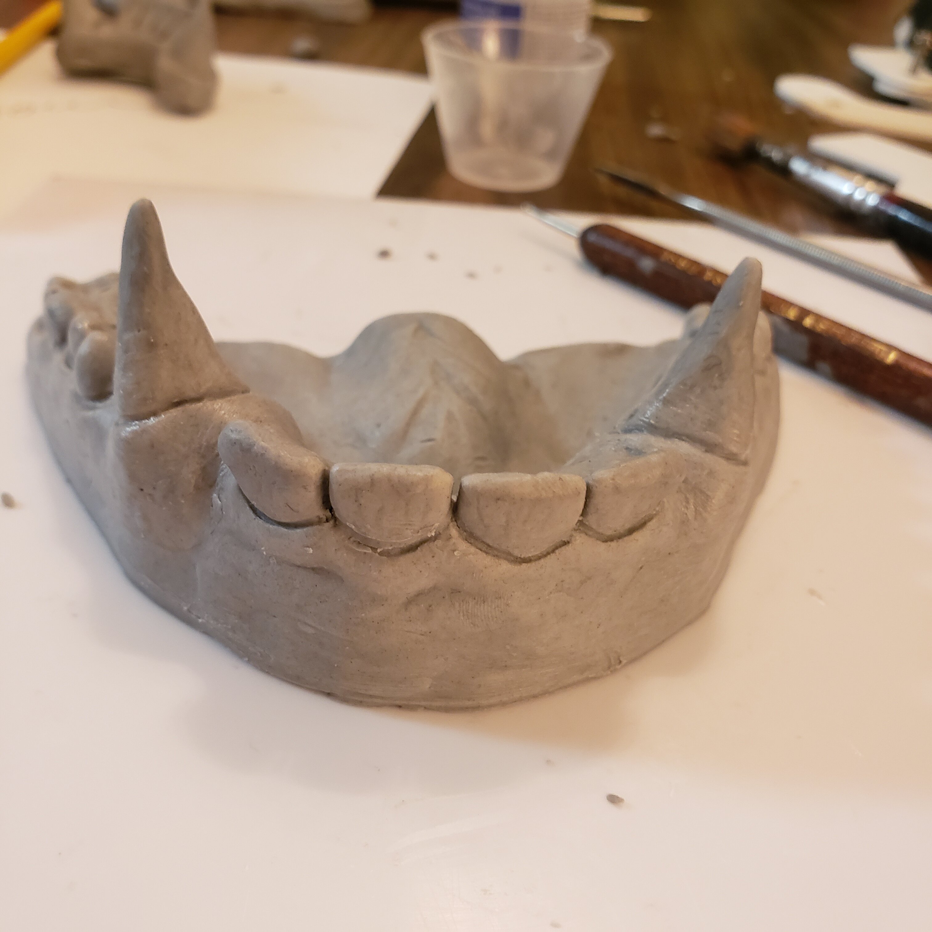

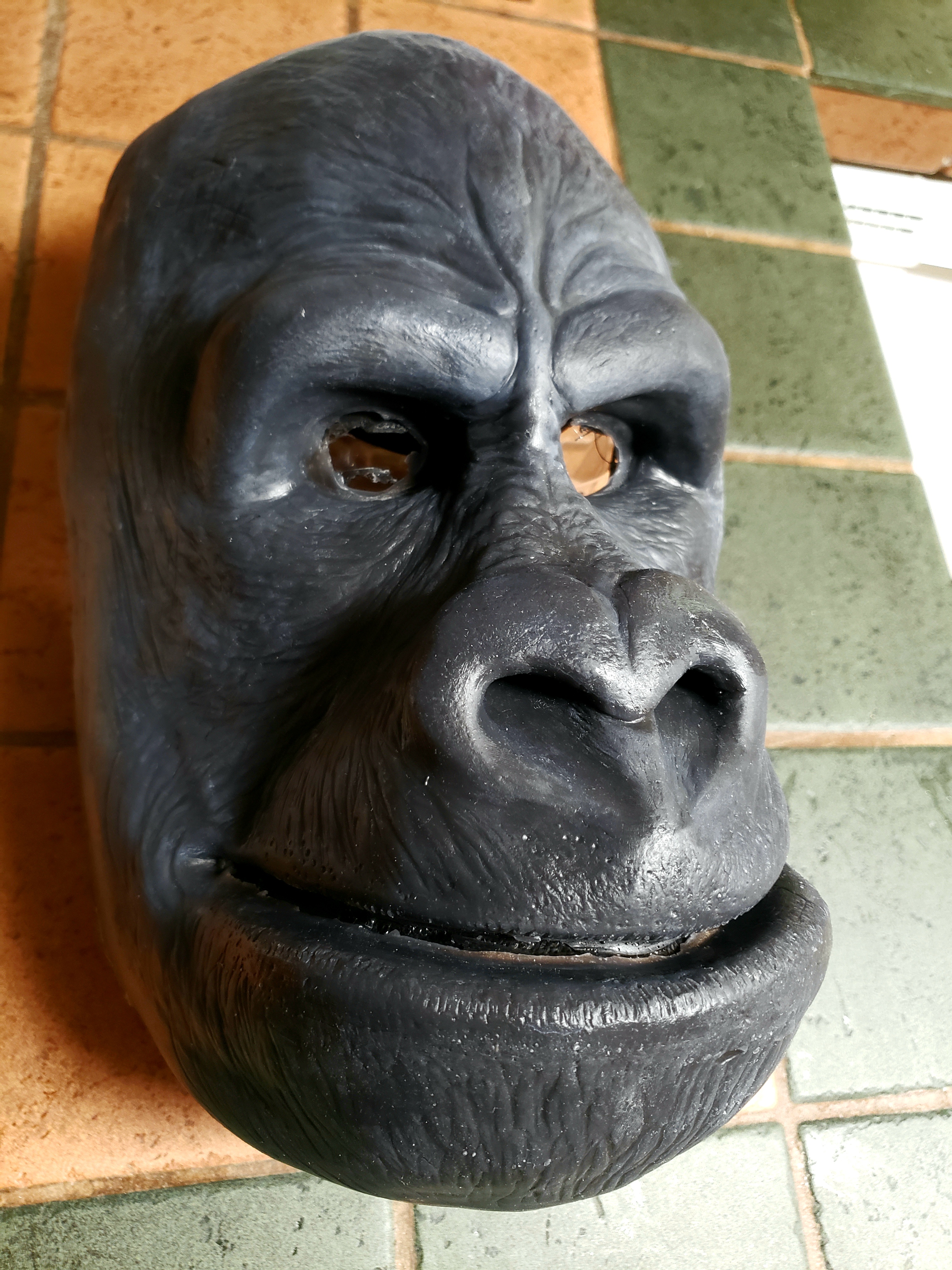

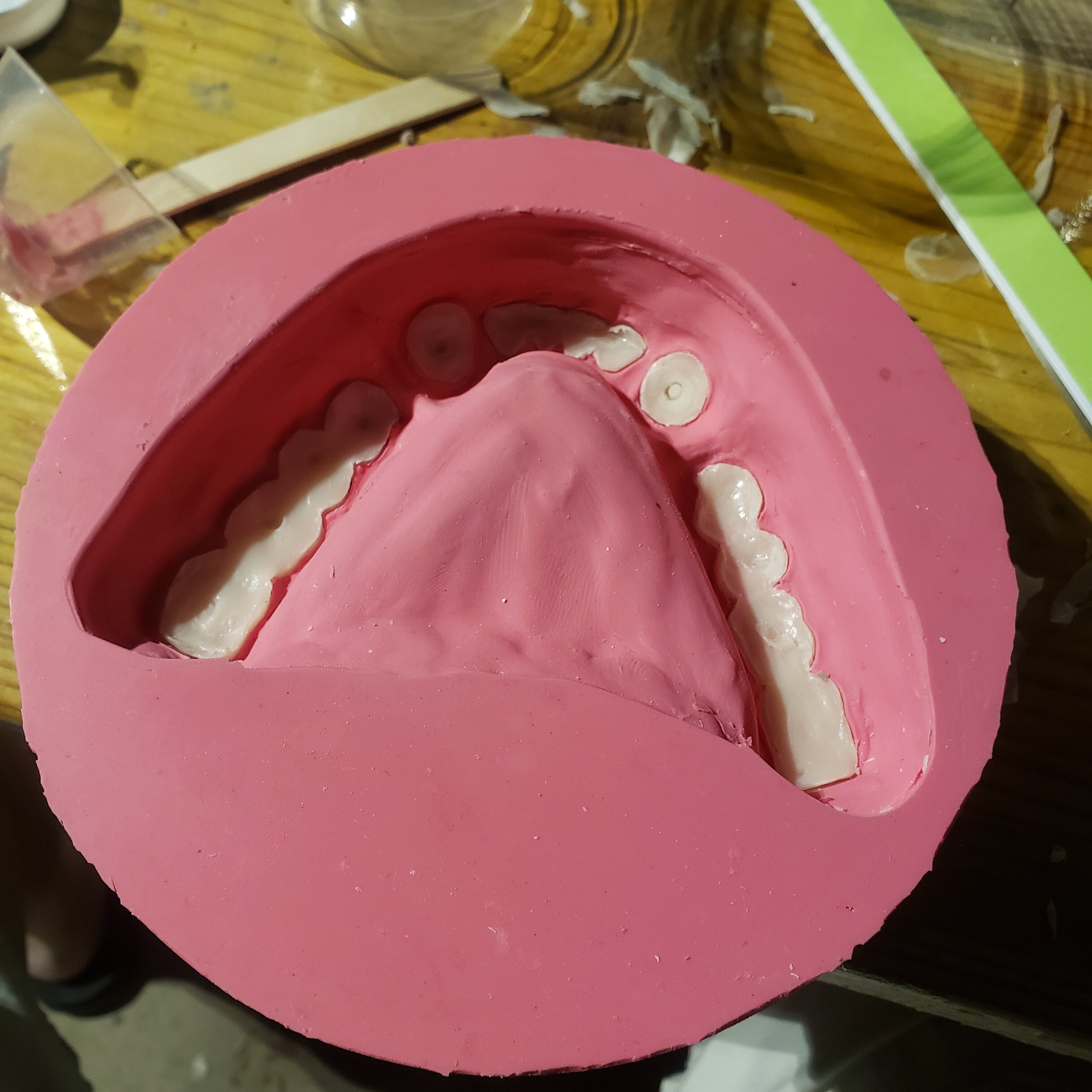

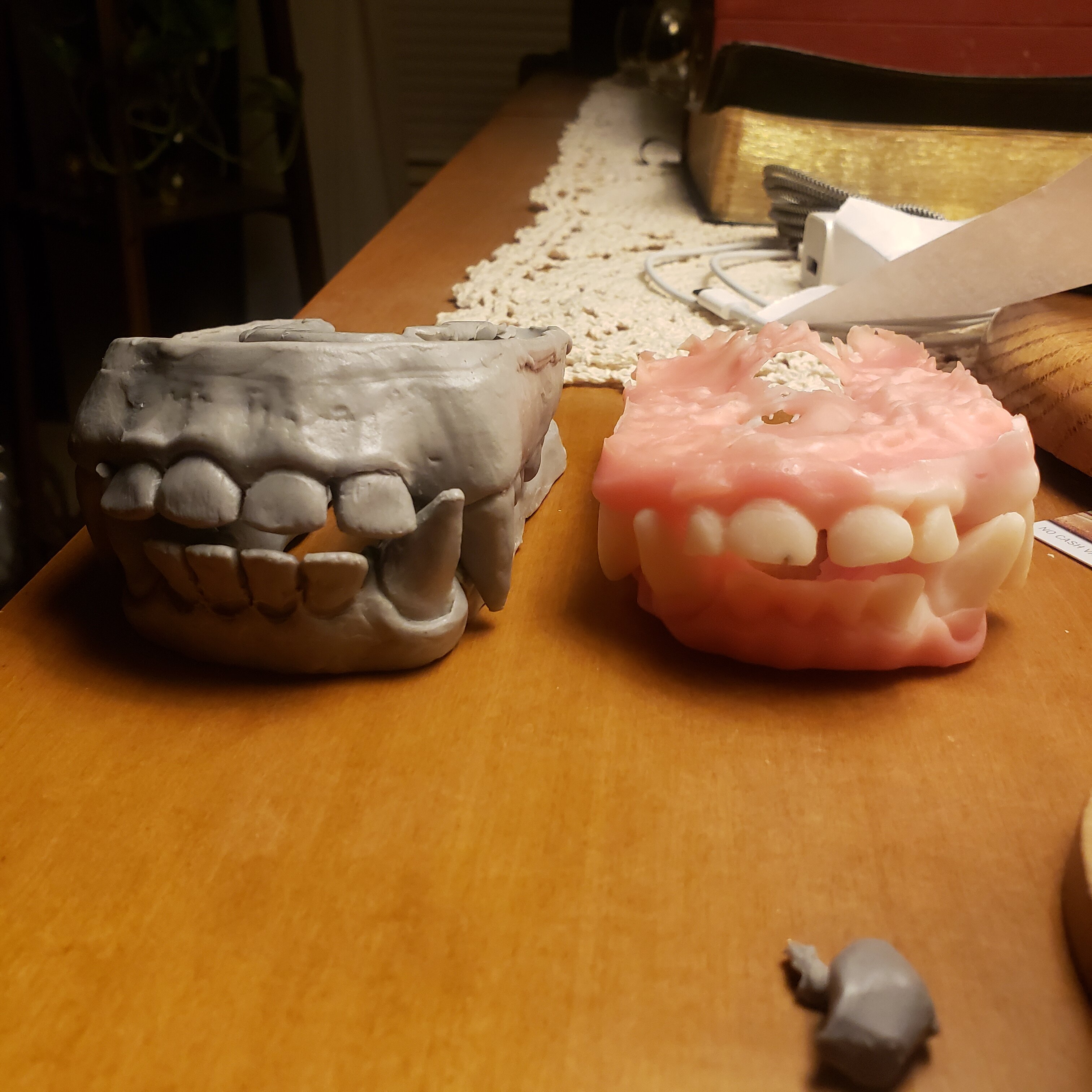

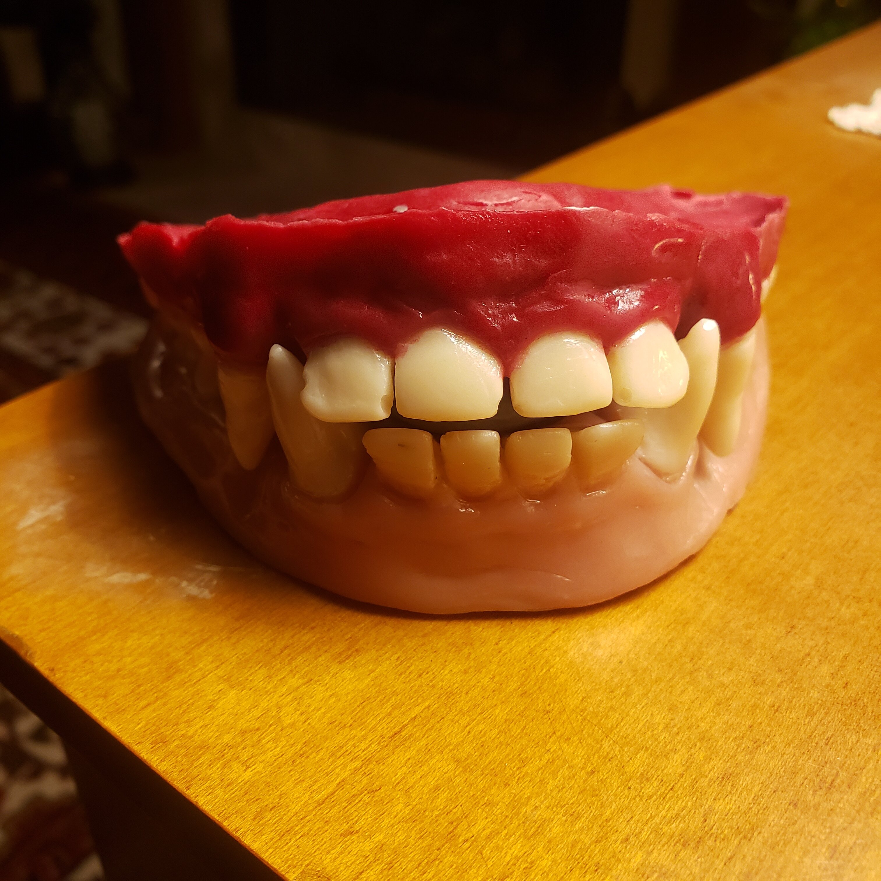

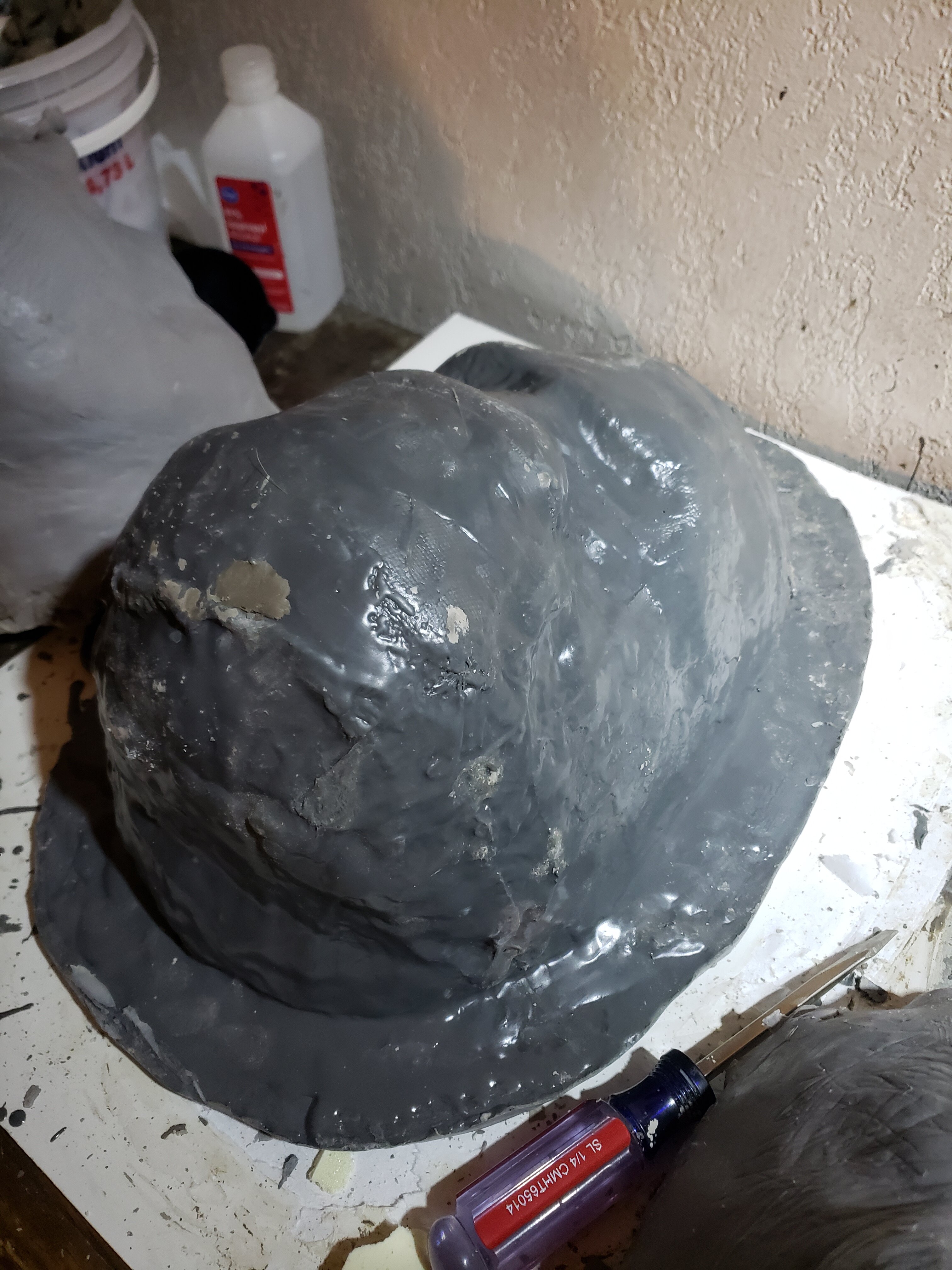

I made my mask in a very thin layer of Latex. I made two versions, one with cotton batting glued to the underside of the latex and one with a layer of Polyfoam to get a foam latex feel. Worked great. I then made a fiberglass underskull and fabricated teeth using resin cast of Gorilla teeth in silicone. In the silicone I poured liquefied Monster Clay to get a master I could manipulate to fit the fiberglass mouth area. Once I got the Clay teeth to fit the underskull, I molded them in Silicone and cast them in Dental gum and tooth acrylic. I glued everything to the underskull.
Fantastic! This is coming together so well! It's exciting to use so many different skills, products and techniques in a project. Very impressive work!

How do you make the final step (ie the hand gloves) in you ultracal mold ?
