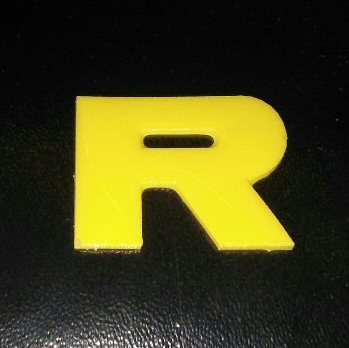

I have decided to make my own tube bag done 3D lettering. The last time I made these, the yellow pigment came out translucent, even though it was supposed to be a solid colour. When I glued them on to a lid, the glue made them really transparent and you could see black through the yellow.
This round, I have mixed white pigment first to make white epoxy resin, then pigmented that yellow. So hopefully these work out better.
I know the screen used bag had painted decals. It would be nice to be able to get a reverse sticker that allows me to paint them on.
Production bags will get a sticker.
