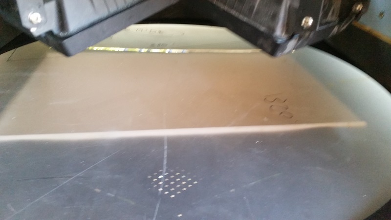

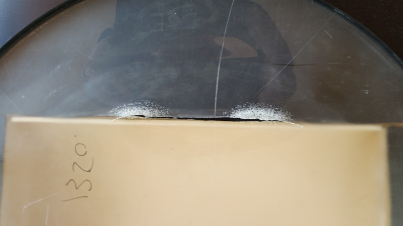

I set this up today, but I rushed it.
1. The front right heater was not on for the 1st 10min of heating so the left side had started to get sucked in, but the right was not moving. I broke the seal too early resetting this.
2. I discovered a leak on the fitting that connects the main chamber to the surge tank. Thread tape should fix this. The surge tank Idea works a treat, but because this fitting sucks air, does not hold the vacuum in the main chamber long enough. I will need to spend time and test a full vacuum before I can continue.
3. I am using 4 x 500W lights for heaters. I had made a wooden spacer to raise the heater off the plastic. It was taking too long and so I removed it. The heaters were now too close and burned the plastic. Something about slow and steady wins the race? I noticed the other day there were 200W versions of the same lights I am using. Part of me thinks that 8 x 200W (1600W) is actually going to be better than the 4 x 500W (2000W) I have now as I will get more surface area coverage.
I will need to run a test to see just how long this Perspex takes to heat. It won't matter if I burn it again now that it aready compromised.
When I think back to the dome I pulled from 3mm, I am thinking that process was over 20mins now...

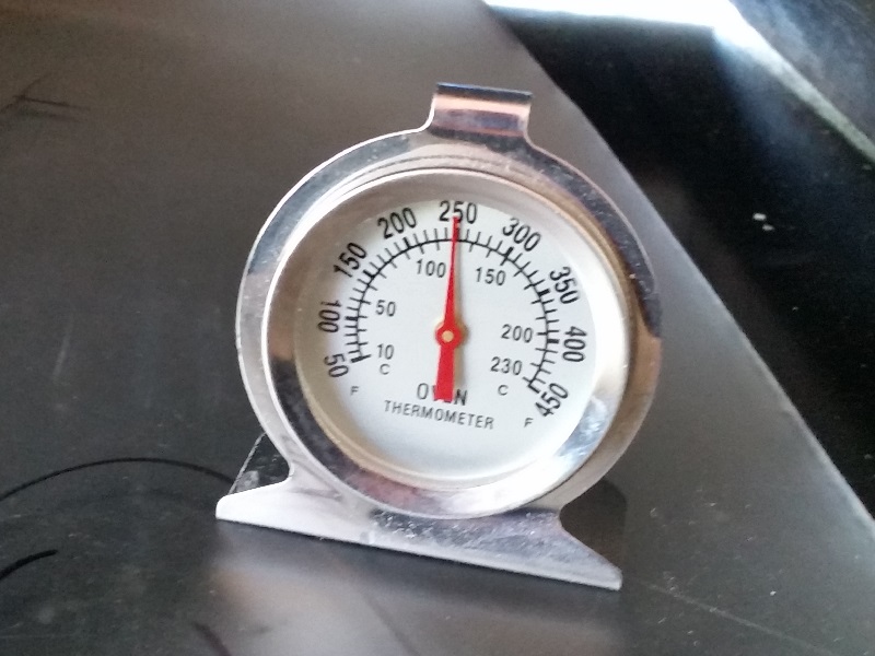

Ran some heating tests today and added a small fan to move the hot air around inside the heater. This got the temp up a bit.
attachment.php

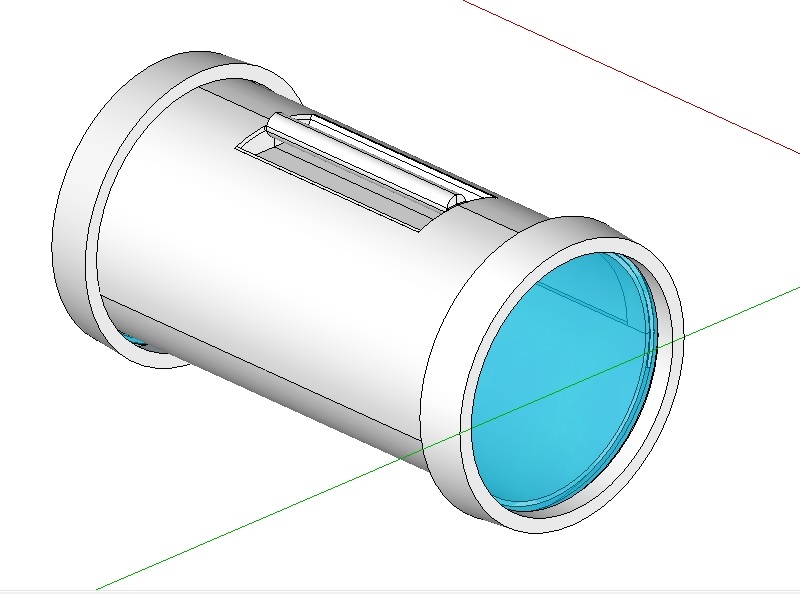

OK after a few re-draws, it looks like the only way this will happen is to have the end cap machined ($40/hour plus materials), then mold and cast this part (probably in an epoxy as it is nice and hard and can be pigmented black.
Based on the tight tolerances needed to allow the lids to move, I think thermoforming is out.

Question for the forum: This tube bag is supposed to be 22" long and 11" round (dia).
Is that 11" the dia of the tube, or the largest part of the end caps?
If I am to spend money on tooling, I want this right.

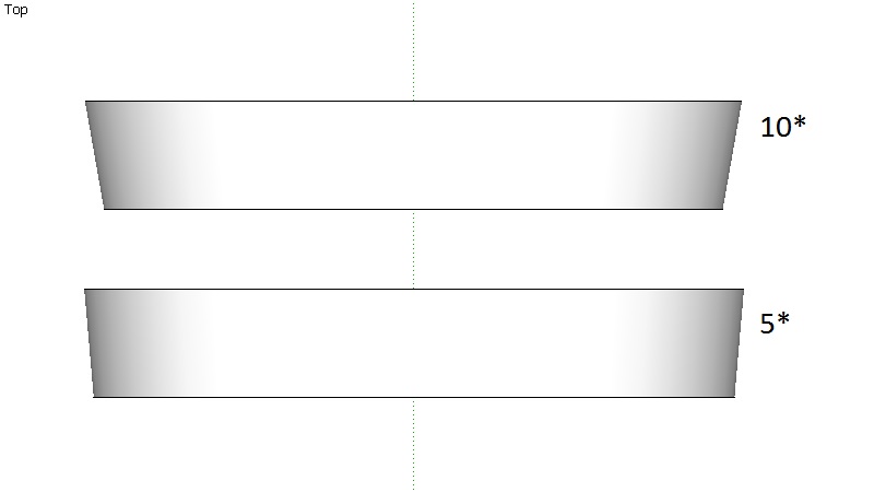

Please provide feedback. I've reduced the angle on the tapered lid from 10 degrees back to 5 degrees. And I am liking 5 more than 10 right now.

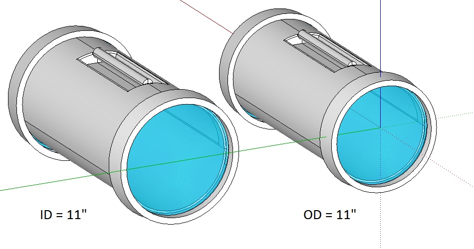

It may be 11 overall outer diameter, its just big enough for MJF's sized shoes
https://thngs.co/things/6942
Yeah that is what I thought too. People want screen accurate (and in my opinion, that SHOULD include a 1:1 scale) yet also want this to be practical. Most of the people that buy this tube will have shoes bigger than US7.
If we run with 11" overall diameter, then the PVC pipe that I have on hand (and I want to use to make the body) is perfect. But that won't hold a pair US10MAGs with bending them. It does however fit in the overhead locker on a plane :)
I will create two models, 11"OD and 11" ID.
Any thought on the angle?
And two versions - the one on the left with an ID of 11 inches and the version on the right with an OD of 11 inches. Both are the same length.
