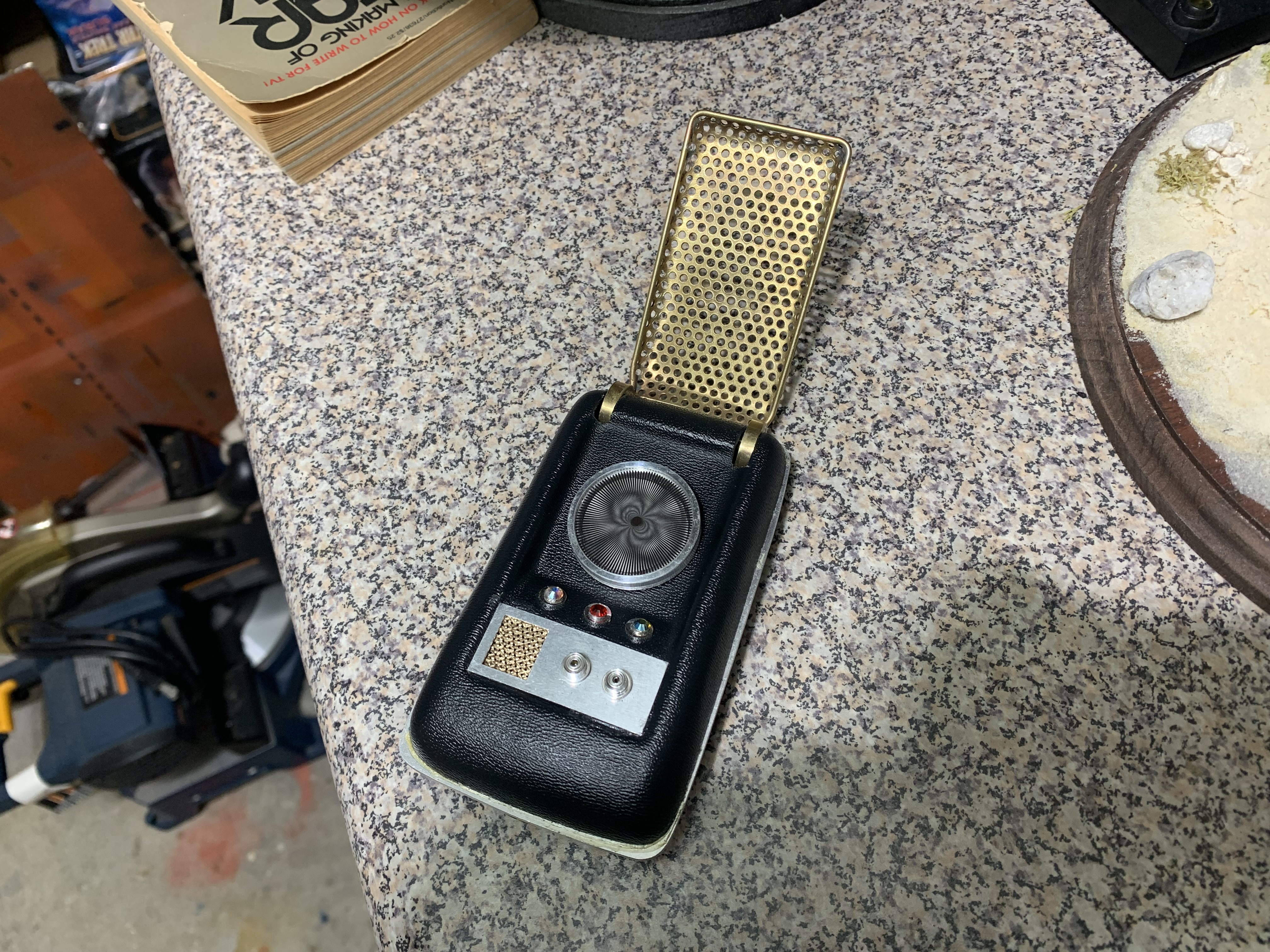

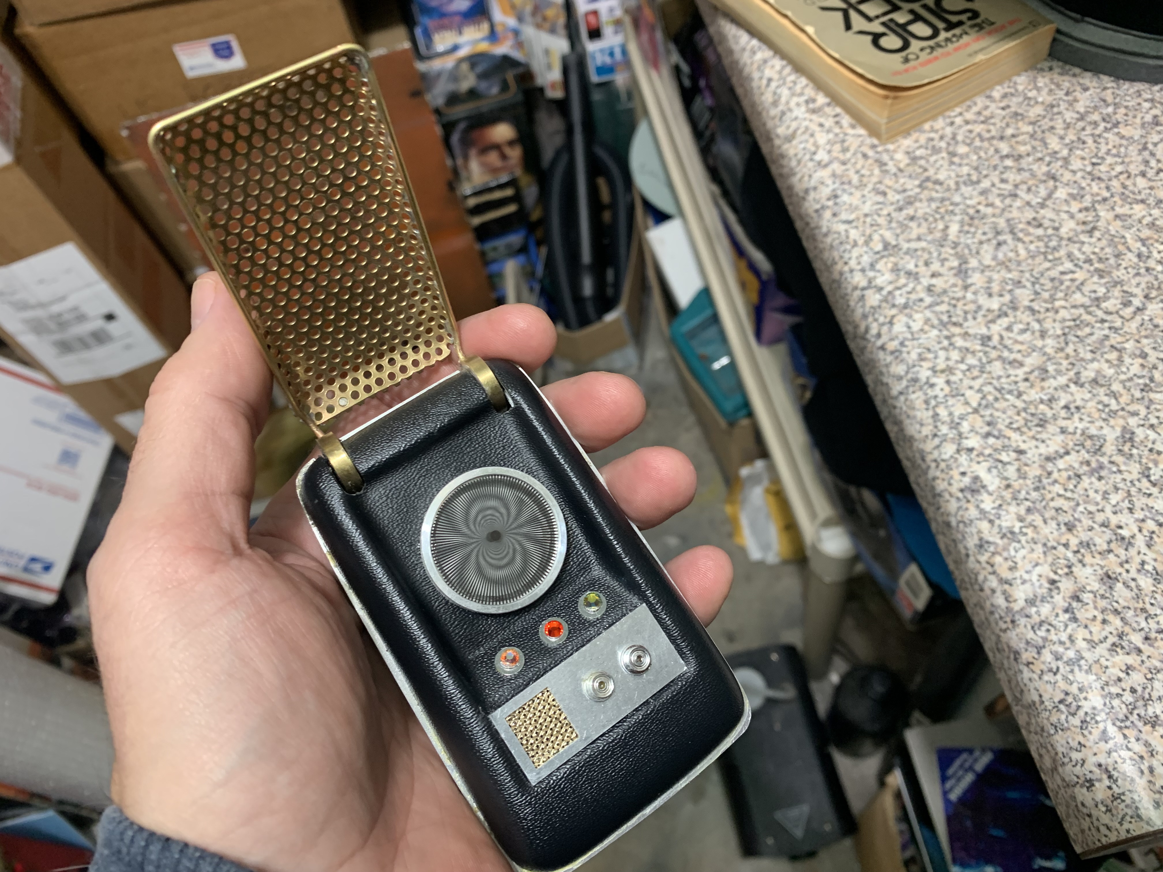

So here is my Alpha Hero Communicator build. I used my references and Herocomm to get the build right.
Many thanks to friend and master prop maker Stephen Pilock for his assistance.

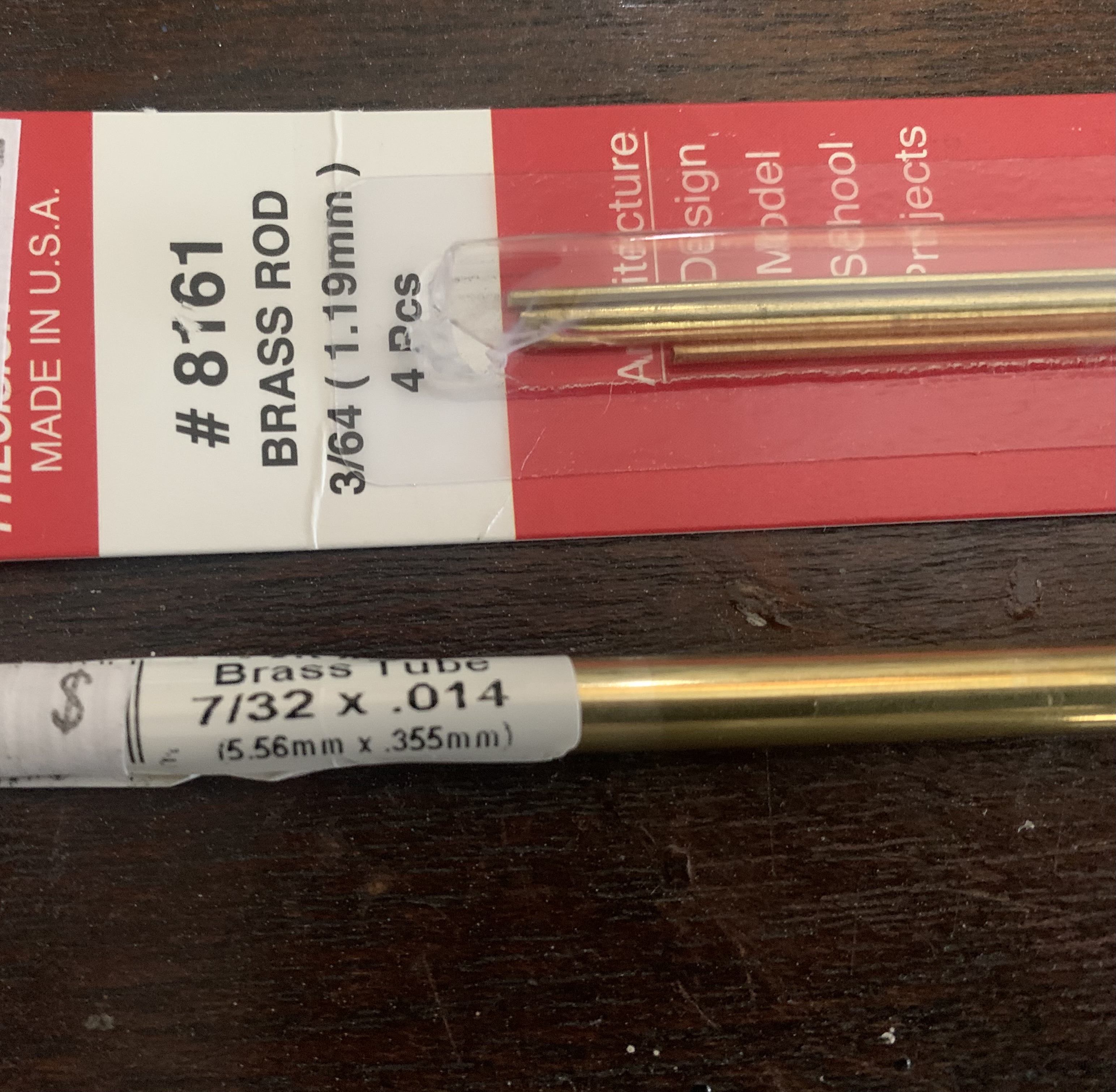

The Shells, lid, mid plate, mic grill, control panel, knobs and the jewels were acquired from friend and Master Prop Maker Stephen Pielock. The two piece bezel and all the internal parts I acquired on my own(stop watch, brass tubing, rubber hose ETC...
Steve had a ready made lid for me, the rest I put together and assembled.

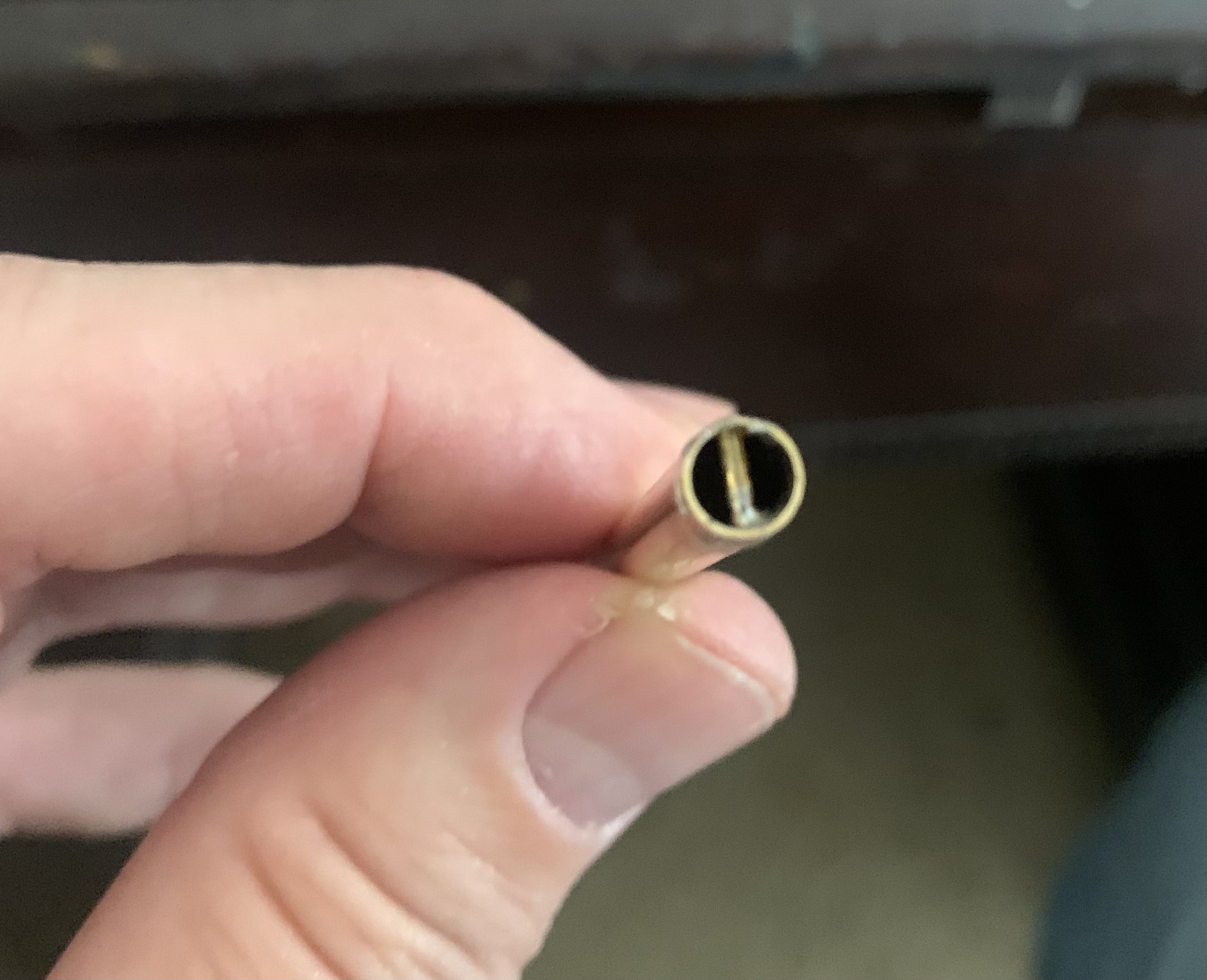

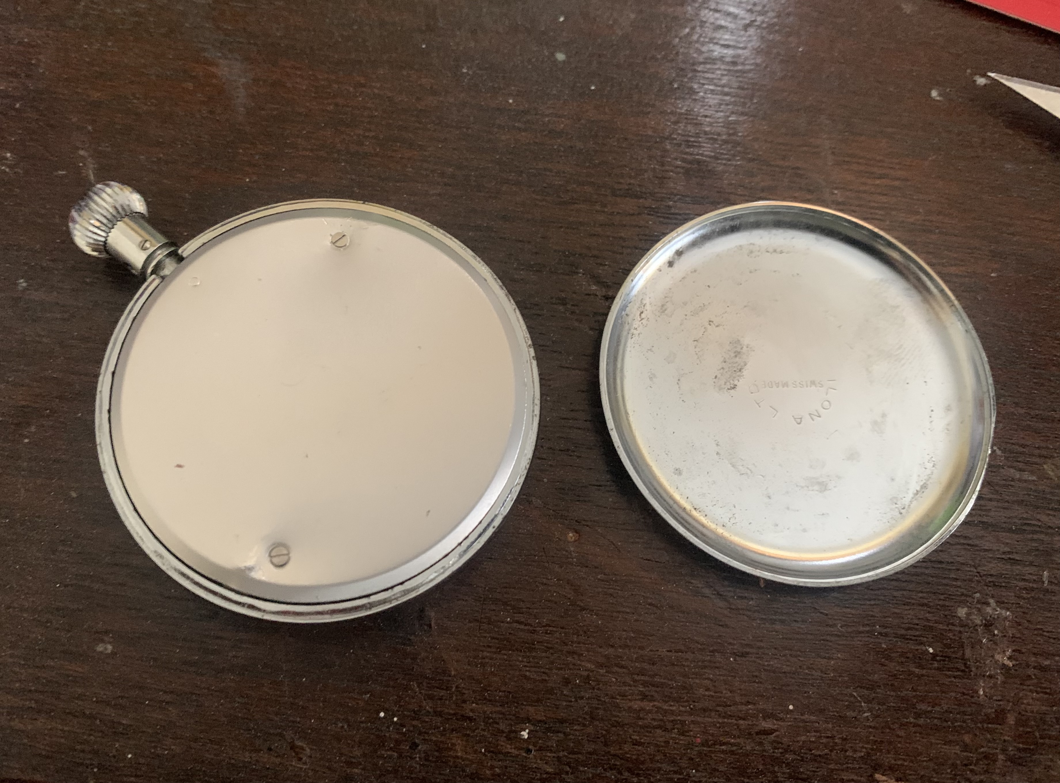

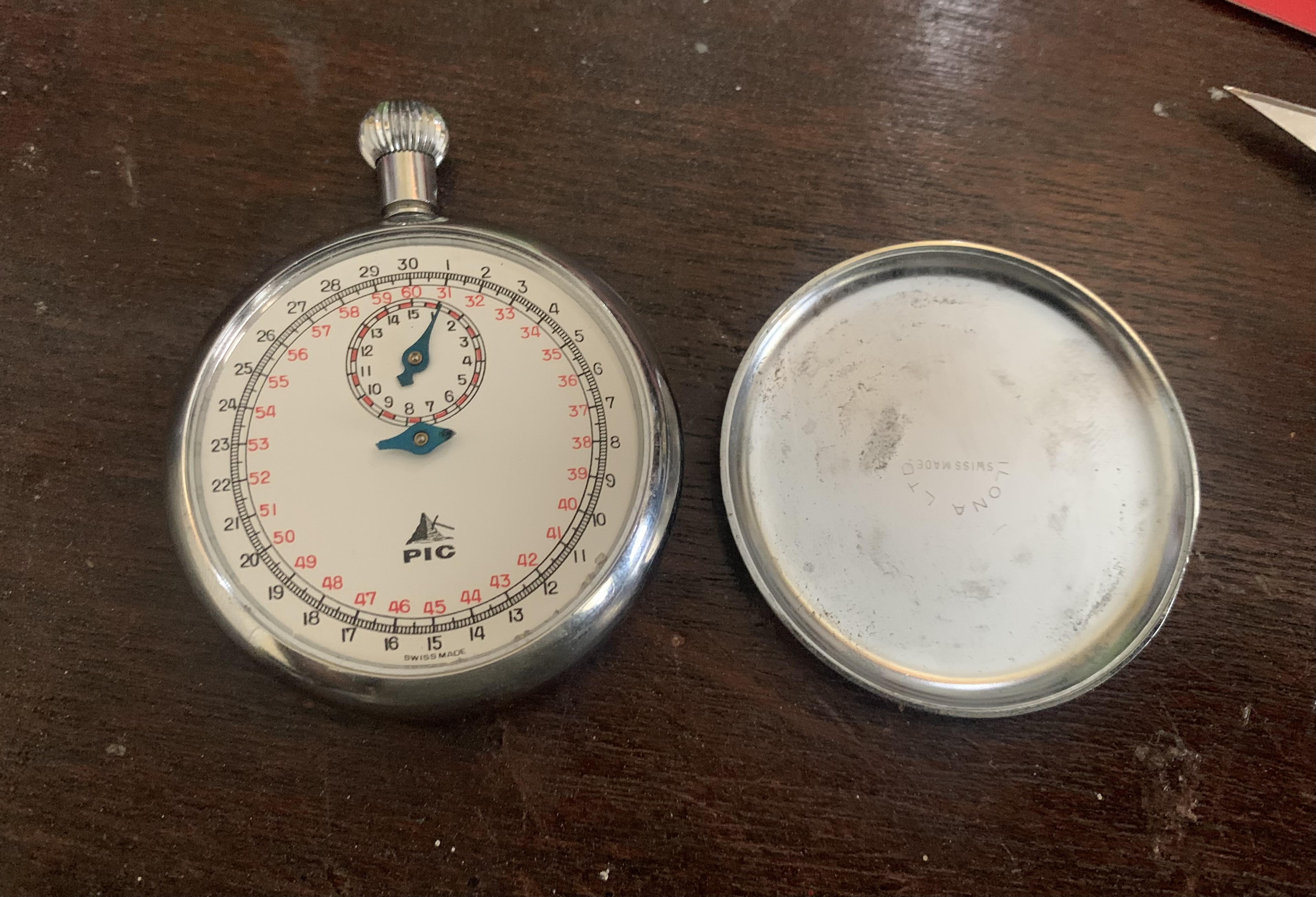

Sorry, I missed that! I used a 1/8"spacer (a circular piece of styrene) epoxied to the second hand on the the stop watch. I trimmed the hands down. Then used a clear epoxy to cement the bottom moire to the spacer, being careful it was perfectly aligned. All this was done after the hole was made in the upper shell for the bottom of the two piece aluminum bezel to sit.
I believe he inverted the face so the numbers at such couldn't be viewed inside the bezel.
