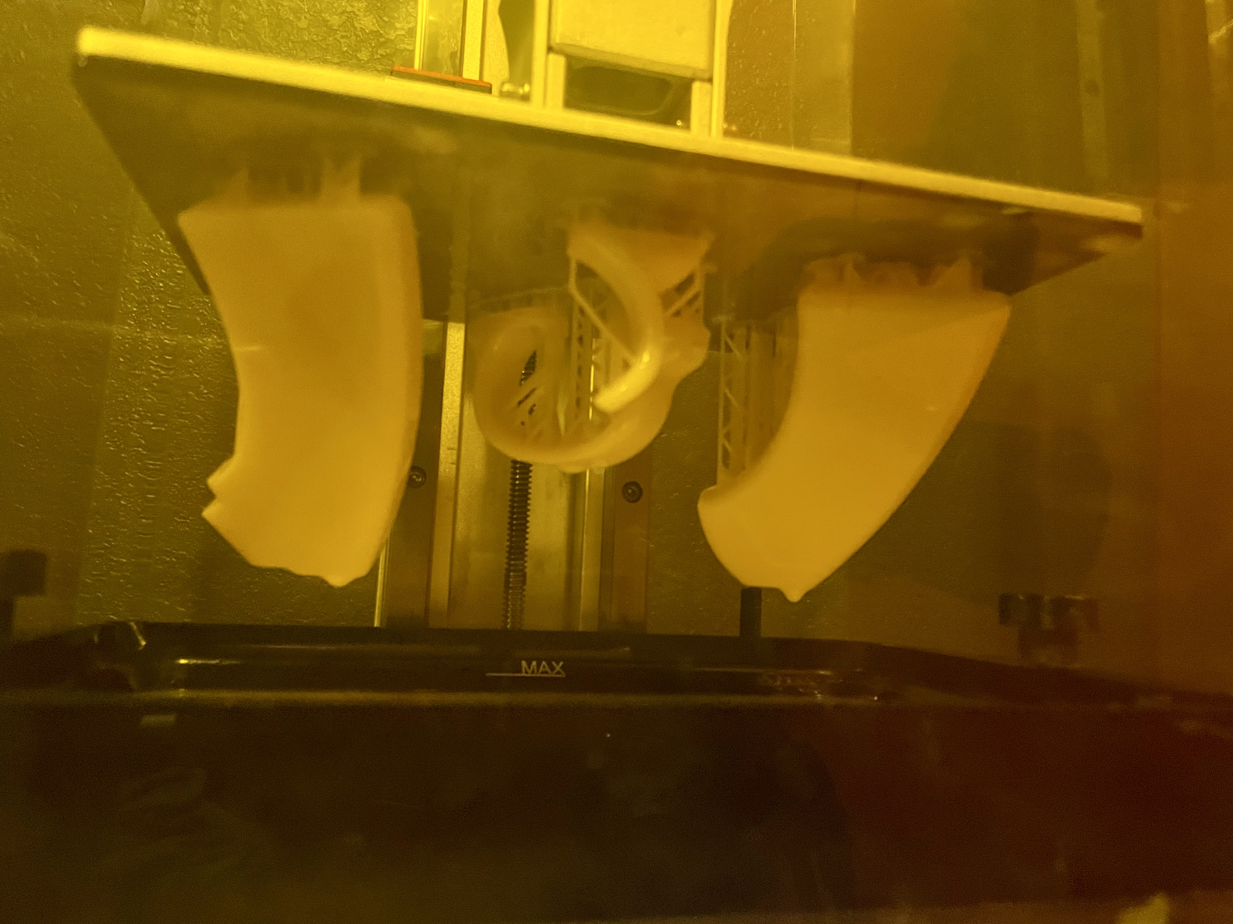

In the meantime, I’m still helping a friend of mine print out parts for his Boba Fett rifle. With the Mega out of commission, I moved over to the AnyCubic Photon Mono X to print some of the smaller pieces.

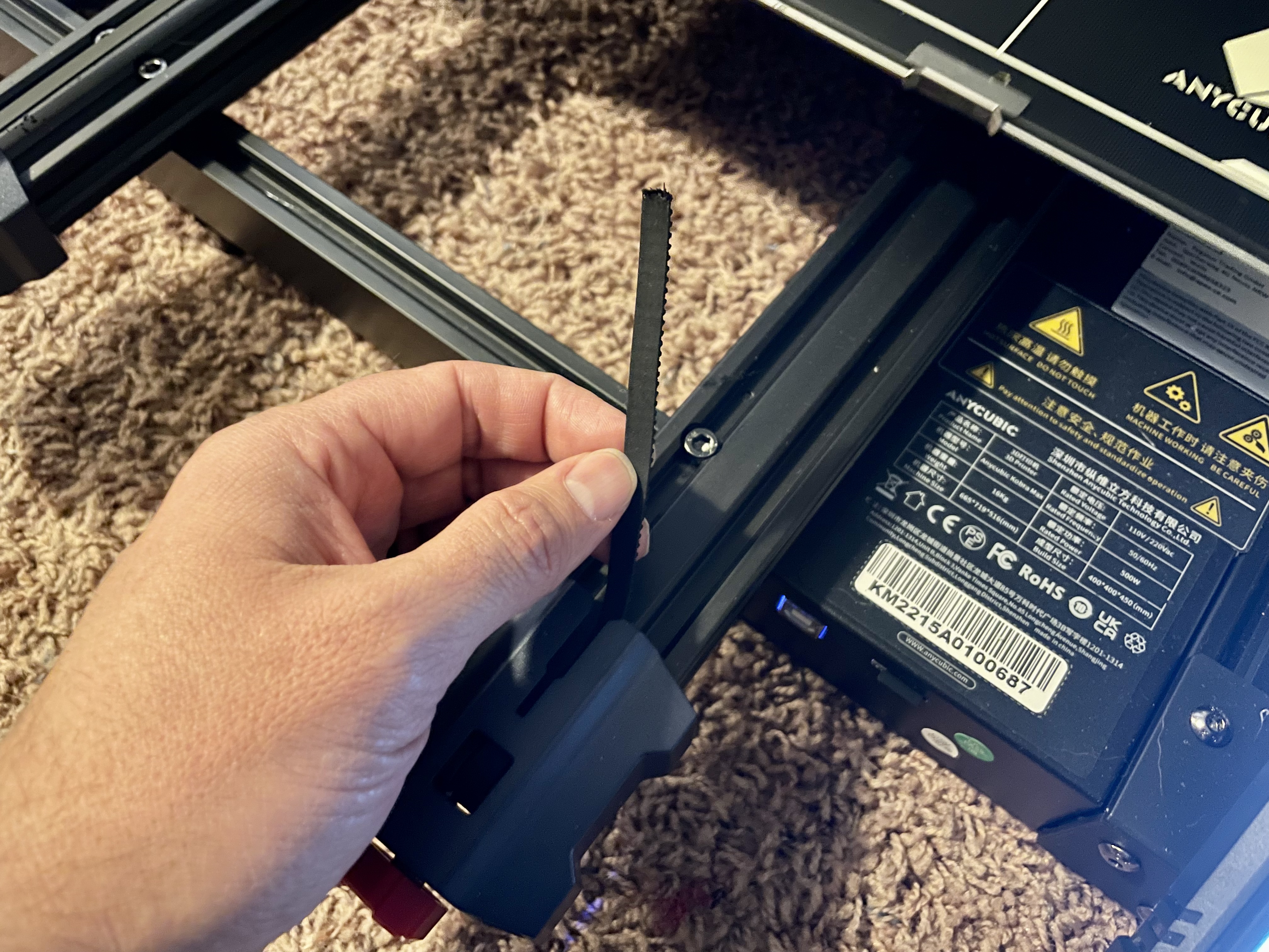

On the FDM side, I was printing some articulated dragons for the kids on the AnyCubic Kobra Max when one of the belts snapped. Somehow, the print managed to finish with only a slight layer shift. As the printer is still under warranty, AnyCubic is sending replacement parts for that…

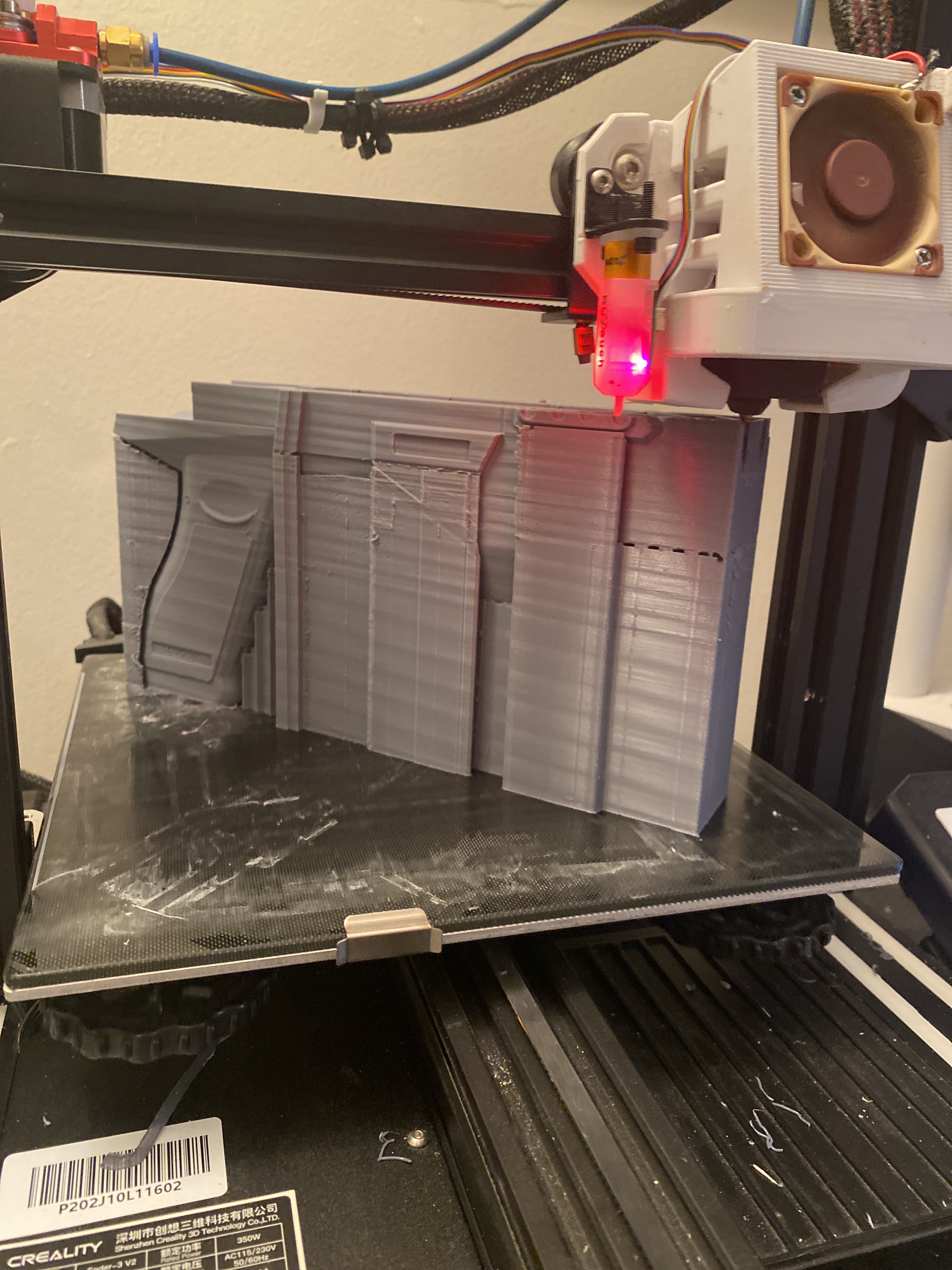

I've been fighting with my printer over the last few weeks. Its been giving me terrible z-wobble and nothing I've done has helped
That is the lawmaker from Props3d's project here on the RPF btw-- amazing project, it will be my first time working w/ arduino and electronic accessories.

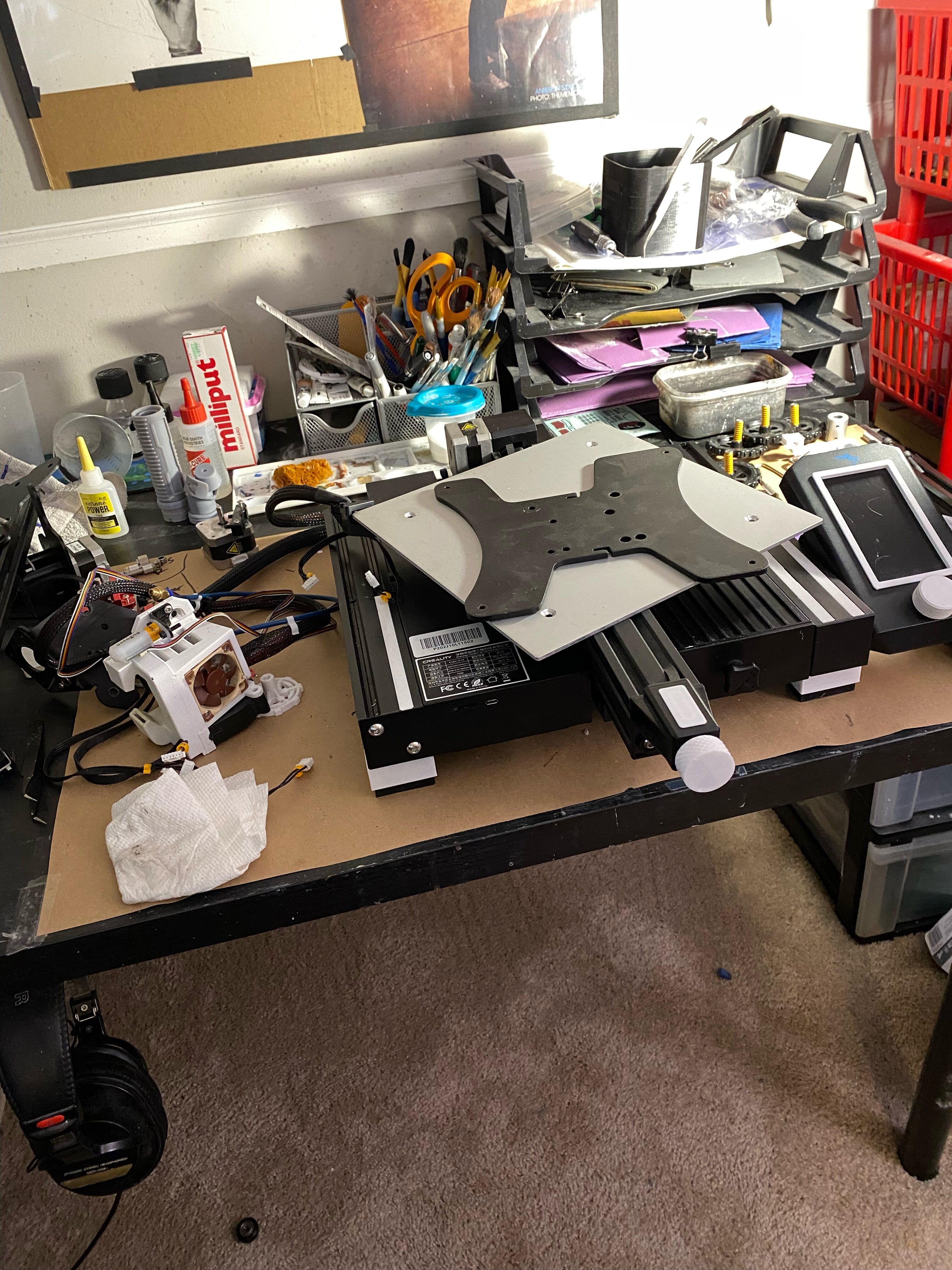

I've had enough of the problems so I've gone nuclear with my printer:
Every roller wheel is getting replaced, nearly every screw has been pulled, and all gantrys will be reassemled and re-squared, and extruder gears are being replaced.
Hopefully this gets it on the right track. Its been printing great for nearly 2 years with minimal fixes, so it's about time for a full maintenance anyway.

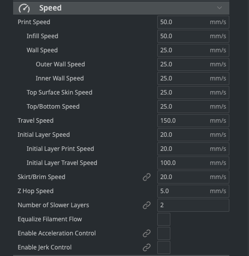

I used the CR-6 SE profile and just adjusted the bed dimensions to match the Kobra Max, and haven't really done much else. I got the printer and immediately had a bunch of jobs I had to do, so I haven't really done any calibrations.
Checking the Cure profile I've been using speeds are set as follows; again, these are likely just the default CR-6 SE speeds:
I'm guessing I could crank some of them up a bit, but as the prints have been looking pretty good (less the busted belt), I haven't really seen a need.

Thanks. According to AnyCubic that model is supposed to work at a faster speed, but doesn't have a Cura profile of its own, yet (I checked a couple of months ago).

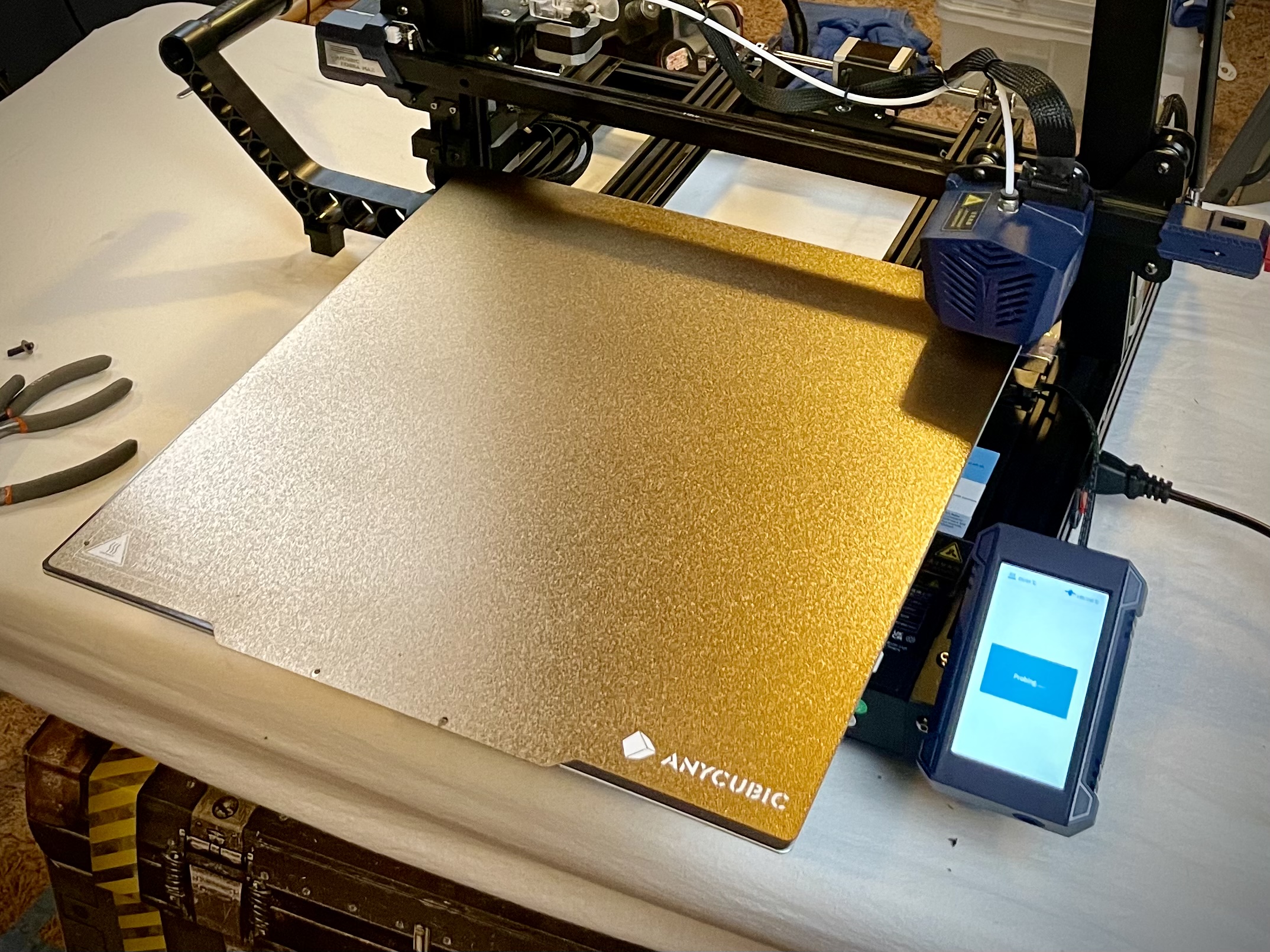

Took some time to get both the Phrozen Mega 8K’s screen and the AnyCubic Kobra Max’s broken belt replaced.
Both replacements were relatively straightforward, although, on the Kobra Max, you have to remove the print bed to replace the belt... That was a bit tedious, but not difficult. I also took the opportunity to put a flex sheet on the Kobra as I’ve broken a handful of the stock glass plates they come with…
Just need to run a test print on the Mega, and we’ll be back in business!
