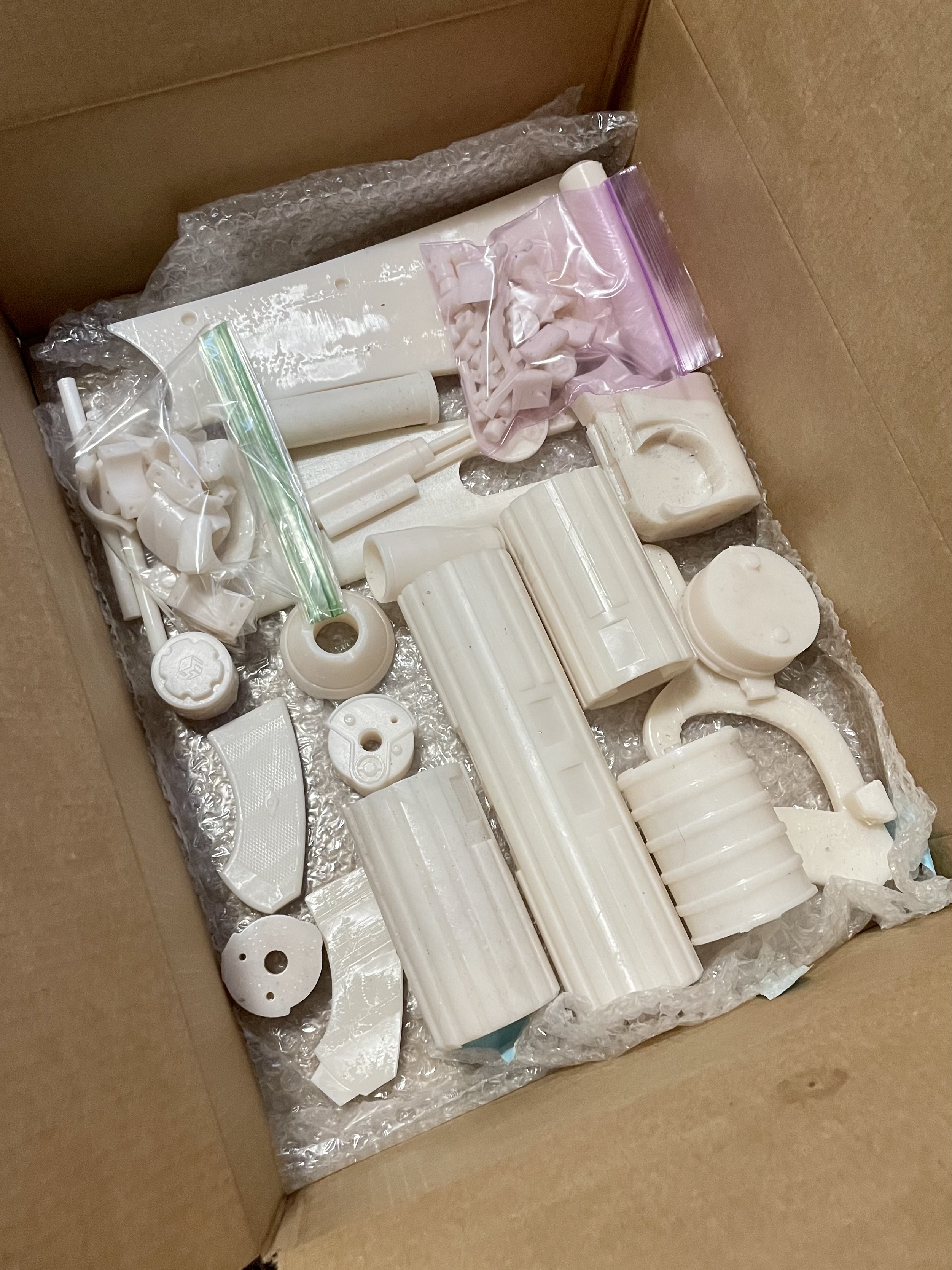

Finally finished printing the Mystery Makers Boba Fett EE3 rifle for a friend of mine who is making a Mando S2 Boba (aka Boba Fresh).
Overall, pretty happy with how things came out, despite the various printer issues I ran into. The Phrozen Protowhite Rigid resin is some tough stuff, albeit expensive. For a prop that’s going to see a lot of handling, I think it’ll do well.
~70 parts in all. Look forward to seeing what my buddy does with it!
