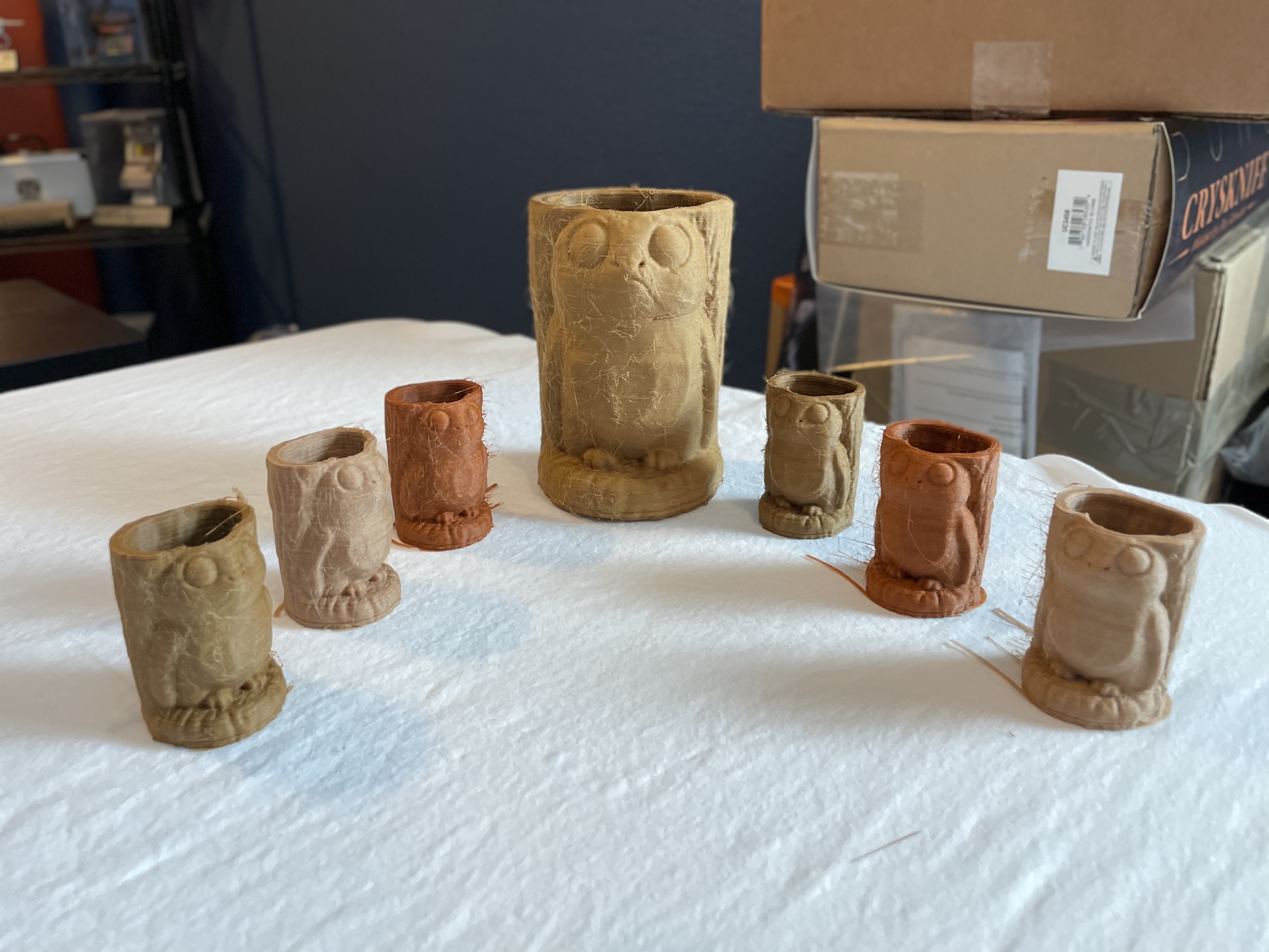

First up are some porg tikis. This is the first time I’ve printed with a wood-based filament, and while there was some stringing, not too bad…

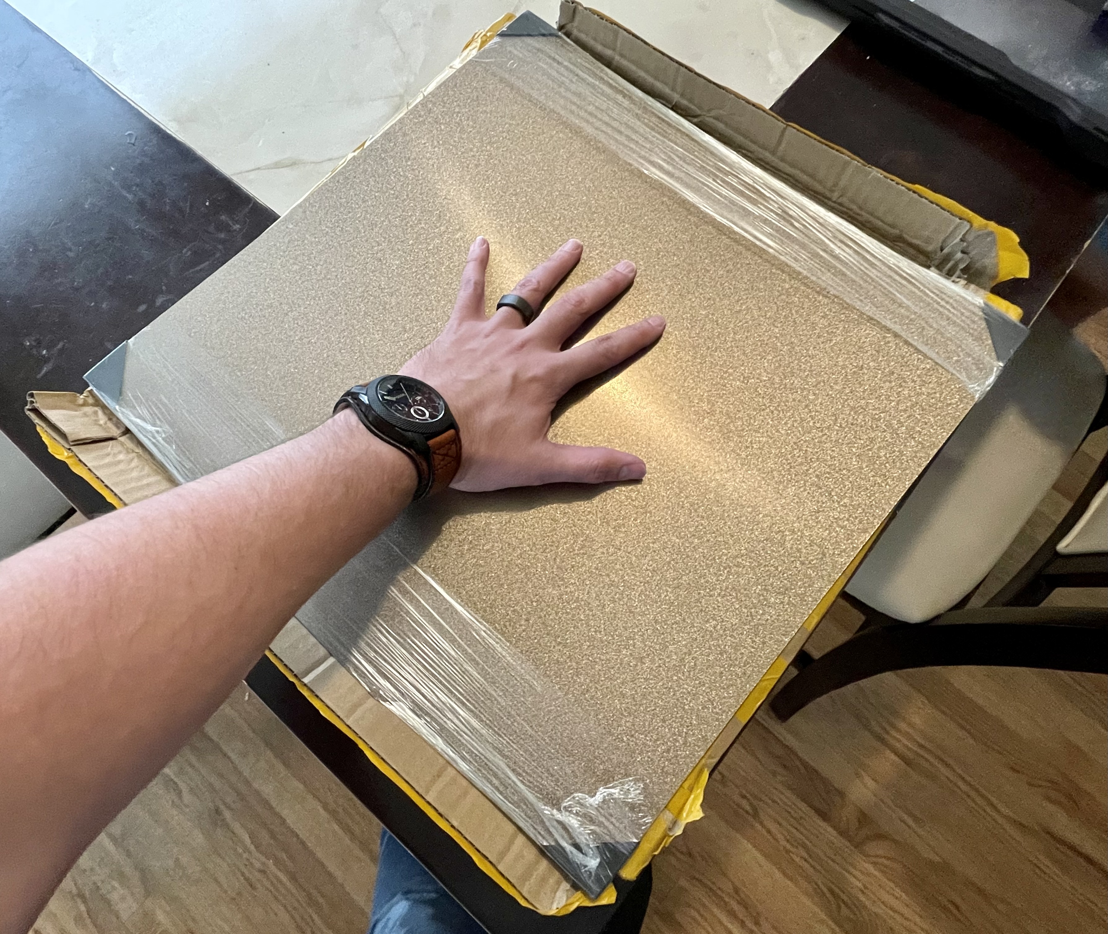

While I love the AnyCubic Kobra Max, I have cracked two of the glass print beds so far...
Don’t understand why they didn’t ship it with a PEI sheet, like the Vyper has, but I found this one online that is close enough in dimension that it should work. Hope to get it installed soon!

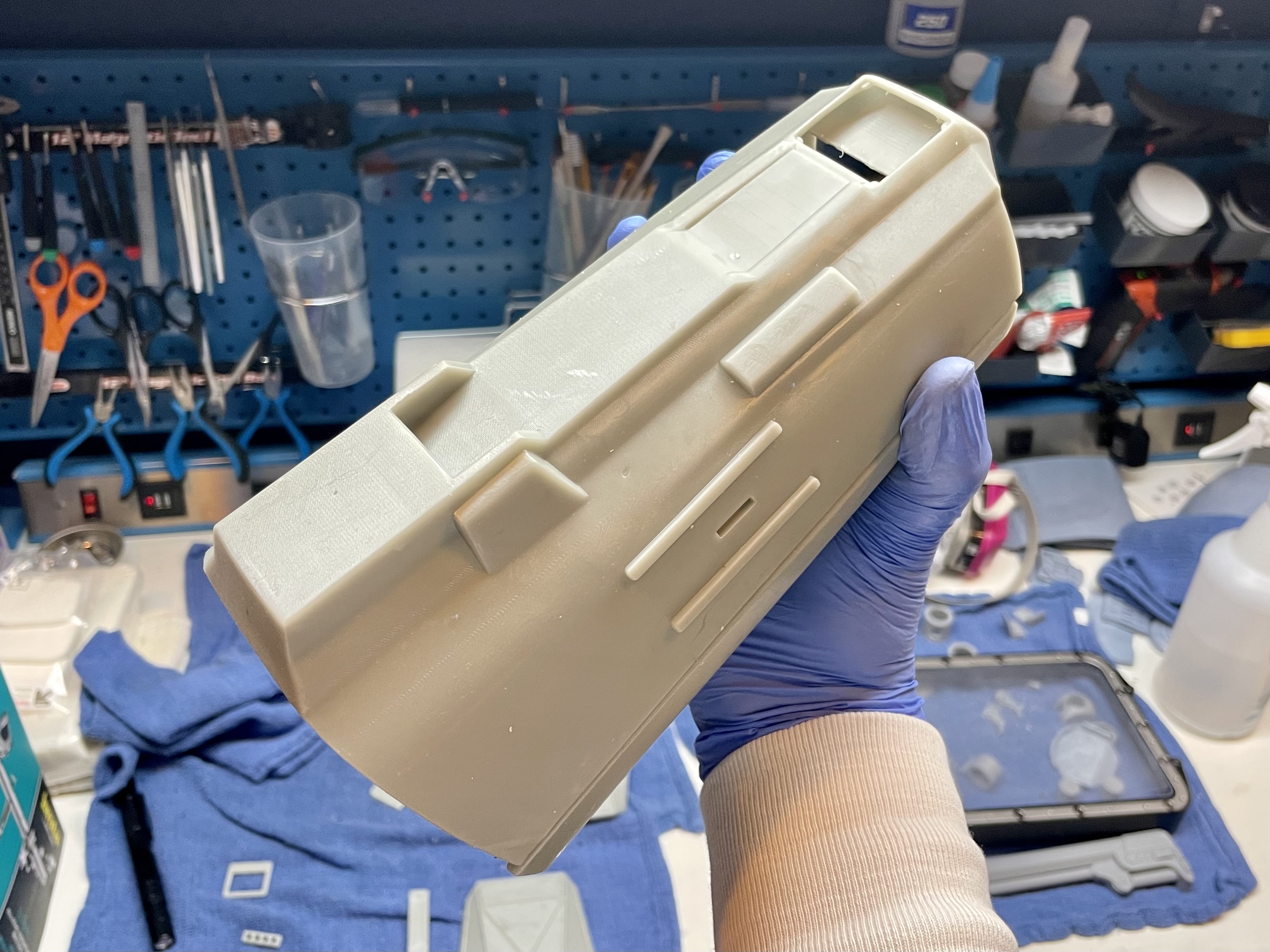

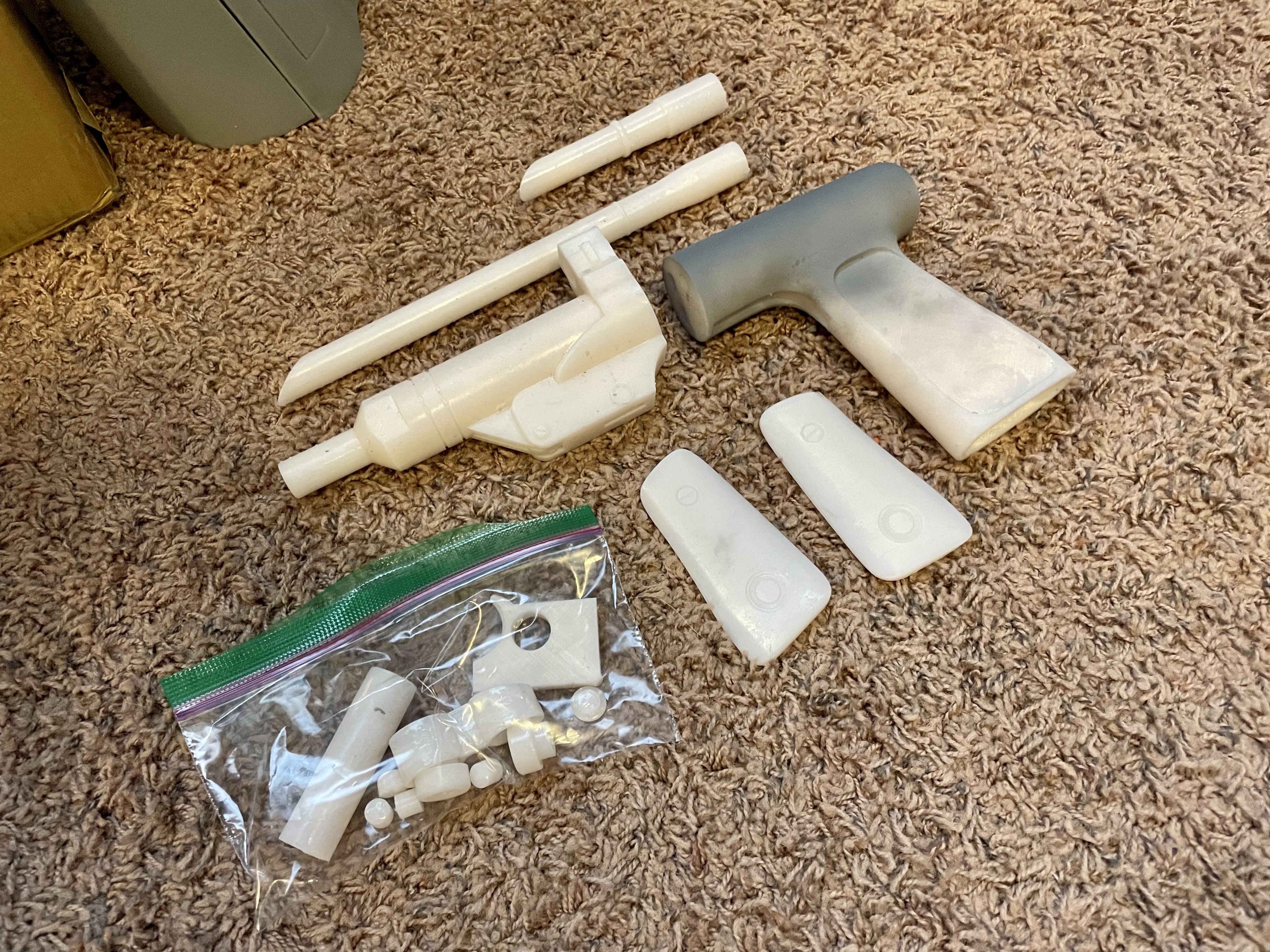

Boba Fett pistol for my friend who is doing a Mando/BoBF build. Printed in Phrozen’s Prototype Rigid resin. The gray on the handle is some primer I threw on to see how it would look.
I haven’t actually finished any printed resin pieces yet, but the brief time I spent sanding and priming that part of the handle was very encouraging!

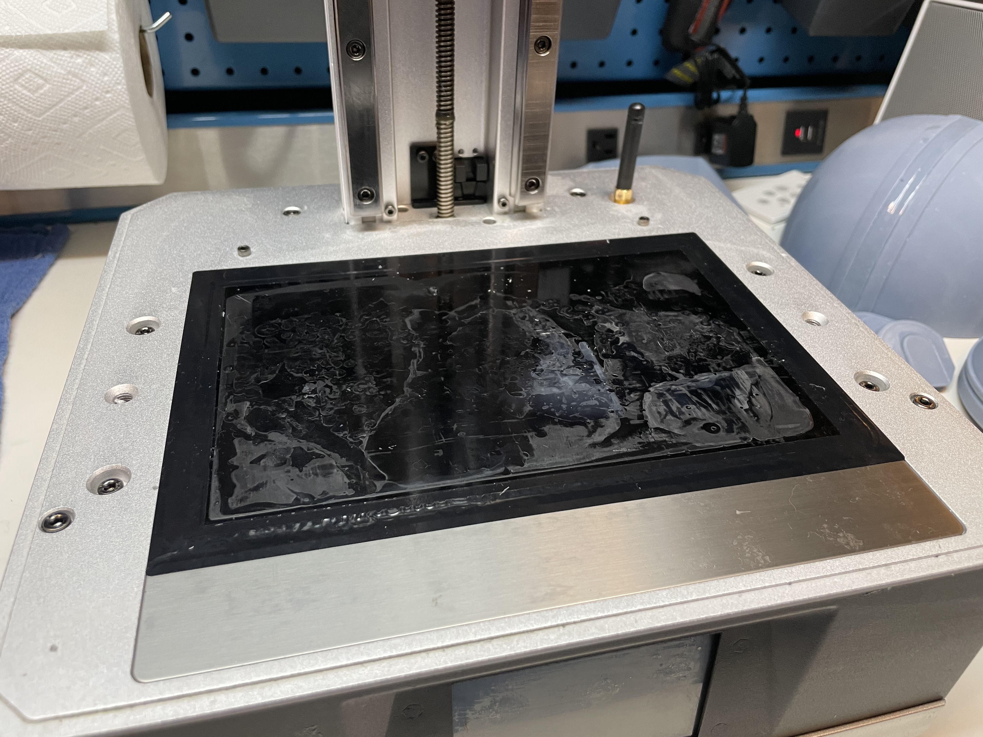

The FEP on my Mono X leaked, and resin got all over the LCD…
I tried all the usual tricks - soaking it in IPA and trying to scrape it off, but I think it was a lost cause.
Let that be a lesson kids - use protection! A screen protector that is!
New LCD from AnyCubic arrived quickly and was surprisingly simple to install! I also threw a screen protector as to avoid any recurrences of the leaking FEP problem…
So new LCD and new FEP for the Mono X! Time to run some test prints…
Sean
Ugh. That SUCKS when the tank leaks.
Really clean straight razors might get it off with minimal scratching, but with it being cured, it's mess.
You might also try (for the benefit of others) some of the glass stove top cleaner stuff. Designed to get baked-on food off glass without ruining the glass... might actually work. I have some (somewhere) but fortunately no tank leaks.

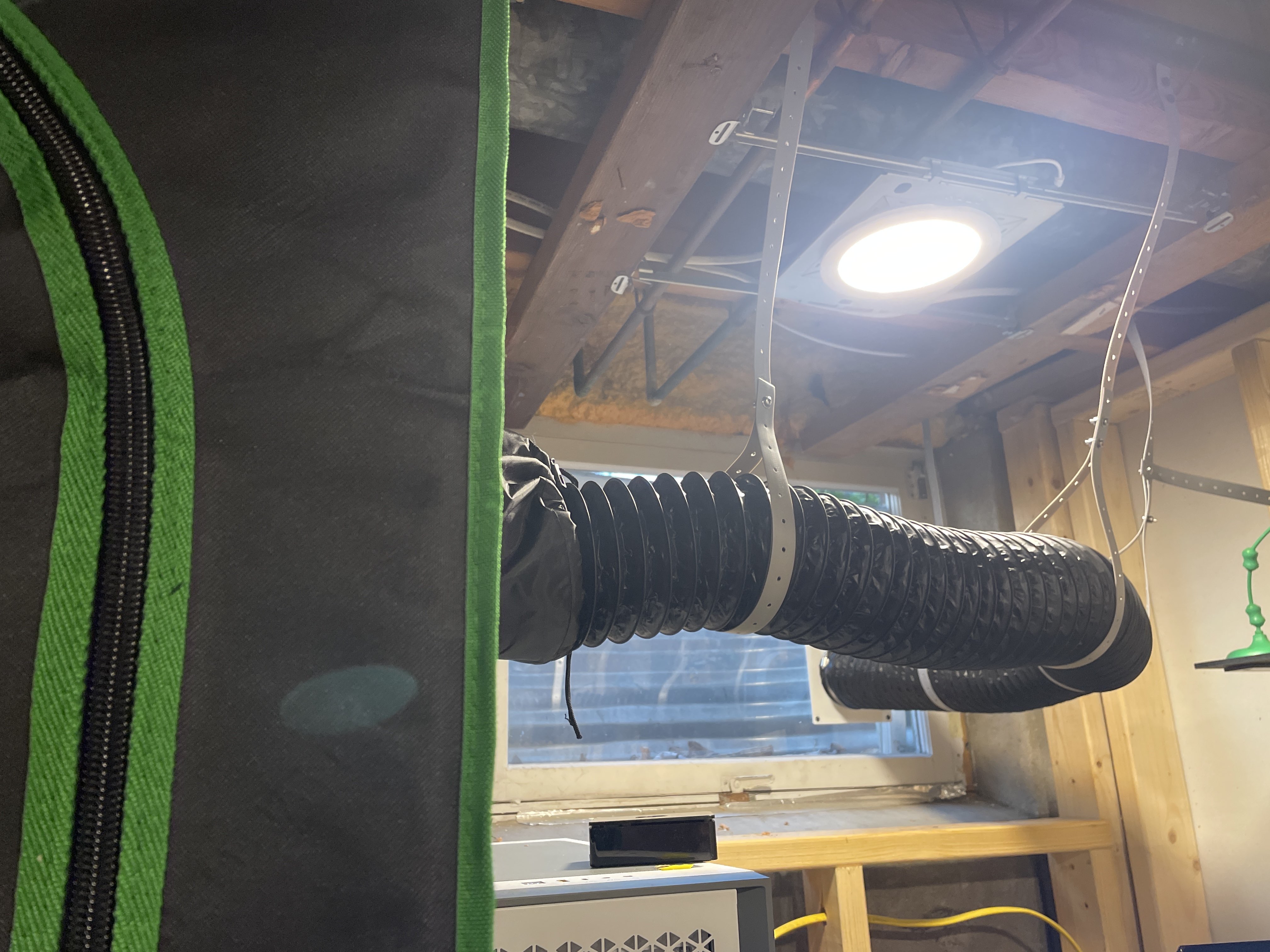

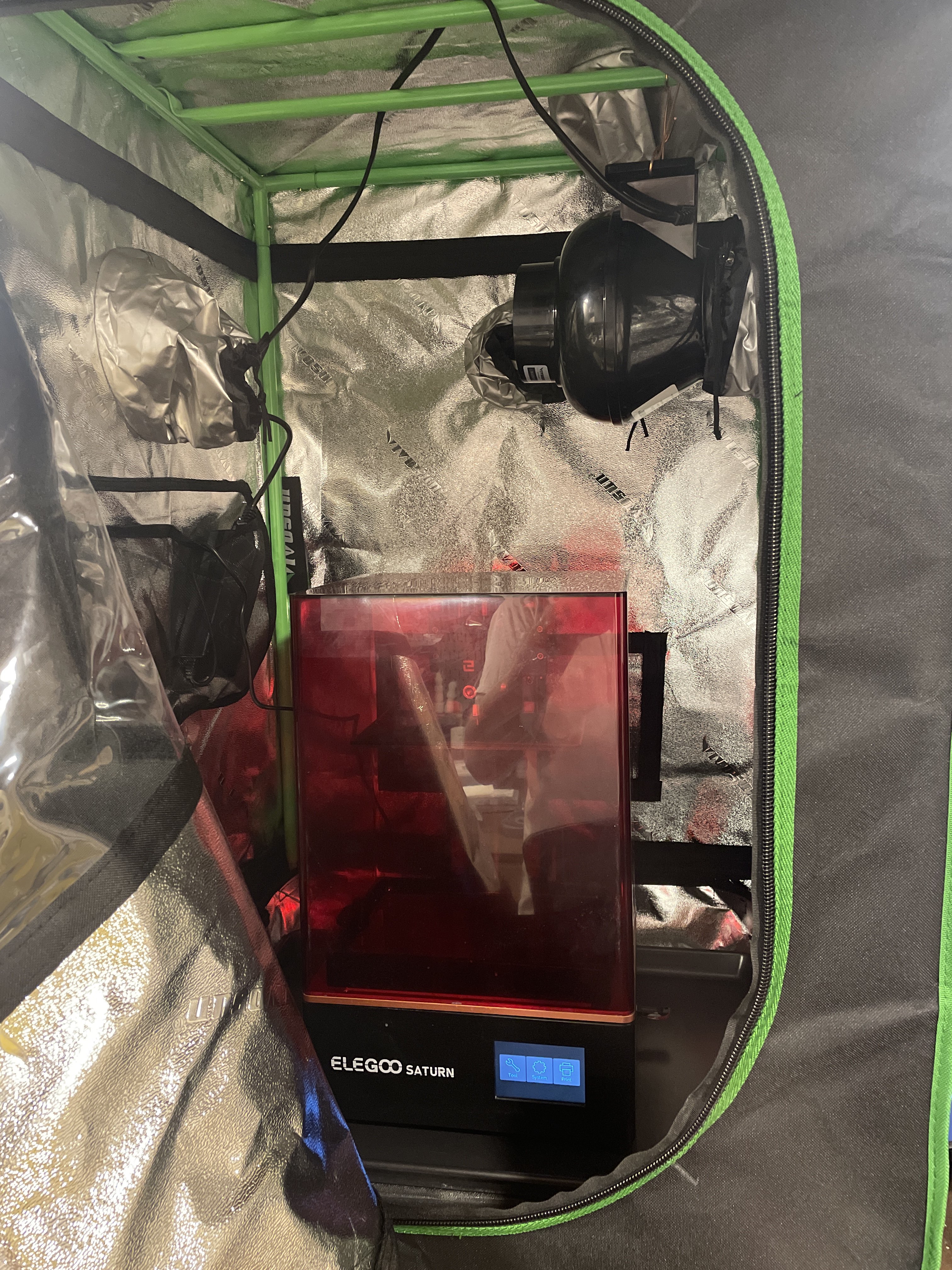

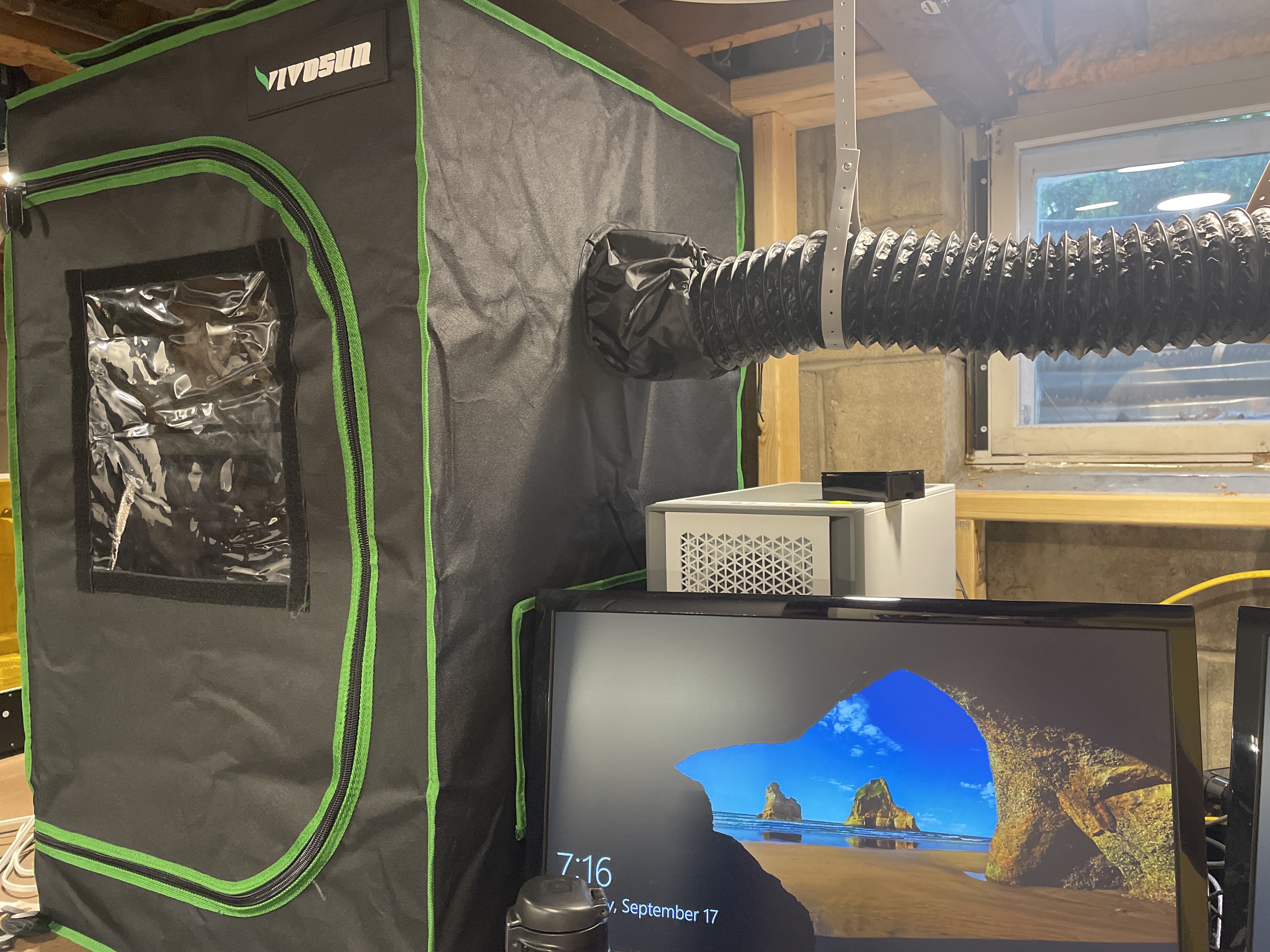

Sean - I hope you don't mind me sharing this. It looks like this thread is collaborative, so I wanted to get this info to folks looking to vent their stinky resin printers.
My shop is in my basement and so my first step was getting a glass repair shop to swap the glass window out for polycarbonate. I then cut a 4" hole and fixed a vent tube mount with 4 screws. I ordered stiff stainless steel screen material and cut a circle shape to affix inside the tube mount to keep critters out. I am using a Vivosun grow tent to house my printer and a Vivosun 195 CFM inline duct vent fan to suck the fumes out. It's a big grow tent, but I have a Saturn so I need to be able to lift the cover up and off. When I upgrade to the Jupiter it will be a tighter fit, but that is a front load setup. I used plastic strapping material to suspend the duct. It's easy to work with and the slight vibrations shouldn't wear on the duct work over time like steel might.
I researched how to do this and found that info is limited. So, if anyone has questions please ask. If I can save you time, I'm happy to help. Here are a few pics:

Sean - I hope you don't mind me sharing this. It looks like this thread is collaborative, so I wanted to get this info to folks looking to vent their stinky resin printers…
Not at all! And great solution! I did something similar to vent paint fumes in my old house. Need to find how to vent my current shop as there are no windows…

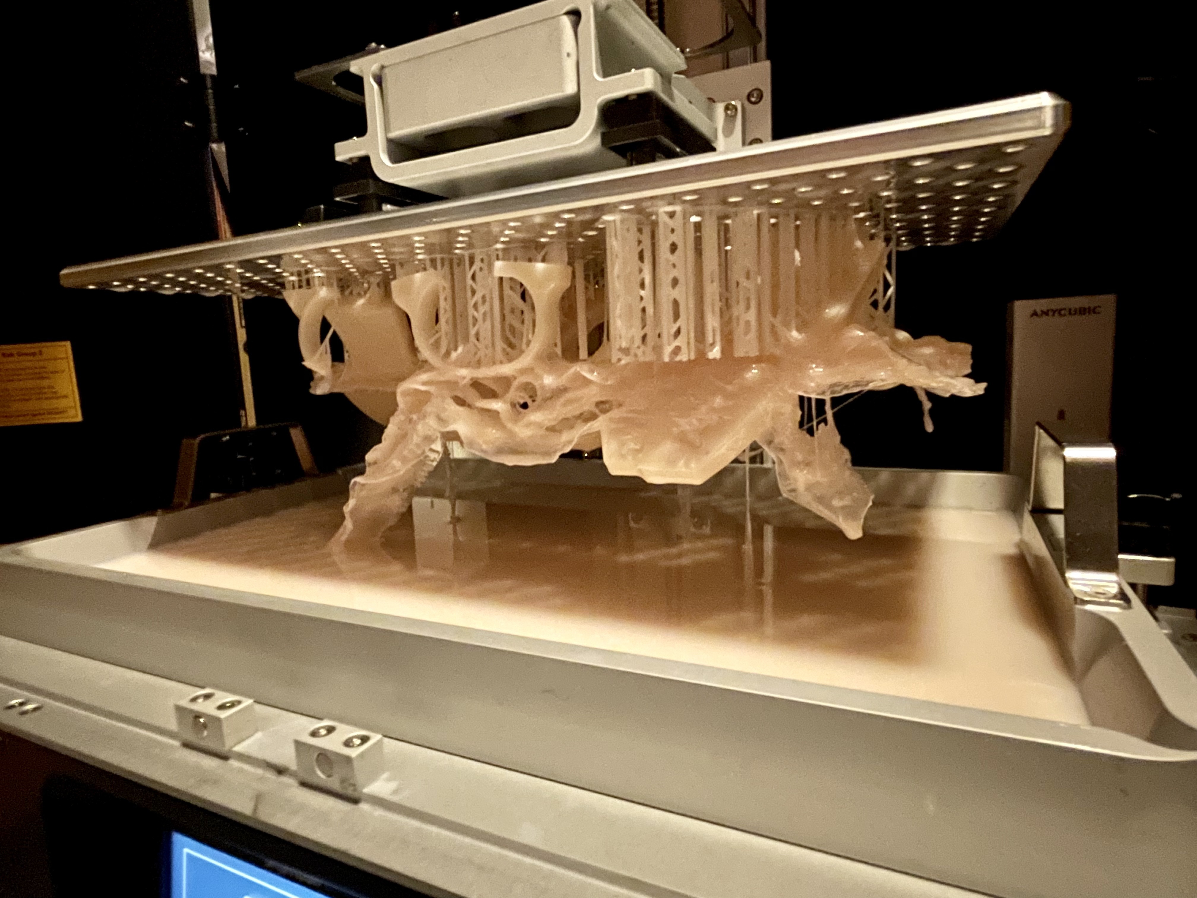

26 hours into the print job... I'd guess it happened about 30 min after I checked it and went to bed. It then proceeded to make spaghetti for the next 8 hours.
We've all been there, even when your printer is pretty well dialed in, things go wild sometimes.
