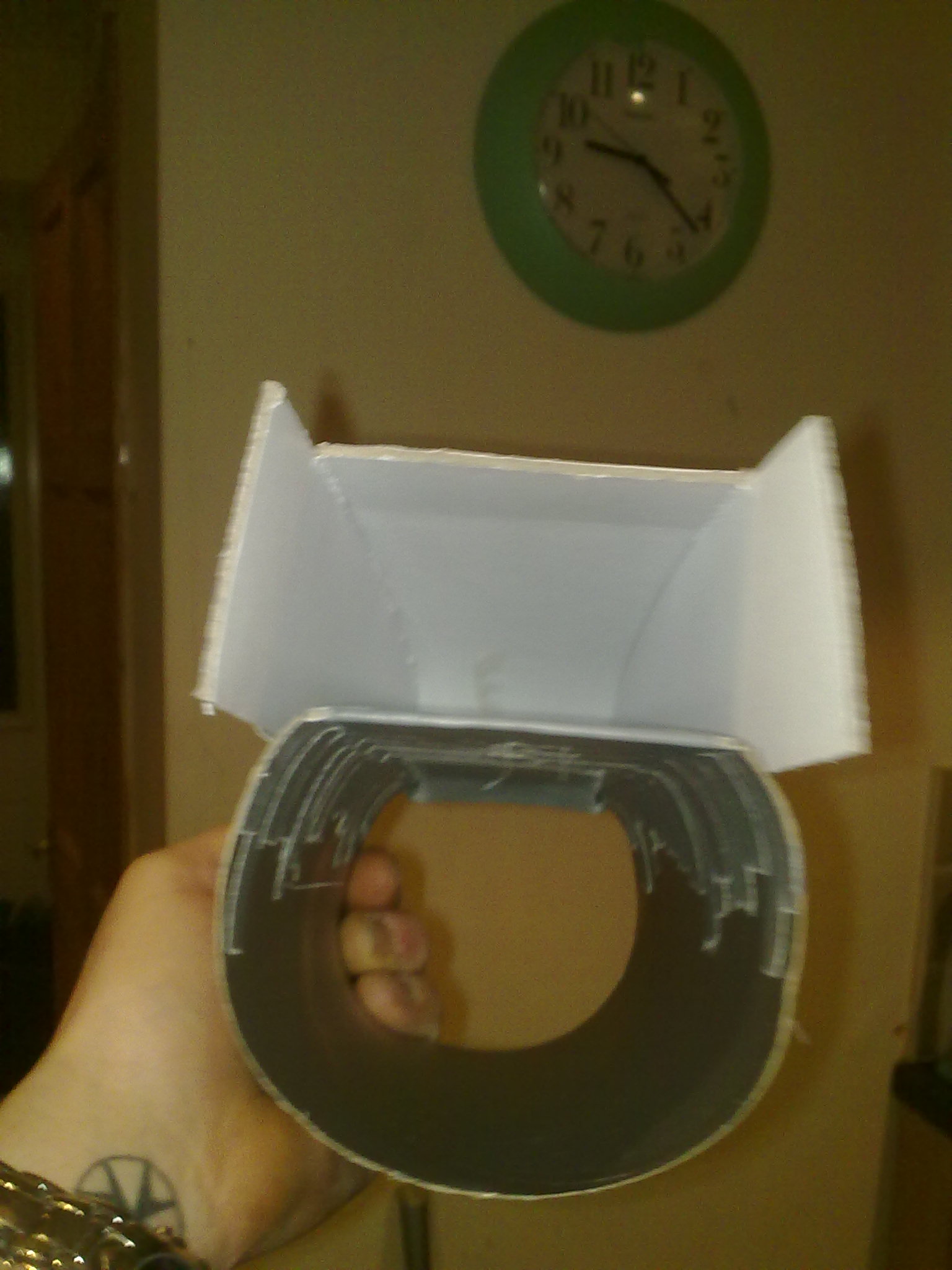

Cut the pringles can to suit the shape & size of your forearm, then tape in a flat piece of card to fill the gap
Attatch card to suit whichever shape you need to take the wristblades, & mount the bomb.

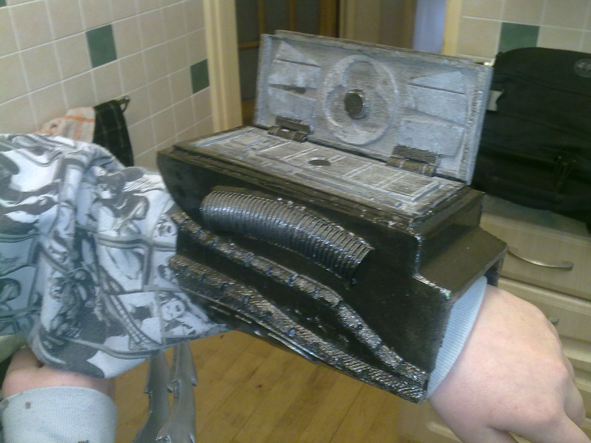

Using Vinmans templates, make the bomb & lid from balsa.......

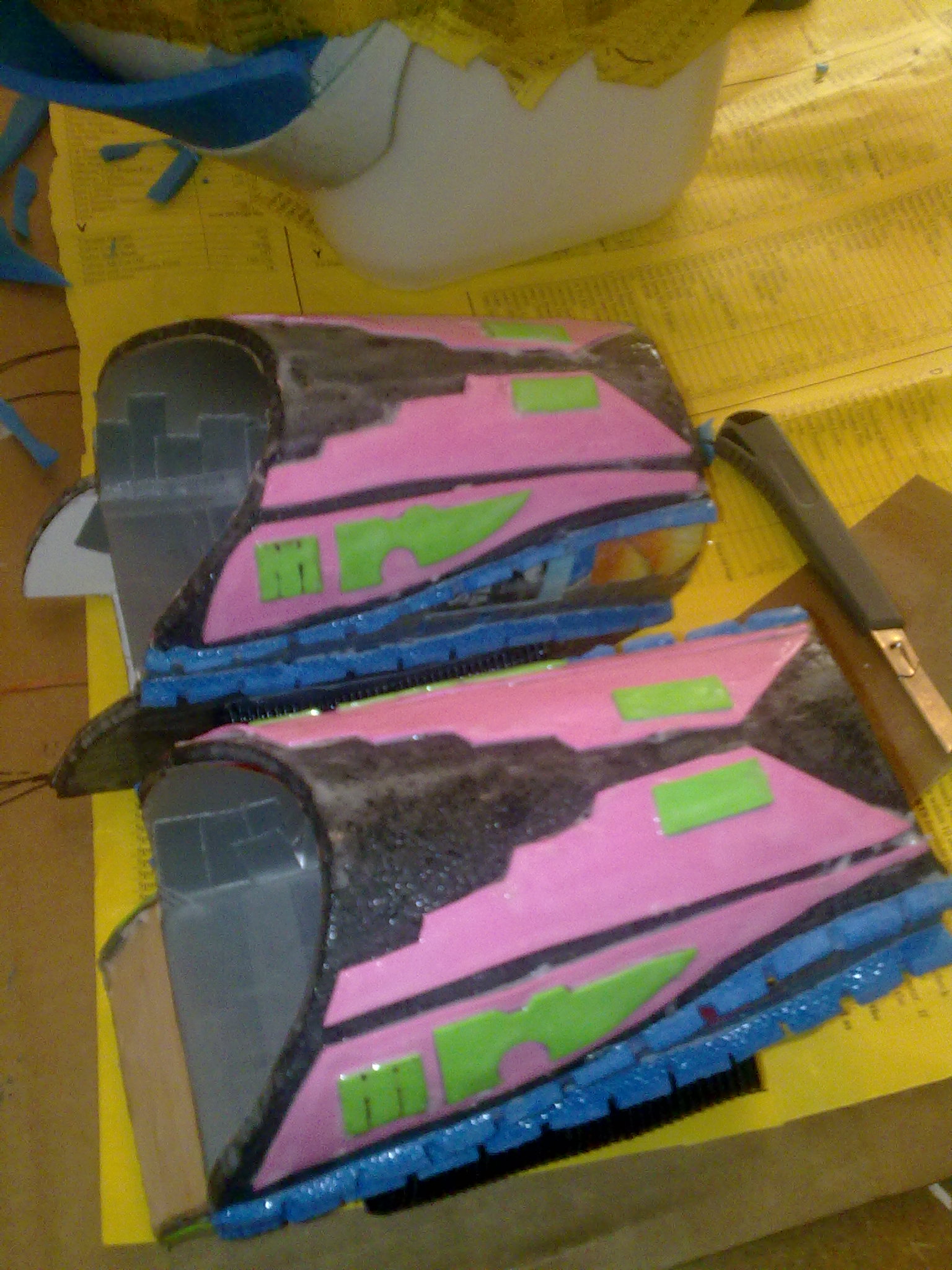

......& also the bath waste, split in two, & the other gauntlet details, from foamies

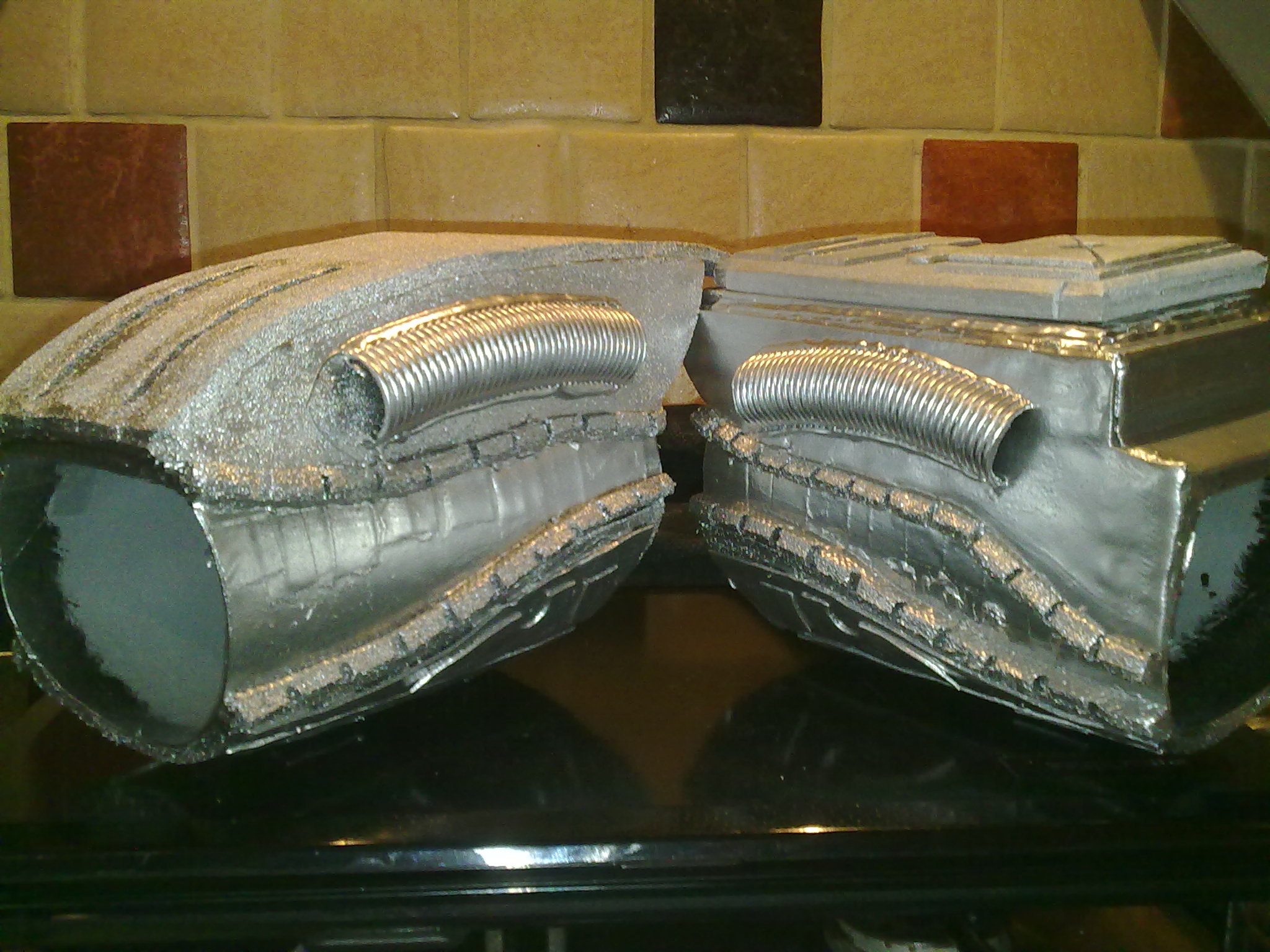

Paint 1st in silver, then with the hammerite

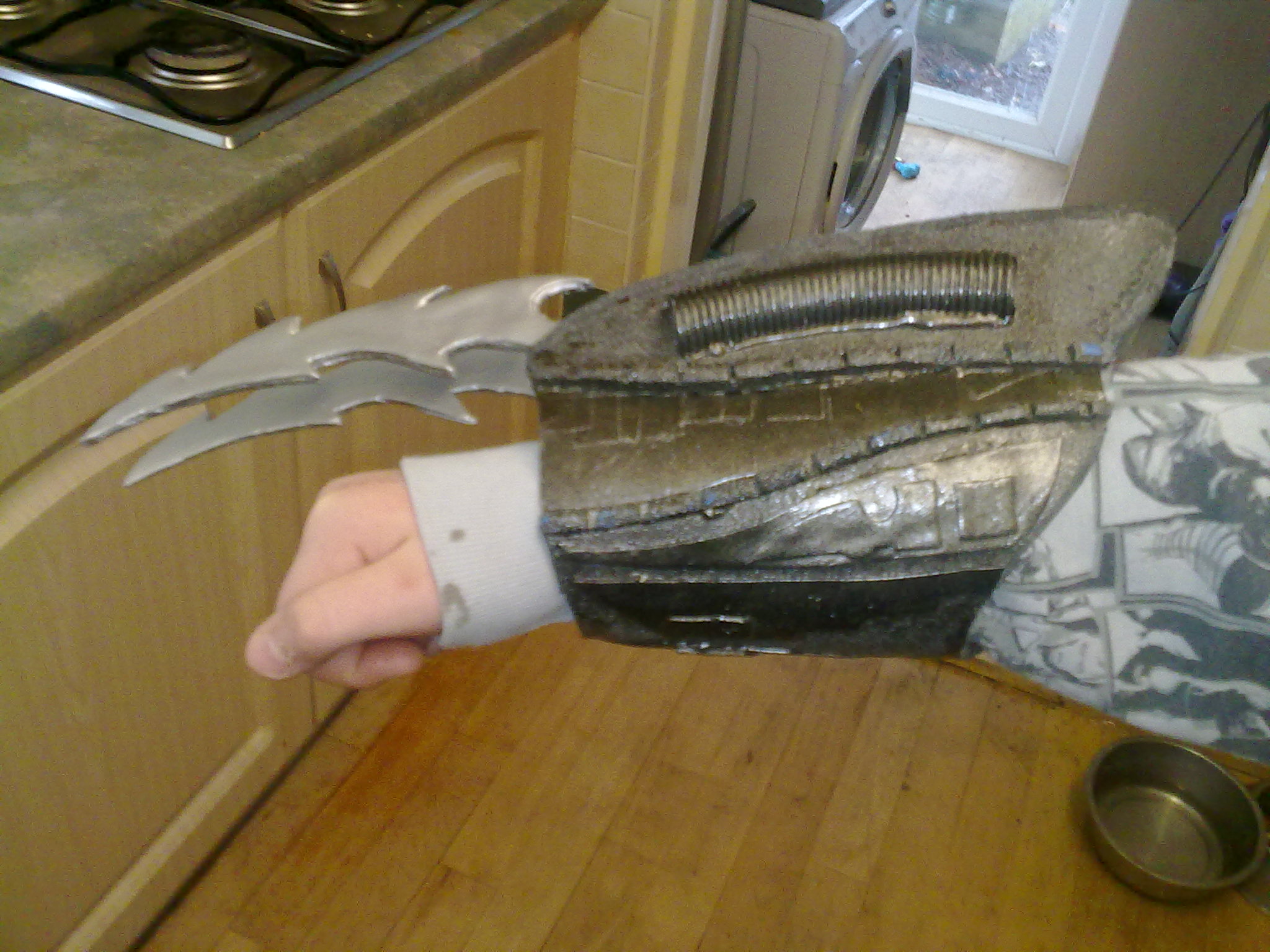

Attatch the wristblades (made from card & foamies)........then get No 1 Son to model them, so you can admire & photograph your handiwork!
