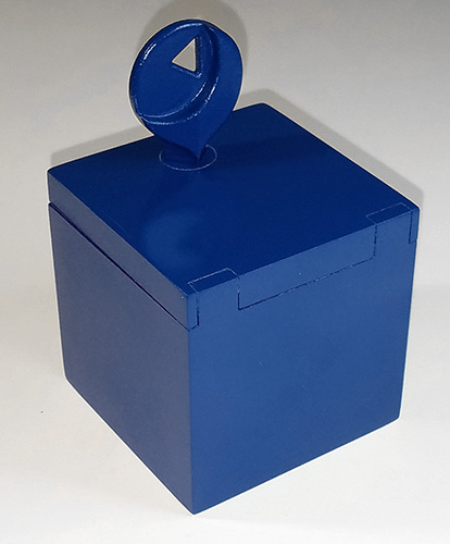

Hey SquidMan, glad you like the key! I sweated a lot over the 3d model, working from dozens of HD screen grabs.
When I finish a model I've had printed at Shapeways, I use a liberal slathering of Liquitex modeling paste on if first, then a lot of sanding before painting. It's made from marble dust suspended in a gel medium, dries quickly, and sands super smooth. Then I just hit it with gloss royal blue spray paint. It's not perfect, so if you come up with a better paint, I'd like to know!
Thanks!
Beej
Thanks!
Beej

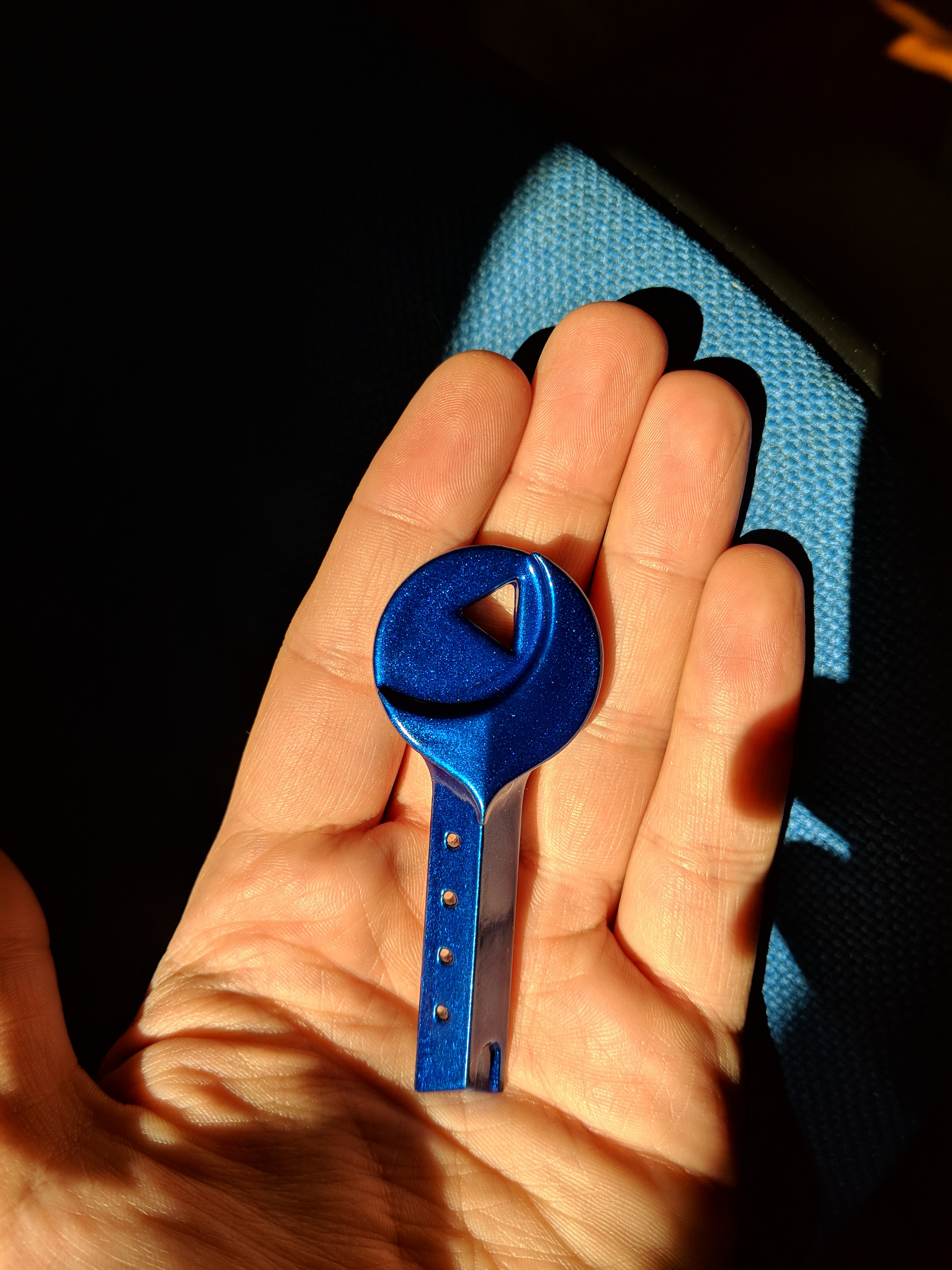

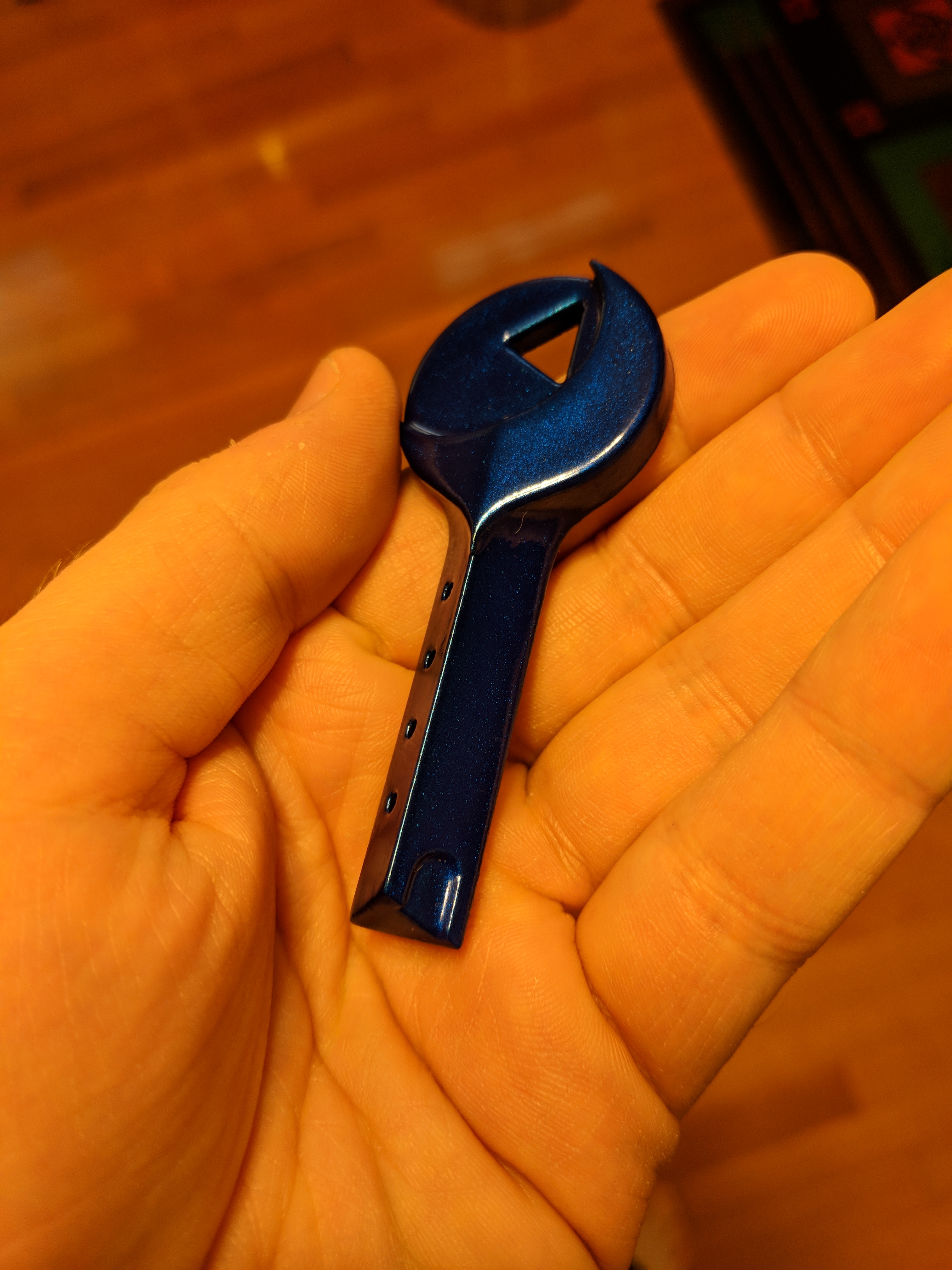

I used a spray can of Tamiya 86016, Metallic Blue on the Shapeways key after a bit of sanding and filling, and it turned out great!
It's about the right hue, but it doesn't look metallic. I don't want to go with a metal flake, but there's a certain "shimmer" missing. I just used a Krylon royal blue, and it looks OK, but not magical. I may try a clear coat to give it more depth.
Ah I see. It's definitely not metal flake, you're right. But it has that distinct metal look somehow.
Can we see a pic?
