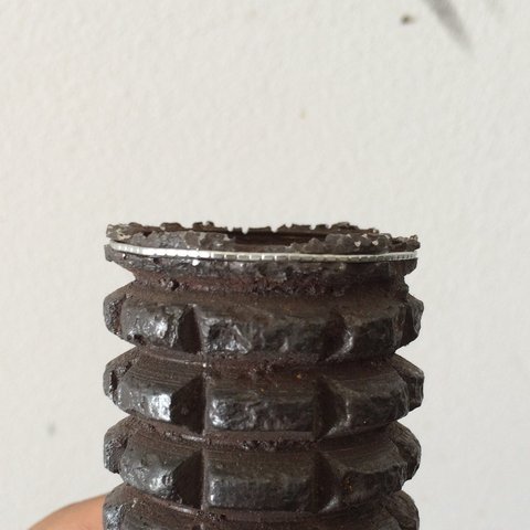

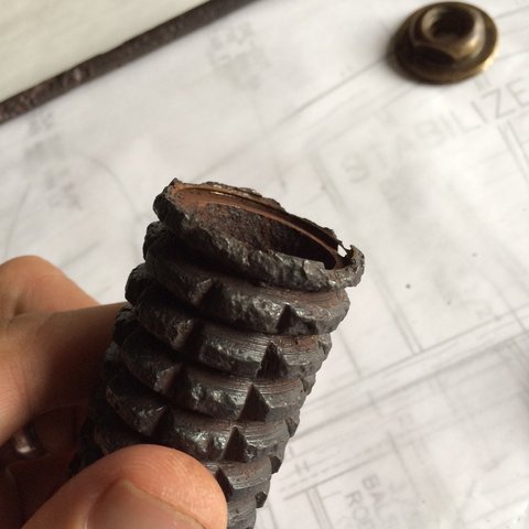

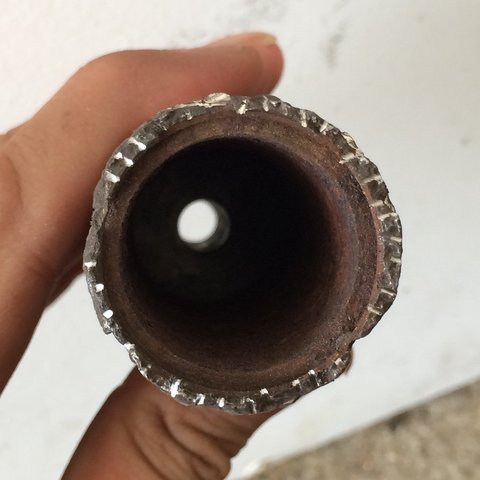

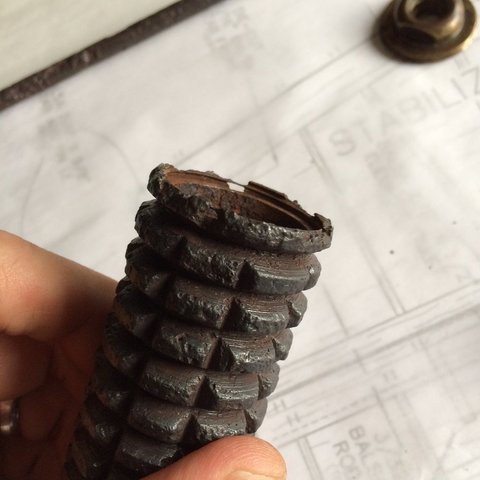

I have finally gotten around to tackling the top end of this Hales No.3 Mk1. The end of the fragmentation body that sits closest to the Graflex clamp on the OB1 ANH is actually the top end (or front end when in flight) of the rifle grenade. It comes naturally with a brass plate that threads into this end of the frag body, just as the brass neck that holds the windvane has a plate that threads into the other end of the frag body. On the OB1 ANH, this top brass plate/disc is removed and unused...at least that's how I had mine.

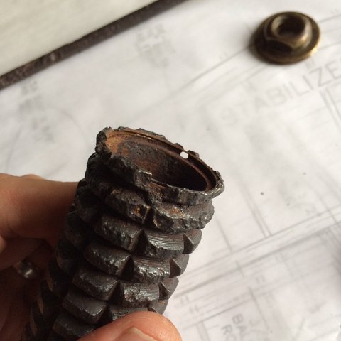

The issue with the top end of this particular frag body is that is extremely deteriorated. It's not just pitting. Pitting would match the rest of the frag body and there would be no need to attempt a repair. This is far beyond pitting with portions of the steel frag body missing from this lip having corroded for a century in the French countryside...not entirely unlike what happens within the Sarlacc pit. Here are some close ups of the end of the frag body:
It's like the little thread that wouldn't go away.
A quarter turn.
Another quarter turn.
And the final quarter turn. As you can see, even though this grenade has fought aging like a champ, there's some things 100 years int he ground will do to you.

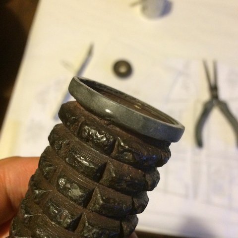

PLAN A

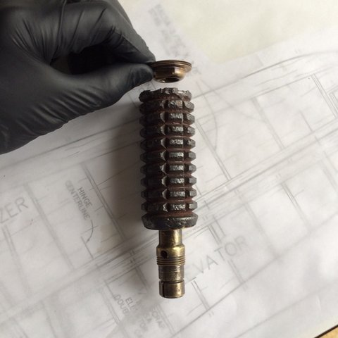

The first thing I did was to attempt to remove any small bits of steel that looked like they may come off on their own within the next couple of years. Surprisingly (but I guess it really shouldn't have been) no little pieces would be removed. I used my fingernail to try to pry the tiny pieces off. Next, I cleaned the edge of the frag body per the JB Weld instructions. I then "roughed up" the edge with sandpaper. It really didn't seem to do anything to the steel.

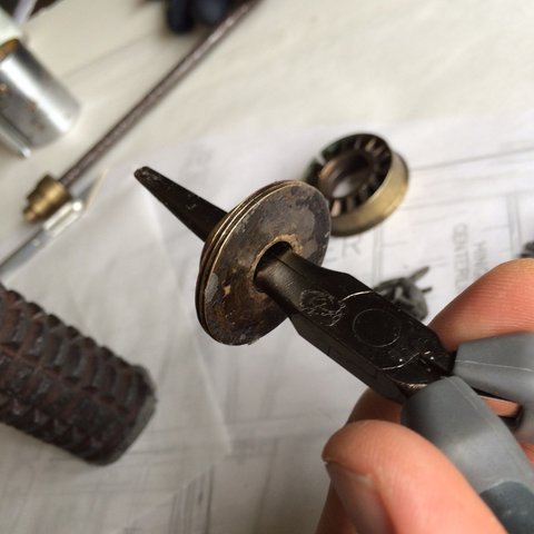

The next step was to insert the brass plate into the frag body. Here is the way the plate is typically oriented with the frag body:
However, for what I was about to attempt to do, I flipped the brass plate to screw it into the frag body like this:
The reason for inserting the plate upside is because I want my build up of steel compound to be absolutely flat on this edge, so that it sits perfectly flat against Roman's clamp spacer. By screwing the plate in upside down, and then standing the frag body up on that plate, I can insure that the bottom will be flat and uniform when I smush the compound against the frag. Be sure to stand the grenade up on the baking paper.
ALSO, I had to spray the threads of the brass plate with the White Lithium WD-40 lubricant so that the compound would release the brass plate once the compound began to cure. This had to be done sparingly, and I even wiped the brass plate down several times before attempting to screw it into the frag body:
DO NOT SPRAY THE LUBRICANT ONTO THE FRAG BODY.
The compound needs to adhere somewhat to the frag body, so spraying the lubricant onto the frag body is counterproductive. I then screwed the brass plate into the frag body. You can see in the next photo how this gives us a nice flat somewhat clean base for stability:

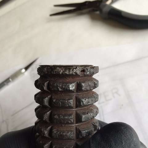

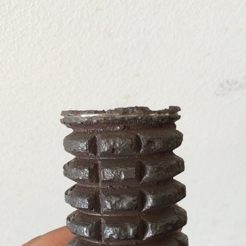

Here is the side view:
And threads are exposed due to the corrosion...
An even nastier hole that needs to be filled (that’s what he said...)
And this side isn’t absolutely terrible in comparison to the rest of the edge.

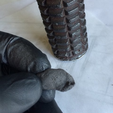

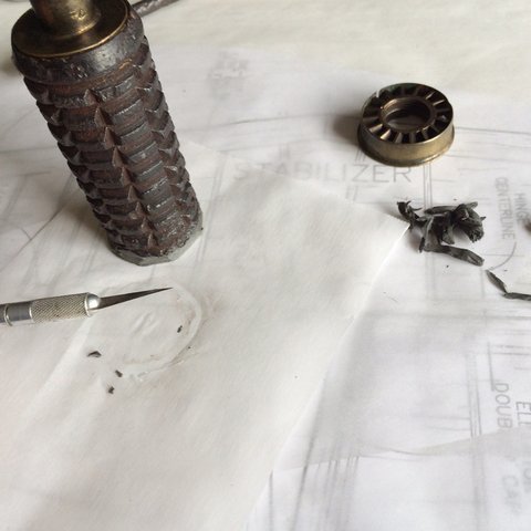

Then, I cut off a 1/4" slice of the steel stick:

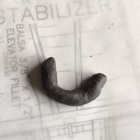

Then I smashed it between my fingers for about 30 seconds, and wind up with what looks like a dark metallic clay:

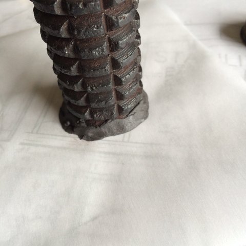

I then broke this clay finger into smaller pieces and pressed these pieces one-by-one into the crevices between the frag edge and the baking paper. Once I was satisfied that enough JB Weld was in place and that I thought it was secure enough, I would rotate the grenade and add the steel compound to those crevices:
First this side:
And then this side... all the way around.
After waiting a minute (and no longer than that), I used the X-acto knife to trim away any areas of the compound that I knew were in excess. Waiting any longer to trim the compound makes for a very difficult time, even with a razor sharp blade because there is steel dust in the compound:

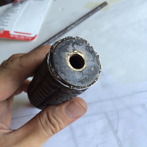

At this point, my plan was to allow the full cure time to transpire, and then I would file and sand away any minute areas of overage. But first, I took my needle nose pliers and removed the brass plate by unscrewing it:

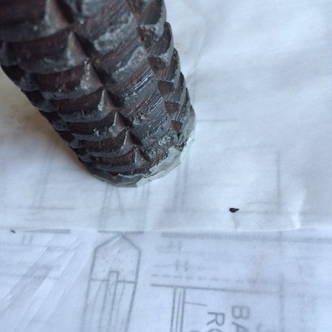

Then I inspected the flat edge I had just made with the compound:
So, it isn't perfect, but again, this end will be hidden to a depth of roughly a 1/4", so it doesn't need to look perfect. I then allowed the compound 2 hours to cure. The packaging says it only needs an hour, but I needed to go to the grocery anyway.
TESTING THE GOODNESS
Once I felt that it should be cured enough, I began stress testing the compound. First I screwed the brass plate back in and all went smoothly. Good so far.
Next, I tested the strength and rigidity of the compound by picking at it with my fingernail. The compound did not fare well:

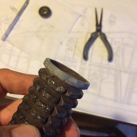

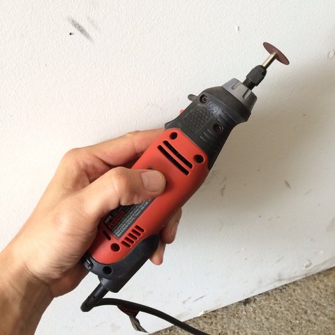

My new plan was to add a small metal armature to be seated within the compound. To do this, I used a paperclip. A small paperclip. An added bonus was that the particular paperclip that I used had little notches along its entire length, which is better for gripping the compound. I unfolded the paperclip and shaped it into a rough circle with the diameter of the frag edge. I then used my rotary tool with a cutting disc and cut a paperclip-thin trench around the lip of the frag:
All the way around:
For redundancy, I also cut grooves into the very end of the frag:
I then wrapped the paperclip around the frag and seated it into the rotary tool trench:
The paperclip itself was not long enough to go the whole way around the frag, so I positioned it so that both ends of the paperclip started/finished in the most complete section of the frag:
Next, just like before, I screwed the brass disc back into the frag:
I mixed the JB Weld Steel stick:
I applied the compound just as I had the first time, but this time the paperclip (once the compound has hardened) would give great reinforcing strength to the compound. After a minute of curing, I again took the X-acto knife and trimmed the excess:

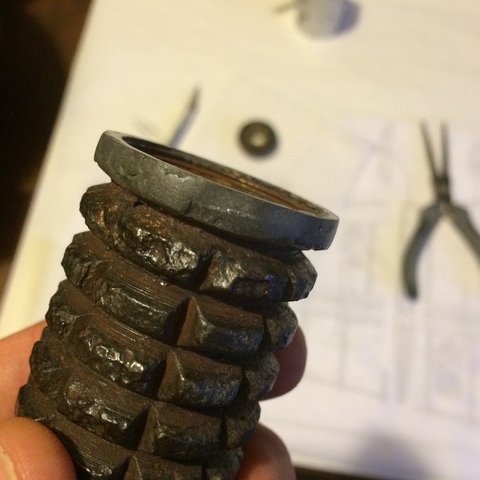

This second time, I really went slowly with the trimming in order to avoid as much filing/sanding as possible:
I then removed the brass plate:
The bottom is looking good (that’s what she said)
I then left the grenade again for three hours this time. I believe it helped. I think the paperclip and the notches also helped immensely. Next came sanding!

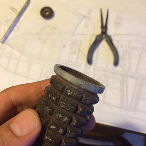

FINISHING TOUCHES AND WRAPPING THINGS UP

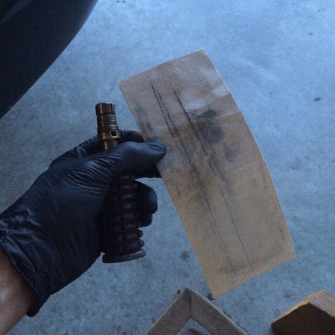

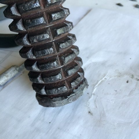

The sanding was done very gently, very slowly, and very lightly. I sanded the compound for probably 20 minutes with three different grits of paper.
I actually did not end up needing to file it. I think it came out well:
Of course, the color is a bit off, so I put some oil on it:
And here is what it looks like in the clamp, on the spacer:
And turned:
And all together again:
