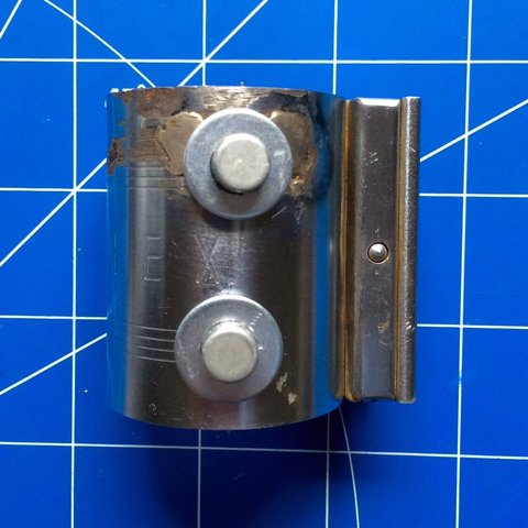

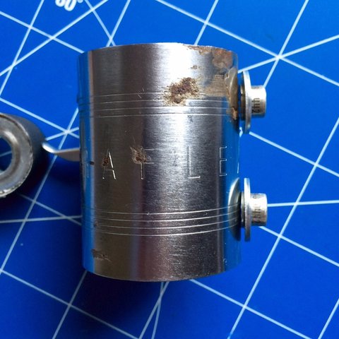

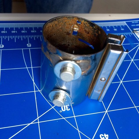

Here is the side with the lever.

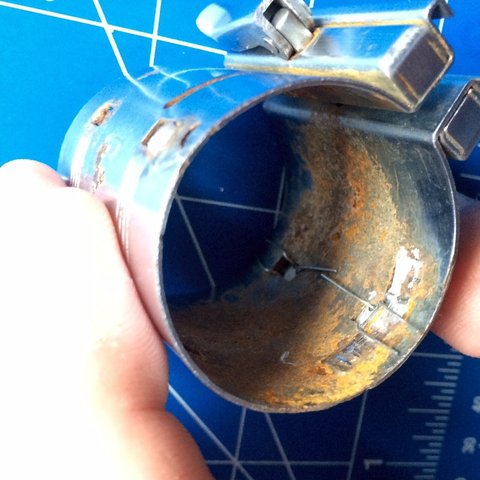

You can see already from this side that there is some major corrosion and flaking of the plating. There is also what appears to be some sort of crap repair that was attempted on the upper hole.
Turn it a little bit:
And still more corrosion. From this view you can also see a bit better what I was referring to regarding the washers. Too wide?
And one more better pic of the best repair part of this clamp:
Don't ask me what happened to this clamp. I really don't know. On top of that, I can't even say whether the person that did this did a good job or a completely disastrous job. To be completely honest, I'm not even sure this is a 100% authentic Graflex clamp! But I really like what it does for the "relic" tone I'm giving this OB1.
As you can also see, the transistors have not really been weathered at all. Once I settle on how I am going to permanently affix them, I will weather them more.
I really do love how this clamp looks though. I did attempt to clean it up a bit as I was going to use this as a test subject for my nickel plating experiments, but as I got going with removing some of the rust, it dawned on me that this is the most relic-like clamp I've ever seen. And not to worry...I didn't get all of the rust removed:
Haha this side is even better:

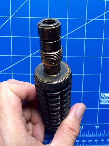

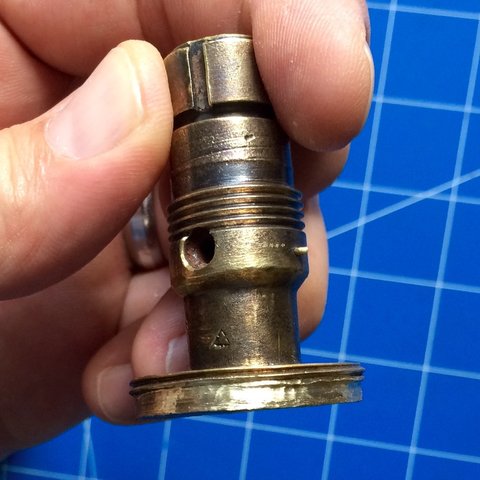

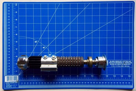

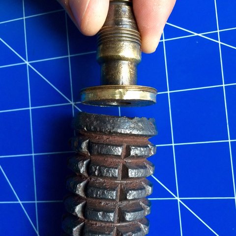

Finally, I want to show a bit about my Hales No3Mk1. I had quite a bit of difficulty getting the brass section back into the frag body, as mentioned earlier. I sort of gleamed over my process for "fixing" the issue that I had caused on my own by beating the crap out of the grenade in order to remove the detonator. But in the odd chance it may help someone else, I will share my very non-gentle way of massaging a warped brass section into a deteriorating frag body.

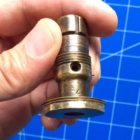

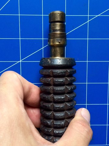

First, let me show you the bottom (the end closest to the pommel on the OB1) section of the frag body. It has some real deterioration:
Spin it a little:
As you can see, the bottom rim of the frag body is quite eaten away. I know there have been some questions regarding how this sits against the clamp/clamp spacer. On the one hand, I am lucky this is made of steel, so once I screw on my end nut-device, it all holds together tightly with no wobble. On the other hand, tiny bits of this are so deteriorated, the steel is a bit brittle where it is extremely worn, so I run the risk of snapping off those little ridges.
And now, I'll show you the brass section screwed into the frag body (this is the other end of the frag body) just to assure you that superficially, everything comes out okay in the end:
And here is a profile shot to show how flush it is...probably need to get this down just a hair further:
So, you're probably saying to yourself, "that doesn't look so bad. I thought you said it was really warped." Well, the thing to remember is this is brass and steel, and it doesn't take much warping to make these two not come together. What I had to do was take my trusty rotary tool and grind down about 3/4 of the threads.
This is what that looks like outside the frag body:
All the way around...:
It takes a very steady hand to leave those upper two threads alone. Here it is going into the frag body:
And there you have it thus far.
Please do take a look at these next two images and let me know your opinions on these washers. I've tried to give two slightly different angles to show how they look:
Too big? Let me know.

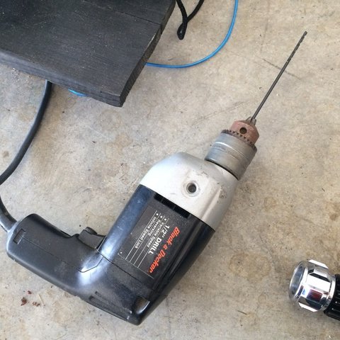

1. a really old period-correct electric hand drill with 1/8” drill bit

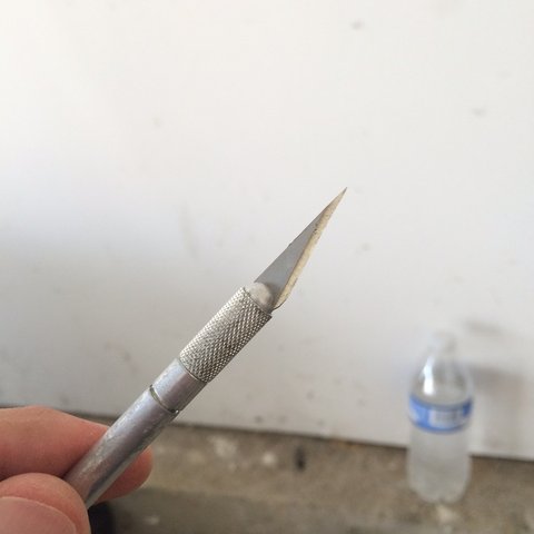

3. an X-Acto knife (it must be new; it must be sharp)

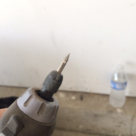

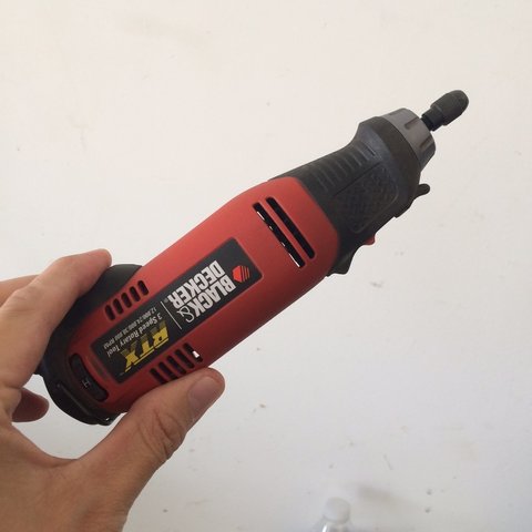

4. and what kind of cockamamie build would this be without my trusty rotary tool?
For this challenge, I used it only for a moment, but with it, I used...
5. this super pointy bit (whatever you do, do NOT trip and fall and have your eye land on this thing)

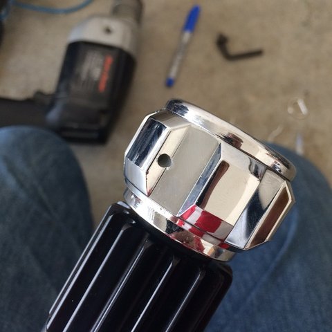

The next step then is to see where the hole needs to be drilled in the cube. This was also challenging, but I did remember seeing on the internet a very good example of where the hole is supposed to go: www.romanprops.com/SinkKnobTX
Roman's photo of the hole location is very helpful for two reasons:
1. I know Roman does his homework. It is evident in everything he puts out. Thus, I am confident that this is in fact where the hole is supposed to go.
2. If the hole IS in the wrong spot, I can blame it all on Roman.

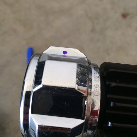

So, I took the Sharpie and made a mark where I estimated my hole matches up with Roman's handwheel's hole:
I know what you are thinking...why did I draw such a large dot if I was using a fine point Sharpie? The reason is that very rarely do I touch the tip of the Sharpie for the very first time in exactly the right spot. Once I have the Sharpie on the handwheel, I can sort of correct where the tip is and by making the circle bigger, I know that the center of my pilot hole needs to be in the center of the dot. If you start with a regular fat Sharpie, this "luxury" will not be available to you.
DOING THE DEED
It was at this point that my nerves started getting to me... I mean, THIS IS IT... the big moment! So I thought that the wisest thing would be to do a primer for my pilot hole.
So I took the X-Acto knife and put its razor tip in the center of the Sharpie dot. Then I began rolling it back and forth in between my thumb and finger just to get the pilot hole started:
I wouldn't say I did this for too long, or dug down too far. Just let the weight of the X-Acto do all of the digging. We are only making a pilot for the pilot hole. It doesn't need to be deep.

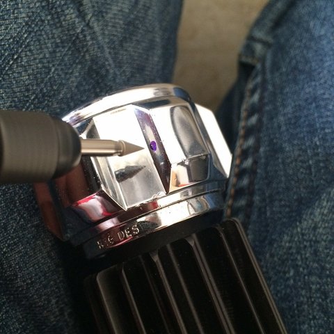

Next, I took my rotary tool with that pointed end and put that in the primer hole:
Again, with the pilot hole, I am not digging a giant hole in the cube, but a spot just big enough where I feel certain the drill bit on the drill won't come flying out once I really start going on it.

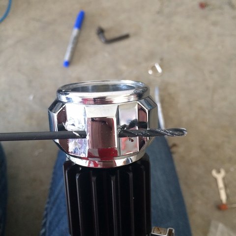

Next came the drill with the 1/8" drill bit:
The great thing about using this really old hand drill is that the bit only rotates as fast as you want it to. If you barely pull the trigger, the drill bit/chuck rotates very slowly; if you pull the trigger all the way, it drills like you think a drill will. In the photo above, I was barely pulling the trigger and that plastic came out of the hole in a rapid fashion. It is good to not have to drill to fast.
An important note when drilling with a hand drill as opposed to using a drill press: You MUST check, doublecheck, and recheck about 50 times while drilling to insure that all of your axis' are true. You don't want to be coming in crooked on this thing.
Ahhhh, complete penetration!
Here is the entrance hole:
And the exit hole.

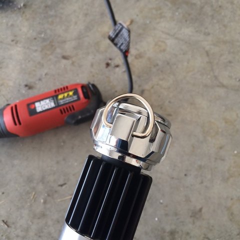

ONE D RING TO RULE THEM ALL

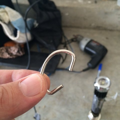

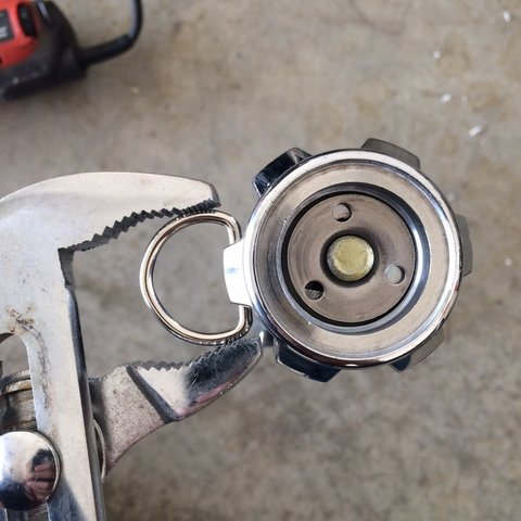

For the D-Ring itself, I used two pairs of pliers to bend it open. Normally I would use a rag or something to keep the D Ring from getting scratched by the pliers, but as this is going to be the ultimate weathered and decayed OB1, I just gripped it with the raw pliers and bent it open:
Then I put each end of the D Ring by the opposite holes and used the pliers to pinch it back shut:

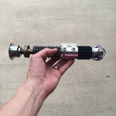

And there we have it:
BASK IN THE GLORY
And here it is proper:
Can anyone tell me exactly where this D-Ring should be located in relation to the clamp?
Thanks for reading.
Re: My In Progress OB1 ANH (some) Real Parts Build
third cube to the right of clamp... or about 4-5-o'clock
http://i288.photobucket.com/albums/ll200/mugatu66/OB1 D Ring/grinding_zpsxdyakipz.jpg

I find one of these invaluable as I don't have a drill press, find it helps with accuracy:
http://www.ebay.co.uk/itm/20PC-Micr...077?pt=LH_DefaultDomain_3&hash=item51cb455ecd
Then you could go for one of these or even skip the first:
http://www.ebay.co.uk/itm/MINI-HAND...884?pt=LH_DefaultDomain_3&hash=item33948ed1cc
Marv, I really like that first one...I can't believe I've never looked for one of these. This would be perfect...and it's ordered!
Sorry for not checking your questions in regards to the correct hole placement and those washers, they are to large indeed. Still you managed on your own and it's a great tutorial mugatu, however for those who do happen to have a drill-press at hand here's the 'correct' method for making that D-ring hole, thanks to James Kenobi 1138 :
http://www.therpf.com/showthread.php?t=113901
Chaim
Sym-Cha, I agree. A drill press is absolutely the way to go. That tutorial is awesome...I wish I'd have found it earlier. I'd have found someone with a drill press and made them do this for me. I'm also getting rid of the washers...well, one of them anyway. Probably the other one too, and replacing with a smaller one. The lazy man in me always tries to make do with whatever I can find right out of the bag at Home Depot, but these washers have really been bugging me. I guess if I can't find the right size, it's going to be rotary tool time. Watch out for flying metal discs!!!!

Danny, the cubed ring of the Handwheel is definitely plastic. I believe it has been vacuum-metalized, which is basically the same end concept as plating it. The handwheels are comprised of three pieces:
1) the cubed ring - plastic
2) a threaded inner and lower cuff - plastic
3) a threaded inner and upper cuff - metal
I'll get some images up of the three in my next update.
